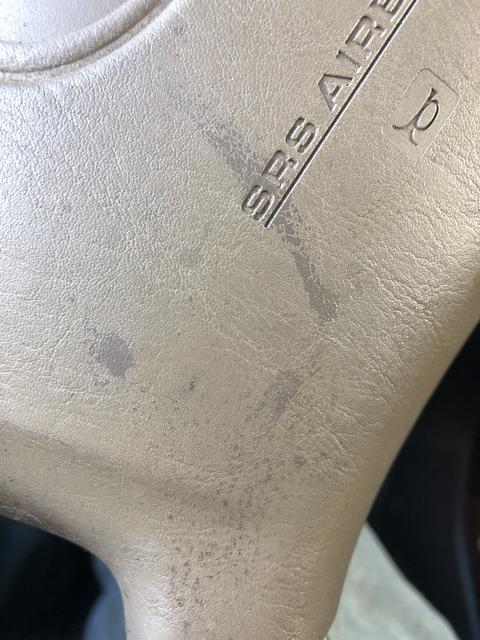

Also noticed my steering wheel looks painted, not sure if it’s oem but was wondering if anyone has any suggestions for removing the paint?

On that steering wheel, I never heard of anyone painting that before. I wonder if they used some solvent or a cleaner they shouldn't have... Or, too much sun? If paint, I'd try things that remove paint, but as always recommended, do so first in a place that is not very noticeable, just in case it somehow makes things worse.

It’s for sure paint cause I can scratch it off with my finger nail, it’s also on the bottom plastic trim pieces on the front seats. Looked like the PO had the leather on the seats and steering wheel repaired previously and I bet that’s why those things are painted so it blended the repair better.

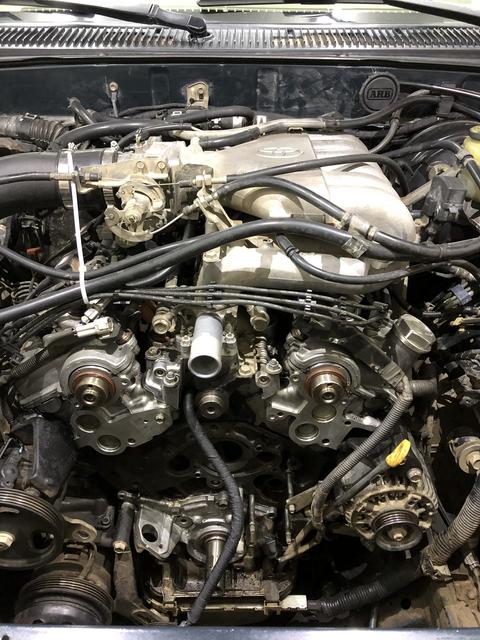

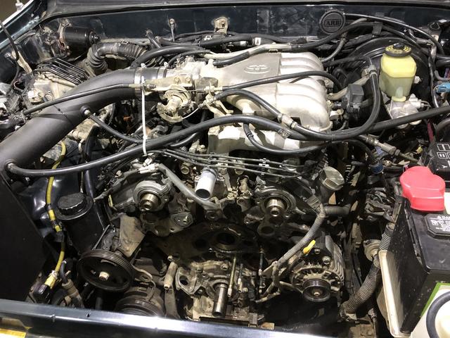

Started on the timing belt/radiator/cooler.. probably save the trans filter for my next trans flush. Pretty dirty back there! Going to get some simple green or something on there tomorrow before I reassemble everything.

I hate cleaning engine parts.. Not done but it looks a lot better already. I found a wire with the sleeve cut sort of in the middle so I ended up using some Tessa tape and wire loom to make the repair..
Now I’m pretty much just waiting on parts.. when I bought my trans cooler off eBay I didn’t see the box that said (hardware not included) and of course didn’t check the box until I was installing it lol. Here’s a few things that got delivered today

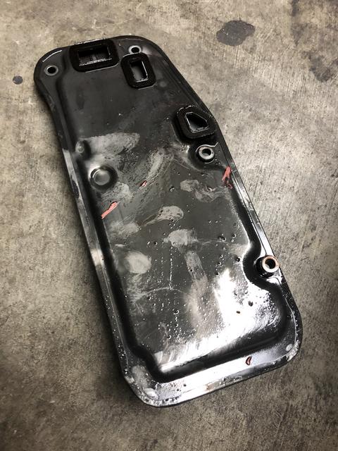

Finished up the timing belt and transmission cooler last week, turned out really nice. Ended up doing the transmission filter this weekend as well, fluid was sort of dark but I was pleased to see it was only very very fine metal shavings was like a paste. Not much of it either. Truck definitely feels better under acceleration, I think I was low on fluid before. Took 6qts and I ordered a 7th Incase I need to add a tiny bit.. thanks for all the help [MENTION=102606]infamousRNR[/MENTION]!!

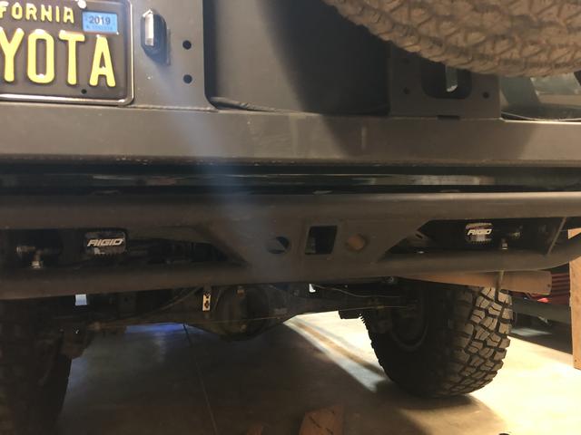

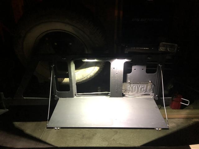

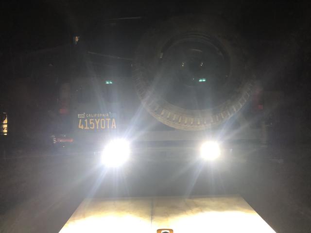

Finally finishing up with moving, been working on the garage/house every other day. Got my rigid reverse lights & camp table lights finished up last night. Really happy with how the camp table lights turned out. Also decided on my next project: marlin dual cases. With a kid on the way I want to be as safe as possible on the trail.

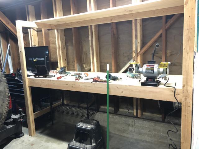

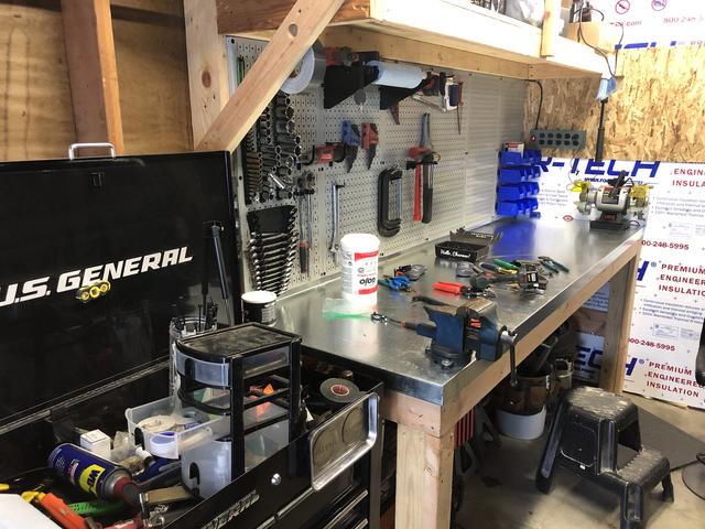

Also built a workbench today, I think it turned out pretty good..
Haven’t been doing much in the sicmods department lately, mostly preparing for the baby. Just ordered an odyssey AGM battery as the interstate battery I had wasn’t really holding a charge very well. Also updated the workbench a bit.

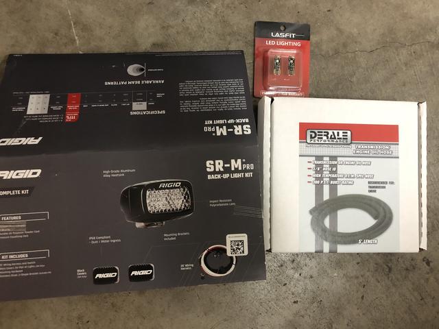

Since it was my bday not to long ago I ended up treating myself to a couple of things.

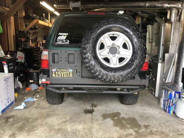

Finally made time to go on a small trip over the weekend! Was a lot of fun, wish I took more pictures. I believe we went up hwy 31 kind of near hwy 89. Got to a point where the road was completely snowed over and we didn’t want to risk getting stuck as I had already gotten stuck in a small patch of snow earlier lol.
The truck looks great, as always! The new garage looks sweet! It seems wider, and longer, the perfect place to get some sicmods done. Does it have the larger outlet for the welder?
Thanks man! Yea pretty happy with the new space. It has a 220 outlet for an electric dryer that I’m using for the welder, works great!

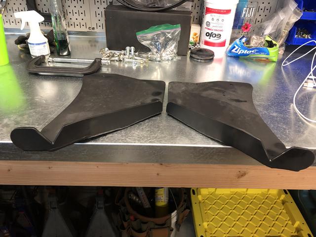

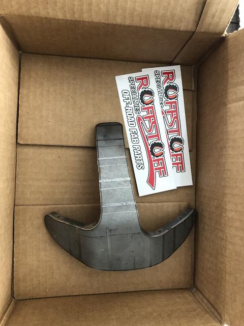

Been a while since I’ve updated. Did a couple things over the weekend: power washed/vacuumed, chased all the threads on my oem skid plate bolt holes, cut my LCA skids a bit more for clearance issues (hopefully I don’t have to cut more), tightened some of the leds on my SRQ blinker filler panels. Also just received my ruffstuff diff skid, this thing is a work of art I can’t wait to install it. Was looking at the bud built skid and I think Marlin but I just really liked the simplicity of the ruffstuff one and the price was right.
