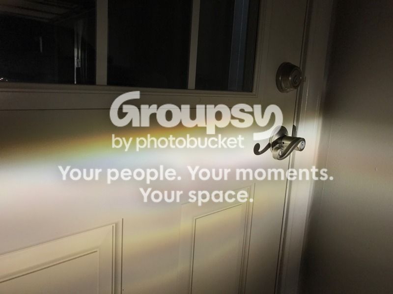

also, you will get some yellow and green (really a full spectrum) right at the cutoff even with whiter lights, its chromatic dispersion caused by diffraction from the cutoff. If you look in your photo you can actually see the full ROYGBIV
mine are definitely whiter than 4300k after lots of use, I read they are supposed to shift to ~4700k and I can believe that for mine
So the amount of orange/warmth in my cutoff line looks normal to you guys? I have seen other HID projectors and the cutoff line looks bluer. Maybe that's just due to the design of the 4Runner's halogen projectors though.
I think it's the coloring in my cutoff area that's throwing me off because below that it's pretty white (although warm). The cutoff area is very warm and greenish to the point that I am noticing how warm the light is and the color shift as oppose to just having a bright white light in front of me.
Mine looked like that when I had them aimed too low and the cutoff was too harsh. I tweaked them up just a bit where they are still properly aimed and not in anyone's eyes and they don't have that much chromatic dispersion anymore.

That could be part of the problem. I lowered them quite a bit because I was lighting up the back of people's heads in compacts and got a middle finger directed my way. Although I can't recall seeing a shift in color along the cutoff when doing the adjustment. Worth a try to raise it up a bit though.
the reason all those colors are so visible is because you are projecting onto something very close. The diffracted light isn't as intense so it will fade away if you just backup a little but
