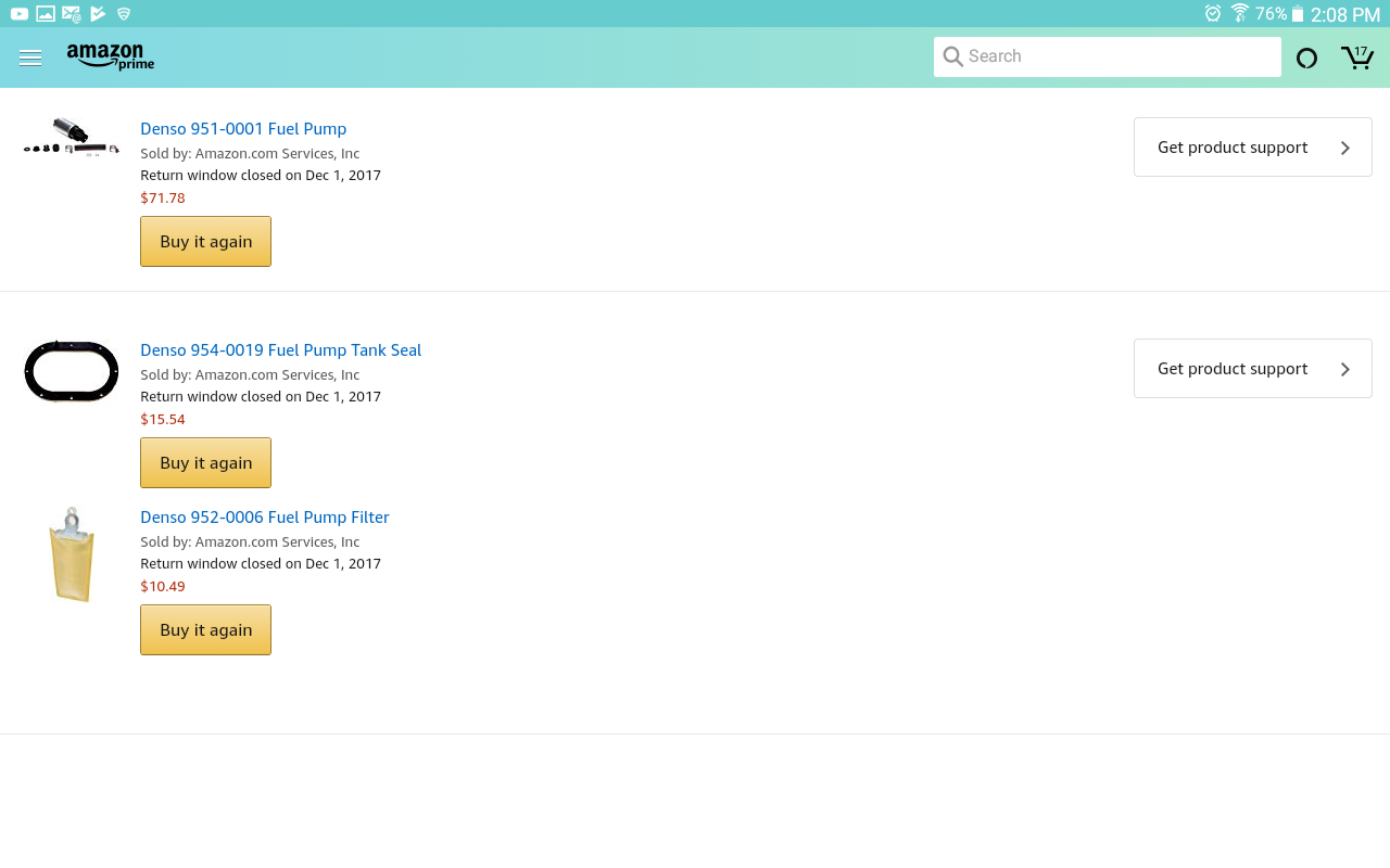

I ordered the following from amazon 2 years ago and so far so good

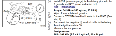

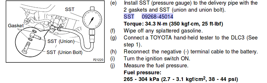

Have you been able to find the Union with adapter to check the fuel pressure? I see you have a workaround but I was hoping this adapter is available somewhere to make it a bit easier. Also; anyone know what SST stands for?
SST 09268-45014

No I haven't. I did a lot of research and you have to make a custom fitting banjo bolt or buy another fuel rail and tap a schrader valve into it. But at the moment I couldn't beat $3 bucks from the junkyard for the fittings/hose to make my own. I just rented the fuel pressure gauge from autozone and the readings were as accurate as can be. It's not really a work around it's just a easier way then custom making a banjo bolt. Apparently only the dealers have the fittings to check fuel pressure. Plus their is absolutely no room to do anything off the front of the fuel rails if you drop a nut or bolt good luck finding it. I wouldn't recommend it if it didn't work.
