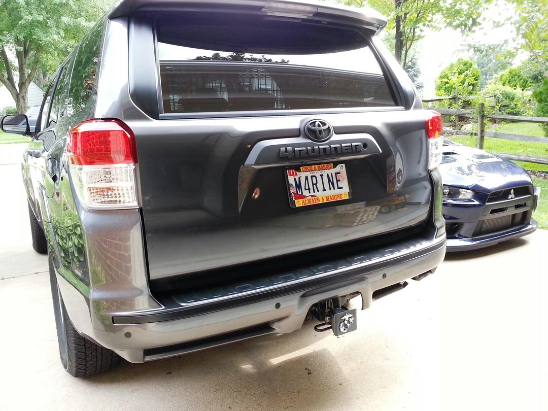

I have a 2013, so there is a chrome strip about an inch wide that runs from one side to the other, just below the liftgate on the bumper....
I've got the same strip on my '11, thanks for clarifying.
