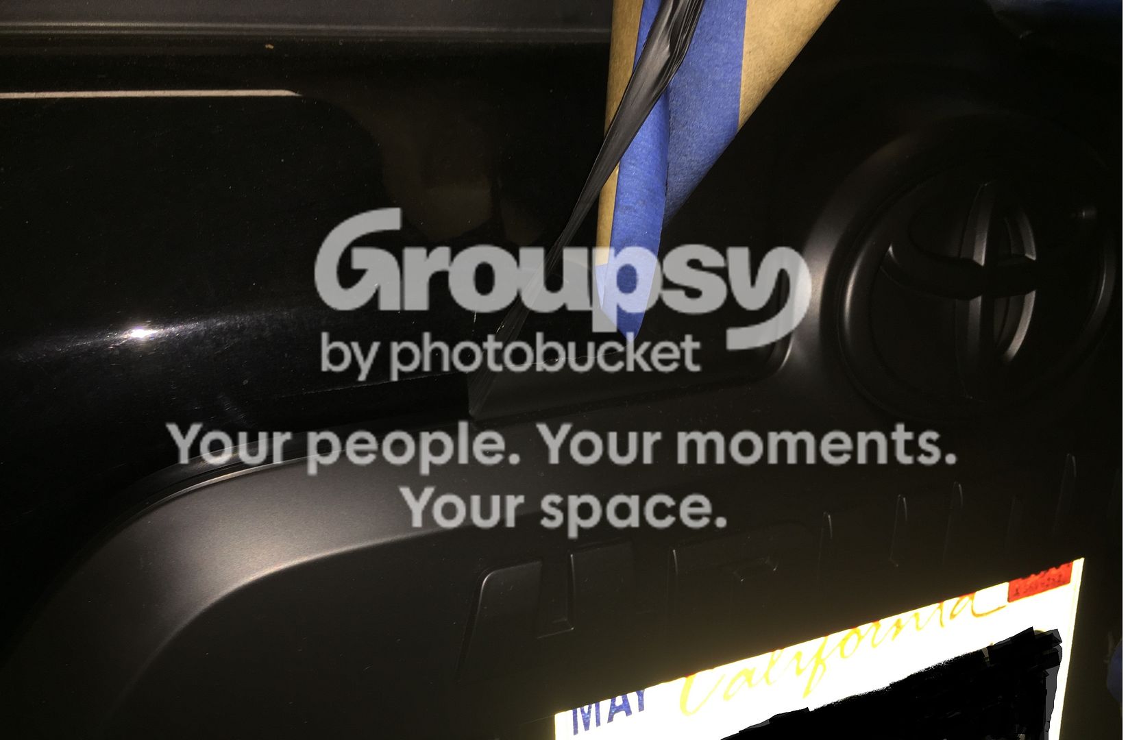

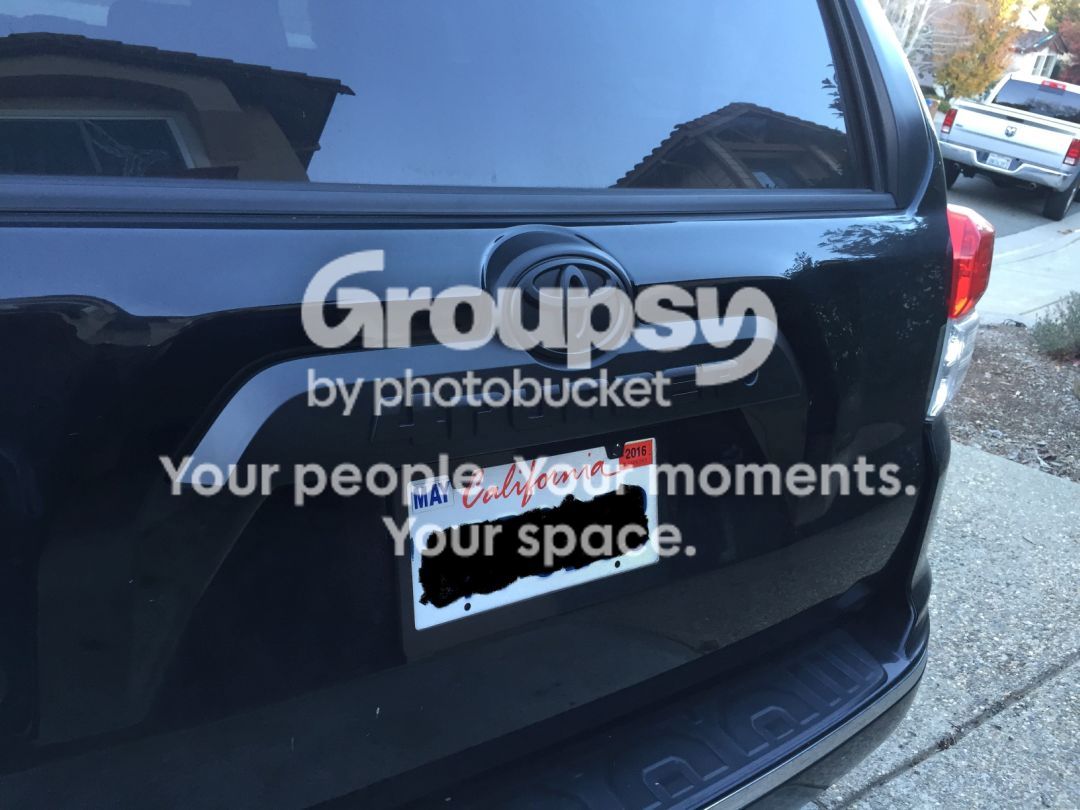

This stuff is pretty cool, I was pretty skeptical even after watching some of the videos. I masked off an area about 1" - 2" beyond the logo just to avoid light over spray. I did get a little light over spray that went under the tape where it lifted a little, I'll have to figure out how to remove that later.
It was cold (cold for California) and I noticed that this stuff does not like to spray out when its cold. Heating the can by letting it sit in some warm water made all of the difference. When it was cold it just did not want to flow on to the surface. I preheated the logo area with a heat gun from distance just to get it so that it was warm to the touch. I think the garage was only about 55 degrees while I was working in there and later in the night it got down to the low 30s outside.
On the first coat I got it on a little too heavy trying to get it between all of the letters going at it at different angles. I actually thought I was going to have to start over, I thought I had run, a sag, and some drips. The only reason I kept going was that I thought I needed to thicken it up if I wanted to be able to peel it and start over. Amazingly the run drip and sag seemed to shrink up and go away??? I'm still not sure... either way I'm happy with it. Due to the weather I decided to wait until tonight before attempting to pull the letters and logo. I only did 3 coats, I'm thinking I should have put on 1 more. The nice thing is it I think it can be redone relatively easily. I'm liking the blacked out chrome so far, but not sure about the flat finish. I might end up pulling it and painting it to match the rest of the door.
