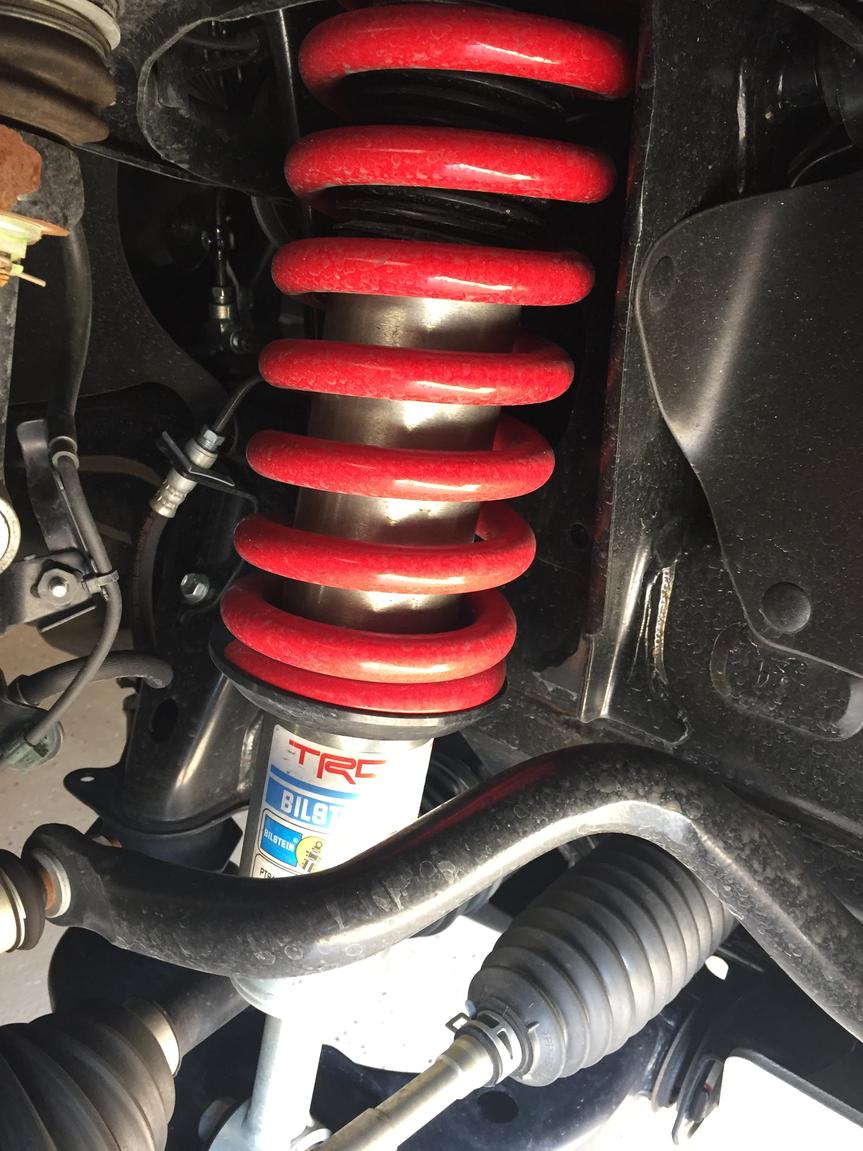

Vlad, did you move your passenger side coil up to the second setting? Mine came with it set on the lower ring. If you did move it up, how does your lean from side to side look?
Pics of my stock settings below. Drivers side is first.

Bevo, I didn't move either of my coils. They were both on the second setting when I pulled them out. I talked to one of my Toyota Techs, he told me the reason that one sides higher than the other is to compensate for the drivers weight in the vehicle. I think you gotta be pretty large to level out the truck in that manner.
I would just bring the passenger side up. That way you have an even look instead of a confused lop sided truck.
That is strange. Mine is level with the passenger side on the lower ring without me in the truck. I read the same thing about it compensating for the extra weight on the drivers side(gas tank, driver, battery, etc). If I moved the passenger side up it would not be level for sure.

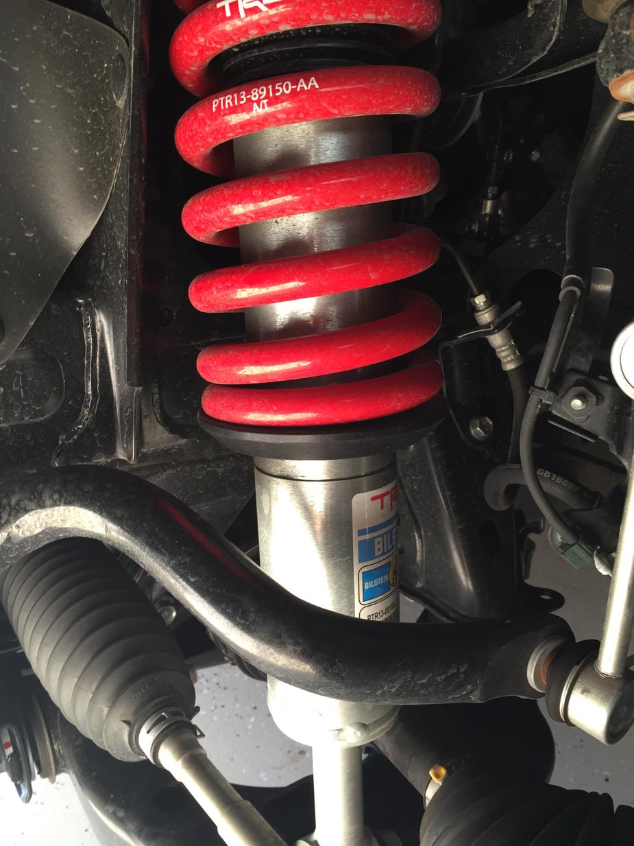

Pics of my stock settings below. Drivers side is first. Sorry the pics are sideways.
weird... yeah mine is set to higher ring on both sides and my truck is level.

Josh, there are only 2 settings on our shocks; Upper Ring and Lower Ring.

the pre production trucks you saw in all the press releases had the 3 rings... but they were "pre production"
the production trucks (ours) ended up with just two and they're (mostly) set to the higher ring...some are set one lower for passenger side from what we've learned here so far.
