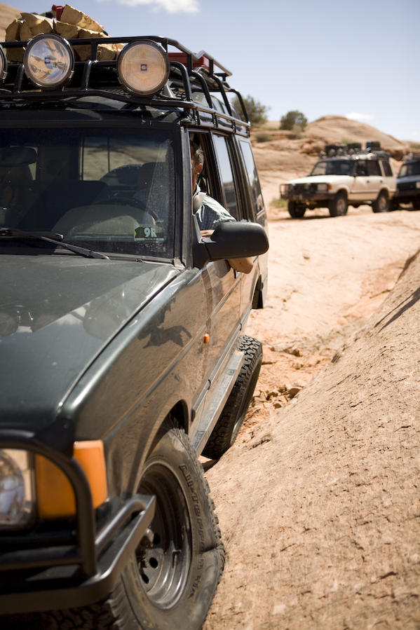

just curious... why is everyone going wider on the wheels/tires?
is it for better off road ? if so, what kind of off road are you aiming for with wider tires? unpaved roads in general of course but is the more advance stuff where a tire matters rock, mud, sand?
or is it because they generally look better?
I only ask because this is always a good subject to hear opinions on the matter since its such a subjective thing (imho). personally I've always gone skinnier on the tire and smaller diameter on the wheel and larger diameter on the tire. for example, my land rover right now has 33x10.5x15 tires while many love to run 32x12.5x16 . i run mostly around California/Utah trails wish are rocky with packed sand at best. Mud and soft deep sand aren't really prevalent enough (unless you seek them on purpose) to warrant a wider tire for the float effect and the skinny vs wide debate on snow.... again i prefer skinny, but i know many prefer wide. My "science" behind it is more rubber to flex and soften the ride on rough roads ( washboard/small rock road) with 15-16 rims and easier to maneuver the truck through tricky stuff with the skinnier tire while the larger diameter makes it better to go over stuff (think 29r bicycles).. the wider the tire the more you're wrestling the thing and when you're really flexing, the bigger the tire the less room in the wheel well to tuck into it.
on this 4runner i was pleasantly surprised to find 7" rims on it but i read so many guys wishing for wider rims.
