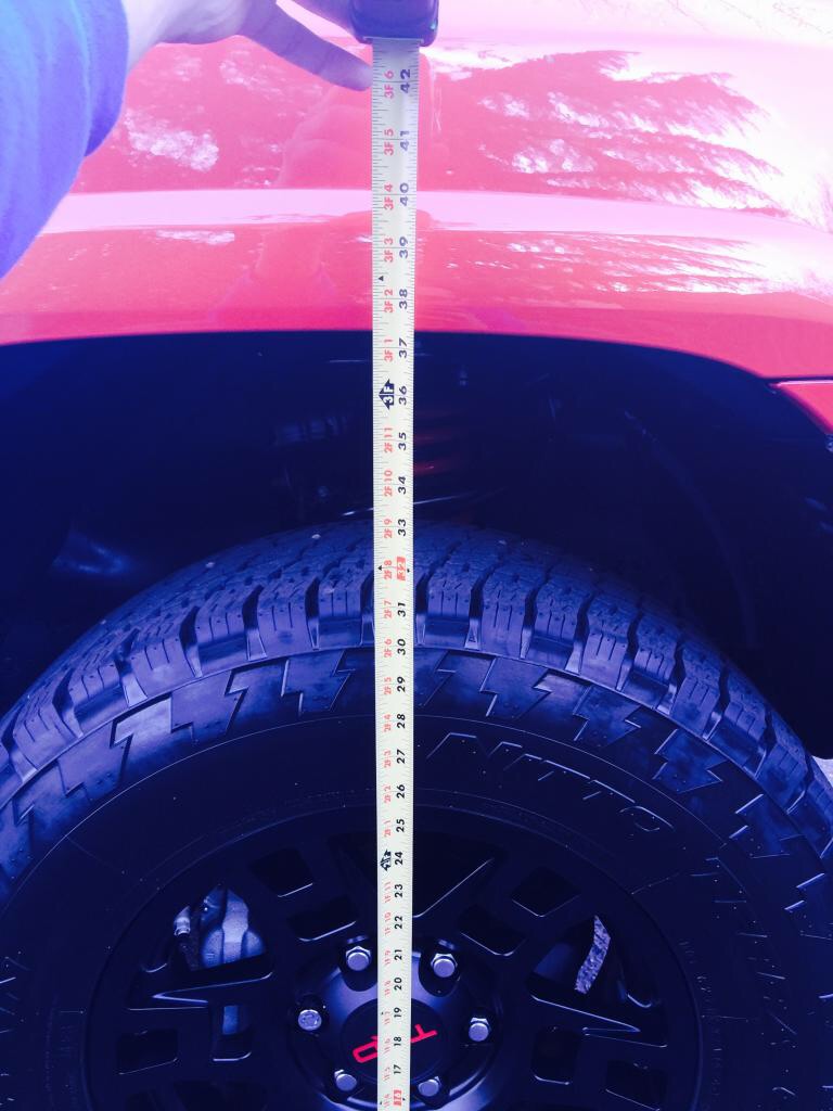

My first mod: Installed 3/4" Toytec spacer in the front to level the truck.
Nice man! Looking to maybe do the same. Did you measure before/after? Would love to know. Also, are both your coils set at the same level or is your driver's side on the upper seat? Lastly, any issues with your UCA's? Your pic looks like it is much lower than stock, so wondering if you had any alignment or rub issues.
Thanks and congrats on the new ride!

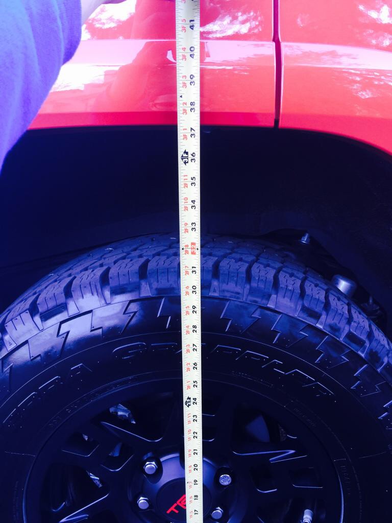

These are the 1' Baja lift spacers for the front
Front
I would assume the 3/4 toytec spacers are slightly lower
I didn't measure before but now is 36 5/8" on both sides on the front.
Both coils are set equal. No issues with the UCA and everything is stock.
Alignment before and after was check and stayed the same.
No rub issues as well
Hope this help
