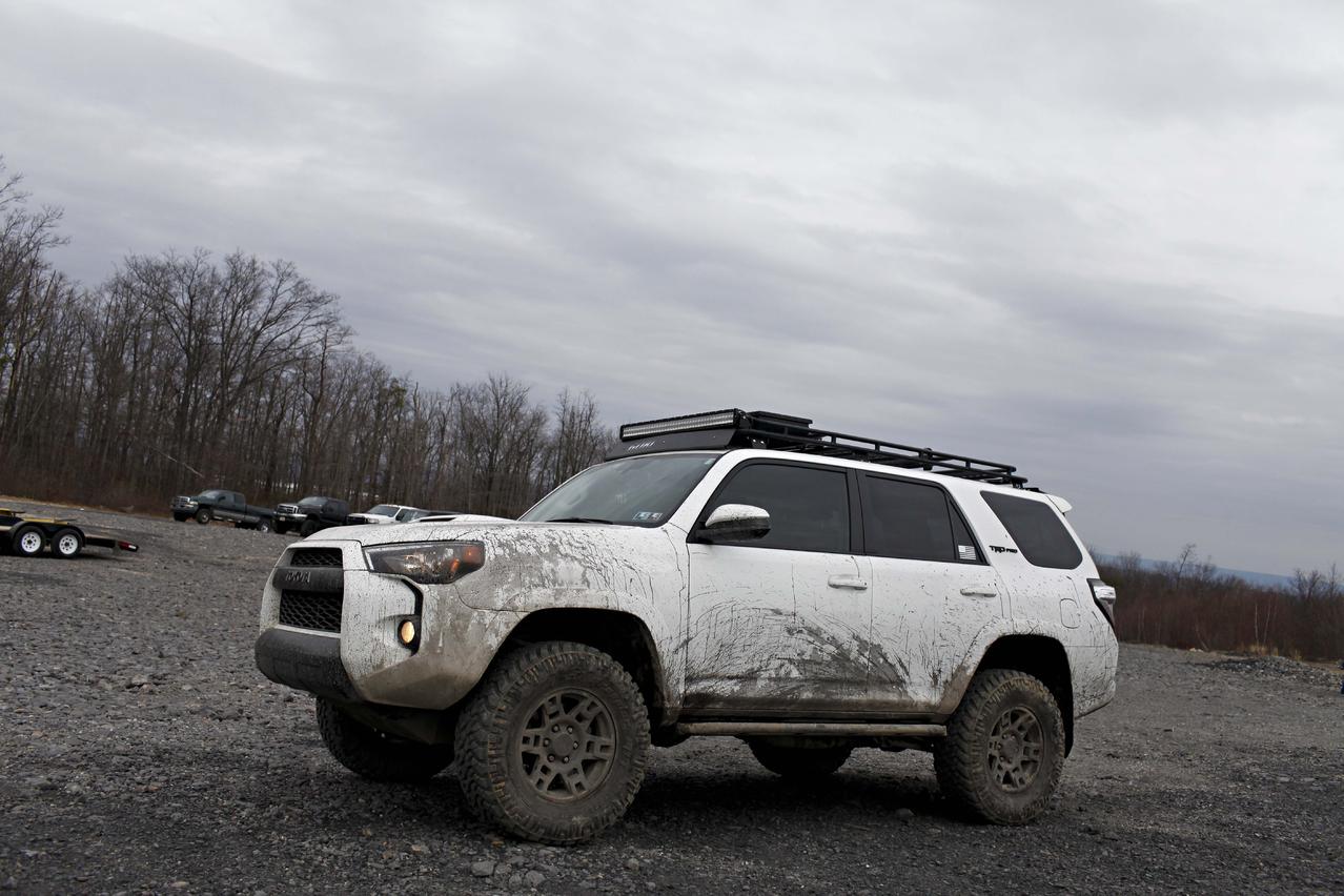

Toytec Lift - 285/70/17 NITTO TRAIL GRAP- fit with no issue & no rubbing. had to remove the front mud flaps though just to be safe. Otherwise they would definitely get torn off while going over rocks. Also have demello sliders which fit without issue. no need for any sort of cutting etc.
you WILL need a lift if you want tires of this size.

Awesome, this is great to know. I have the Toytec lift and am gonna go with the 285/70/17 Nitto Ridge Grapplers when my Terras wear down.. they're slightly less wide than the Trail Grapplers. 32.76in diam 11.5in width on the Ridge vs. 33.15in diam 11.81in width on the Trails
