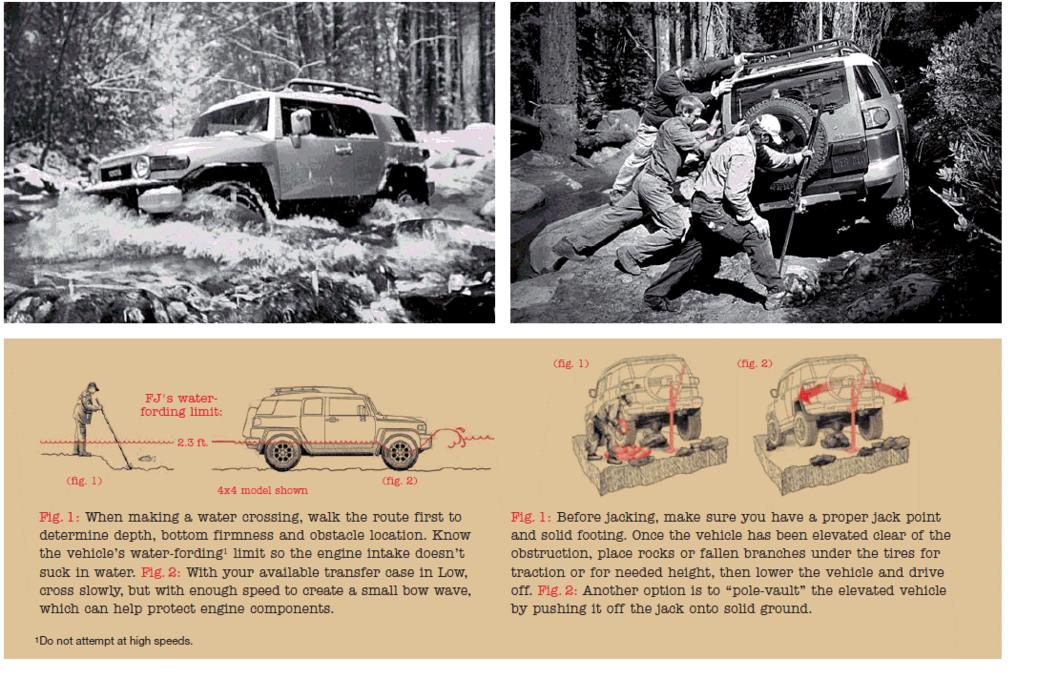

I agree with most of what you have an opinion on here, but what do you say about this from Toyota?
See Pic below.
No rear diff breather mods installed from factory, thats why we install them.
Not for everyone, I'm sure, but we still do it as a precaustion. All other breathers are up much higher in the engine compartment.

I call BS, my FJ Cruiser's transmission and T/O bearing died from sucking water from much shallower water crossings.
Well....that is straight from their brochure, maybe you should have taken that BS up with Toyota....
Don't shoot the messenger, my friend!
