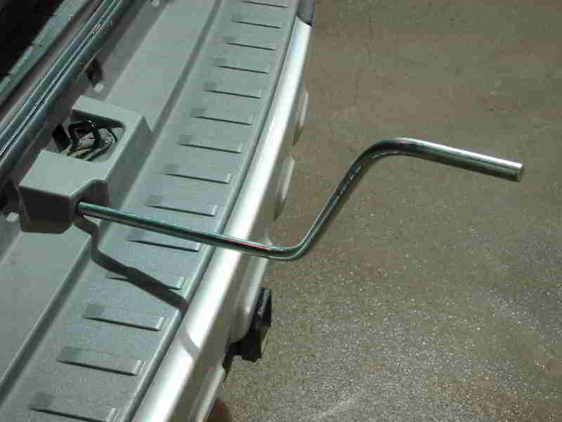

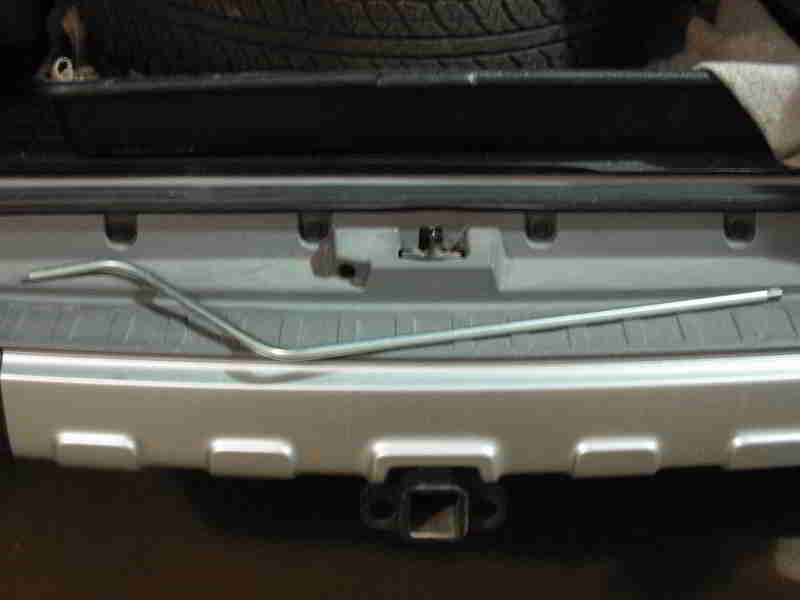

This thread gave me this idea. Why carry a Phillips screwdriver (which you don't really need) when you can carry a big stick!
Take a 1/2" diameter X 36" plated steel rod. Mill a 0.422" X 3/4" long square drive on one end. Hold it in a vice and put some bends in it to create a handle.
With this and a trolley floor jack in the garage I won't have to unpack the T4R equipment unless I'm away from home.
