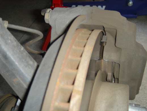

Front brakes. Plenty of pad left at 29k miles:

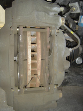

Another shot of the front brakes. BTW, how do you guys attach more than one pic at the same time? Thx!

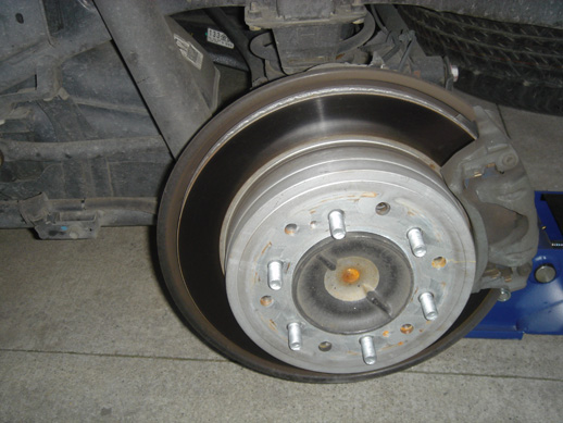

Here are the rear brakes. No brake grooves at all! Is this normal?
You have to remember that 80% or more of your braking is done by the front brakes. It is normal for the rear rotors to look like that. The back pads can last 3 to 4 times longer then the front.
