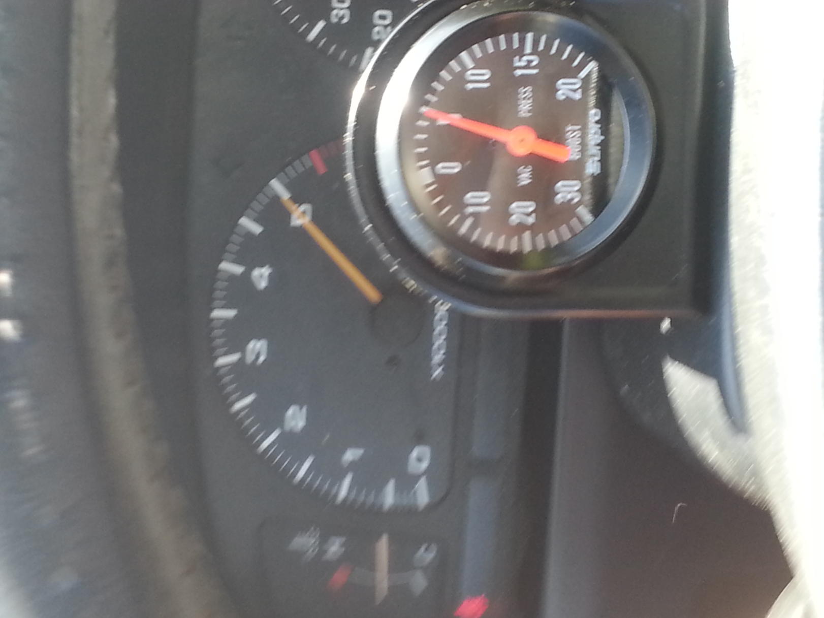

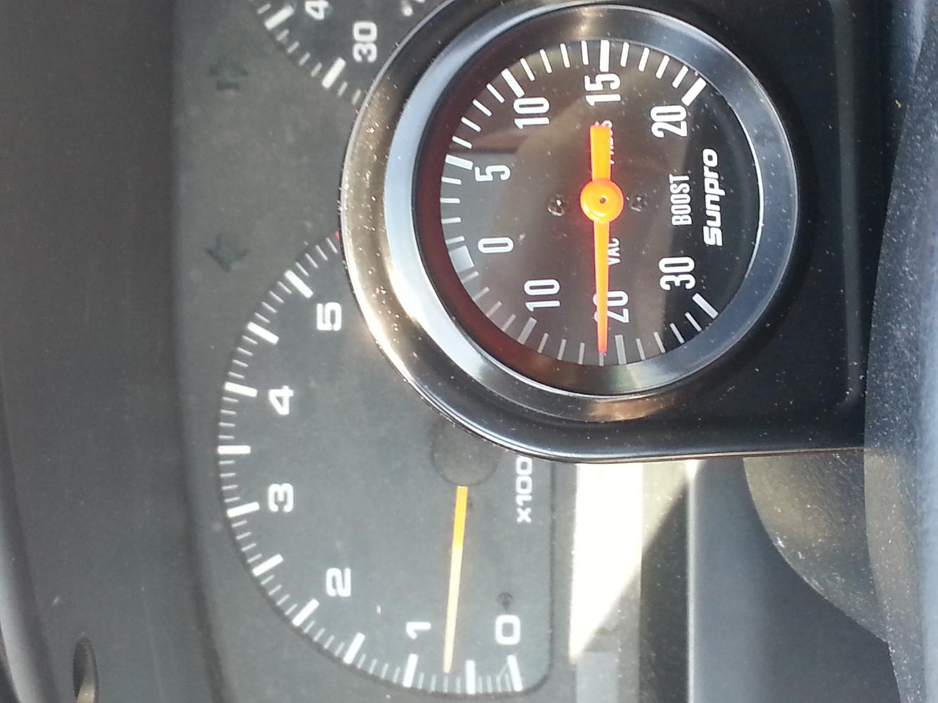

I've done some research and can't seem to find anything relating to this so I thought I would ask. I am only seeing 5psi full throttle in any gear. Vacuum at idle is around 15 and 20 on decel. The reading doesn't bleed off goes goes up to 5 and stays there. I have the second gen supercharger with the dynamic tensioner. I also have TRD headers, with a resonator in place of the cat with borla exhaust. Wondering if it would be normal to have only 5psi of boost or if I may have a problem somewhere...I am at 1000 ft above sea level.
About to start tuning this thing and want to make sure I don't have any issues before hand. On a side note, when I had the R4 software going looking at readings I was getting about the same. But with the engine off it was at -.8? I was just playing with it at the time and am not sure I had the settings like Gadget lists in the U-tune manual. The setting was at Vaccum/Pressure, but I hadn't messed with any of the other settings as of yet.

Did a few runs this morning with the R4 software and the gauge. Consistantly the gauge shows 5psi where the software only shows 4.3-4.4. Plus every time the truck is off instead of showing 0 it is showing -.8. Any way to calibrate the MAP sensor in the URD computer?

I'll have to check and make sure at lunch. I wanna say yesterday after it had warmed up with the ac off it was 18-20 vacuum at idle. What way would you suggest checking for leaks?

Checked at lunch at 700 rpm fully warmed up it's a tick over 18 in/Hg at idle. Drops to 20-22 on decel. While idling I grabbed some throttle plate cleaner and sprayed around the boost port and connections at the back of the charger, around the bypass valve, around the intake manifold (hard to get to the driver's side of it under the charger though) and rechecked the torque on all the bolts. Idle didn't change at all when I was spraying the cleaner. This is how I have checked for vaccum leaks in the past on other cars, someone chime in if there's a better way...

Question - how does the sunpro read boost? Where did you connect the line to?

As far as the sunpro I tappped into the line going from the back of the supercharger (fuel rail vaccum) where I already had it tapped for the URD Map sensor line, just tapped it again using vaccum hose instead of the ridiculously cheap plastic line that the gauge comes with.
