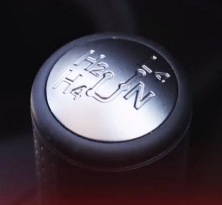

Today I checked it one more time and here is what I noticed.
While on full stop ,with break pressed, but transmission on D, system locks the transfer case handle and does not let me move it from 4H to 4L until I switch to neutral. BUT
WHEN I STARTED MOVING, SHIFTED FROM 4H TO 2H AND BACK TO 4H, THE SYSTEM AALOWED ME TO MOVE TRANSFER CASE HANDLE TO "N" AND EVEN TO 4L.... I did not move to 4L while driving though, I just gently pushed it to make sure it is moving, to prevent damage. As soon as I start feeling rattling I stopped moving the handle and stopped the track.
So, it looks like and an issue, no?
Btw, the indication I got was: check engine, Track Off amber constantly, and Multiterrain indication green flashing constantly.
My expectation from the system was it should not have allowed me to move TC handle to 2L until all conditions fulfilled (full stop, break pushed, Nutral). Is my expectation too high?

Believe he's trying to explain that he's getting grinding when trying to move the tcase lever into L4 from H4 while driving down the road at speed. You may not be able to break it by pushing at it at highway speed but I don't think you mean that it can be done. He is presuming that the component is designed in such a way that you cannot cause damage although the audible results should be a sign.
Now that he explains the Camaro 1st gear lockout he's talking transmissions not transfer case but anyway, find 'em or grind 'em eventually it will get sorted, or understood.
