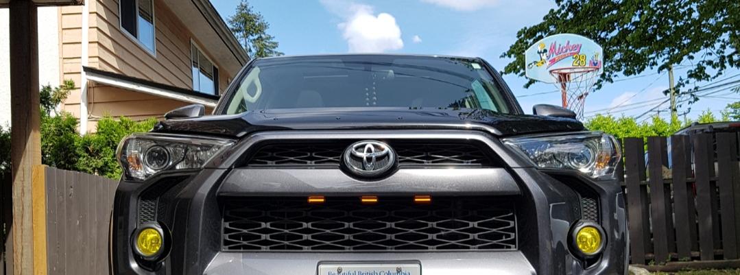

First post. Bought my daughter a TRD Pro. My wife and i both have Raptor’s and really liked what I saw on this thread. However, I wasn't happy with the plastic LEDs bars being used. Found these on amazon and gave them a try.
5 LONG HAUL CLEAR/AMBER MINI OVAL 2 LED DIODES 2" X 3/4" .75" CLEARANCE MARKER TRAILER TRUCK LIGHTS W BULLET ENDS https://www.amazon.com/dp/B00SC2QARK?ref=yo_pop_ma_swf
Very happy with fit and final results! They look very similar to the ones on the Raptor, are bright during day/night and fit securely in the grill slots. Only modification I did was to silicone the lights better to seal them. Alrhough they snapped into the grill and felt secure, I added a littlesilicone on them to ‘glue’ them in grill.

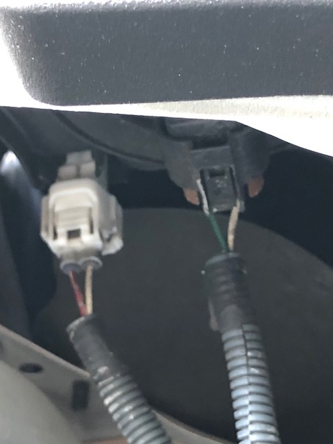

Can someone confirm for me that this green wire to my day time running light is the wire used for the led's? On all the time any lights are on? Thanks in advance.

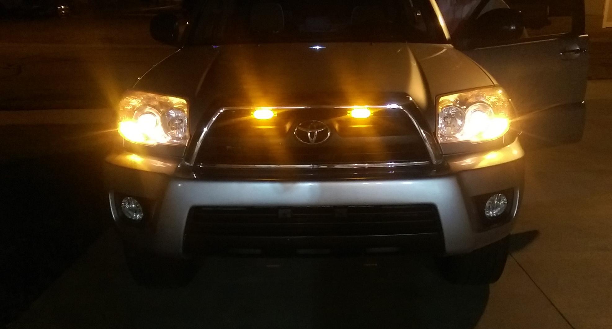

4th Gen Marker Light Install
Finished my install on my 2008 4Runner. Love the updated look it gives the truck. Pictures don't really give it justice. Thanks for all the info in the previous posts everyone!
Depends on when you want them on. Most guys tie the grill markers to the side markers, not your highbeams/ drl. Also killing the drls with the bent pin metjod would kill anything wired to them like your markers in this case.
Either way, before you splice, slide the led marker wire along your stock wires and into the back of the plug to test the connection.

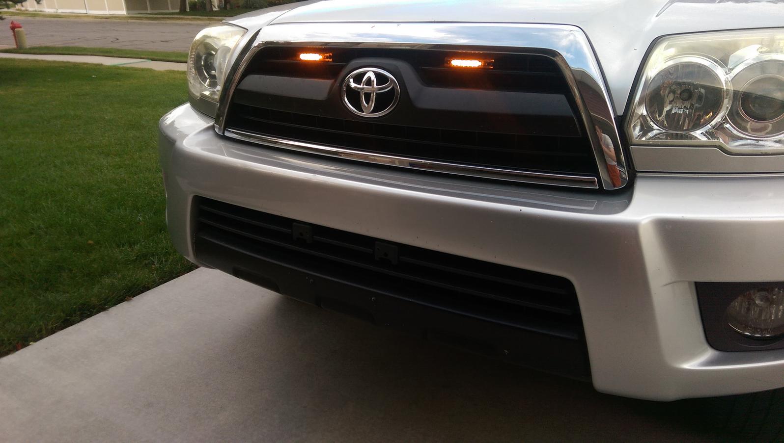

Ok, got mine done. This was actually my first DIY wiring job. It was actually easier than getting my light bar wiring done, even though that came from a kit.
I went ahead and dremeled the sides so it would be flush with the grill, as per some other posts here. I also spraypainted black the sides that I cut. At first I thought it was going to be a waste of time but I am glad that I did (I would have used heat shrink tubing if I had some though...would have been easier).
I didn't want to wire tap anything so I used the tap-a-fuse back into the interior fuse box. Unlike some other posts....I only needed 1 fuse in the tap-a-fuse and it worked the first time.

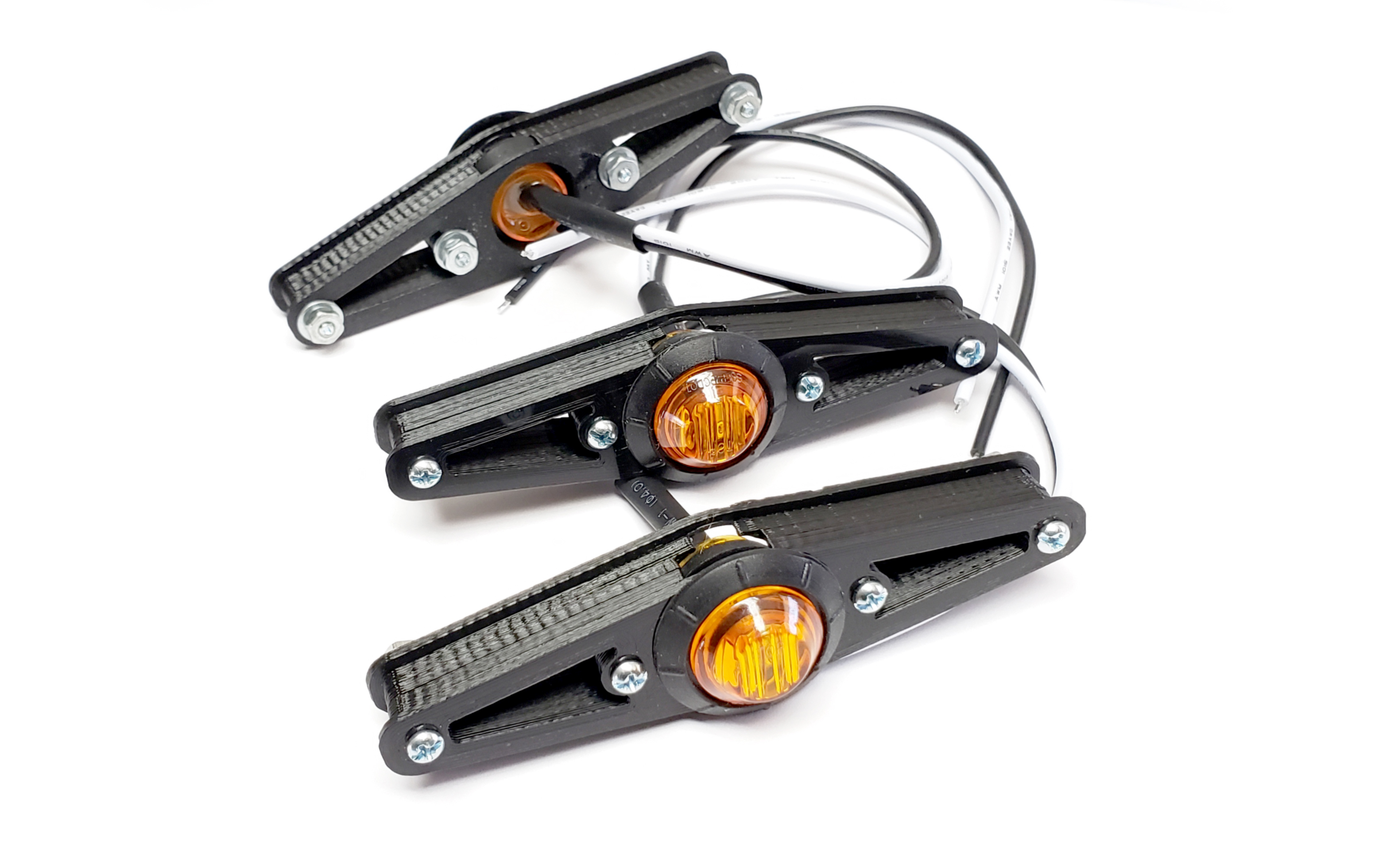

Hey guys, check this out! I found this searching on Facebook. Someone finally found a solution for mounting those round 3/4" LED lights for the 5th gen grill.https://www.gunnscaddshop.com/shop
I hadn't seen these till I ordered them, I was excited for them because they look good and don't have to zip tie something on,
they were on the expensive side at $60 for a set of three plus shipping, when I got them I thought "man, I'm going to loose at least half of these little nuts and washers putting them in" I took the first one apart and was pleased to find out the screw is what holds them together and the nuts are supplementary, I got one of them in and was getting ready to put the nuts and washers on, I notice they didn't fit as tight as I had wished for, as I was starting to put the washers and nuts on I was pushing on the front to hold it in place and accidentally popped it thru the grill dropping it inside, a little peaved at first I put it back together and tried to just pop them in, worked out fine but still loose and could get shoved out at any time easily enough,
I was at a loss as to what to do.... but looking at them they seem just too thick for my grill, thinking back the web site had some kind of measurement for their use but I ignored it as I always do.
my final fix and am very happy with them now was to put a 14 inch wire tie around the back to take up the slack for them being too thick, I used a 14 inch because it's all I had but mostly for their width, it put them at just the right position to hold them securely in place, not secure enough that they wont come out but enough that they wont just fall out,
now I just have to wire them up
I ordered a set of these a few weeks back but haven't messed with installing them yet. I believe they're only designed to mount in certain holes. Which front grille do you have? Did you try other holes in the grille for fitment?
