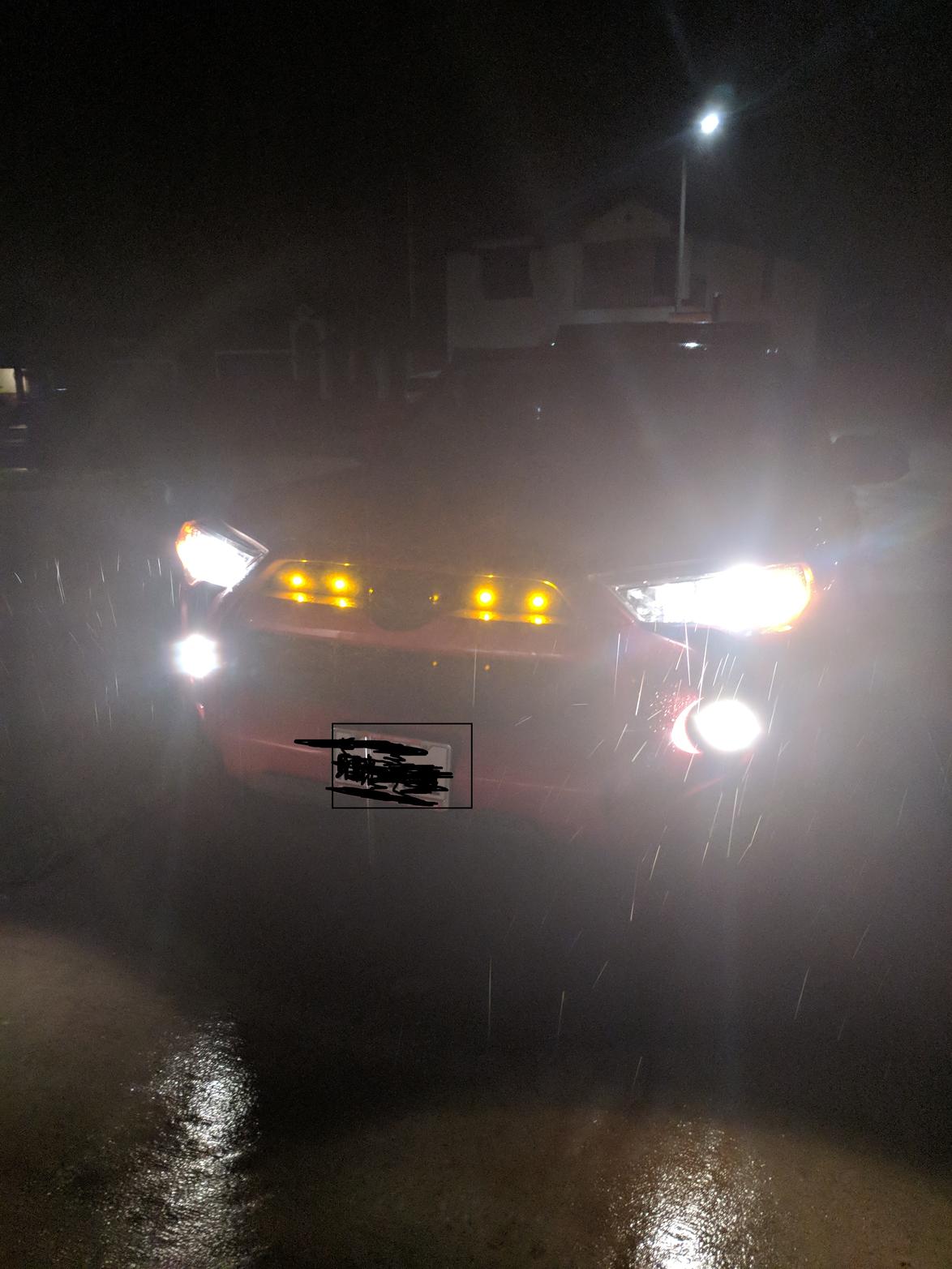

They look awesome!!!! I can wait to get mine so I can make the switch from the GG ones!!

I didn't really see a good write up on this, so I went through it on my own, so I'll post it here.
First off don't ever use a wire T-Tap on a 40k vehicle, there are always ways around it. Second, I never fuse tap into the under hood fuse box. Toyota's are known for electrical gremlins, so I try to be the least evasive, and always make it so I can return it to stock.
All in all this was fast an easy. It took longer to make this post than to install the lights. I will update if I have any issues.
I used these lights from Amazon.
https://www.amazon.com/gp/product/B00ECTQNF6/ref=oh_aui_detailpage_o00_s00?ie=UTF8&psc=1
Prepped the light tails. No need for fancy connectors.
I used high quality zip ties, I might change to small bolts if I feel like it.
Then I prepped the harness using 18ga, cause that's the smallest I had.
Then covered it in some split loom.
Plugged it all in, and filled the connectors with some di-electric grease.
Then added some electrical tape to the connection areas.
I ran the power wire through the small hole that the hood latch cable goes through. It fits no problem, and I was able to push it through with only hand pressure. I wrapped the area that goes through the firewall with electrical tape for added protection.
Then I got out my Voltage Meter and searched for a switched circuit. I found an unused one that was hot when the ignition was on, but not hot when the key is turned to acc.
I used a fuse tap I got off Amazon. These are nice, because the new circuit is powered through the main fuse, that way you can't overload it, if you were to tap into a circuit that is already in use.
I only had 15amp mini fuses, so I'll have to switch them out to some 3amps tomorrow.
Works great. Much brighter than I thought.

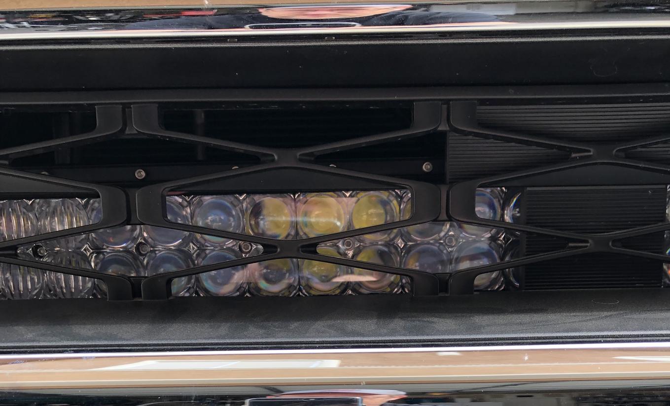

Cali raised 32 led light bar
Anyone heard good bad cost. My wife had one installed for my bday I think she over paid. And might be me bring pickie but the install looks to low should be in the middle
Is that a SDHQ mount? On the limited the upper mount is just a tad low (it is made for the other trim models). Mine is just slightly higher than that but my light bar might not be as wide as yours. So it may be as high as you can go. You might have to take a look at the mount and see if it will side up any higher.
