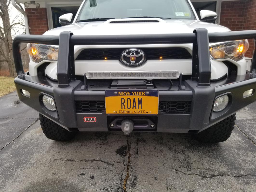

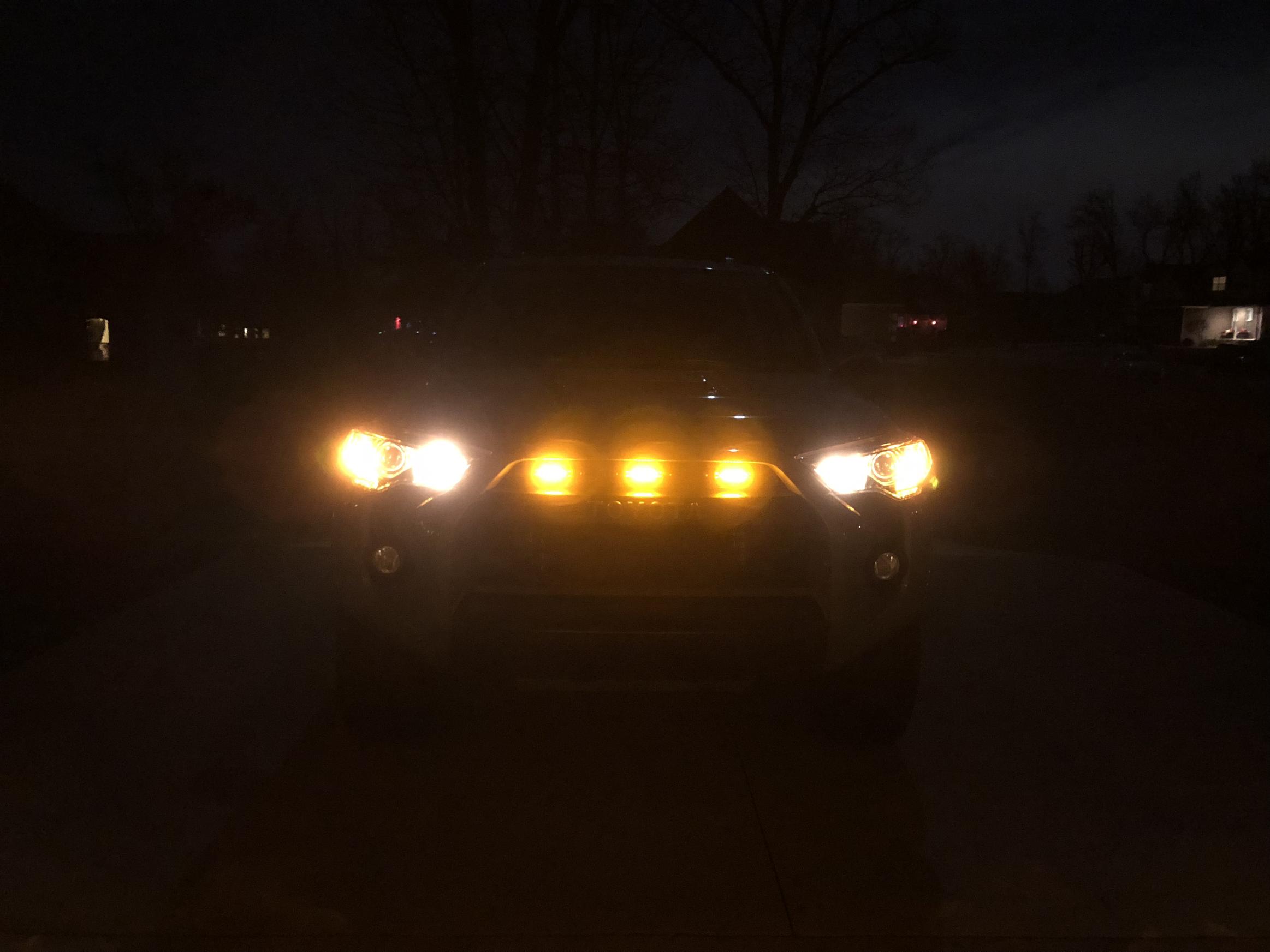

Amber Marker Lights on 2017 T4R LTD

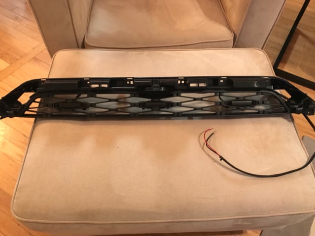

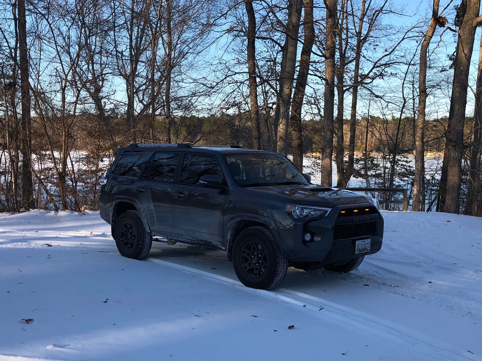

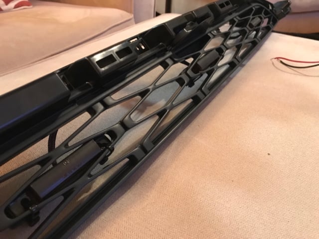

Bought 4, put in 2. Thinking of putting in the other two down low near the fog lights. Not sure how easy it is to remove that plastic trim around the fog though. There is an empty space there that would fit these in perfect.
Thoughts?

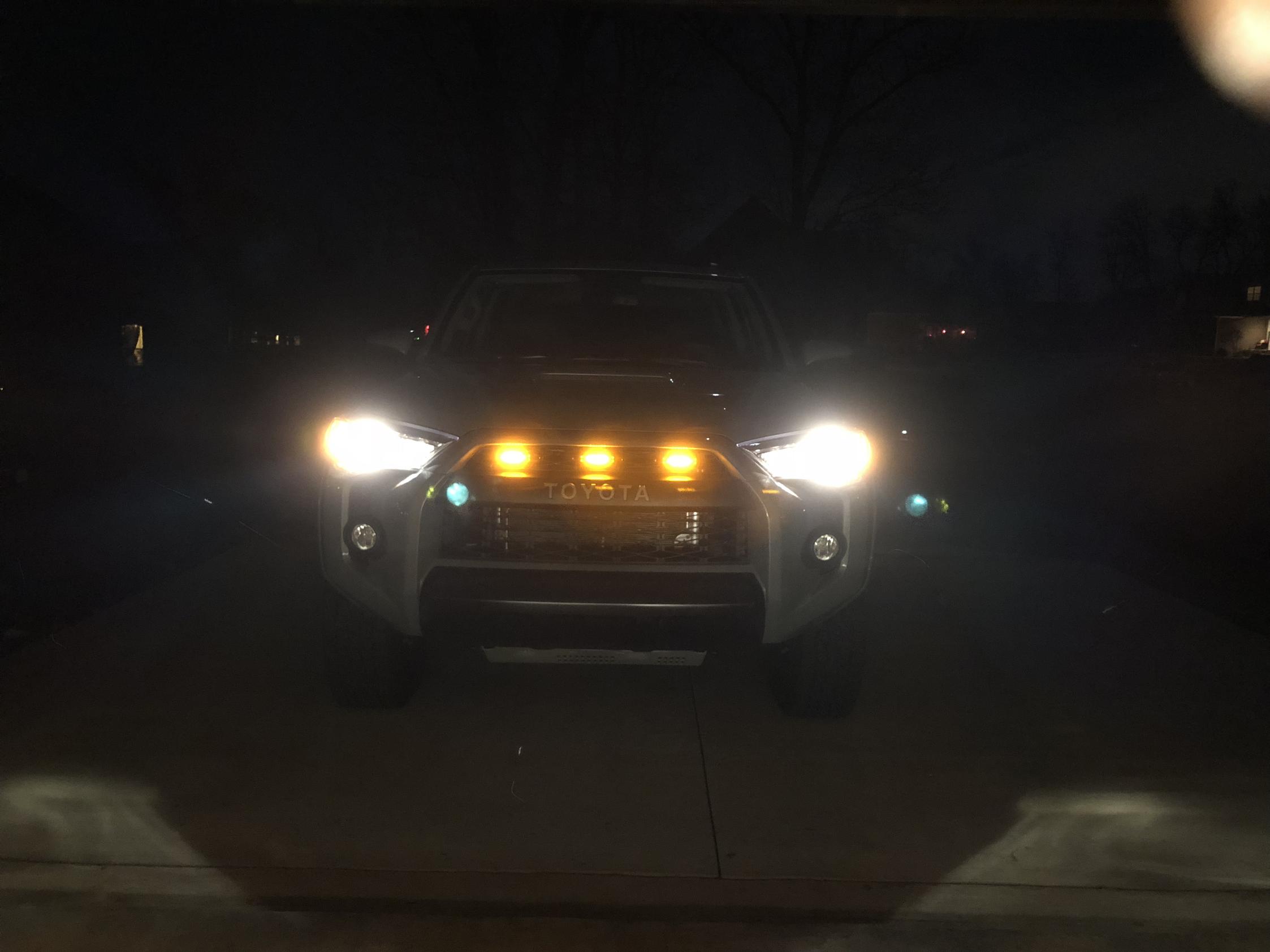

So here are couple of pics of where I've tapped into the side marker lights. Again, I've changed my marker lights to LED's. So the combined load of the marker lights and the 3 grill marker lights are relatively low and rest assured you won't be popping/blowing the fuse.
For reference, the green wire is the power. I just tapped into the green wire. The white is ground. For my ground wire from the grill lights, I just grounded it separately. In the pic, black wire to ground. Hope this helps.

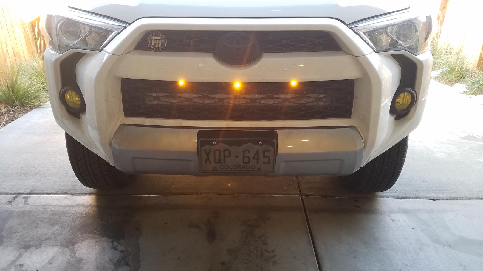

I went a but of a different route and put them right below the Toyota. You can't see them when you are standing there and they look good when on. I also used the small dot LEDs

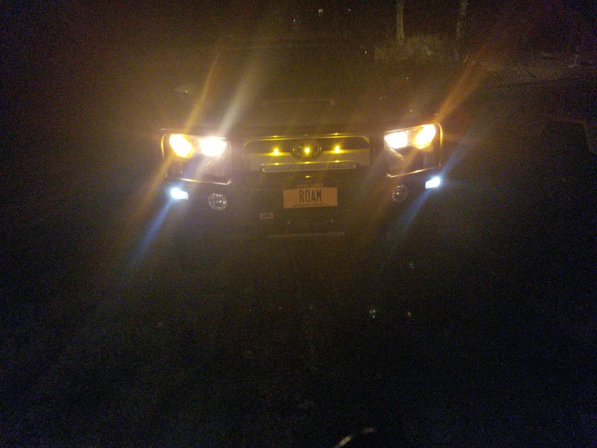

I used some small LED's off Fleabay...discreet, pretty bright, happy with the outcome
