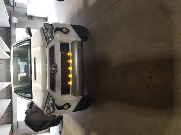

Hi Toyota 4Runner Forum.

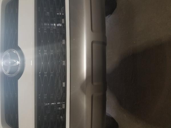

This is my first post. Sorry about the photo being sideways. I can't figure out how to turn it around. I'm not very tech savvy.
Thank you for the wealth of information this forum provides.

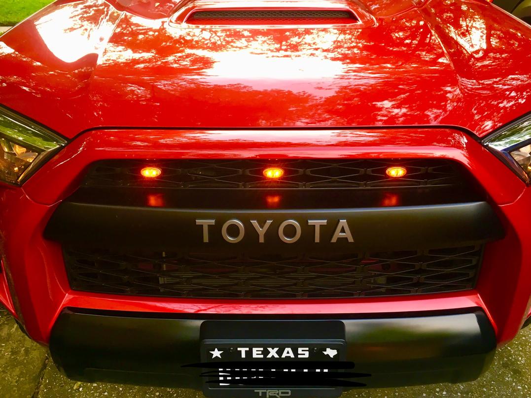

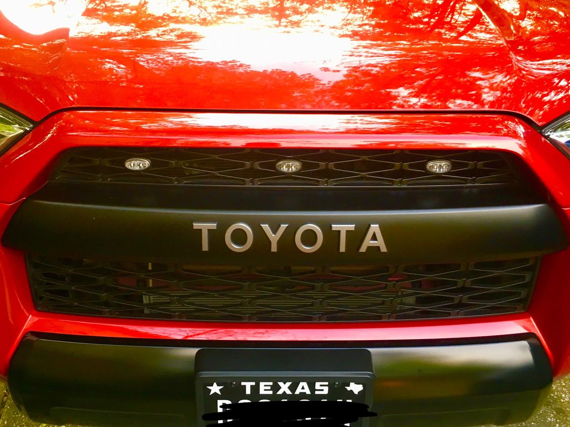

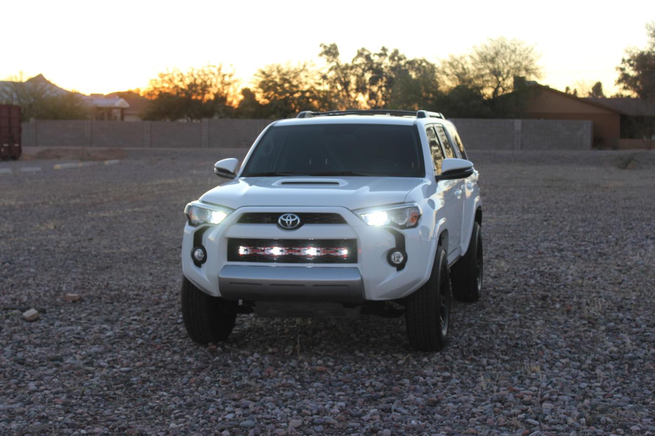

I did my first light project this weekend and installed grill marker lights. I used the Rockcreek method, but switched styles of LED lights. The lights required no modifications and fit nicely into the grill. Hyperlites was the company used. I've used their product on my motorbike in the past.
Thank you. Have a great day.
-NashvegasMike

Link for those lights? I went on their website and can’t seem to find those, or a way to shop hahaha
It truly looks like a good fit

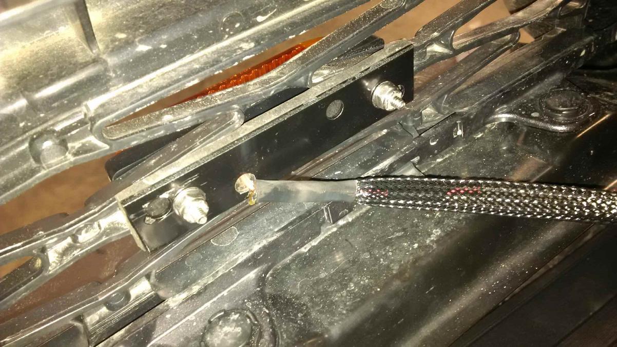

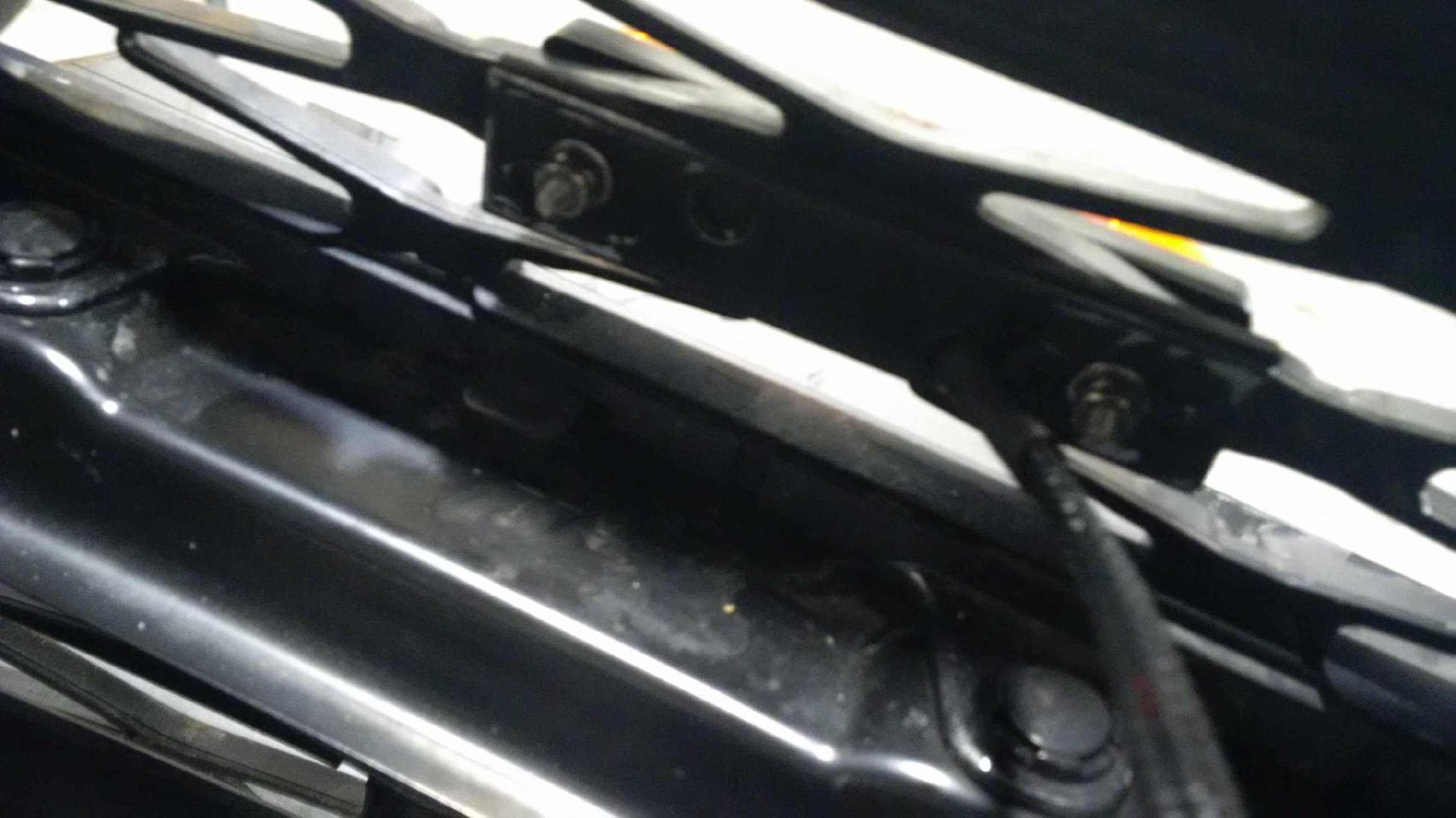

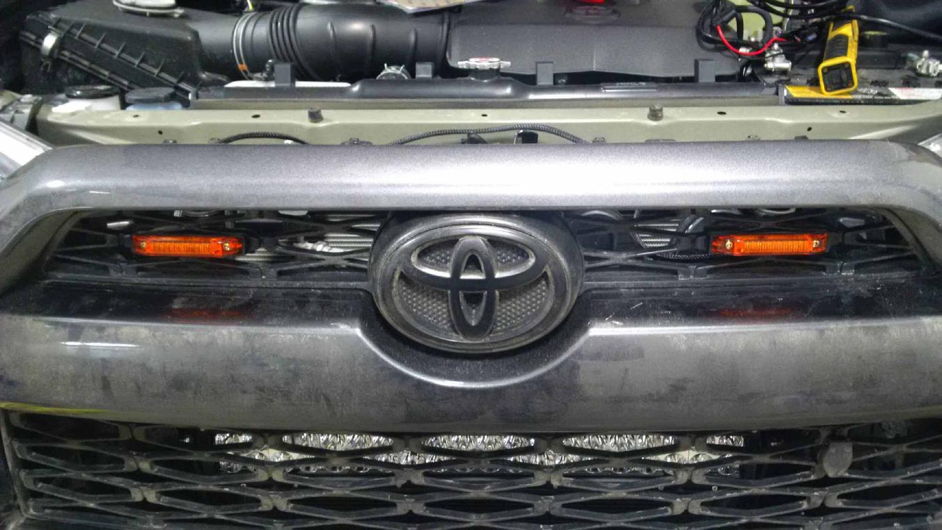

Just getting underway with the grille light mod and wanted to say thanks to [MENTION=121801]swva[/MENTION] for your build idea. Bought that metal backings, painted and prepped them and it made things go smoothly. Soldered the connections instead of taps and then rubber shrink sealed them before running loom on them and another rubber shrink seal. Am going to splice them into the parking light so when it’s dusk/dark and the parking amber lights come on, so will the amber grill lights. Will black out the stainless steel bolt heads once it’s ready to go. Here a a couple pics, nothing great but did get a few. I will post finished pics when it’s all done. Thanks to all for your ideas and inspiration !

I'm glad I was able to help someone out with on this! I hope the project works out well for you. The plates have held up really well on my vehicle. The lights are still rock solid today.

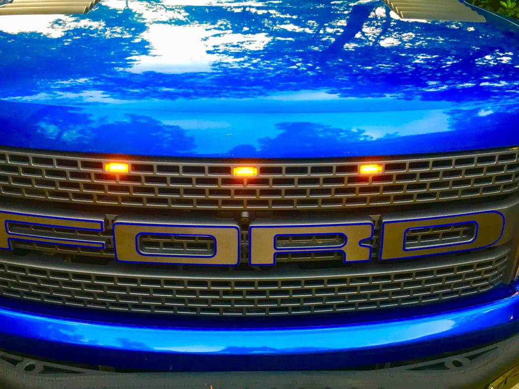

Raptor style LED

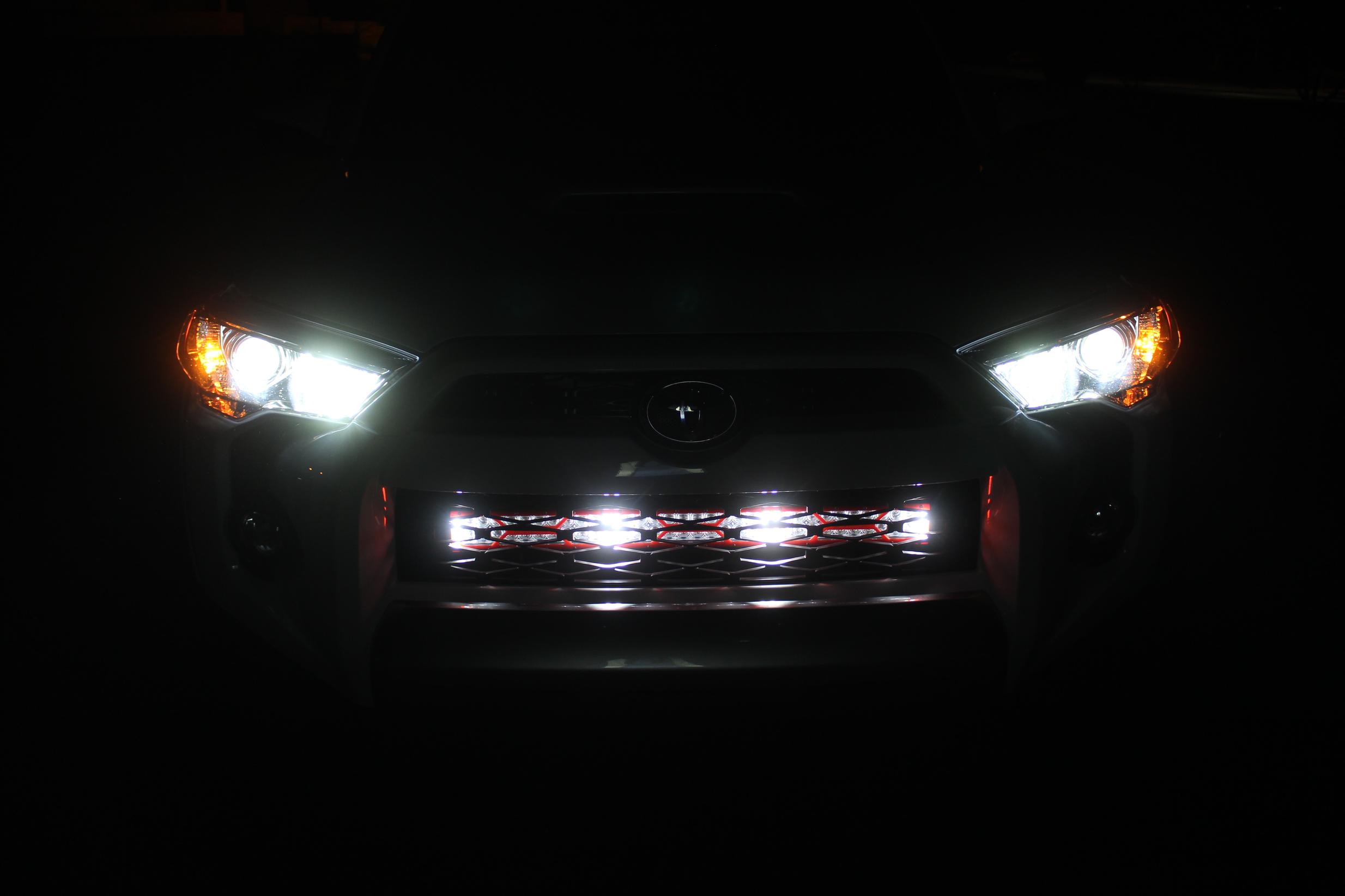

First post. Bought my daughter a TRD Pro. My wife and i both have Raptor’s and really liked what I saw on this thread. However, I wasn't happy with the plastic LEDs bars being used. Found these on amazon and gave them a try.
5 LONG HAUL CLEAR/AMBER MINI OVAL 2 LED DIODES 2" X 3/4" .75" CLEARANCE MARKER TRAILER TRUCK LIGHTS W BULLET ENDS https://www.amazon.com/dp/B00SC2QARK?ref=yo_pop_ma_swf
Very happy with fit and final results! They look very similar to the ones on the Raptor, are bright during day/night and fit securely in the grill slots. Only modification I did was to silicone the lights better to seal them. Alrhough they snapped into the grill and felt secure, I added a littlesilicone on them to ‘glue’ them in grill.

^ Two raptors and a TRDP!!! You want to adopt me? Or can I marry your daughter?! Hahaha
The lights look awesome, great fit!
Not sure which Raptor I like more the blue or the white. I am holding out for the Ranger Raptor for my Daughters as it's a way to sneak another truck into the garage.

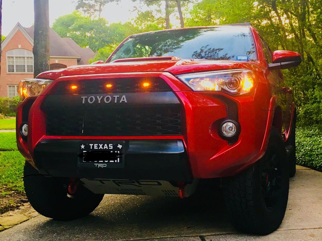

Silver Taco is my sons. Working on Raptor LED for his and will try to install next weekend.

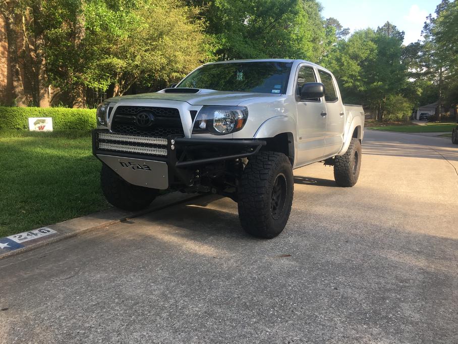

Auxbeam Dual LED function
I ended up going with an Auxbeam LED light bar that had integrated DRLs. Right now they are on independent switches supplied with the light bar.....
I also went with DDM Tuning DRL/HighBeam LEDs and Xenon Depot Low Beam LEDs.
