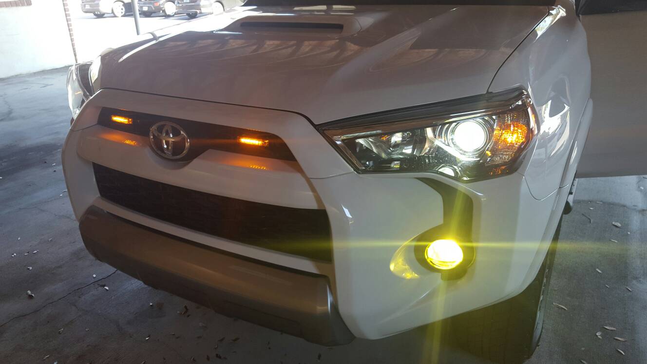

Installed mine today. However, being unfamiliar with my 4Runner still, I spent all this time trying to t-tap the blinker. Luckily I'd tested and found the constant 12V so the grille lights are on during all stages of the multifunction switch, even when the blinker is pulsing. However I tested all the lighting situations I'd be in and the "blinkers" are always on when the parking lights are on, so the end result is the same. However when I upgrade like parking lights to led (lol since I just discovered I had actual parking lights today), I'll move the t-tap if I need to. 20170108_135346.jpg20170108_135441.jpg

Installed mine today. However, being unfamiliar with my 4Runner still, I spent all this time trying to t-tap the blinker. Luckily I'd tested and found the constant 12V so the grille lights are on all the time, even when the blinker is pulsing. However I tested all the lighting situations I'd be in and the "blinkers" are always on when the parking lights are on, so the end result is the same. However when I upgrade like parking lights to led (lol since I just discovered I had actual parking lights today), I'll move the t-tap if I need to. View attachment 233658View attachment 233659
my thread explains which wires you can tap into that are for your marker lights.
Ahh okay cool found your thread. I was able to reach the same conclusion with my multimeter. I was merely thinking it may have been much easier to tap the marker light instead.

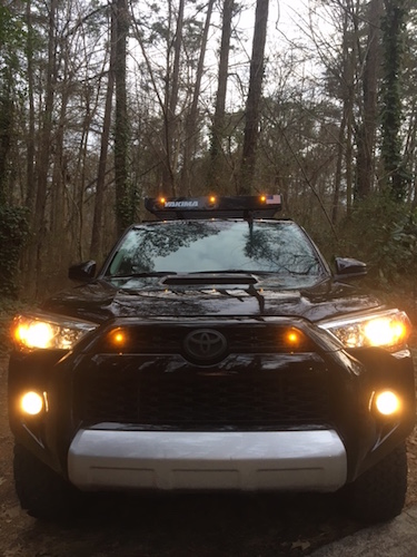

Fun little weekend project. Oznium LED's front grille hooked up to fog lights and roof rack hooked up to on board lights on the fuse box inside on the driver's side. For some reason my DRL's won't come on now. Work in progress..

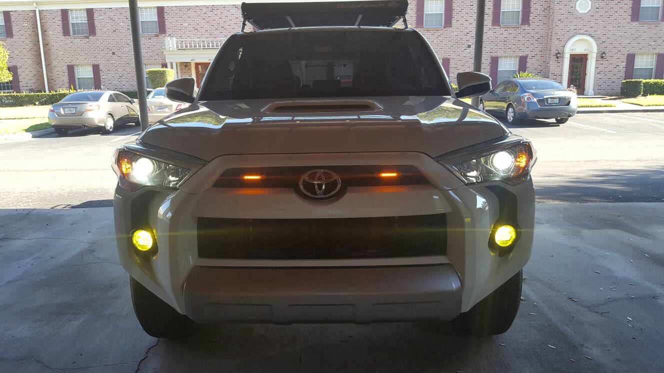

I have a few questions about this mod.
What wire color are you guys tapping into to power the grill lights with the turn signals?
Do your grill lights flash with the turn signals during remote lock and unlock? Do they blink with your turn signals?

green wire to the marker lights.

So just run my red wires from LEDs to green wire on 4runner headlight and ground my black wire from LEDs? That's it?
