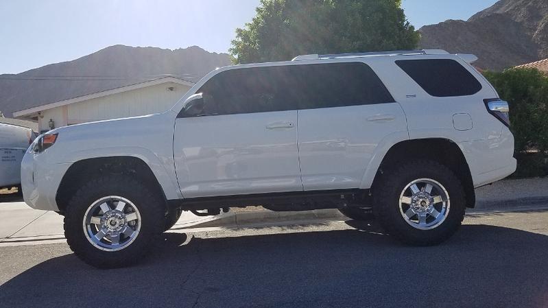

New Limited Change to 18's Need Help

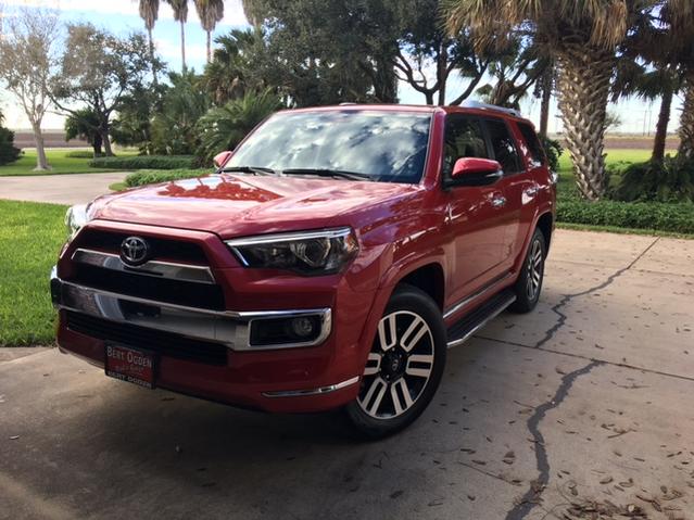

Have a new limited. See pics. 5th generation with 20" 245 60 20's.

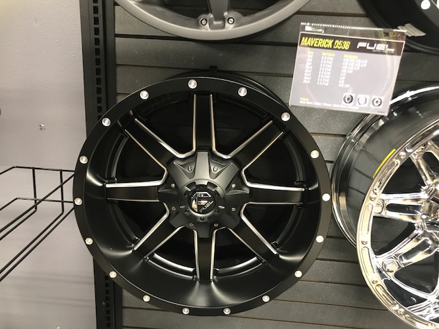

Want to change to 275 65 18's using a Fuel Maverick Rim 18X9.
4runner shop say +20 offset.
Would like to use a Toyo AT II
DO NOT WANT TO LIFT!
DO NOT WANT RUB!
What Offset.
Any comments please, i.e, any other tire size that will give a more comfort, performance, and look more appealing.
If anyone has a good idea on wheels or tires please go for it. Only thing I do not want to do is LIFT or have RUB. Wheels and tires only.
I chose Toyo because they are supposed to be easy riding and quiet and do not have too much of an extreme look. If you have a better idea I am open for suggestions.
Thanks in advance for any help. Am new to this forum and it is my first runner.

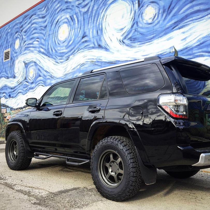

17x8.5 Method NV et0
Cooper Discoverer ATP 285/70/17
Had to do the front fender liner mod and removed mud flaps to avoid rubbing

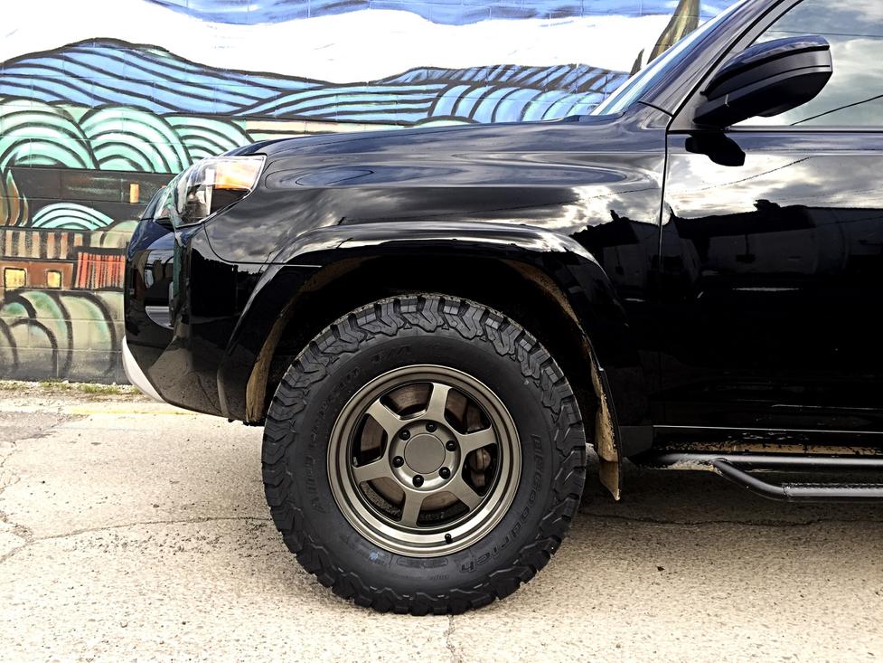

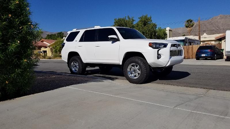

stock suspension but wanted to try these on from my old vehicle and thought id share fitment pictures with the offset compared to the fenders.
17x9 scs f5 3.5 backspacing with 285-70 duratracs
The rig looks great! I was hoping to see 265/70 BFG A/T's on a stock setup to see if it looked alright without a lift and it does! Also, did your step-up bars come ready for installation or was there fabrication needed?

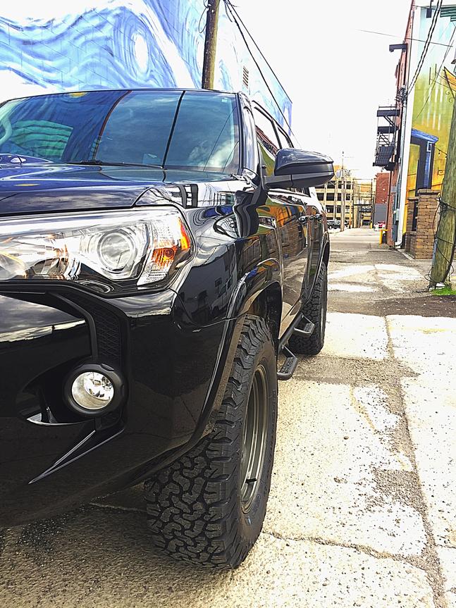

Thanks man! The side bars are from N-Fab and they were a direct bolt on replacement. No modification at all needed. installed them both by myself in about 45min. Also the wheels I have do make the 265s seem beefier than stock wheels due to the 8in. width and -10 offset. So they stick out just the slightest compared to a stock wheel. I just got the Bilstein 5100s installed a couple weeks ago at the .85 setting in the front and 5100s in the rear at stock height. Used all stock springs and coils. I will post pics when I have a chance to transfer photos.

285/70/17 AT KO2's on 17x9 Black Rhino's. No rubbing after removal of the flaps and a tad bit of trimming.

As for the bilsteins with stock springs/coils It feel very similar ride to the stock ride. One thing I did notice right away was less body roll on turns and less nose dive when stopping. It's for sure an improvement. Also something to take note on is if you are using the stock coils in the front, The higher you go, the stiffer the ride gets.. So .85 is one notch above stock height so slightly stiffer. The 1.75 will stiffen the ride more and so on and so on. I have only done minor wheeling with them last week and they performed great for my needs. Very solid construction/quality shock. I recommend them. Amazon sells them cheap. I got all 4 shocks for around $383 shipped. It sits just like stock but a tad less rake.(still retains very slight forward rake at frame) With just enough lift that it looks a little more aggressive. Which is exactly what im going for since it is my daily driver. Just looks a lot more proportionate now. Especially with the wheel setup.
