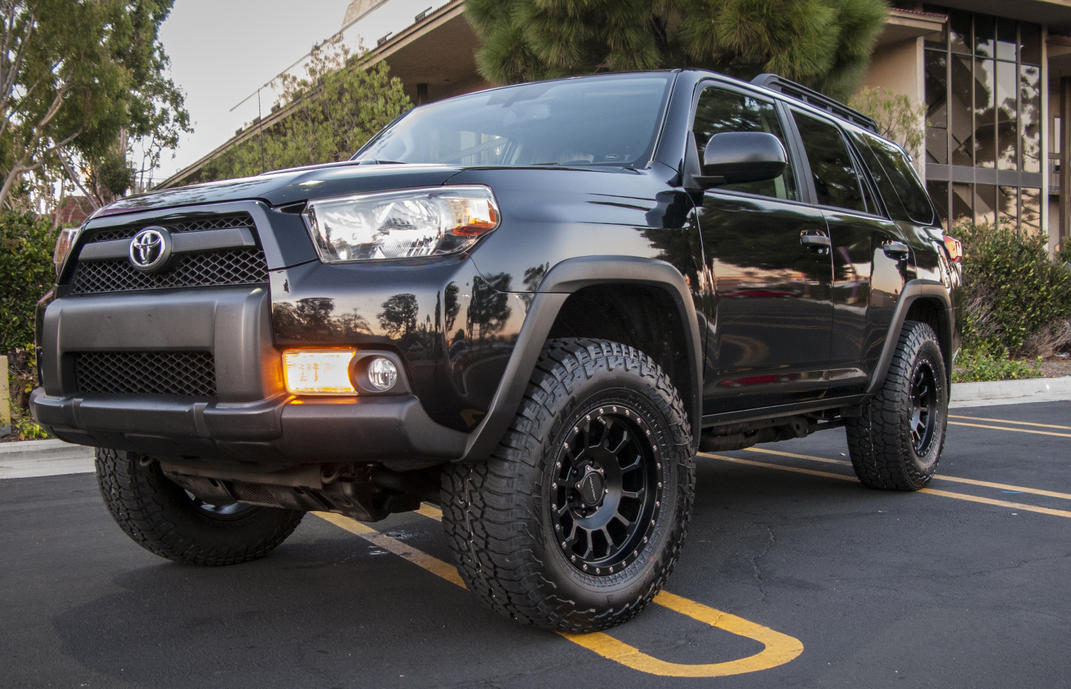

Wheels: Micky Thompson Sidebiter II 17x9 0 offset
Spacers: 1.5 wheel spacer, cheap ebay stuff
Tires: Falken Wildpeak AT3W 285/70/17, E
Suspension: ICON Stage 1, with 3" overland spring. With some JBA UCA. And two 1/4" shims to add another 1" to the 3.5 from Icon. So that make a 4.5" front and 3" rear lift
Body Mount Chop: None
Tire rub: only rub when I reverse. No rub at all on road or off road.
Trimmed: about 1/4" from front bumper.
Mud flaps: Removed fronts for now, they were rubbing little bit.
Great looking truck!! How do you like those Falken Wildpeak AT3W tires? I just bought a new 2017 and I'm thinking that the tires that came on it aren't good for off roading. Any information would be great. Thanks!!

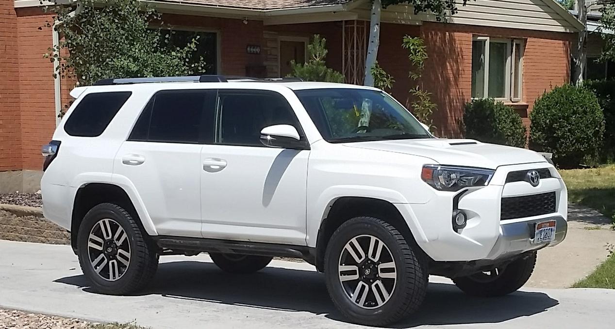

275 60 20's on LTD wheels. For street duty. 33.1" tall. I have 285s on Trail wheels for playing in the dirt.

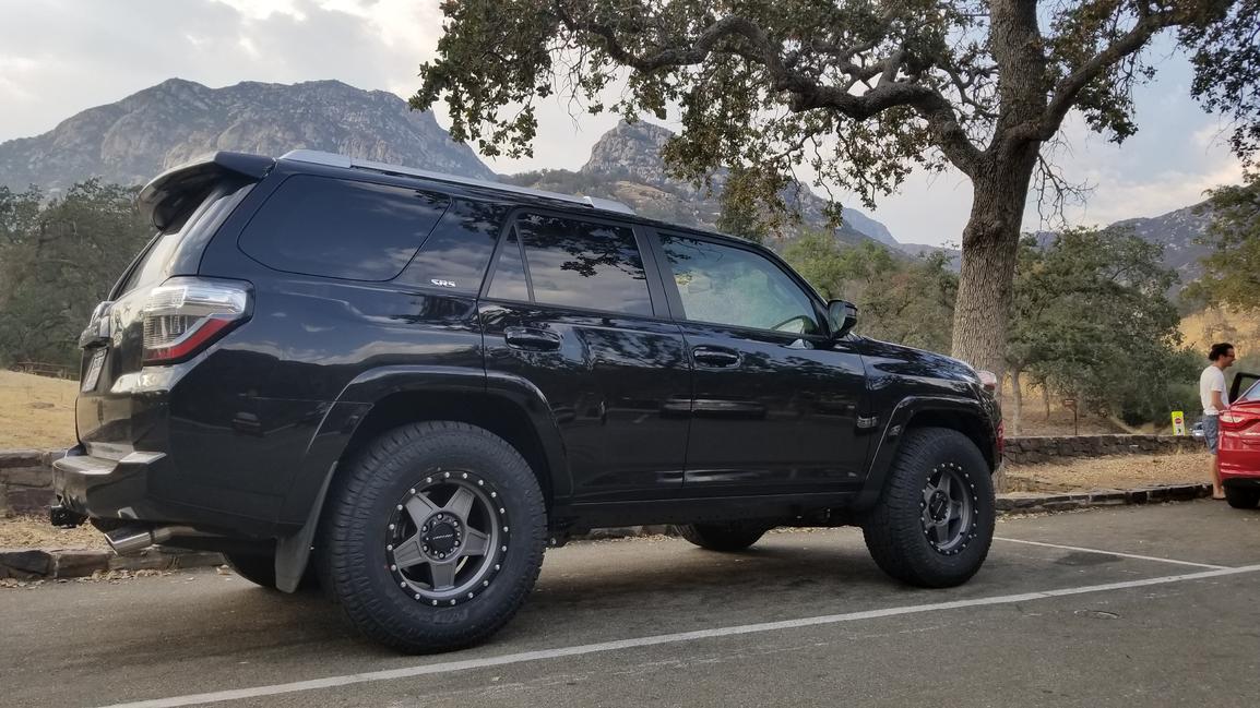

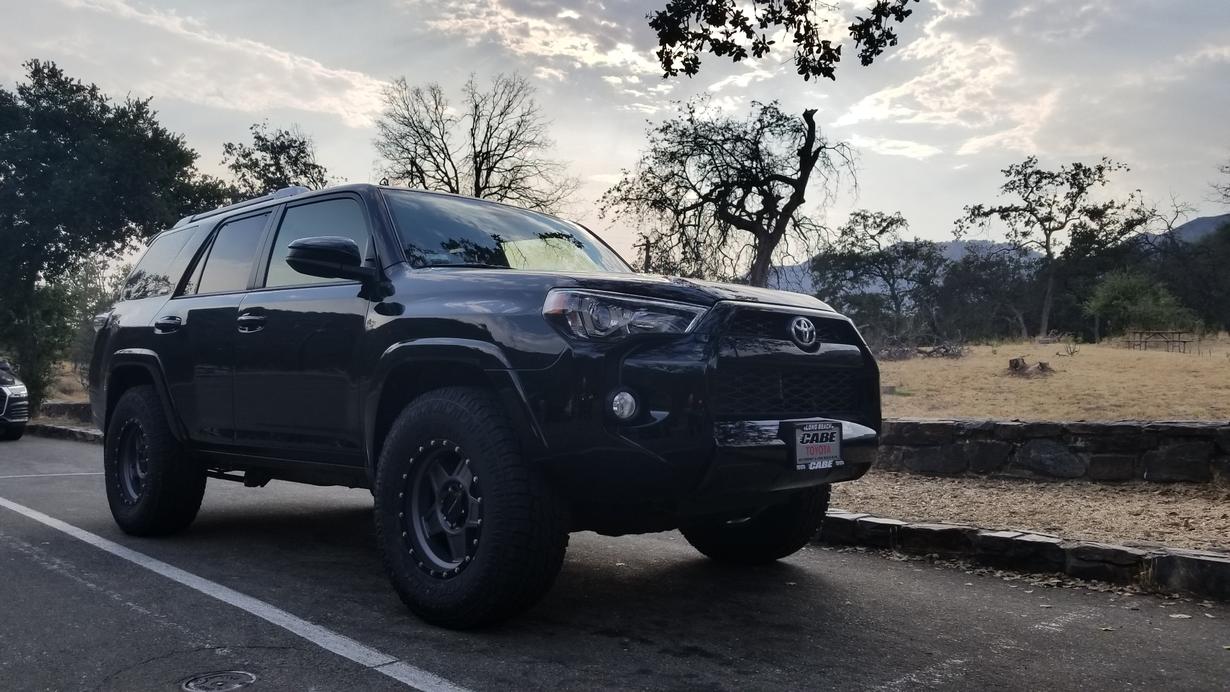

Mounted these Procomp predators on my rig last Friday and took a trip to Sequoia National Park to test her out. The 285 definitely robs the truck of power but it's still very doable. I averaged 16.7 MPG for the entire trip and 15 MPG while climbing the mountains. Overall I like the look without a lift but I know these aren't as capable off-road. Getting my temporary lift put in this weekend, going with the 6112/5160 combo. Also getting pretty bad rubbing on full lock in reverse and going to have to modify the fender/liner.
Rob
They are pretty great off road!! Got them 10 ply, air down. great on rock, dirt, sand and we will see about snow soon.

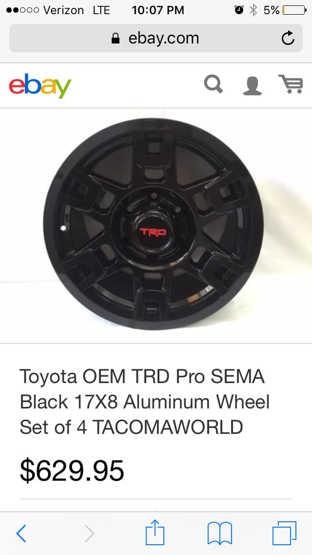

TRD sema
I am no wheel aficionado, but love the TRD Sema rims. I have the stock T4R rims(17"x7"). Will the tires that came with these rims fit on the Sema (17x8)?
Also are the rims on eBay OEM, or are they FN with a TRD cap on them?
Old post but OEM are only 17x7 not 17x8. It is anyone's guess if they are FN's. Can't remember a FN price for the set off hand.
Also I can't for the life of me figure out why they made OEM "pro" wheels in 7" instead of 7.5 or 8.
