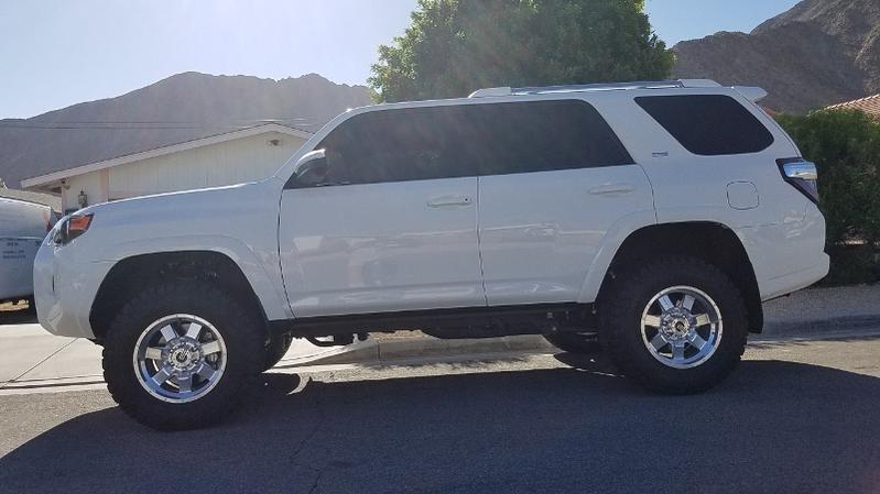

4.5/3 lift
Wheels: Micky Thompson Sidebiter II 17x9 0 offset
Spacers: 1.5 wheel spacer, cheap ebay stuff
Tires: Falken Wildpeak AT3W 285/70/17, E
Suspension: ICON Stage 1, with 3" overland spring. With some JBA UCA. And two 1/4" shims to add another 1" to the 3.5 from Icon. So that make a 4.5" front and 3" rear lift
Body Mount Chop: None
Tire rub: only rub when I reverse. No rub at all on road or off road.
Trimmed: about 1/4" from front bumper.
Mud flaps: Removed fronts for now, they were rubbing little bit.

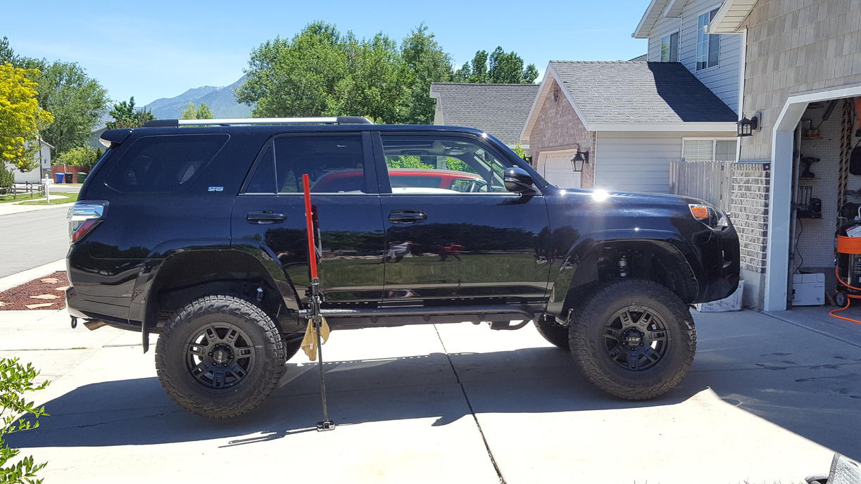

Yesterday I finally upgraded my wheels and tires from the stock SR5 wheels and stock size BFG AT KO's. Couldn't be happier with the outcome!
Thanks @VTXOffroad for the wheels, they look badass.
Specs:
VTX Offroad Viper's 17" x 8.5", Satin Black
Toyo Open Country AT2's LT285/70/17 Load Range E

How does it look when not on a high-lift jack?

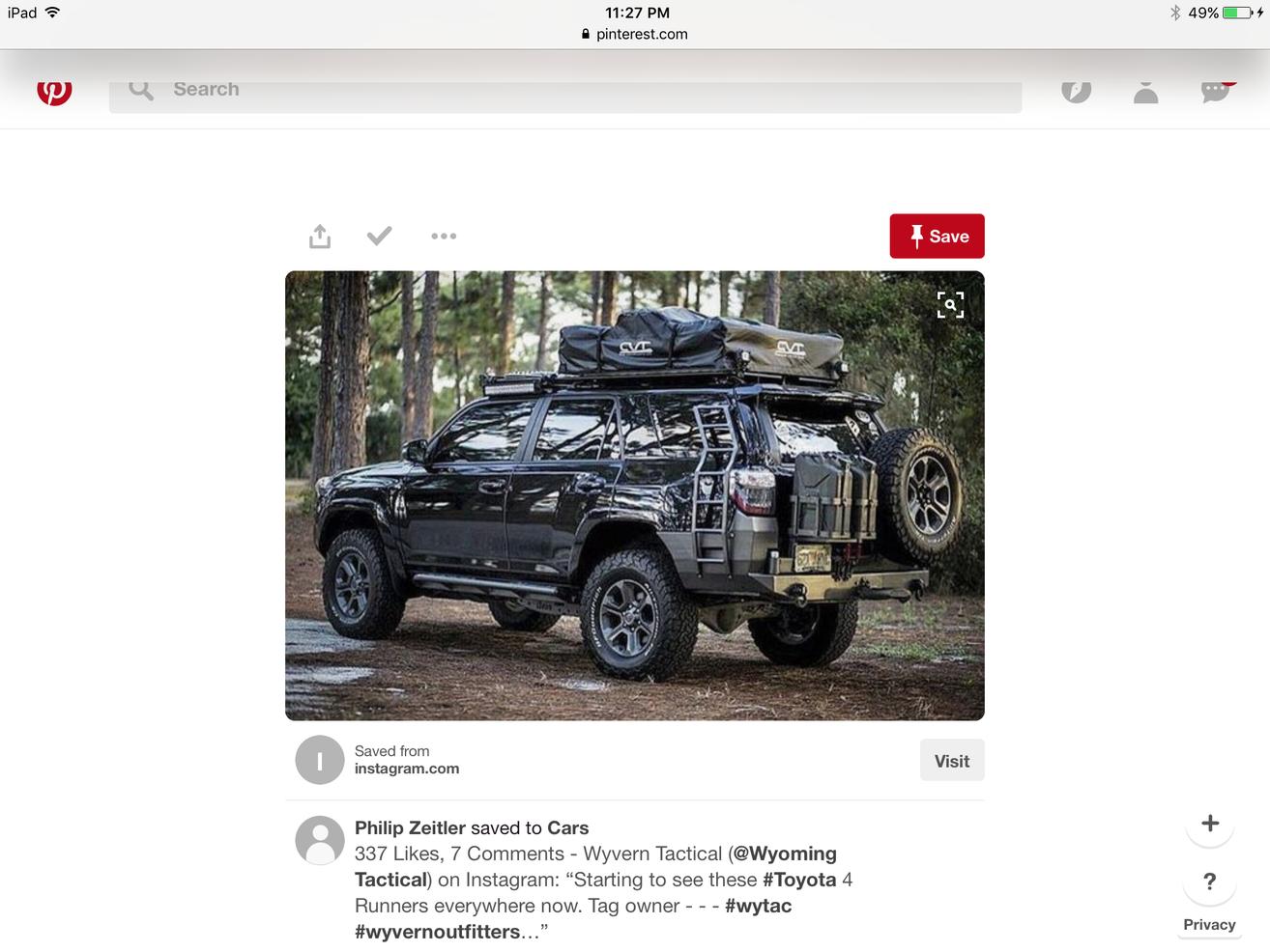

Hope this works, I found this picture on google. Can anyone tell me what these wheels are? Perhaps factory sr5 wheels painted? Thanks

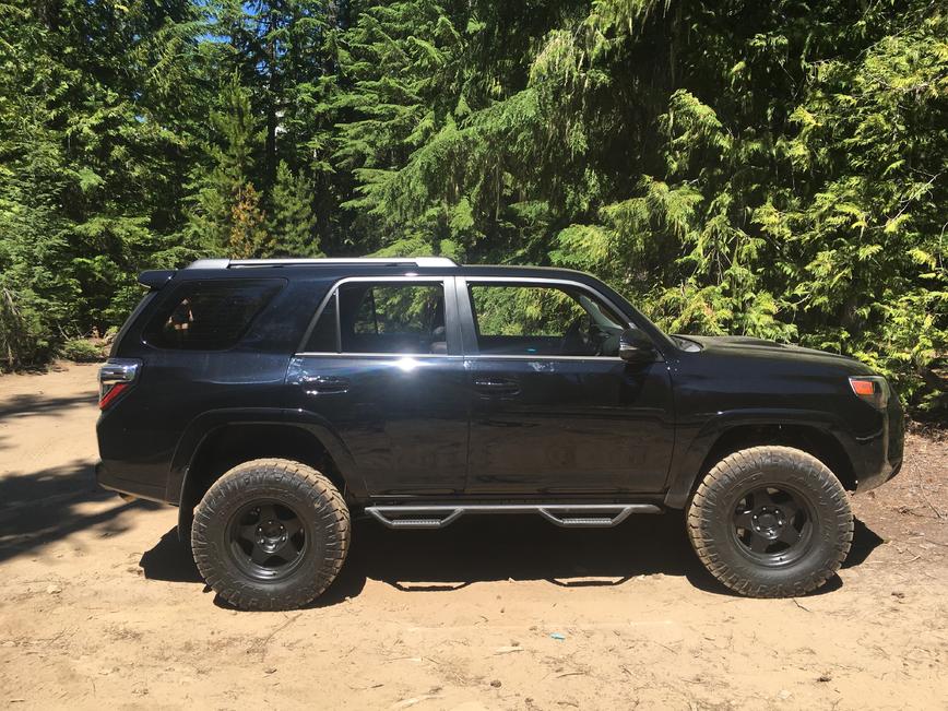

Here's my SCS F5. I love them! The only wheel I considered and I got them on the first attempt .
