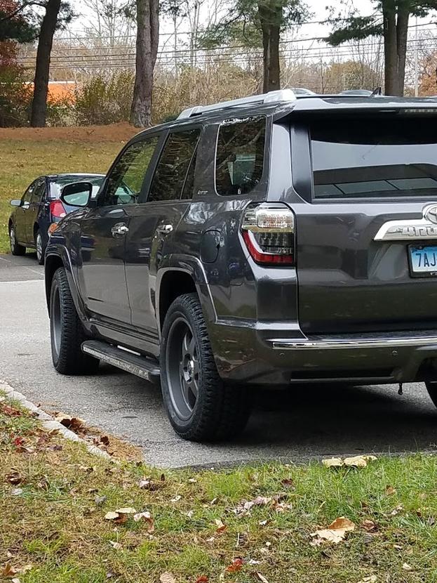

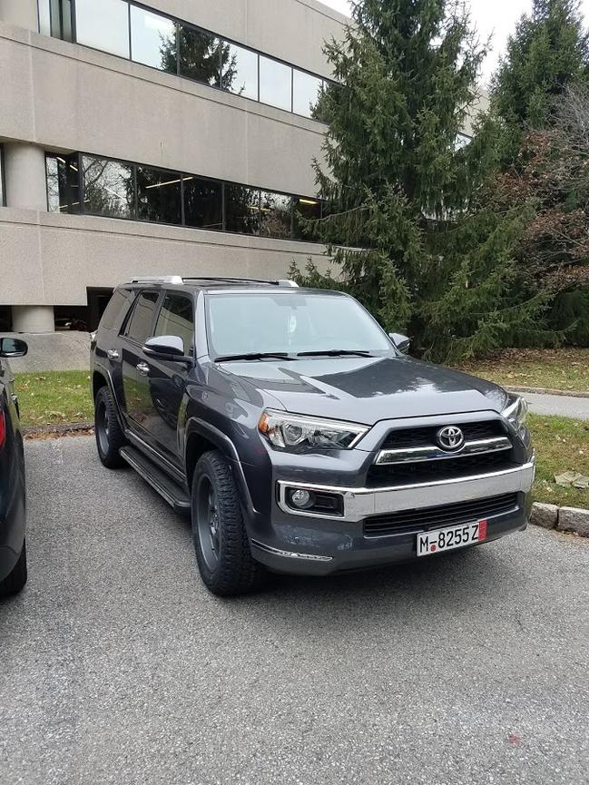

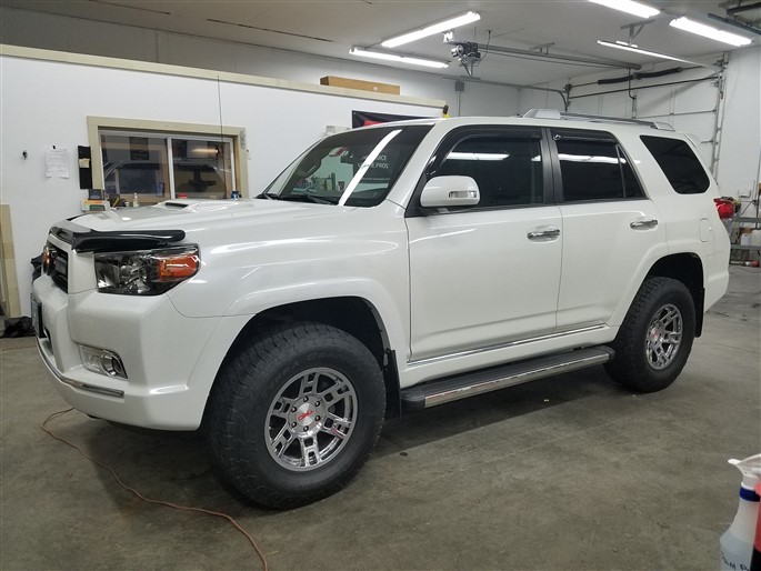

5th Gen Wheel & Tire Thread
Volk Racing Te37s
18x9+0
BF Goodrich All Terrain T/A KO2s
285 / 65 / 18
Front bumper trimmed.
Slight rubbing on front mudflap.
Stock Height - still deciding on lift.
Looks good!
--Nate

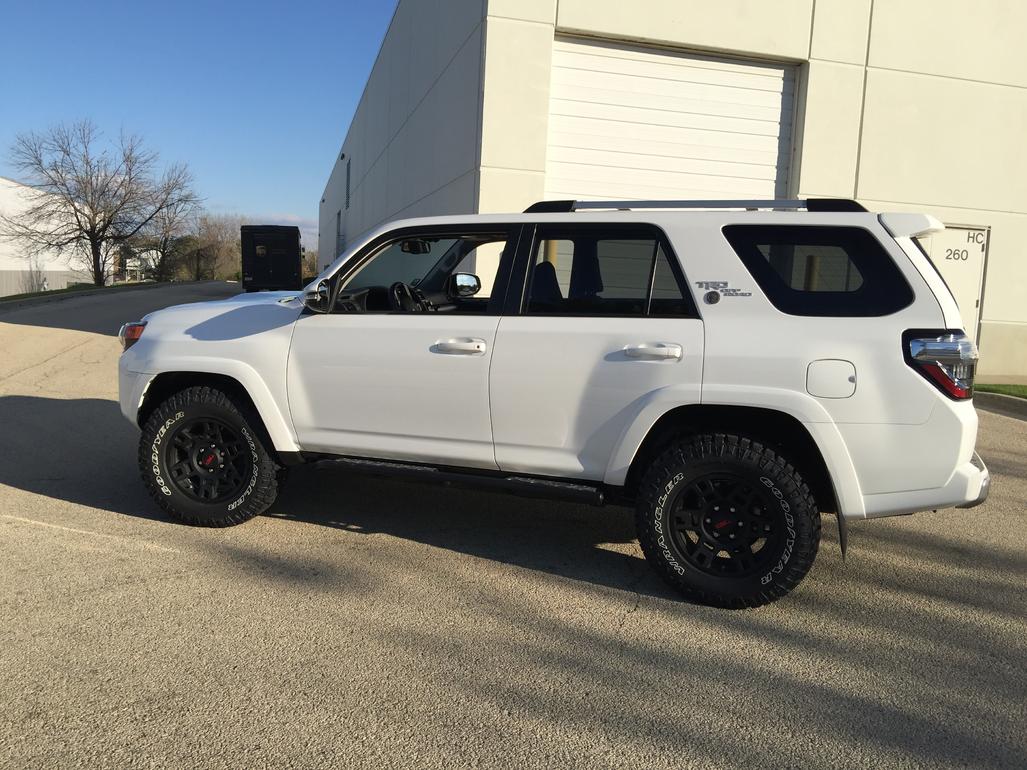

I have the same 2017 off road.
I went with volk te37s 18x9 + 0 offset
with 285/65/18 KO2s on stock suspension.
I just pushed the fender liner back and trimmed the front of the bumper maybe a 2-3 mm and i have 0 rubbing.
No issues in the rear at all.
2 inch level front spacers

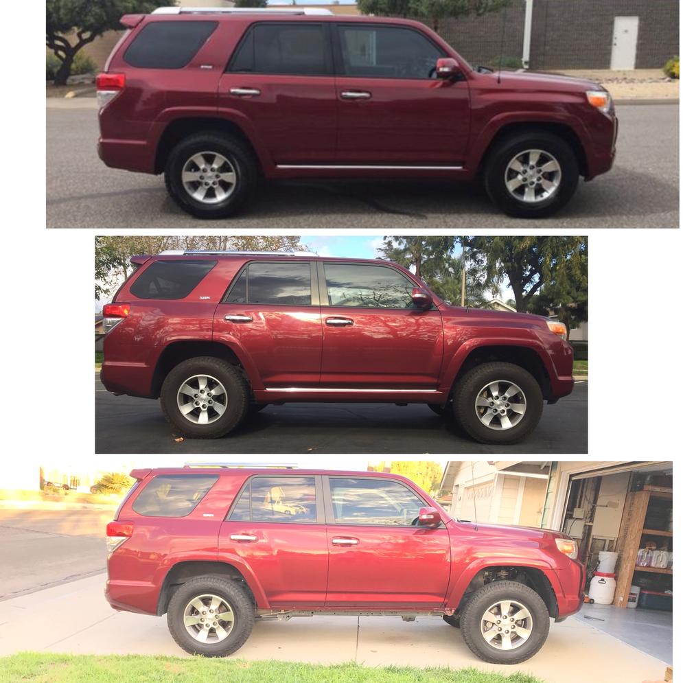

Need some opinions on this first pic is stock middle pic is after 2 inch kit and third pics is when I took of th rocker panel moldings let me know what you think about my truck it’s a budget lift and next will be the tires

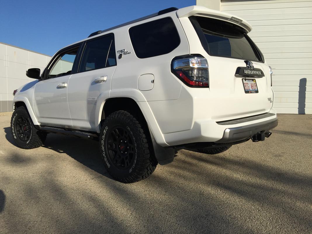

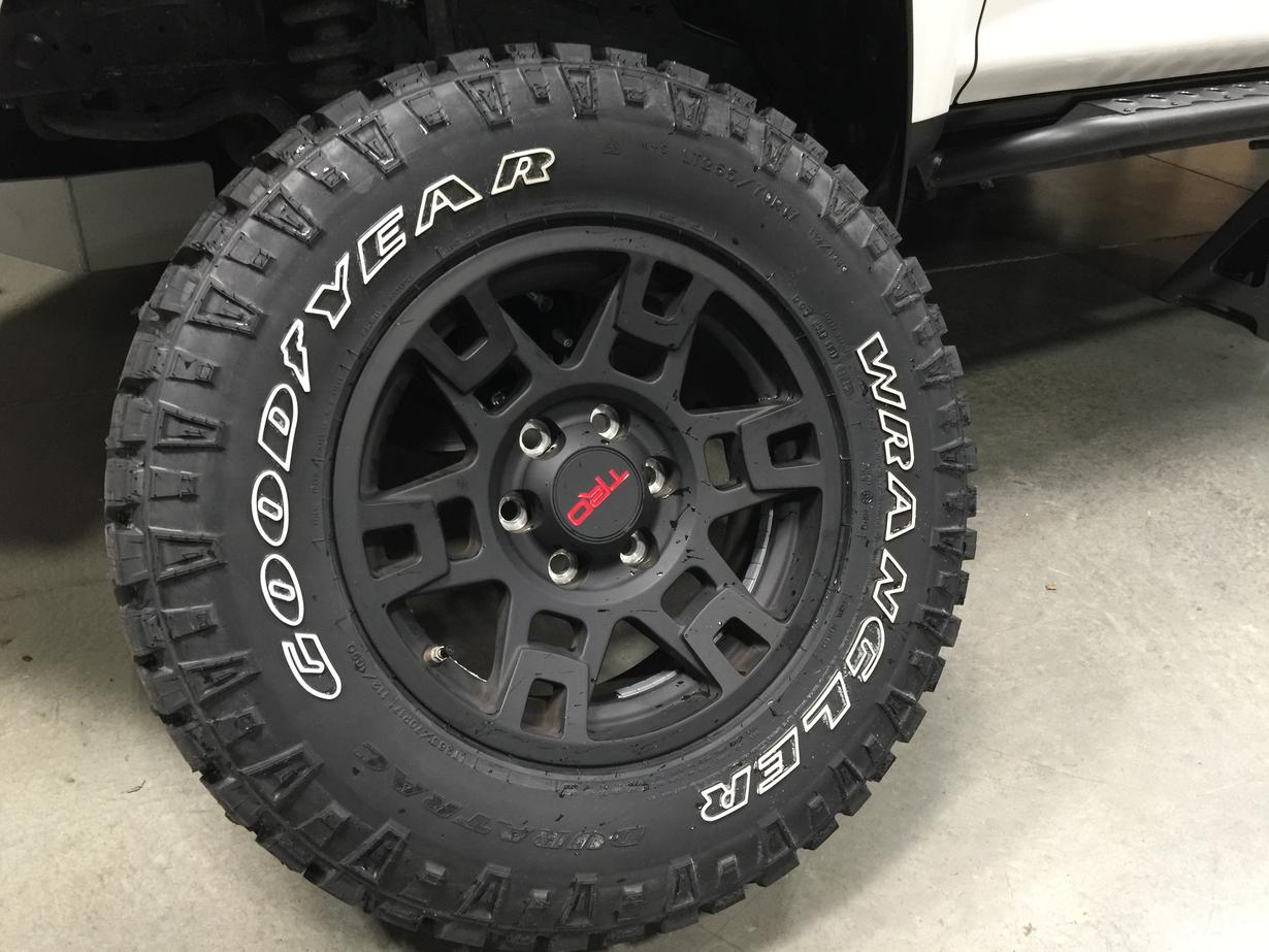

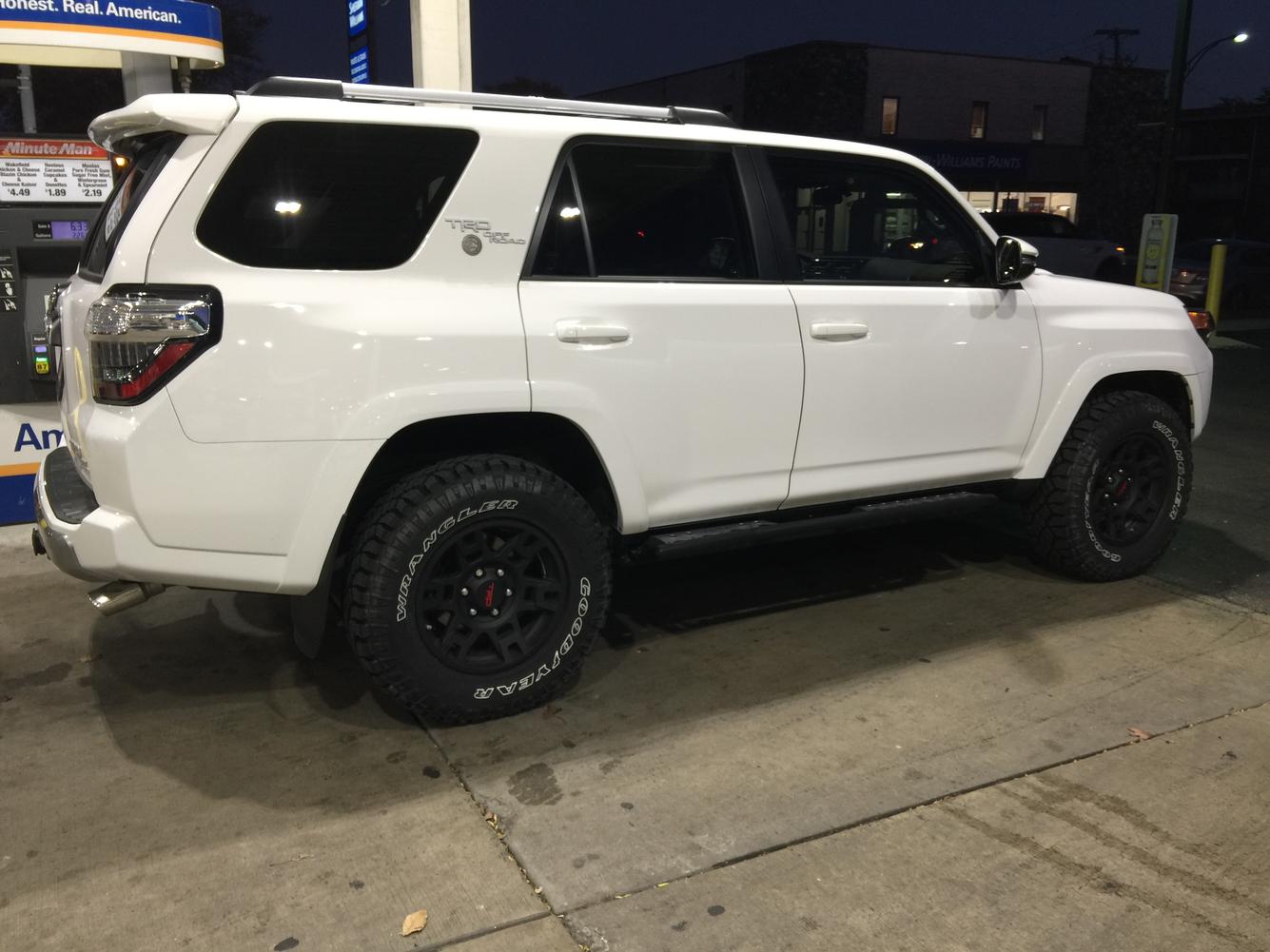

265 Duratracs on Pro wheels with spacers, no lift.
Wheel: TRD Pro 17" Matte Black 17x7 with 4mm offset
Spacers: BORA 1.25" spacers
Tires: Goodyear Wrangler Duratrac OWL C series 265 70R17
Suspension: Standard KDSS
No body mount chop, but we did relocated the fender liner and trim the front bumper and remove the front mud flaps, which I am going to modify with a heat gun. No rubbing now.
