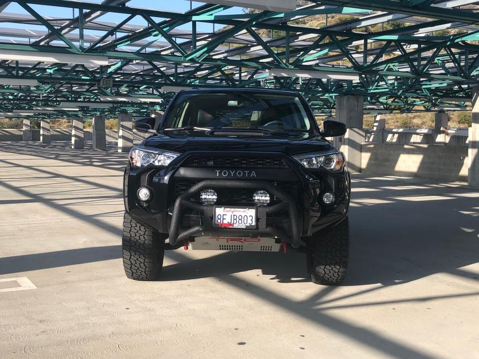

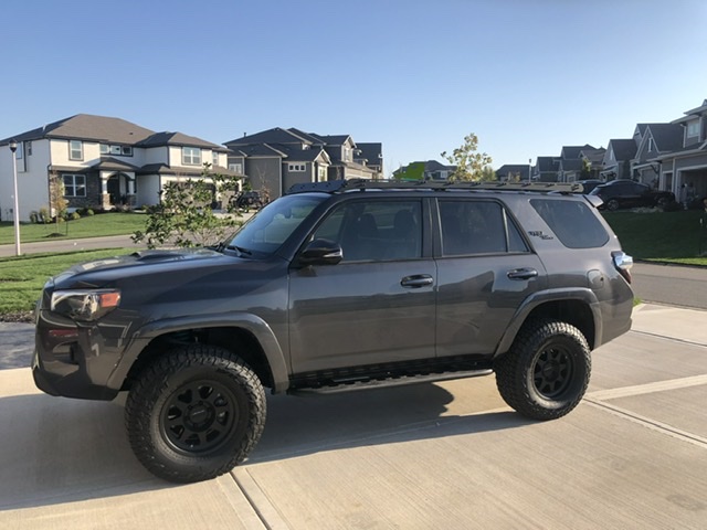

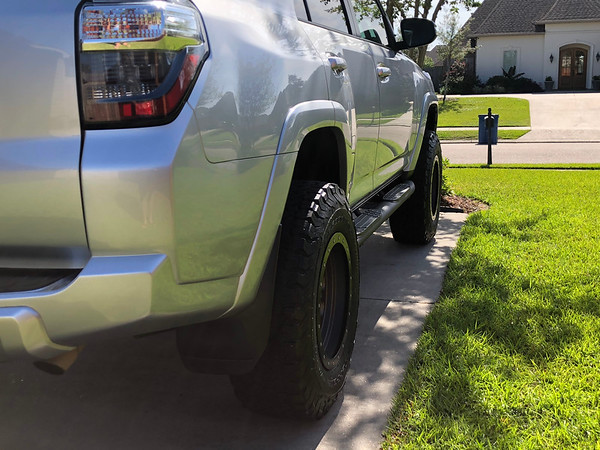

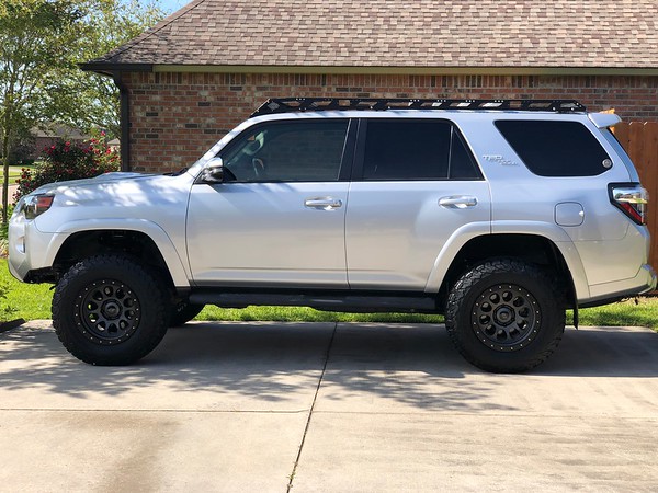

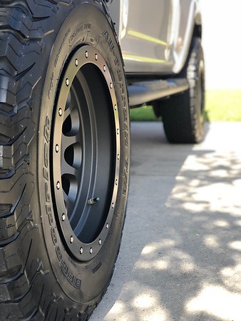

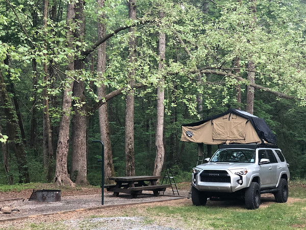

5th Gen Wheel & Tire Thread
2017 TRD ORP
3” OME lift
2884 friont coils
2889 rear coils
SPC upper control arms @ +2 deg caster
SCS Ray10 17x9, 3.5” bs, -38 offset
BFG KO2 285/70/17

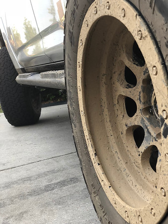

Wheels are SCS Ray 10 in matte gunmetal. These are the 17x9, 3.5” backspacing, -38 offset. Its comparable to running their 17x8.5 -10 WITH a 1.3” spacer. I had to remove the mudflaps and do a very aggressive BMC(thanks SSO), and I opted to do a conservative high clearance type cut on front bumper and well liners. No rubbing on or offroad after BMC.
...also look good in the North Georgia Clay color combo...
Update: I switched out the KO2s for KM3s. I got about 80000 miles on the KO2s. They still looked fine, but had gotten a but dicey at highway speeds in the rain.
285/70 KM3 - same size as KO2s I had run but the side lugs make them “appear” much wider. I started getting some grabbing on the rear of front fender liner at full lock during hard stops and had to move the liner back with a heat gun.
Also swapped rear springs to OME 2898(440lb additional constant load) after mounting an ultraswing and full size spare. There was already a 50ltr dometic fridge, about 70lbs recovery gear/tools, and the 3/4” birch floor plate I installed for the fridge slide.

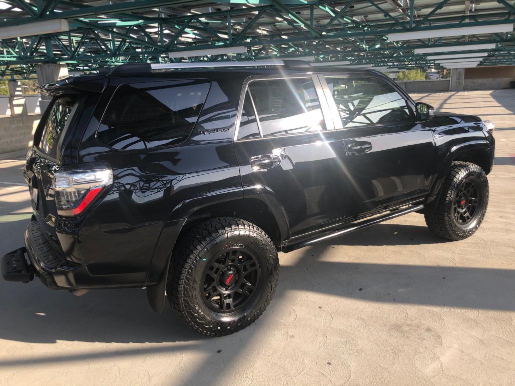

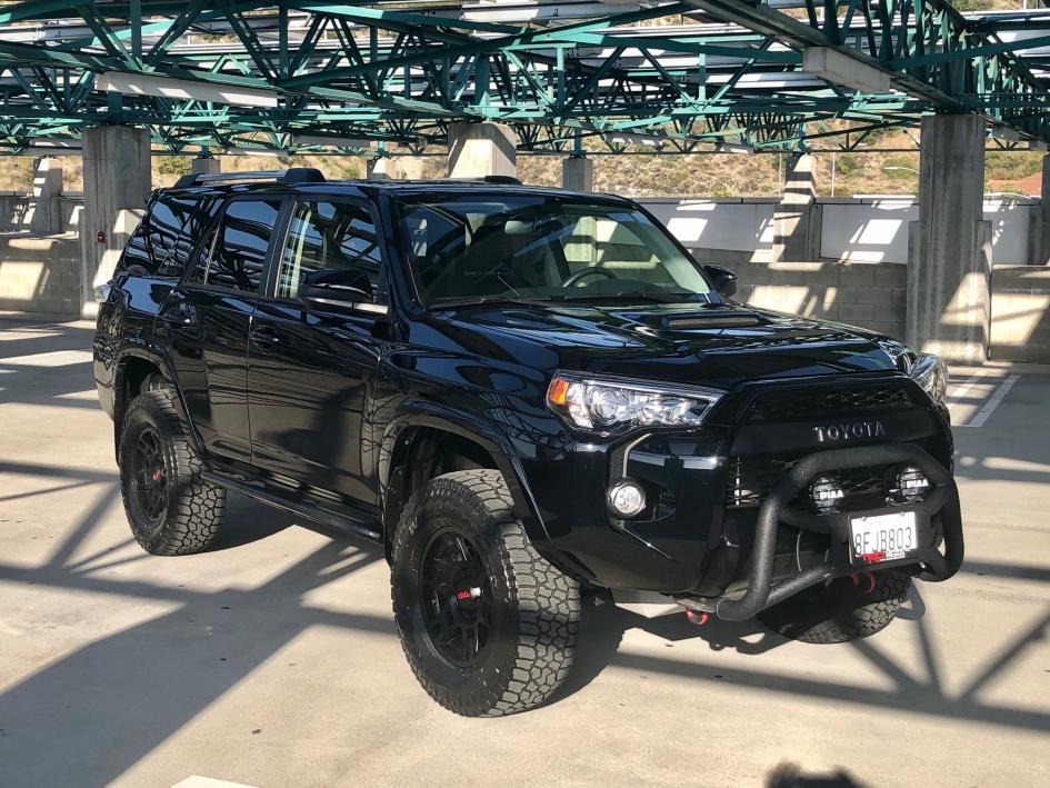

I had new Falken Wildpeak SL AT3W’s in 285-70-17 installed on Saturday. I replaced my 275-70-17’s. I had a 1.5/1” spacer lift on my Pro prior to the 285’s and everything seems to clear even with minor articulation.

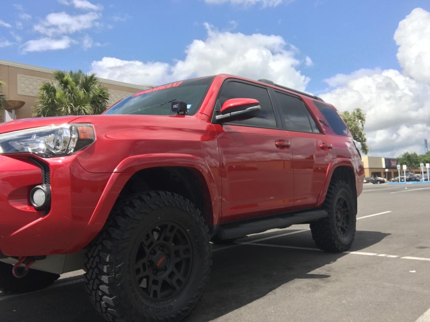

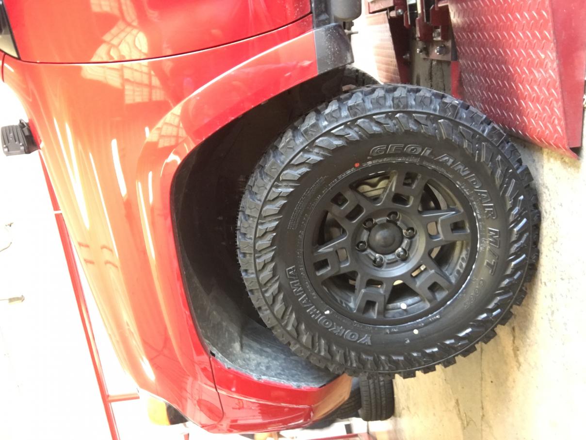

Royal Guard

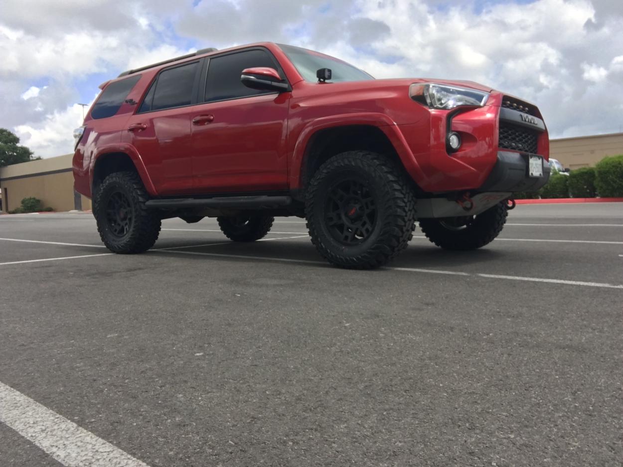

Just got new tires
Yokohama Geolandar M/T
285/70/17
Pro wheels
3 inch Rough Country Lift
No rubbing

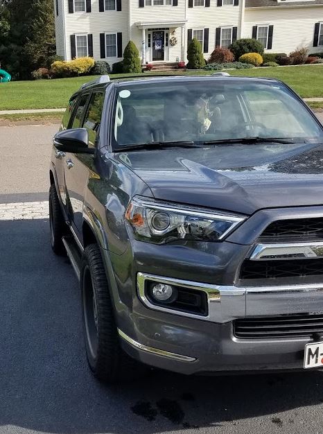

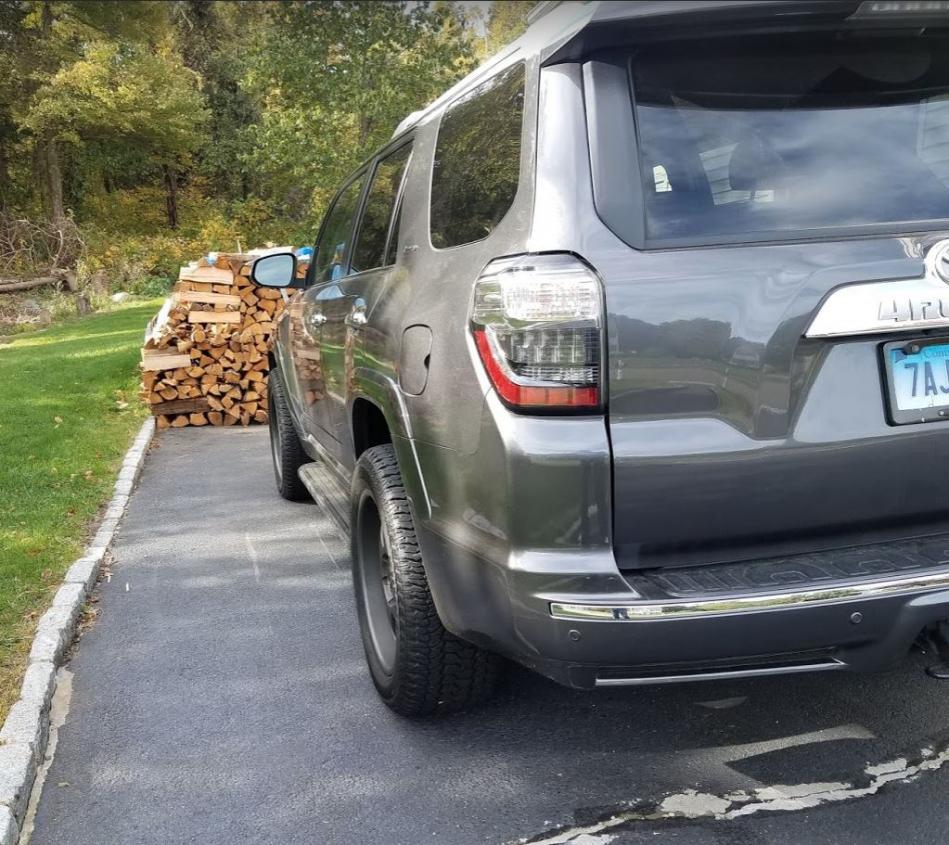

Here are some updated picks of my Enkei ST6 20 x 9.5 ET10 with some spidertrax 1.25 inch spacer and no lift.
I have no rubbing issue in the back.
In the front I had to remove the mud flap and push the fender liner forward.
There is a small piece where i am still rubbing where the mud flap used to bolt on, which I would probably need to trim, but I will also look at the possibility of being able to push it back with a zip tie
The weird thing it rubs only when in reverse on full lock. anyway here are some picks.
Do you guys think it is too aggressive or looks good? I was going to go with 1" spacers in the front and probably would had no rubbing but the company stopped making them, so I just went with the spidertrax spacers
I think your rig looks great! My previous limited looks really similar to yours but in a different color on the enkei blackhawk wheel. I like the way they sit without the spacer TBH but its only a personal taste.
