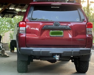

Thanks. Any pics from front or rear?
here is one from the rear favoring the driver side. these tires are over an inch narrower than my 285/70/r17 MTR’s. These are a great winter tire.
pushing these out 1.25 more would definitely get your tires flush or close to it with the top of the fender.
