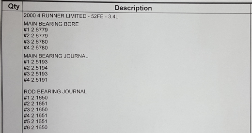

So, my machinist measured the crank and main bores, and gave me the measurements (block stamping were rotted and could not be read). The machinist said, "get Mark 3 bearings across the board." So, I called Toyota and they have No.1 Mark 3, No.2 Mark 3, but no No.3 or No.4 Mark 3 bearings. Do I order (1) No.1 Mark 3 and (3) No.2 Mark 3 bearings? I know some say use Taiho Standard bearings, but what is the measurement of those standard bearings?
Here are my measurements for reference that the machinist measured:

I know The YotaShop sells Taiho Bearings (which are the same ones Toyota uses), but their website just says STD, 0.10, 0.20, and 0.30 sizes. I'm curious what STD (Standard) size is for these bearings?
