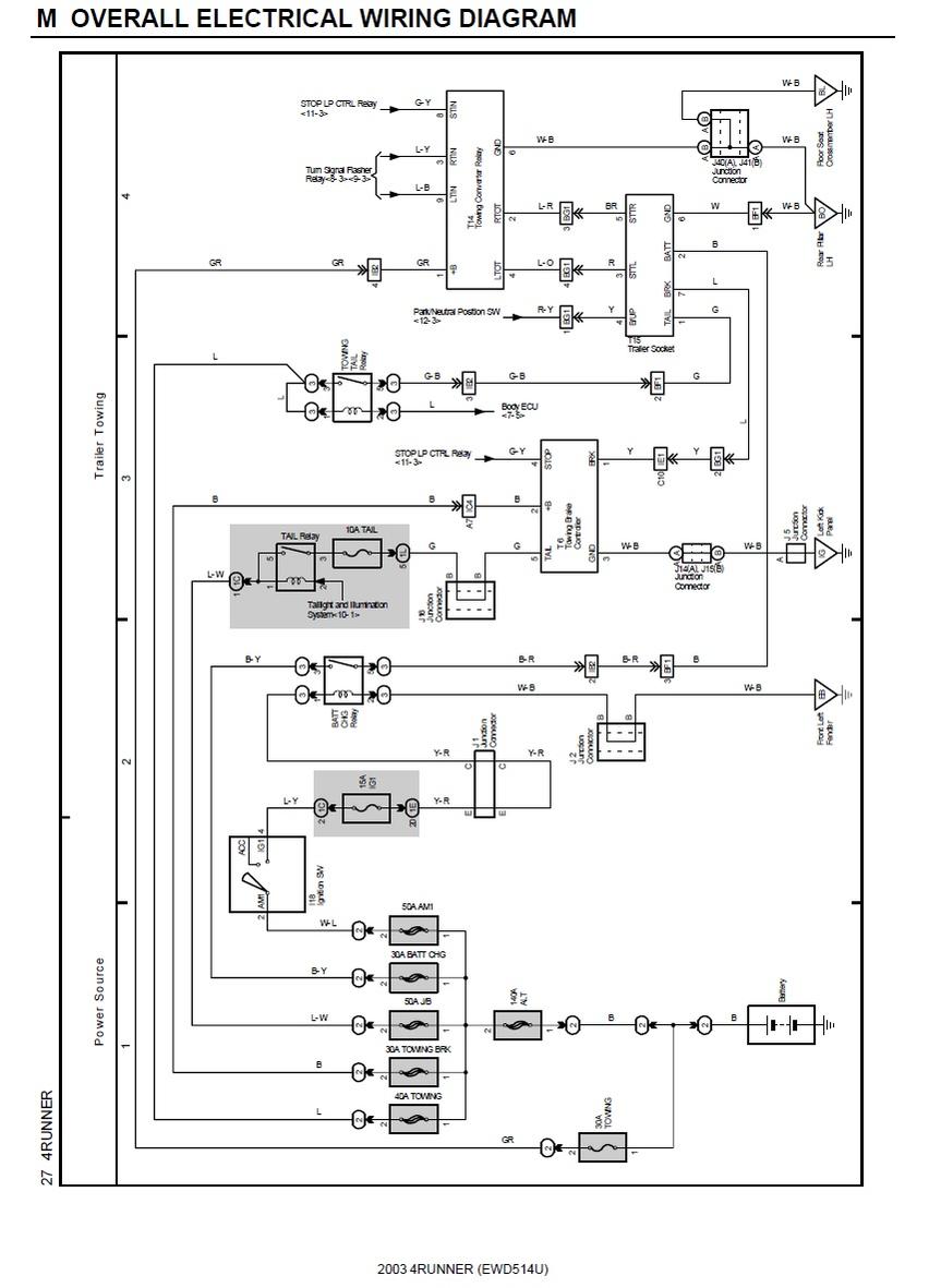

Here's the wiring diagram. Looks like you have 40 amps at the tail-light terminal and 30 at the battery charge terminal, if I read the diagram and fusing correctly. Anyway, should be plenty for your lights.
Also, from another page it looks like the backup light circuit is fused at 15 amps, but that includes the existing backup lights as well.

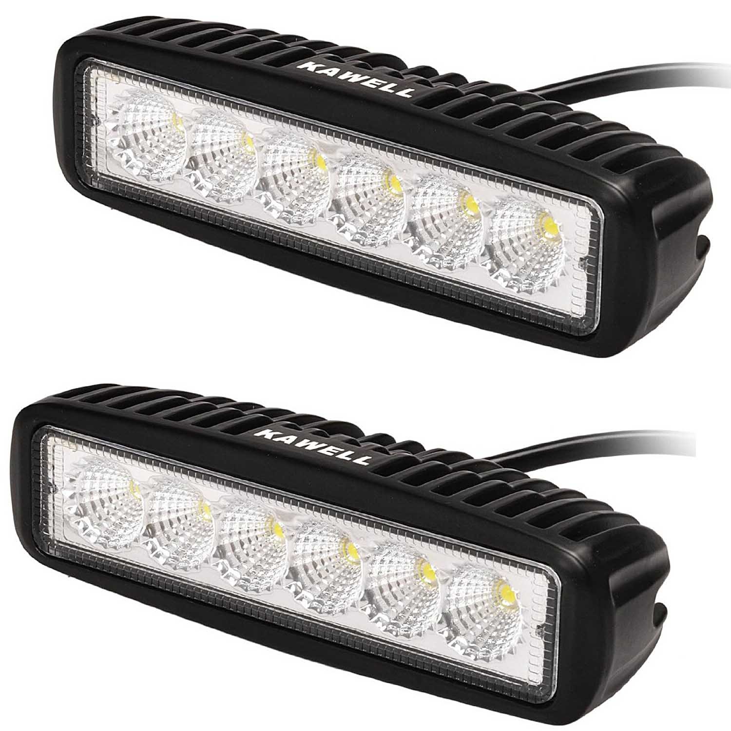

I like the Kawell lights. They work great. Cheap enough to be disposable. My truck has 8 lights. My Jeep has 12. Originally had halogen lights on the Jeep at 4amp per light. The LEDs have more light at 1amp each.
Amazon lights

The trailer reverse light circuit is 10A Fuse located at drivers kick panel.
