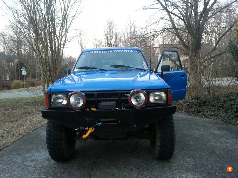

86' 4runner gets VooDoo'd

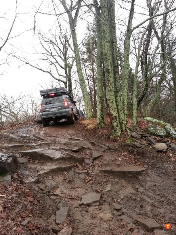

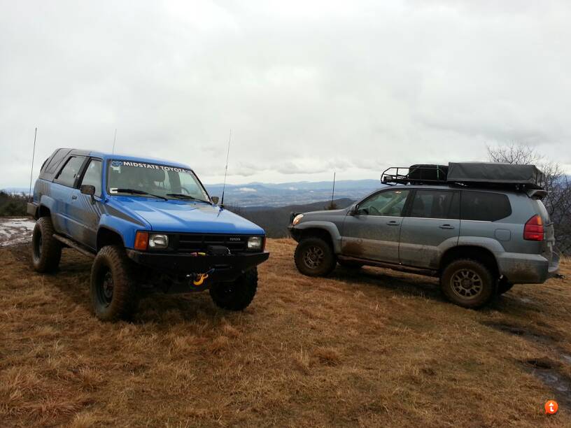

Did a little riding yesterday with a friend, and family. Not many pics of mine from my camera, but may receive some from the others.
Love your rig, you have done some amazing work on it. I have a 14 trail on order that should be here in the next few weeks (hopefully) Let me know if you wouldn't mind having a newbie tag along sometime to learn the trails around here.
You would be more than welcome to come. Congrats on the new one on the way.

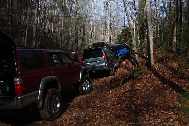

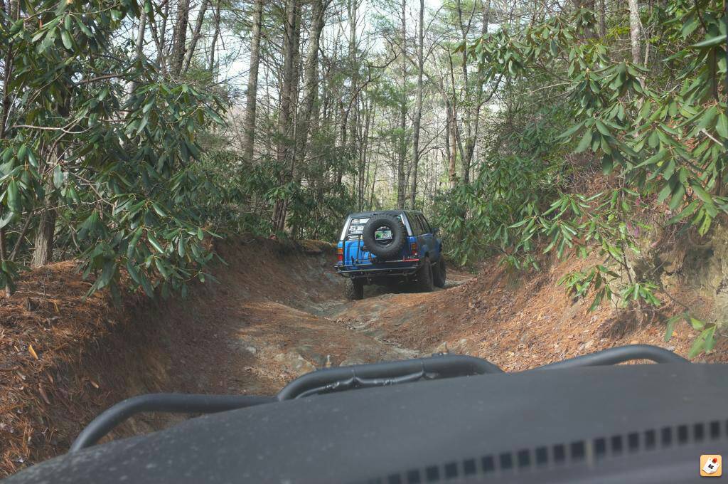

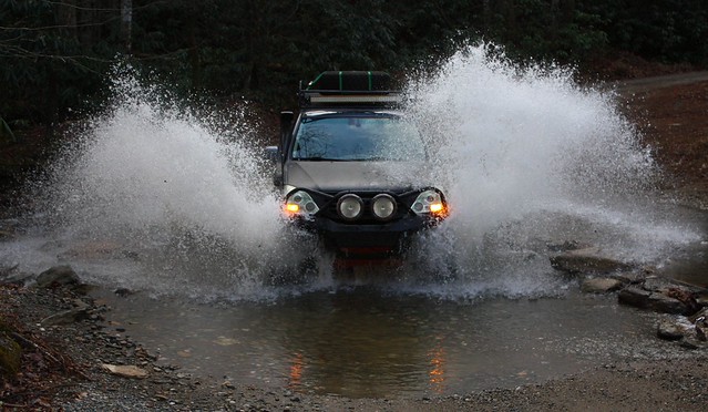

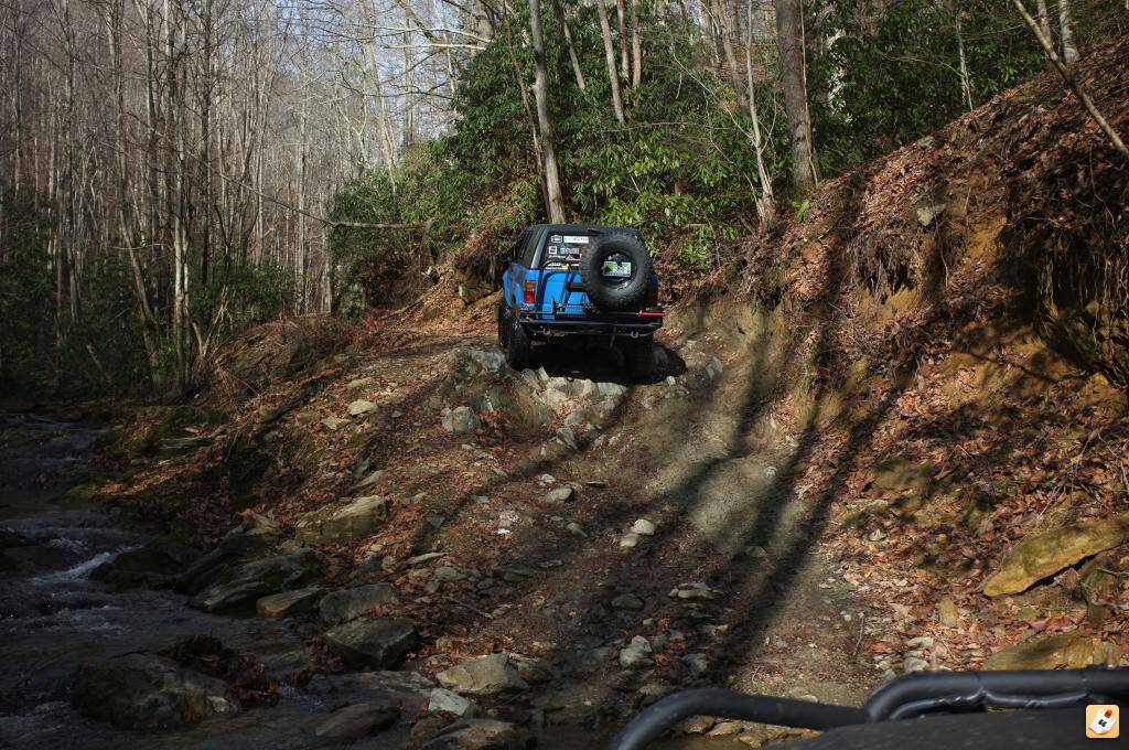

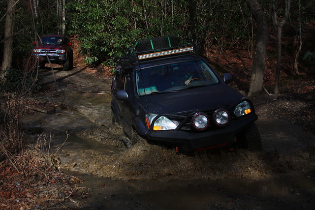

Some pics from one of the others on the last ride.

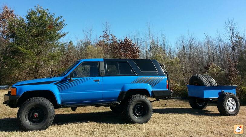

And my trailer's progress
Nice truck dorton! I never would have thought that blue would look so dam good. Looking forward to your progress on the trailer as ive been looking into such a project.dont be to upset if i copy you haha
Beautiful 1st Gen and an awesome build up!! Makes me want to start looking for another 1st Gen. This last year has been the first time I have been without a 1st Gen in a long time. Keep up the great work!

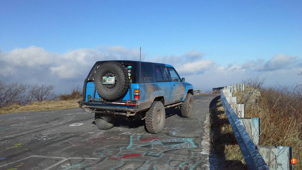

Thought that looked like my favorite stomping grounds. How did you like the view from the top?
:bravo:
Thats a beautiful area. It was my second time going,but first for the people in the lexus, and the first for my wife and daughter. We plan on going back again soon. We also want to find some places over around your state. We used to do a lot of ATVing around the Welch, and Bluefield area before Hatfield McCoy, and I'm sure there are still places to enjoy without the need of a helmet(from my understanding the truck/suv ok trails require helmet for
all passengers).

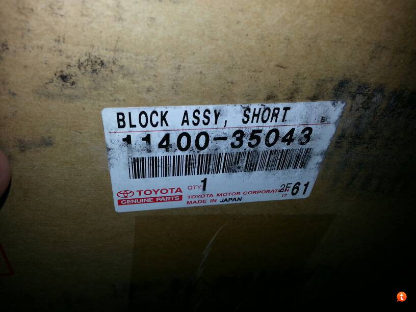

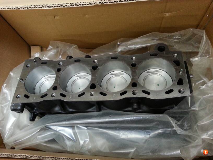

The powerplant has been good, but has 330k on it now, and deserves a break. I have thought long and hard about many different options, and kept coming back to a new Toyota short block. I decided now was as good of time as any to take the plunge. So here she is:

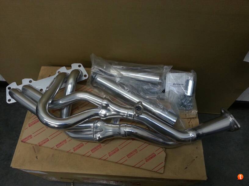

I also have a head inbound from engbldr with oversized valves and their 270/430 camshaft, and a Doug Thorley tri-y header from Summit Racing.

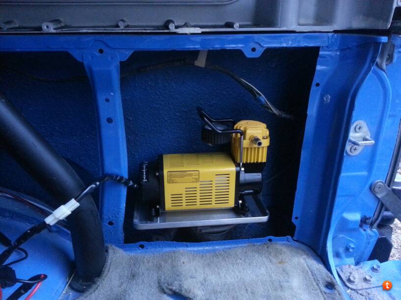

It will include slideouts for the fridge, camping stove, and drawers. I have removed the inner side panels as the room behind them will utilized for storage. For one, I'll be swapping from CO2, to an air compressor to save space, and weight.

What brand is that air compressor? I've got the recommended one from Pep Boys and it's done well so far, but want to pick up another for mounting similar to your setup.

The compressor is a TJM and has worked well. It isn't nearly as fast as the CO2(i didn't expect it to), but it is much smaller, and much lighter. I will accept the loss in refill speed to keep the room I've gained.

Nice. I was hoping for a bigger power plant when I saw the box. Either way a fresh motor will make a long trip much more enjoyable. My original engine is what's keeping me from Moab lol. I decide to build my tundra instead for expo type travels.
I think you made a good choice. An engnbldr head with a good cam and that Thorley header should give you all the grunt you need.
I used to own an 85 longbed pickup on 35s w/5.29s, with basically the same motor setup and was pleased with it. Hopefully this will be the same. I spent hours and hours and hours trying to decide between the 1uz, 5vz, and either of the rz's. What helped with the decision for me was I've replaced almost everything on my 22re that could wear or go bad as precautionary moves. If I went any other direction, I'd have to do the same for peace of mind.
I've only needed more power one time. The key word being needed. I have remedied that with added gear multiplication of the 4.7 tcase. I'll also bring a timing light next time I'll be gaining 10k feet elevation. That lesson won't be forgotten. A 22re(especially with 310k miles) tuned for 900ft elevation is anemic at 10k, and much worse at 13k ft.
