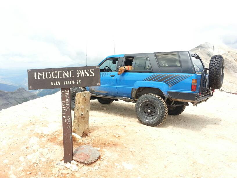

Got some more goodies installed.
I upgraded to T100 rotors, calipers, master cylinder, and v6 dual diaphragm booster. I had been needing more braking power for a while. Between the oversized tires, and alk the added weight, stopping distances had increased.
I had been thinking of changing wheels for a while and found some procomps I liked. I'm pleased with the outcome.

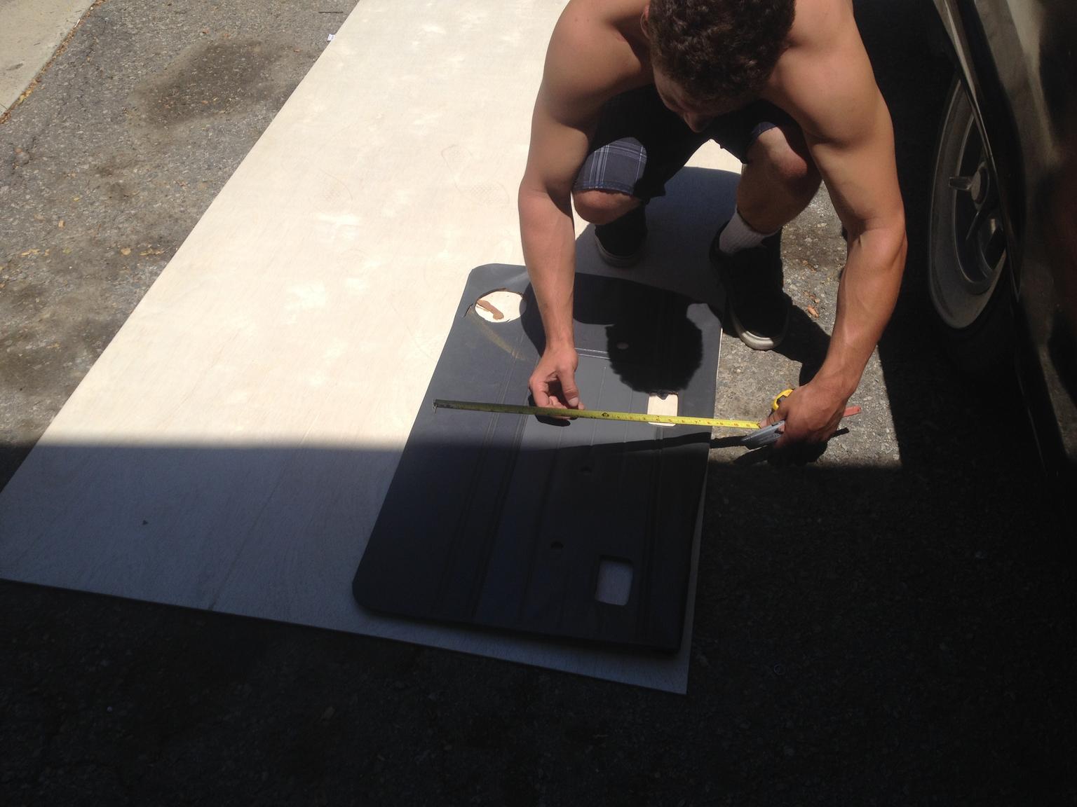

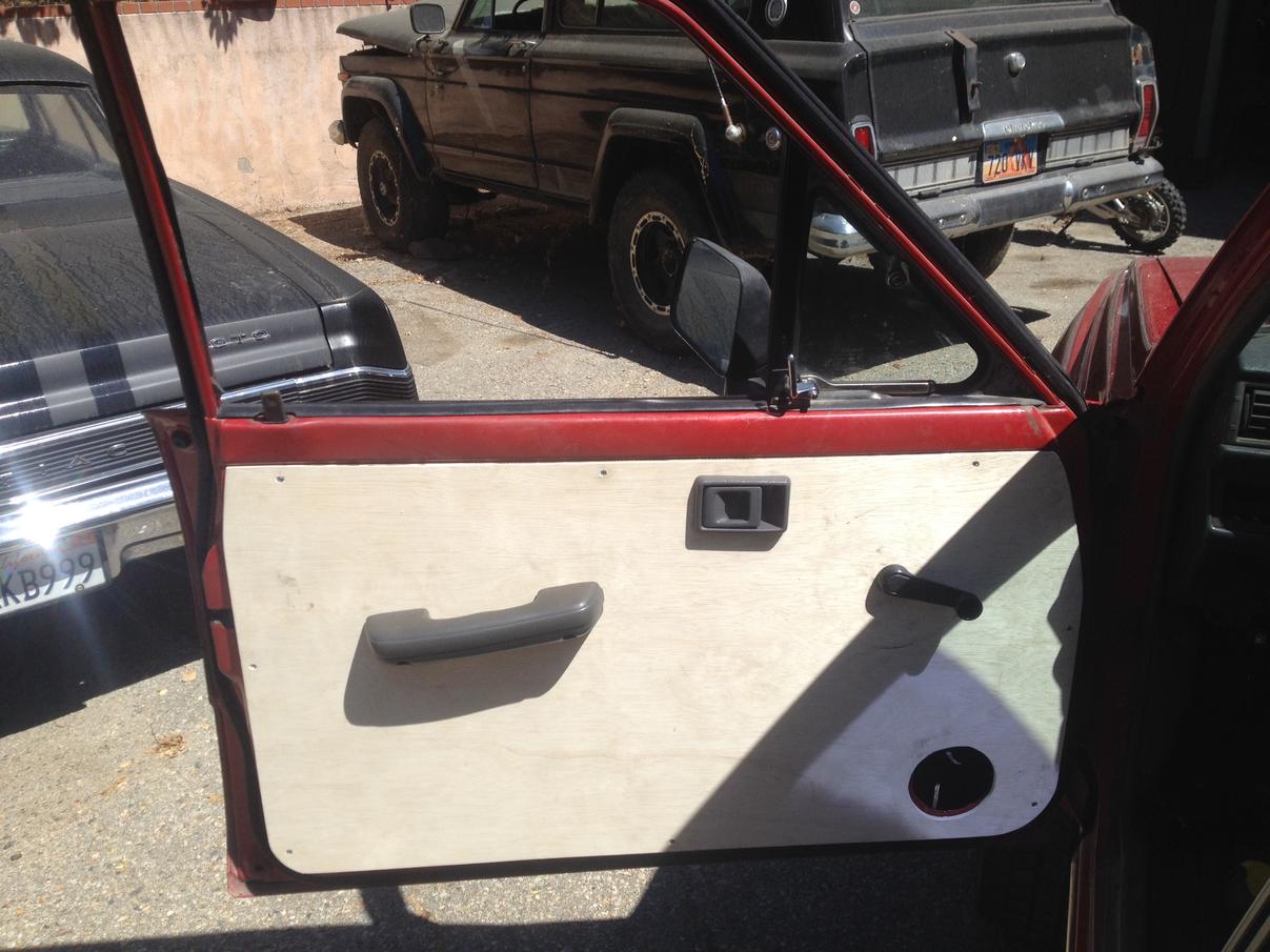

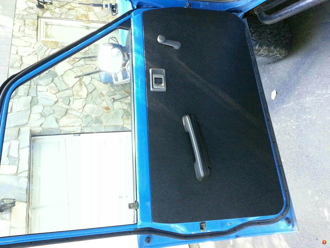

I was feeling a little inspired by your door siding so a buddy of mine and I went and made some. 1/8 inch plywood, they're just waiting to get some speakers installed in them and get a nice coat of grey rhino lining type substance. (Textured Paint)
That bare metal strip should never have been covered in vinyl!

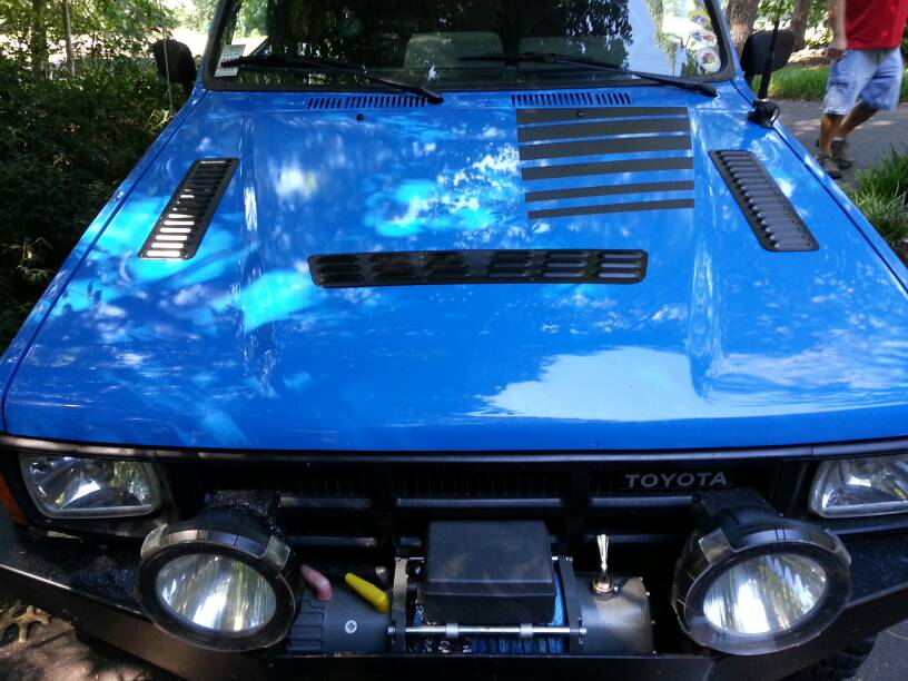

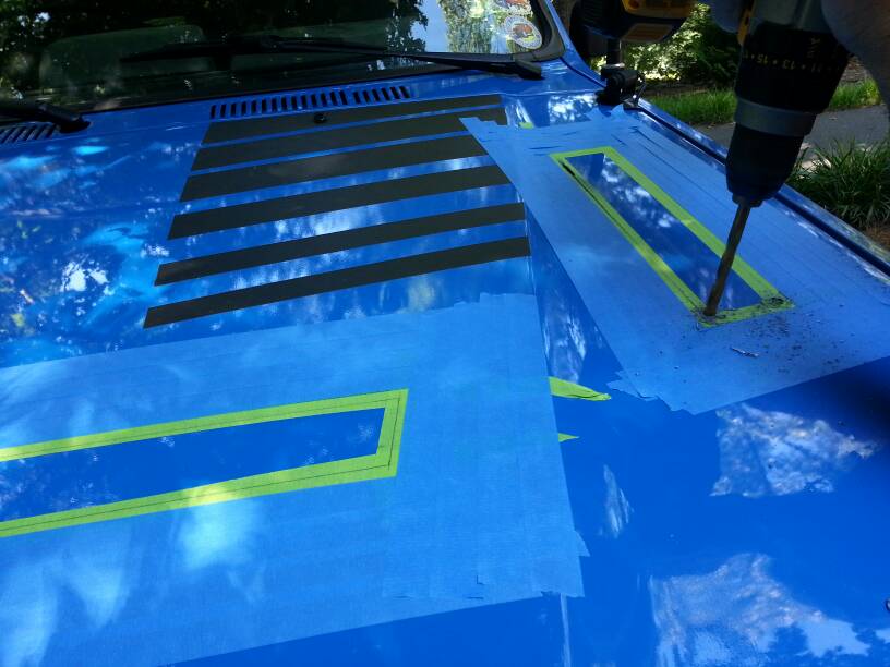

I liked that after seeing Dirtcos build. Can't make the commitment to putting holes in my hood though.
Lookin forward to info on underhood temps...
I was feeling a little inspired by your door siding so a buddy of mine and I went and made some. 1/8 inch plywood...
Nice. Looks like you got rid of the hidden fasteners? I detest those. I have started to replace mine with plastic expansion nuts as I touch each section. Already did it to my grille fasteners.
Do you ever rest your arm on the window sill while driving? The vinyl will protect the paint and ultimately the metal from salt from our sweat that will promote rust.
I prefer the look of the painted section being visible. As long as the metal is covered by paint, sweat won't cause rust. If it were bare metal it would definitely be an issue.
