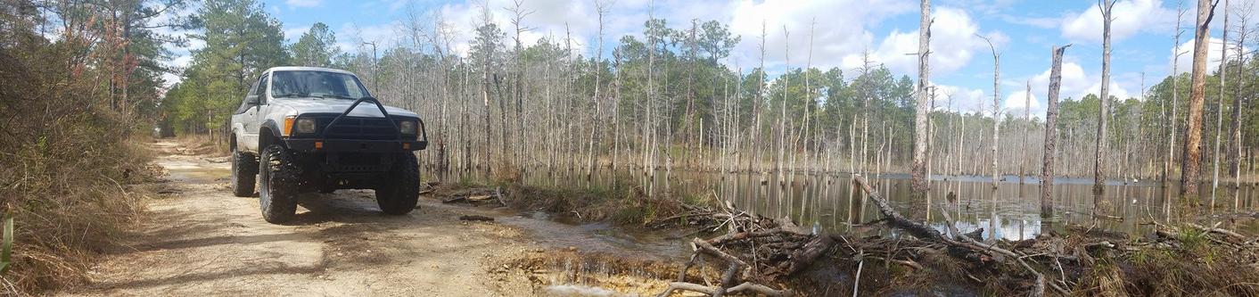

87 With Terrible Body lift!
I am not a fan of flat black wheels. Sorry, but it looked better to me with the stock wheels and BFG's. Definitely looks better without the running boards. Add a front skid plate to cover up all that front suspension support hanging down.

If it ever gets the white paint job I want the wheels will look a much better with than with the silver. And I think I am going to live with the body lift until one of them fails lol.

Some Amazon special. Milestar Patagonia. 305/70r16 they bumped the price up 20$ per after my order.
Sent from my SM-N920V using Tapatalk
Had to take her out today to test out the tires.

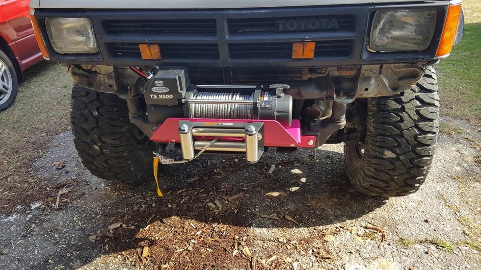

Did you weld that winch plate to the frame? Those 4 bolts won't hold to a full winch pull.

I'd definitely take the body lift off the truck. Its really not that hard, I did it on my truck awhile back. As far as the winch plate goes, ive done a vehicle recovery and uprighted a flipped vehicle with those 6 bolts holding the winch on. They did get stripped out though and Id suggest putting an additional brace.

Also got this mounted and wired today.
