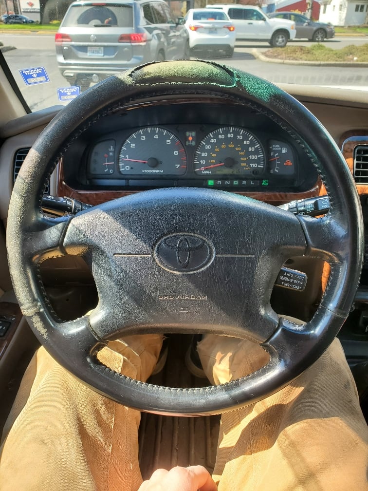

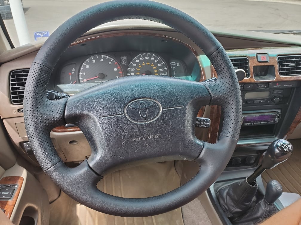

Most recently, I got my steering wheel cover redone. Probably my fave mod. So glad I finally got to doing it, especially after so long of having the irritating spots of bare steering wheel on my palms.
