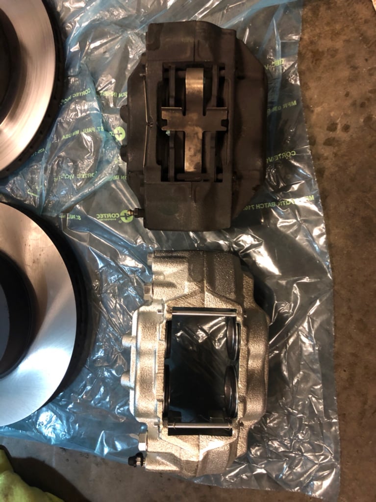

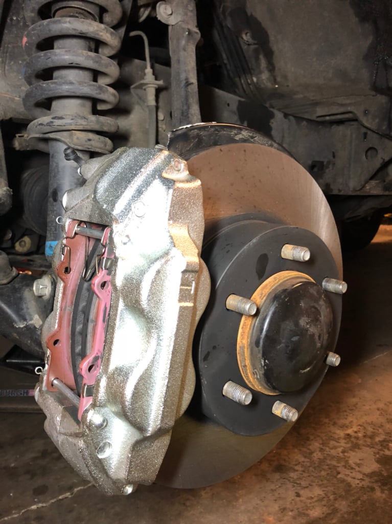

Did my big brake upgrade today with factory Tundra rotors, pads, shim kit, and rebuilt calipers.
Unfortunately wasn’t able to take a drive and test out the new system because my Pro Comp 1059s 16x8 don’t clear the calipers, despite all threads saying that they do clear. It hits the caliper piston bulge. Needs about 1/4” to clear. So I’m strongly considering Spidertrax 1.25” or BORA 0.75” adapters.
Unless I did something wrong, but there’s not much to mess up since it’s only two bolts that mount the calipers and everything bolted up fine, done many brake jobs before this one...

Sucks about your wheels. I've got BORA .75" adapters and no complaints. I'd recommend them unless you want a thicker one.
While your waiting and dealing with wheels you should toss some caliper paint on there.
That’s exactly what I was wanting but they’d only be here Monday and I think I’ll be going up to the hills on Saturday so I went with Spidertrax 1.25” should be here tomorrow. Way wider than what I want but it’ll do for now and I may go down to .75” later on or get different wheels.
I was going to put some G2 paint on them but I wanted to test them out first and make sure they don’t leak or anything before polishing the casting marks a bit and painting.
Sent from my iPhone using Tapatalk Pro
Those are good reasons to go the way you did. G2 is good paint
