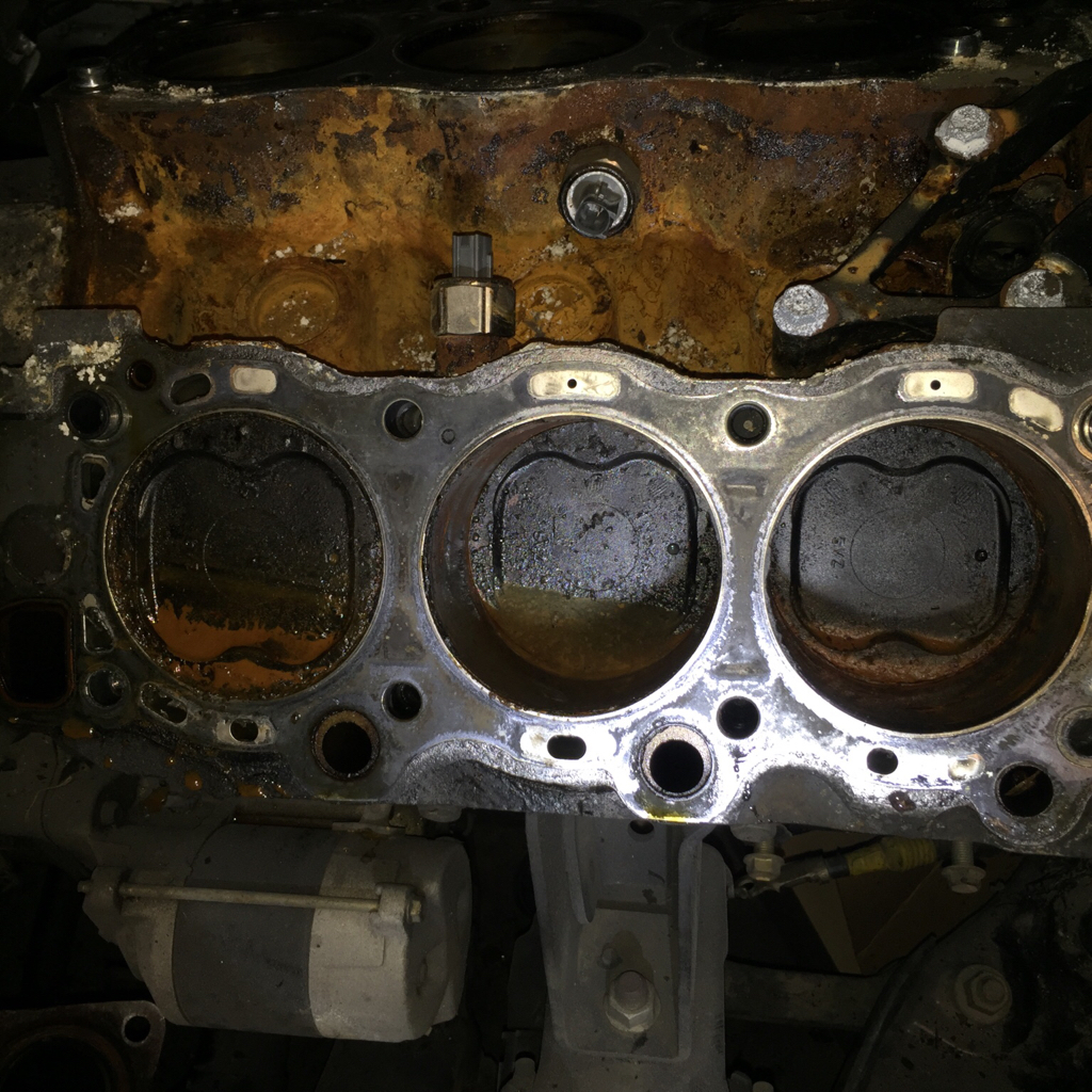

Anyway popped the heads off to investigate the water issue and theres a lot of it lol. Also drained the oil just to see what was up and there's coffee there too.
The factory cross hatching is still very visible basically no wear at all on the cylinder walls, bummer.

You could soak the rust in diesel. That will break it down. I've used that trickster pulling pliers out of a field on the farm. Also worked for a guy who bought a mercury wagon that had a bad motor and to get it to crank over he soaked the cylinders in diesel for several days. Turns out a little TLC and she was good to go!
