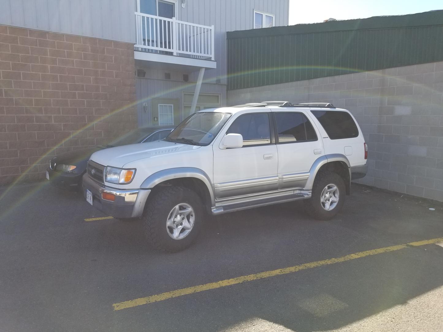

Measurements
These were taken in approximately the same spot on my not completely level driveway. First is ground to fender, then hub to fender.
Before:
Driver Front - 35.5" / 21"
Driver Rear - 35.5" / 21"
Passenger Front - 35.625" / 21.125"
Passenger Rear - 35.375" / 20.875"
After (Pre-Alignment):
Driver Front - 36.75" / 22.25"
Driver Rear - 37.125" / 22.625"
Passenger Front - 36.875" / 22.375"
Passenger Rear - 36.875" / 22.375"
Result/Impressions
Lift:
I gained about 1.5-1.75" of lift which is exactly what I was looking for. The front is a tad higher than I'd like right now, but I'm guessing it'll come down a little after getting it aligned. If not, I'll probably take the front strut down to the bottom ring once the rears are fully settled.
Driving:
On road, the driving experience has improved dramatically. It leans less in corners, the front barely dives when braking, it handles pot holes, bumpy roads, and abrupt driveway/road entrances without being bouncy or jolting. I don't know that "drives like a truck" is a fair statement, as most people associate that with an acceptably harsh ride, so I'll say it drives like a "new, mid-size" truck.
My offroad impressions are very limited right now. I took it on a very eroded (sections are impassable without high clearance vehicles) dirt road near my home and it handled the bumps, holes, and climbs great. It's just more comfortable to drive overall.

looks like more lift
Looks like a lot of lift with the 265/75 for some reason. Just a thought if you take it to the bottom clip seat swap out the rubber isolator for an Energy Suspension poly one. I think that would put you between the bottom and 2nd clip seat height lift wise.
Buy a pair of the OME 10mm trim packers and throw them in the rear. That will help level out the truck.
I think I'd rather bring the front down than raise the back. This would reduce the preload (a small amount) on the front coil from being on a higher perch and improve ride quality (slightly). Maybe if I end up adding a heavier rear bumper I'll go this route, but I don't plan on it in the foreseeable future.
This is pretty much my exact plan on my 4Runner... Though I will either be using the stock front 4WD springs from my '97 parts truck or the stock 2WD front springs from my '99 - I'll be comparing diameter, number of wraps and free length when I do the suspension to choose the stiffest of those two options.
Your description of the ride is exactly what I'm looking for...
Oh, any chance you can do hub center to fender measurements? That'll avoid tire size issues for any comparisons...
-Charlie
Very nice, I did mine very similar to this and love the look and ride quality. Keep us posted on how you feel it rides with the 906 springs..
