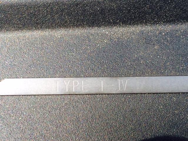

I can confirm that if you have a non-sealed (aka have a trans dipstick) that you need T-IV fluid. Says it on right on the dipstick. I plan on replacing my transmission fluid soon so I've been doing some research.

In contrary from page 350 in the 2003 manual (link here):
Notice: Using automatic transmission
fluid other than “Toyota Genuine ATF
Type T−IV” may cause deterioration in
shift quality, locking up of your transmission accompanied by vibration, and
ultimately damage the automatic transmission of your vehicle.
