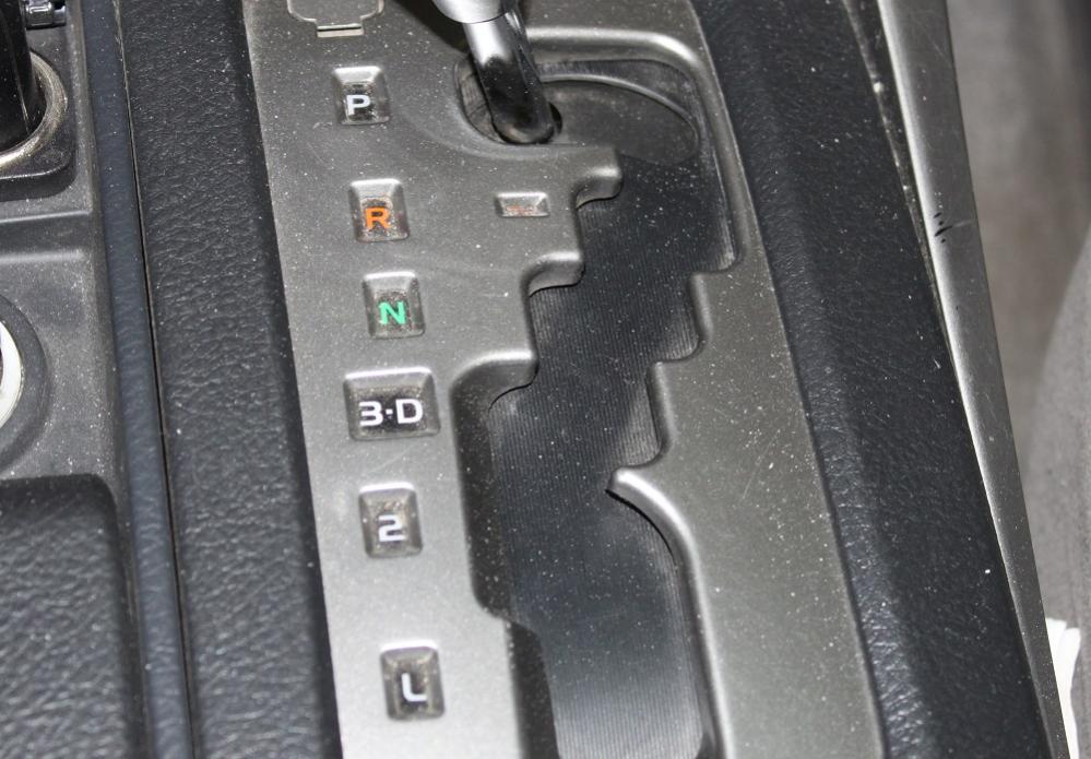

Another way to tell if you have the 4 speed or 5 speed is to look at your gear selector in the gauge cluster. I've attached some pictures below that show the difference in how the gear selector will look for the 4 speed vs 5 speed.
The 4 speed will have the gear indicator with labels P R N D 3 2 L like seen below. The main thing to look for here is the D32L are the 4 gears. L gear is visually below the 2 gear on the indicator.
And the 5 speed will have the gear indicator labeled P R N D 4 3 2 L like seen here below here. The main thing is the D432L are the 5 gears. Visually the L gear is next to the 2 on the 5 speed, whereas on the 4 speed, it is below the 2

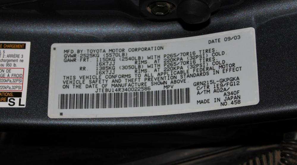

Here is the 2004 4spd 3.90 ... T-IV trans fluid.
For future reference.
