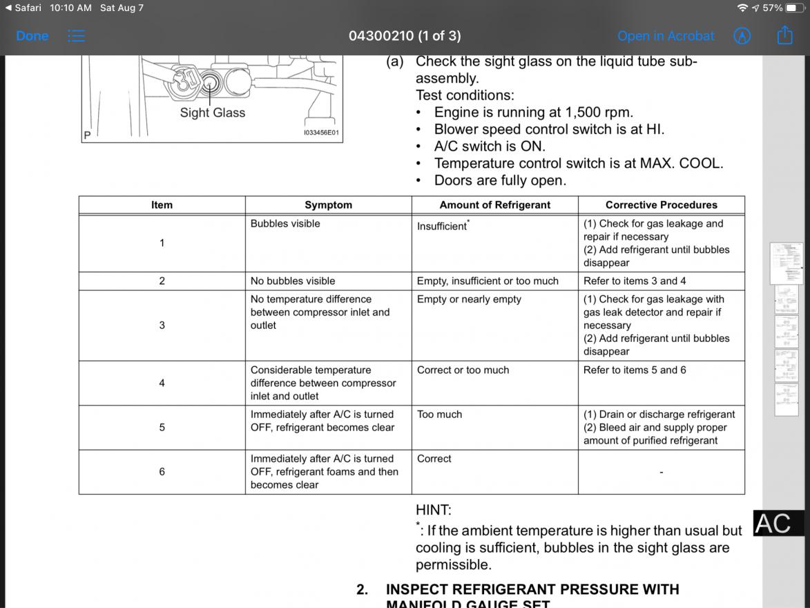

Have checked the sight glass while its running? It sounds like the expansion valve the way it acts. Runs, freezes, thaws, runs again. Repeat. I assume toyota used gauges when they recharged it. But the manual clearly says to use the sight glass for an accurate fill. Over filled is just as bad as under filled.
I checked it this morning, but I'm not seeing any bubbles at all. None while it's running and none when it's shut off. This to me would indicate an overfilled scenario, but I can't imagine the dealership overfilled it. It acted the same both before and after they vacuumed it and replaced the charge.
I'm with you, I'm thinking the expansion valve as well. Just seems like the cycle is so fast for it to be that ,but I've never dealt with a bad one before. The compressor runs for maybe 10 seconds, then stays off for about 10 seconds I would guestimate. As soon as it cuts off, the air begins to warm up until it cuts back on again.
Do you see liquid? Or does it look empty? Shine a light into the sight glass with the AC off first, then on and note the difference. If its always liquid its over filled. A bad evaporator is a leaking one.
First time I checked it, it sure seemed to be empty. I couldn't see any liquid in there at all, or at least no signs of flowing liquid. When I checked it (after I had gotten it back from the dealership) I couldn't see any difference between the AC on/off other than after the AC was shut off, it seemed like the inside of the sight glass would fog up, or appear milky. I have not seen bubbles at all.
For whatever reason, this one is harder for me to read than my '99 is. The '99 always showed bubbles at the correct time when shutting off the AC, and it was easy to see the liquid flowing across with the AC running.
Well, got a call from the 2nd shop. Evaporator core IS leaking, so they're replacing it to the tune of $1,100.
Anything else they should do while they're in there to ensure my AC stays frosty? I've got them changing out the expansion valve as well, and checking the desiccant filter up front.
