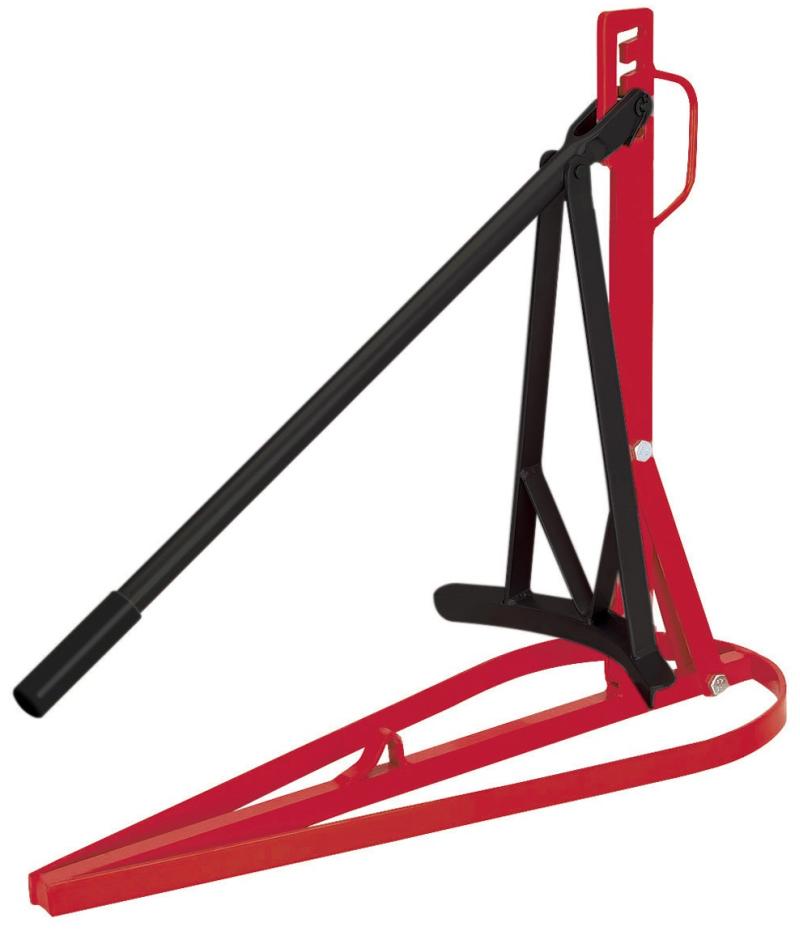

That's the breaker I was talking about, the extra 30$ in expense would be well worth it in my opinion. Passenger wheels have by far the most well seated beads, the bars and hammers are mostly used for truck tires and 16.5s with no safety bead. That extra push from the shovel is what you need to get past that back bead.

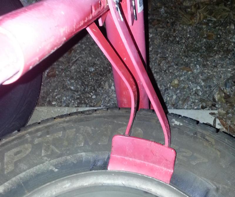

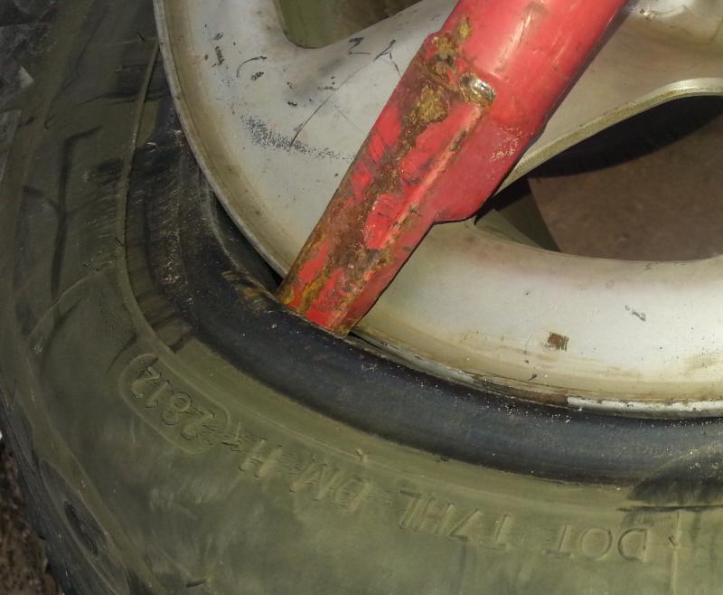

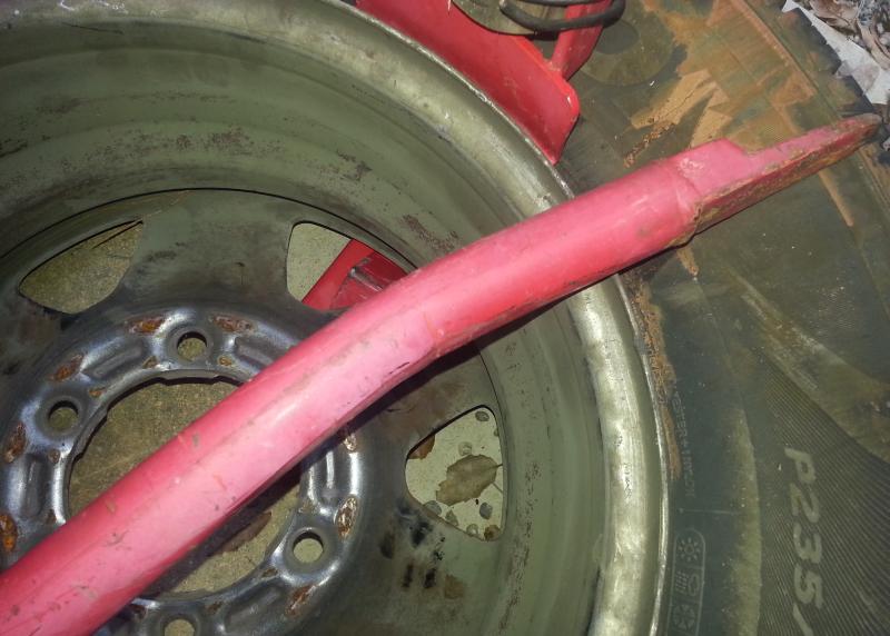

I need your advice.
Time and time again, I "think" I understand someone, but, when I try it myself - I realize I don't know what I'm doing (yet).

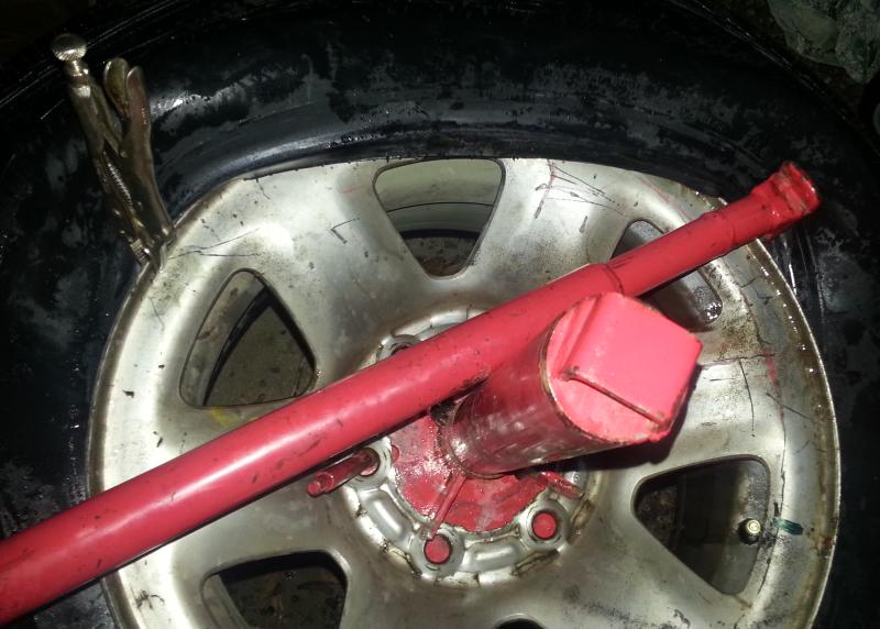

Fact is, I didn't even realize that I (still) don't know how to break the bead until I just now tried to break the bead using the HF tire-changing tube.
The puny bead-breaking tool just slipped off the bead time and time and time again.
230397d1481561357-advice-requested-those-you-who-have-mounted-tires-balanced-wheels-home-toyota_mounting_tires_07.jpg

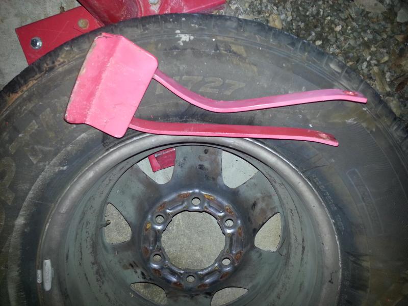

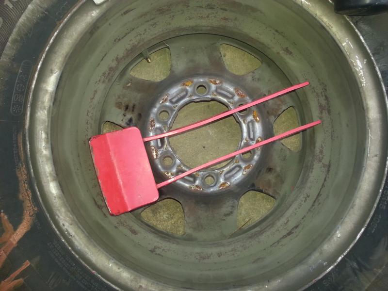

So I got out the bead breaker you had recommended:
230396d1481561353-advice-requested-those-you-who-have-mounted-tires-balanced-wheels-home-toyota_mounting_tires_06.jpg
But, um, which way does it go?
Am I supposed to slip it under the rim this way?
230398d1481561366-advice-requested-those-you-who-have-mounted-tires-balanced-wheels-home-toyota_mounting_tires_08.jpg
Or do I squish it under the rim so as to catch the bead in the other direction?
(there is no way I'm gonna get it under the bead?)

I need your advice.
You've got it right in your picture. If the bead is stuck you can try putting a small amount of air (like 3 psi) and it will give you more to push against. Start with the back bead and get it started before you pop the front.
PB blaster or a similar penetrant will loosen any rust that may be holding the tire and wheel together.
Sent from my Z958 using Tapatalk

I need your advice.

you'll definitely want a bit of air in those to break them down, they're a pain to do flat even on a tire machine. Once you get it started that makes them easy to work with since they hardly ever pop back on.
Thanks for that practical advice to keep some air in the tire to remove it, because it seems I NEED as much practical advice as is possible!
I just hope someone else reads this thread BEFORE they try the job so that they can learn what NOT to do (which I'm only learning by making the mistakes).

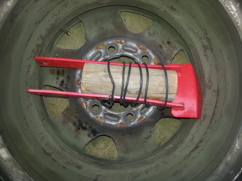

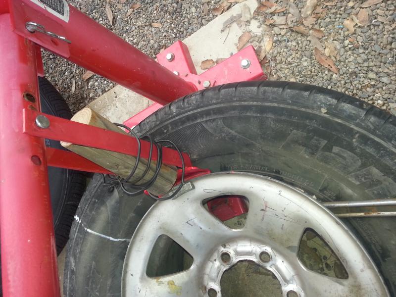

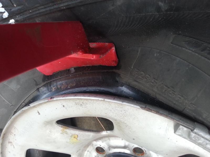

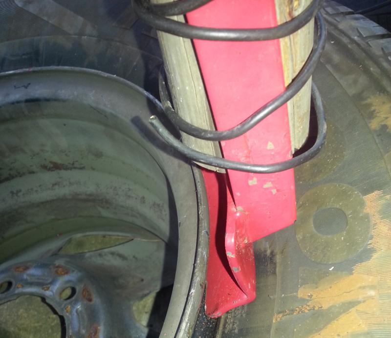

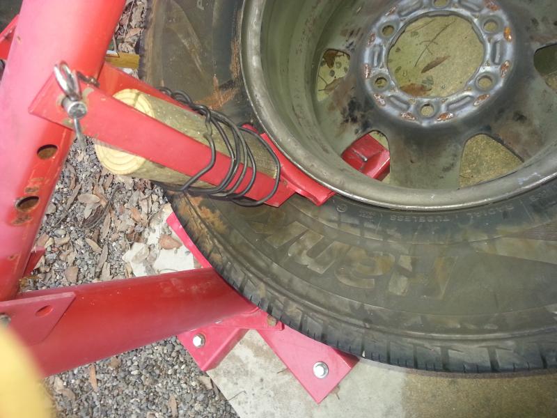

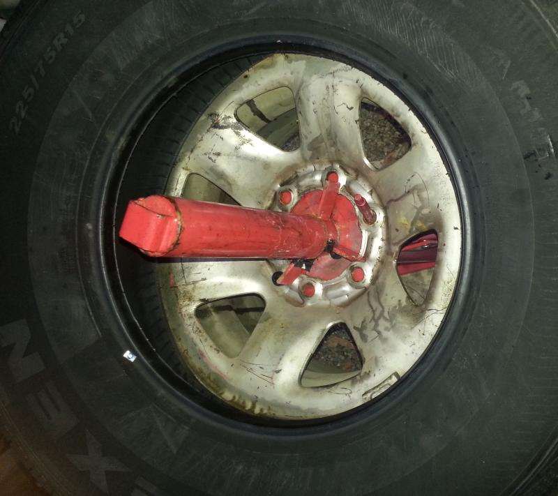

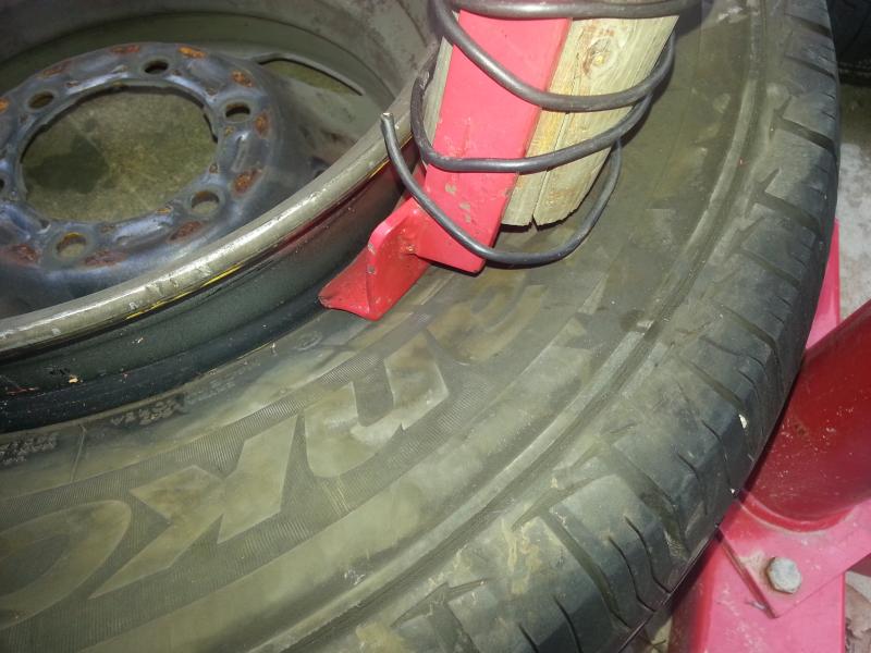

I've given up, for example on using the swan-neck bead breaker bar that someone recommended, which, it turns out, is absolutely useless because it's for a DIFFERENT type of tire (so whoever recommended it, never used it on a SUV tire because it's impossible for it to grab anything).
230539d1481641722-advice-requested-those-you-who-have-mounted-tires-balanced-wheels-home-wrong_tool_bead_breaker_1.jpg

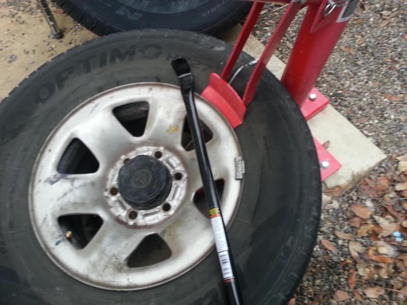

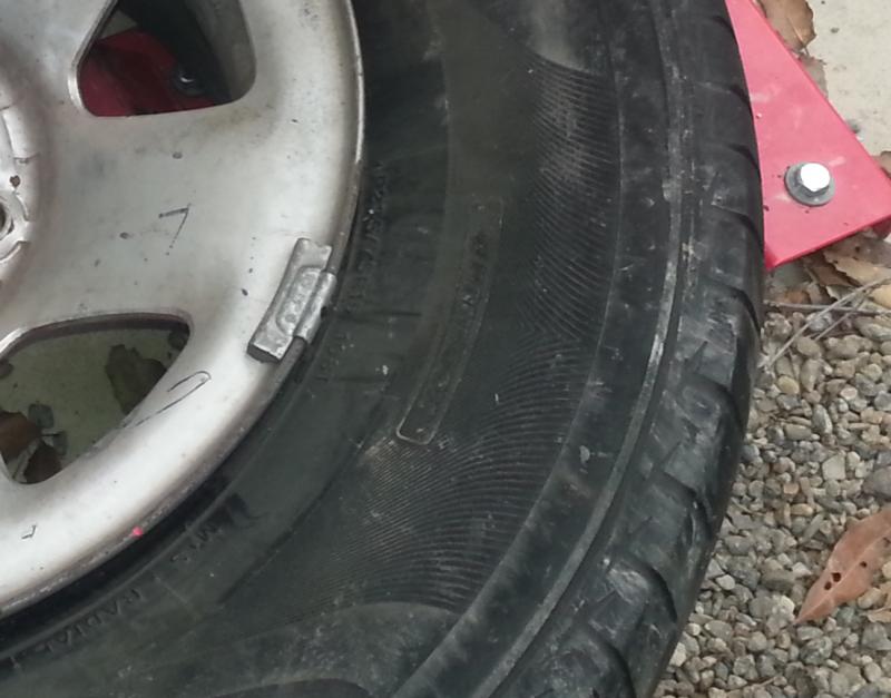

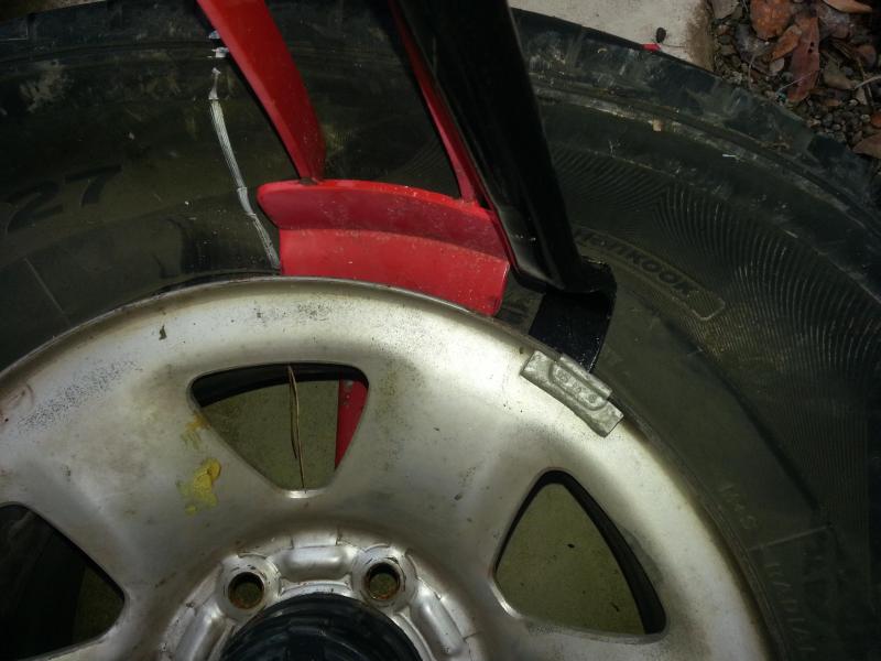

And, I'm going to give up on the bead-breaker attachment to the HF tire-changing tool, because the steel is so soft it bent like a butterknife when I tried to do the one spare tire that I have (the SUV isn't mine so I can only get a hold of the other four wheels when the owner isn't using it).
230540d1481641820-advice-requested-those-you-who-have-mounted-tires-balanced-wheels-home-wrong_tool_bead_breaker_3.jpg
I removed the bent beadbreaker attachment and will straighten it out but it really (really) needs to be reinforced. Either that, or my technique is atrocious.
230541d1481641830-advice-requested-those-you-who-have-mounted-tires-balanced-wheels-home-wrong_tool_bead_breaker_2.jpg
As with many tools, the all-in-one often doesn't do any job well, so I may have to go back to HF to get the single-purpose bead-breaker tool instead:

break out the hi-lift jack. that will pop the bead.
I have done many tires at home. mostly larger off road tires, those can be extra tough..
we have never had the luxury of a tire machine, or any bead breakers. we used good old fashioned tire spoons. you are well ahead of the game.
don't get discouraged, keep at it. you will get it figured out.
its not easy work, and takes a fair amount of manipulation, and body English to get things to go smoothly.

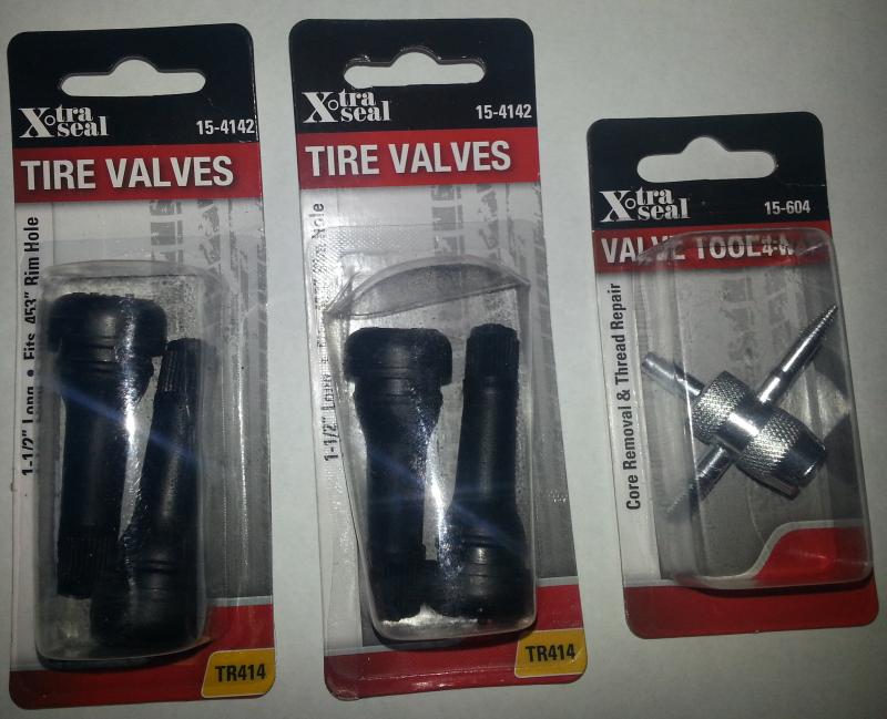

I do recommend getting that $8 valve stem tool. you have all the other, more expensive tire changing gear, its very likely this wont be the last set you do. skimping on that very handy tool seems silly.

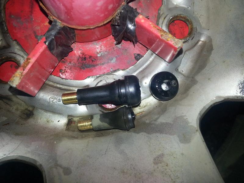

I did take someone's advice to get shorter tire valves and to buy the cheap tire-valve screw-on puller. I also have the lever-type tire valve removal-and-replacement tool on backorder.
As a practical note to anyone reading this who contemplates doing their own tires, I found nowhere where this was mentioned but the 2 inches of the other tire valves seems to be the amount sticking out, and not the total length. I guess that's obvious, but not all specs are what you'd think they'd be.
The current tire valves stick out 1-1/4 inches, which is a tad too short, so these are 1-1/2 inches (0.453-inch rims, max 65PSI, TR414 style).

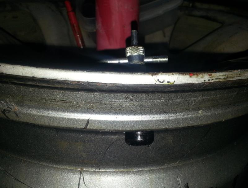

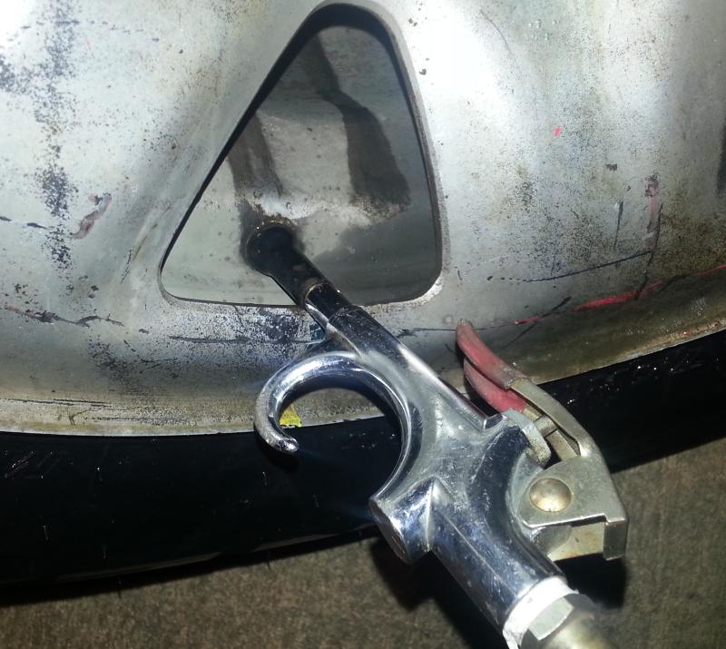

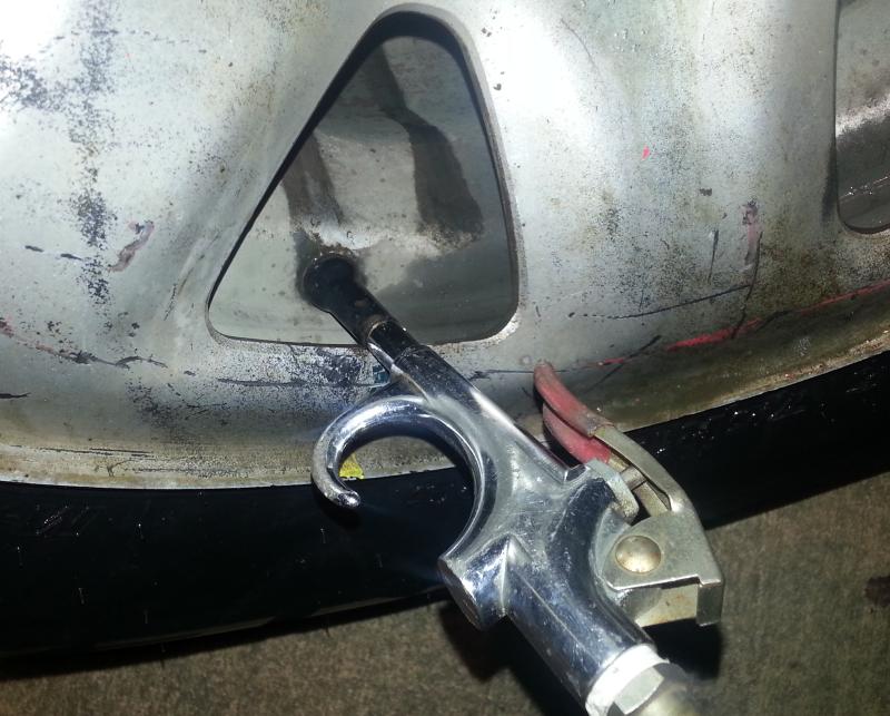

Just how are you planning on getting the bead back? Seems to be a pretty important part of tire mounting. Simply getting it back around the rim won't get you far.

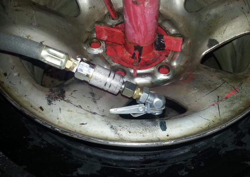

That is a good question and the plan is very simple:
1. Once both beads of the new tires are loose on the rim & the new valve popped in
2. I remove the Schrader valve core from the new 1-1/2-inch long Schrader valve
3. I latch a self-attaching compressor chuck to the now-wide-open Schrader valve stem
4. As the air goes in, I wiggle and jiggle and knee the tire lifting up to ensure a momentary seal
5. Once I get a momentary seal, I let the compressor put as much air as it will take to pop both beads into place
6. Once the beads pop evenly into place, I will quickly screw in the Schrader core & deflate to 40psi
If necessary, I plan on kneeing the tire from the underside and tugging from underneath with both hands (keeping them well away from the bead-to-rim interface for obvious reasons) while it is filling up.
Afterward, I will be looking to see that the rubber ring around the tire shows that the bead is seated evenly.

I may need to buy the single-purpose bead-breaking tool, since, as you know, for SUV tires, the puny bead-breaker arms simply bend like putty on the 108T SUV tire I have in my possession (and there will be four more to go since I have to swap out the spare for her too).

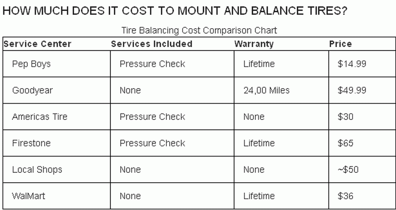

Here is a so-called "The Complete Tire Balancing Cost Guide" which shows this chart:
Since this is intended to be a reference thread for others to benefit from, the cost equation is a valid point in that maybe it's not worth the trouble, from the cost perspective, of buying, mounting, and storing the necessary tools to change your own tires and balance your own wheels at home.
My rough calculation at the start put it at about $200 for the tools and $20 per mounting & balancing but that assumed that vibration didn't occur (hence no additional dynamic balancing needed), which pays for itself in just 10 tires which is about 2 years time for my two cars.
Others had said mounting and balancing was only $5, so that would take a prohibitive 40 tires to pay for itself, which is about 8 years time (at an average of 5 tires per two years per car for a two-car family).
So what you pay for tools and for a mounting/balancing service might sway that return-on-investment calculation mightily!
About the only thing influencing the accuracy of that tool cost estimate is simply the wastage that occurs from buying the wrong tools because the price of the tools is going to be pretty much equal across the various states in the US, so, we can leave the tool cost at $200 for now.
For the mounting/balancing costs, we probably should defer to the professionals such as the Tire Rack Recommended Installer lookup tables.

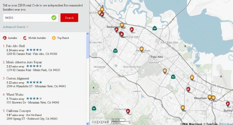

To give others an idea of what they might find, I just plugged in my zip code into the Tire Rack Recommended Installer Zip-Code-Based Search Engine but maybe a few of you can plug in your zip code so that others get an idea of the average costs in their area?
Unfortunately, when I clicked on the first five in the list, none had prices but all had phone numbers with the instructions to ask for the Tire Rack Price.
Doing that for the team, so that folks could get an idea of the average price for tire mounting and balancing, I came up with:
  1. Palo Alto Shell (Contact: Ravi or Kyle (650) 857-1313) $18 per tire (includes mount,balance,valve,& disposal)
  2. Menlo Atherton Auto Repair (Contact: Mario, Tony or Dan (650) 325-1280) Mario says it's $154 for 4 tires out the door which is $38.50/tire
  3. Custom Alignment (Contact: Joe or Alan (650) 961-5311) the line was busy every time I called so I gave up
  4. Wheel Works (Contact: Store Manager but I talked to Chuck (650) 961-2800) $20.50 per tire mounted,balanced,valve,& disposal
  5. California Concepts (Contact: Noah or Brian (650) 260-2375) Noah says it's $24.75 per tire (he also said $100 out the door)
This is a pretty fair test since I simply took the first five out of Tire Rack for my zip code and the price came up nowhere near five dollars a tire (disposal alone was $3.50 at the least expensive place and $7 at the second shop in the list).
Given that, I think my initial estimate before I started this thread of about $20/tire is still pretty accurate.
But to help others, it would be nice if folks can quote standard prices in their area.
NOTE: Don't quote sales prices (unless they are "perpetual" sales prices, which aren't sales); this is because when you need tires, there will rarely be a sale at that exact time, so please just quote their "normal" prices so people get an idea when the $200 investment in tools can pay itself off.
Note: I had forgotten about disposal costs until I called these guys (some of whom charge $7 per tire for disposal plus 70 cents sales tax on that disposal); but then I called a few local autoparts stores who all had prices similar to the above - until I called Costco, who will dispose of any tire for $1 per tire plus sales tax (so about $1.10 per tire). That's as cheap as you'll ever get it.

I'd definitely go for the large single purpose bead breaker, it could save a lot of hassle.
Thanks for that advice.
I'm not going to disagree with you because I found that the bead breaker attachment to the tire-mounting tool is basically far too weak for these strong-walled 108T tires.
Nonetheless, since I didn't have the fancier bead breaker with me, I made do with what I had (after some quick popsicle-sticks American ingenuity temporary repairs)...

The first thing I did was straighten out the bent bead-breaking wedge bars, which was so easy to do one might conclude that they're actually made of rubber.
230640d1481685748-advice-requested-those-you-who-have-mounted-tires-balanced-wheels-home-01_straighten_tire_wedge.jpg
What the bead breaker shovel needs, from the start, is a bit of support, which is shown here (but after using it, I realized it needs to be about 2 inches from the top of the wedge to leave clearance for the rim of the wheel when breaking beads).
Luckily this wedge simply moved out of the way because it was just press fit in and wrapped with solid 120V copper wire. (Given more time, I would not weaken the bars any further by drilling bolt holes - but - I would strap in a rectangular block of wood instead of this fence post, which just happened to be handy.)
230641d1481685904-advice-requested-those-you-who-have-mounted-tires-balanced-wheels-home-02_strengthen_tire_wedge.jpg
I started on the inside bead, which I'm told, is the harder one to break.
By moving the Clovis pin to the outside adjustment hole (making the angle about 90 degrees to the tire), and with this artificially strengthened wedge, I was (finally) able to apply (far) more force on the 108T tire bead without the wedge slipping off the bead itself.
230642d1481686090-advice-requested-those-you-who-have-mounted-tires-balanced-wheels-home-03_strengthen_tire_wedge.jpg
The fence post got in the way of the rim as shown in this photo, so, if you permanently mount it, make sure it's shorter by about 2 or 3 inches than the space allotted, and make sure it's mounted up high and not low where mine is now.
Notice how the wooden block hits the rim?
You don't want that.
You want the block to stay higher up, away from the rim by a couple of inches.
But, in this case, it didn't matter because the block moved when pressure was placed on it.
230643d1481686214-advice-requested-those-you-who-have-mounted-tires-balanced-wheels-home-04_strengthen_tire_wedge.jpg
The stronger wedge plus the 90 degree angle from using the furthest-out of the 3 adjustment pin holes allowed me to apply enough force to finally pop the inside-rim bead of the admittedly strong 108T tire sidewall.
230644d1481686321-advice-requested-those-you-who-have-mounted-tires-balanced-wheels-home-05_finally_popped_the_lower_bead.jpg
Only after I popped the underside tire bead did I try to remove the lever arm, where I found that it bent at about a 10 or 15 degree angle. It took that much force, but you have to also realize that this harbor freight metal is soft as rubber.
230645d1481686479-advice-requested-those-you-who-have-mounted-tires-balanced-wheels-home-06_bent_tire_iron.jpg
After straightening the bent tire iron as much as I could, and after moving the clovis pin to the center hole to get more of an angle, and using a tire iron to keep a depressed bead down, I easily popped the upper bead.
230646d1481686695-advice-requested-those-you-who-have-mounted-tires-balanced-wheels-home-07_moving_bolt_holes_and_popping_upper_bead.jpg
Placing the tire iron flat step with the step side up, allowed me to start spinning the top bead off the wheel rim without lubrication:
230648d1481687073-advice-requested-those-you-who-have-mounted-tires-balanced-wheels-home-08_using_the_right_edge_and_up_of_the_tire_iron.jpg
Adding dish detergent helped a lot to spin the top bead off, where I'd say it's a requirement to have lubrication but everything gets slippery, even the tools, so try to keep it off the tools.
230650d1481687318-advice-requested-those-you-who-have-mounted-tires-balanced-wheels-home-09_adding_dish_detergent_and_water_helped.jpg

Once the tire was off the rim, I cut off the old 1-1/4 inch tire valve from the underside with a utility knife, where the old valve was in surprisingly good shape, so I might have kept it had I not wanted to test out the 4-way valve-seating tool and the fit of the longer new 1-1/2 inch long tire valves.
230652d1481687580-advice-requested-those-you-who-have-mounted-tires-balanced-wheels-home-11_cut_off_the_old_tire_valve.jpg
After lubricating the new 1-1/2 inch valve with dish soap, I threaded on the 4-way tool and pulled it through so easily that it was shockingly simple.
Later you'll see I have a much better idea for a 4-way tool that I already have in my compressor toolbox, so I never needed the 4-way tool in the first place, but I didn't realize that until later.
230653d1481687756-advice-requested-those-you-who-have-mounted-tires-balanced-wheels-home-12_install_new_valve_with_4way_tool.jpg
Only later, when I was filling the tire with air, did I realize that a handy tool for pulling the valve would have been my compressor football/soccer-ball needle-valve tool, with the needle valve removed, which spins onto the valve threads with ease and which has a nice trigger handle to grab onto so that the valve can be pulled into place.
But I didn't think of this at the time I was seating the first valve, so, it's just a lesson learned for the future, and for someone else who happens to read this for hints on how to do the job if you don't have the 4-way valve seating tool (which is never needed but which is probably handy in an emergency and which is small enough to go into your compressor-tools' drawer).

I had to vise grip the end of the bar that I was holding because it kept twisting off the bead but with vise grips, it was manageable.
At the very least, you'll want to use vise grips to hold the slippery upper bead from slipping off as you try to force the last 1/4 of the upper bead onto the rim.
230657d1481688661-advice-requested-those-you-who-have-mounted-tires-balanced-wheels-home-16_the_last_quarter_of_the_top_bead_is_harder.jpg
This is the point where you're extremely glad the tool is firmly bolted to cement, as the force is as much as you can give it.
Even so, I found I had to ditch the slippery but huge red pry bar and resort to two 24-inch tire irons to leverage the remaining upper bead over onto the wheel rim.
230658d1481688802-advice-requested-those-you-who-have-mounted-tires-balanced-wheels-home-17_tire_irons_help_with_the_last_quarter_of_the_top_bead.jpg

The 4-way tool could have been useful here had it a blunt end instead of what they call a (sharp) pick, but that 4-way tool doesn't have a pin for letting the air out of the valve to drop the pressure down from 60 psi back to 40 where it belongs (which makes it less useful than it could have been).
Rummaging around in my compressor kit, I found this needle-valve which is normally used to inflate footballs and soccer balls, but which deflates the tire without sharp points like those that are on the silly and useless 4-way tool.
230661d1481689503-advice-requested-those-you-who-have-mounted-tires-balanced-wheels-home-20_dropping_the_pressure_back_to_40_psi.jpg

It was at this point that I realized that the football/soccerball inflator handle can be used for the next tire to inflate the tire quickly without the schrader valve being in place, so I will try it this way on the next tire to see if it works.
(It may require a third hand to press the trigger, but I can probably wire the trigger pressed because both hands will be needed to coerce the tire into momentarily seating while the air is filling it up.)
230662d1481689703-advice-requested-those-you-who-have-mounted-tires-balanced-wheels-home-21_idea_for_inflating_tire_without_schrader_valve.jpg

One question is what tool you use to remove the old clip on wheel weights?
230667d1481691403-advice-requested-those-you-who-have-mounted-tires-balanced-wheels-home-23_remove_old_clip_on_wheel_weight.jpg
