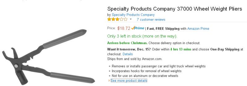

Thanks for that advice on the wheel weight pliers that the pros use.
230685d1481720655-advice-requested-those-you-who-have-mounted-tires-balanced-wheels-home-wheel_weight_pliers.jpg
But a hammer and a small/sharpish punch will work fine, just tap it under the edge of the clip and pry the weight off.
Thanks also for that advice that a hammer and pick of some sort will work fine since you have the experience I lack.
Since I'm not going to be doing this often, that makes sense not to have to store yet another single-purpose tool in my already very crowded toolbox, as I already now have two useless tools that were never needed (the crossbar 4-way tool and the swan-neck breaker bar).

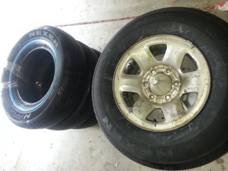

Moving to the next step, I will likely have the vehicle to work on the other four wheels on the weekend so I want to order the right type of wheel weights, in the right sizes.
This is the front of the rim on the balancer
230741d1481749378-advice-requested-those-you-who-have-mounted-tires-balanced-wheels-home-1_balance_wheel.jpg
This is the rear of the steel rim
230742d1481749392-advice-requested-those-you-who-have-mounted-tires-balanced-wheels-home-2_balance_tires.jpg

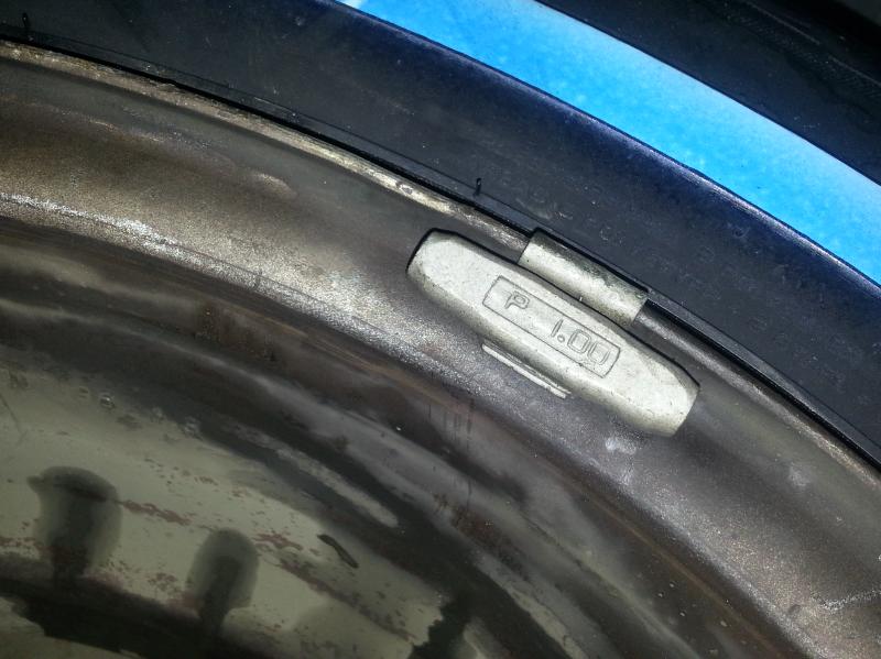

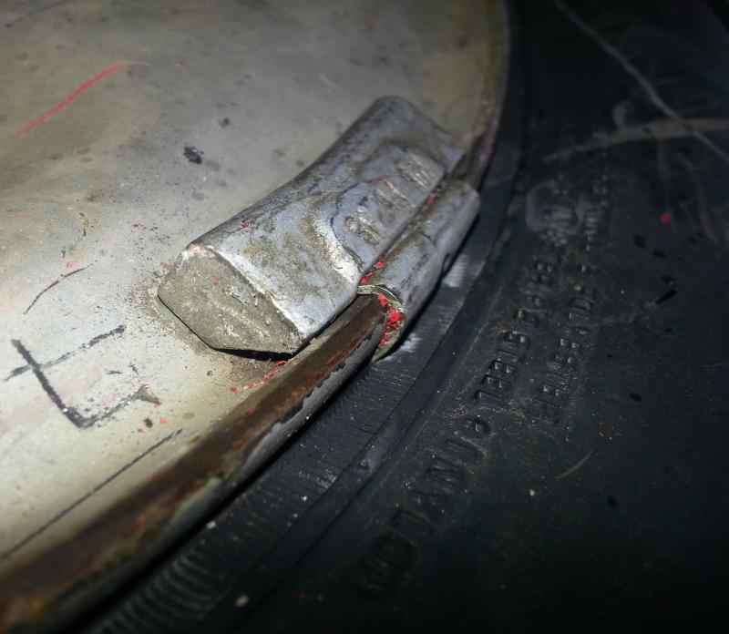

Here is a closeup of the old existing weight
230743d1481749401-advice-requested-those-you-who-have-mounted-tires-balanced-wheels-home-3_old_weight.jpg
From that little bit of information (which is all I have), do you know enough about balancing to know which TYPE (and variety) of weights to purchase?

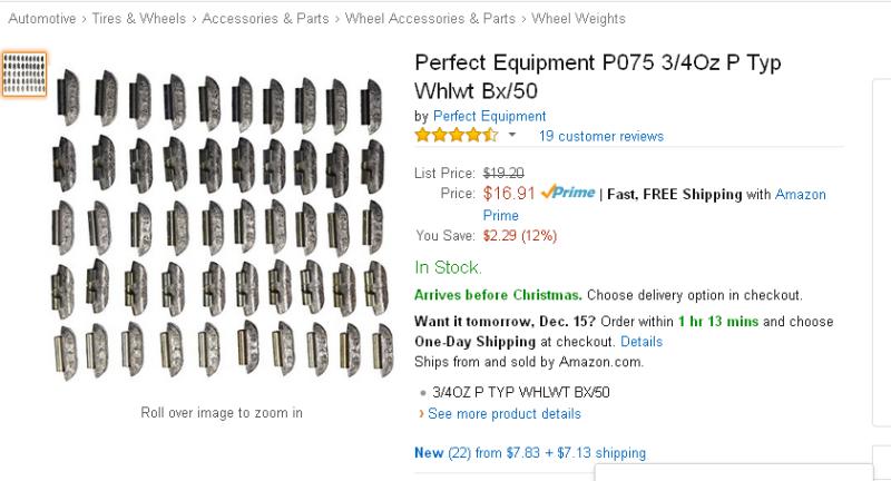

My main question at the moment is which kinds of weights to buy?
Googling, it seems "Perfect Equipment" sells a lot of the weight out there.
For example, here is a $17 50-piece set on Amazon: 3/4OZ P TYP WHLWT BX/50
230744d1481749408-advice-requested-those-you-who-have-mounted-tires-balanced-wheels-home-4_perfect_equipment_weight_set.jpg
But they're all 3/4 ounce, and I probably need fewer weight with better variety.

If it helps you to tell me the type of weights to buy (and sizes), here is a side view closeup of the one (old) weight on the front of the rim.
230745d1481750383-advice-requested-those-you-who-have-mounted-tires-balanced-wheels-home-5_weight_on_front.jpg
And here is a side view closeup of the one (old) weight on the rear of the rim.
230746d1481750390-advice-requested-those-you-who-have-mounted-tires-balanced-wheels-home-6_weight_on_rear.jpg
What type of weight would you get for these rims, and what sizes?

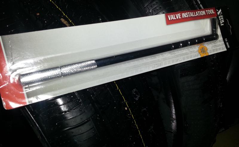

I do recommend getting that $8 valve stem tool. you have all the other, more expensive tire changing gear, its very likely this wont be the last set you do. skimping on that very handy tool seems silly.
I agree that, sometimes, just being able to do the job slightly easier and better is worth it, if you do it more than once.
And I plan on using these tools until I die; so there will be a new set of tires for each car every two years, which means I'll be using them about once a year.
Valve stem puller, about $8 and worth its weight in gold.
I took your advice (and everyone's advice) but the tool was backordered, but I picked it up today:
O'Reilly 15-3606 UPC: 639601536061
230780d1481759064-advice-requested-those-you-who-have-mounted-tires-balanced-wheels-home-7_tire_valve_installation_tool.jpg
No need for the puller, a pair of pliers and a small bit of lube on the stem and it'll pop in with no effort.
You seem to know the most since I agree with you that there really is no need for any special tools to remove the valve or put it back in.
  • To remove the valve is as easy as cutting it off with a utility knife
  • To put it back in only requires screwing something on the threads and using that to pull the lubricated valve through
Anyone with a compressor likely already has something that screws on the end because any beach-ball football soccer ball pin inflator has the right female threads.
But I bought the valve installation tool anyway, just to learn how well it works in both directions because the goal here is to learn myself and to teach others at the same time with your combined experience and mine (working together to create a reference thread that many can use for years in the future).

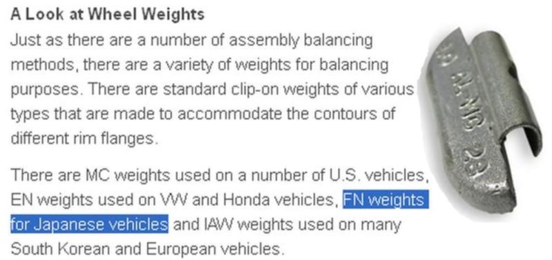

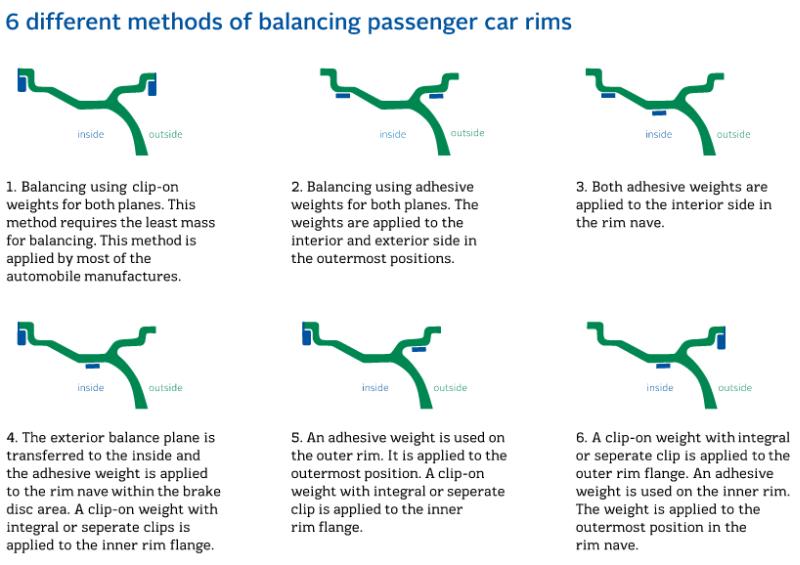

BTW, it looks like I'm on my own for choosing the style of weights, where I found this just now researching what weights to use:
There are MC weights used on a number of U.S. vehicles, EN weights used on VW and Honda vehicles, FN weights for Japanese vehicles and IAW weights used on many South Korean and European vehicles.
That doesn't prove that I need FN weights, but it implies that I do.

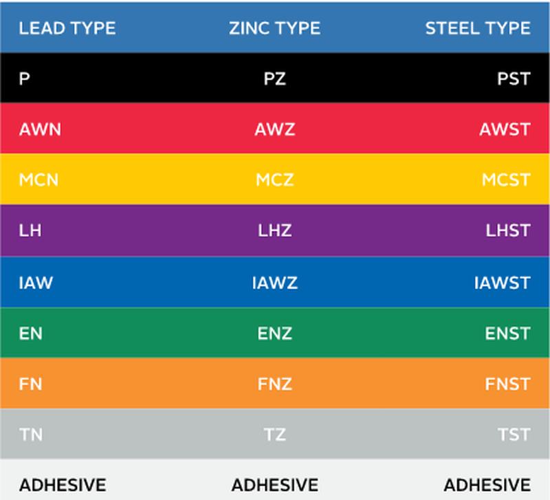

It seems from that same PDF that FN, which is the type that most japanese cars use, can't be used in California, so, I'll need FNZ (zinc) or FNST (steel) if FN is indeed the style of weight to use for the Toyota 4Runner.
It gets more complicated the deeper I read about matching weights correctly!

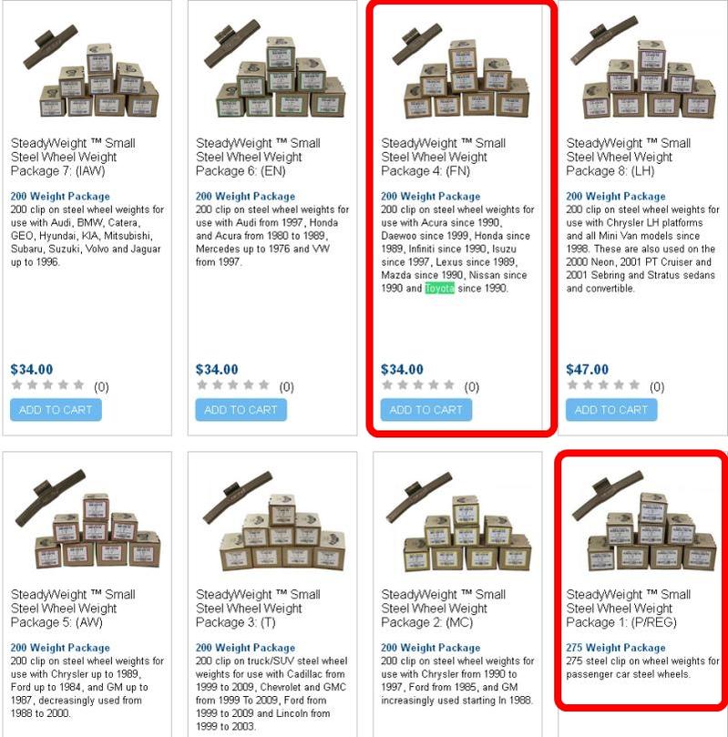

Bearing in mind that the trailing "Z" is for zinc and a trailing "ST" is for steel, and the U stands for uncoated, and that the sizes are generally 0.25 oz. to 3 oz each.
The PZU-Series zinc uncoated (PZ is coated) (PST-Series steel) clip-on wheel weight is used on standard passenger car 13”–17” steel wheels.
The AWZ-Series zinc (AWST-Series steel) clip-on wheel weight is used on most domestic vehicles equipped with alloy rims that were manufactured prior to 1995.
The MCZ-Series zinc (MCST-Series steel) clip-on wheel weight is used on most domestic vehicles equipped with alloy rims.
The LHZ-Series zinc ( LHST-Series steel) clip-on wheel weight is used primarily on late-model Chrysler cars and is designed to fit their unique wheel flange profile.
The IAWZ-Series zinc ( IAWST-Series steel) clip-on wheel weight is used primarily on most European and certain Asian vehicles equipped with alloy wheels.
The ENZ-Series zinc ( ENST-Series steel) clip-on wheel weight is used primarily on Audi, Mercedes Benz and early-model Japanese vehicles equipped with alloy wheels.
The FNZ-Series zinc (FNST-Series steel) clip-on wheel weight is used primarily on most Japanese vehicles equipped with alloy wheels that were manufactured prior to 1990.
The TZ-Series zinc ( TST-Series steel) clip-on wheel weight is used primarily on most domestic light trucks equipped with decorative and larger-thickness steel wheels and most late-model light-trucks equipped with alloy wheels.
Note that the FNZ/FNST says "prior to 1990" but I think they mean *after* 1990.
Based on this somewhat confusing information (due to typos), I think most of you with alloy wheels would use the FNZ or FNST style; but I think, with the steel wheels I'm working on, that I probably need the PZ, PZU, PST, and PSTU styles for zinc, steel, coated and uncoated respectively.
But I'm not sure yet, so if anyone knows that I take the PZ or PST, please let me know.

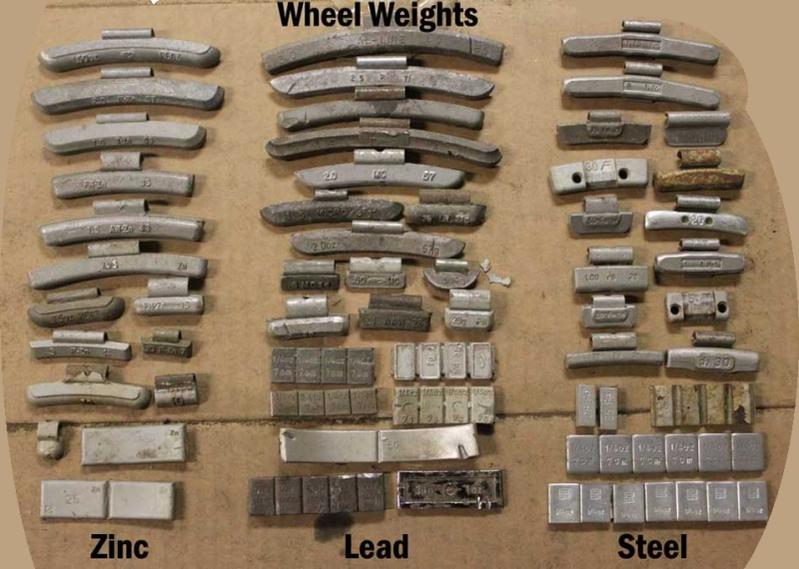

Damn, I didn't know wheel weights went that deep. We use ones that look like the one on the front of your wheel for all steel wheels. Not sure what type the are. You'll want weights varying from .5-2.0 OZ based on my experience.
until you get a stubborn stem, and struggle to get it in place without ruining the threads.
FYI, that tool is a remover also. no need to mess with a knife.
for the weights, the FN's will be for alloy wheels. steels wheels should just use a basic steel wheel weight, for pretty much all of them.
honesty, because of how convoluted the wheel weights are, you are probably better off sending the tires out for balance, after you have mounted them. if you intend to balance all the tires/wheels you come across, you will need hundreds of dollars worth of weight laying around. expensive, and they take up a lot of space.
OR, you could just go with stick on weights. you don't get as good of a balance, and I believe they are a bit more expensive. but, they are universal. don't forget to keep some break cleaner handy, for cleaning the wheels, otherwise the weights wont stick well.
I don't know what they charge there, but around here its $15 a tire to balance. thats not so bad, once you consider all that it takes...
yes, they are ridiculous anymore. basically a weight design for each manufacturer.
I agree with you that I'll want a variety of weights, probably only obtainable in boxes of 50. So, now that I know what I didn't know before, I think the solution, in hindsight, is simply to order four or five boxes (of 50) of the most needed sizes.
I'm assuming those sizes I'll need are the smallest, and the largest, and a few somethings in between.
I appreciate the advice. The advice is helpful, because, this is one situation where the right tool for the job is very cheap (about 8 bucks, just like you said it would be).
Plus, this tool that you kindly suggested is a Goldilocks size and shape in that it's big enough not to get lost in a toolbox (like the four-way tool likely will) and yet it's a perfect size and shape to fit in the drawers with the other related tools.
I know. In fact, I can't wait to try it out when I get the other four wheels for the removal task, since it seems that it can remove old valve without destroying it - just in case we need a spare in a pinch. I don't plan on re-using valves, but, having spares around won't hurt.
Another thing this tool allows is to remove a valve on a tire that is still on the rim, only with the bead broken. I don't envision replacing valves without removing the tires, but this tool makes that task easier also.
I see now, after reading the half-dozen manufacturers' entire catalogs, that the weight I need is probably the "most" standard of the dozen or so different types for passenger tires.
My first pass at guessing the sizes that are needed for a homeowner is the following:
  • 1/4 ounce (probably about 10)
  • 1/2 ounce(probably about 10)
  • 3/4 ounce(probably about 10)
  • 1 ounce(probably about 10)
  • 1.25 ounce (probably about 10)
I know so much more now than when I started, so, what I know is akin to what you said, which is that if you plan on doing all your neighbor's wheels, you'll need the same assortment of weights that a tire shop carries.
However, if all you do are the couple of vehicles you own, it's a lot easier to stock parts. More so, I see now that weights are sort of like nuts, bolts, screws, and washers, in that you can stock them as you see them (e.g., as you find them walking on the road), so that when you need them, you have a "stash" collected over the years.
The brake cleaner is a good idea. So are the stickon weights, as they are essentially universal. And HF sells them, so today I picked up the two sizes that HF sells of the stickon weights, which will have to do for this job (for now).
After reading a half-dozen catalogs, I have to agree with you that the variety sure seems more than it needs to be.
Given that, and noticing that the wheel I'm working on has two different shaped weights, I suspect that the tire shops often put the wrong wheel weights on, simply out of expediency.
