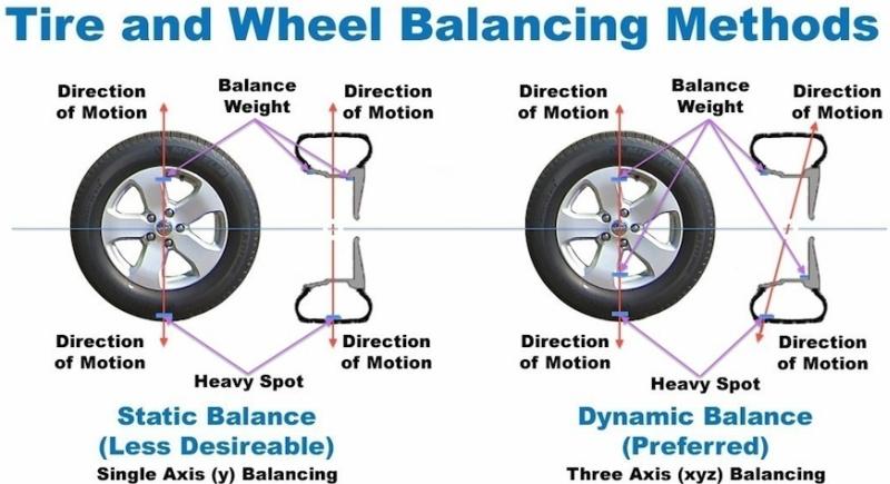

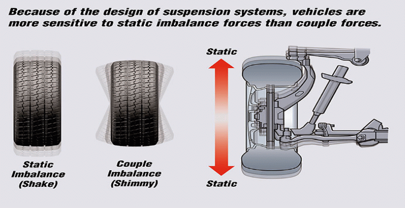

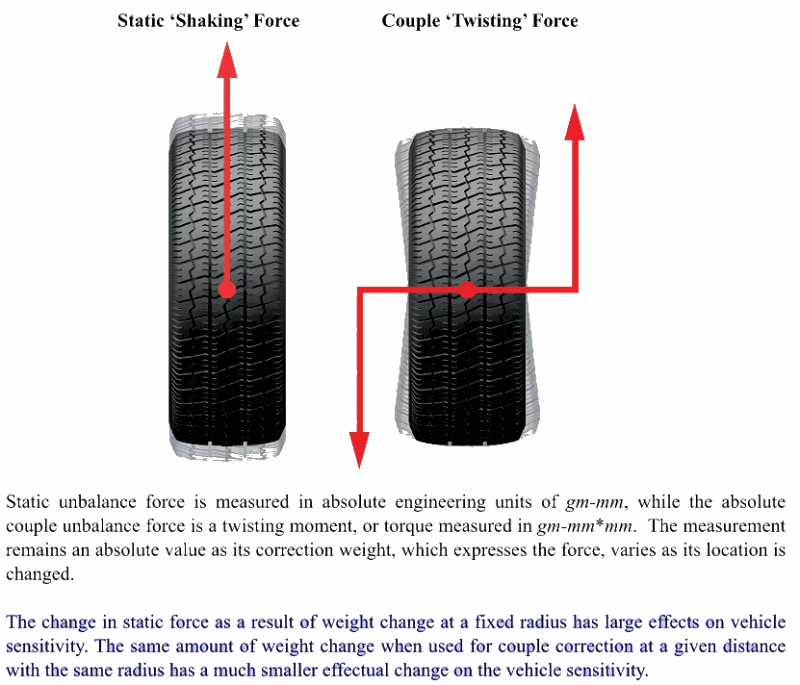

But if you don't answer this question about lack of any palpable vibration while driving, then you can't possibly defend your statement above:
QUESTION THAT MUST BE FAITHFULLY ANSWERED TO BE FAIR TO YOUR OWN STATEMENT:
If the car doesn't vibrate after a careful static balance, what would the benefit of dynamic (road force) balancing be?

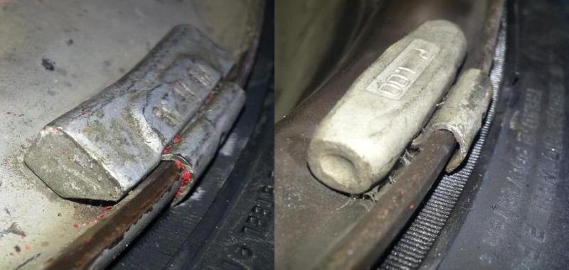

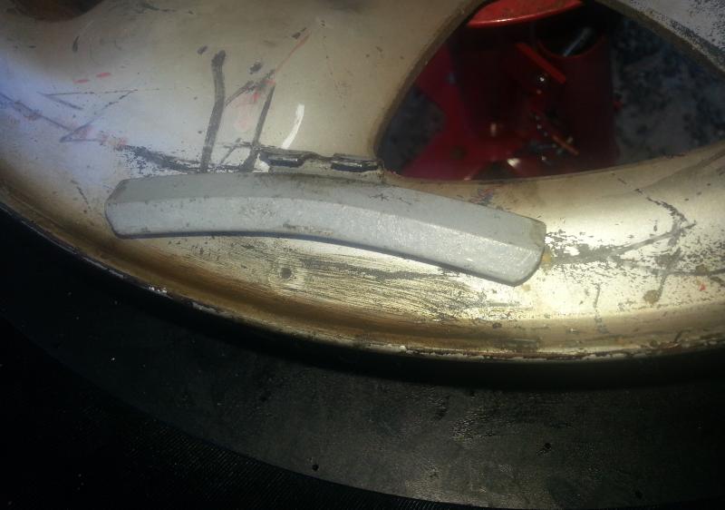

To that end, I only have a single Toyota wheel in my possession, which has two very different looking wheel weights on them, and, from the looks of them, they could even be of two different ages.
If that is the case, then they seem to be improperly mounted.
Does it make a difference?
Probably not.
But my point is that knowing how to do something allows you to tell if someone else is doing that job correctly.
EDIT: I have since found out that the weight on the right (which was on the inside of the rim) is the wrong type, so, we know this wheel wasn't balanced by the book (which fits my assessment that almost no tire is ever mounted and balanced correctly when taken to a tire shop).
Even tire wear, longer tread life, and less wear on components in the steering and suspension. You may not detect a vibration via a butt in the seat, but that doesn't mean that the balance is as close as it can be or that a harmonic distortion isn't present.
If you suspect that static balance is as good as it needs to be, balance one tire/wheel. Make note of the weight used to balance it and the location. Remove the weights and have is dynamically balanced and make note of the difference in weights and locations.
Dynamic balancing also has the ability to tell you if a tire is out of round. The same can't be said about static.
If your end goal is only to remove vibration you can feel, by all means consider it a success.

Curious; so you believe that an entire industry transitioned from static to dynamic balancing (with all the associated retooling and equipment costs) on a whim, driven by the sales pitch of equipment manufacturers?
I never said wheels don't need to be balanced.
  1. Static balancing is primary
  2. Dynamic balancing is secondary
  3. Road-force balancing is tertiary
Given that static balancing is the primary balancing, and that dynamic and road-force balancing are not realistically achievable at home, all I ever said was that I've asked tire professionals and people here the basic question:

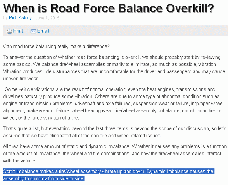

This is a defensible question which is based on pure logic.
While anyone can guess (so can I), if you have a definitive answer to that simple logical question, I'm all ears.

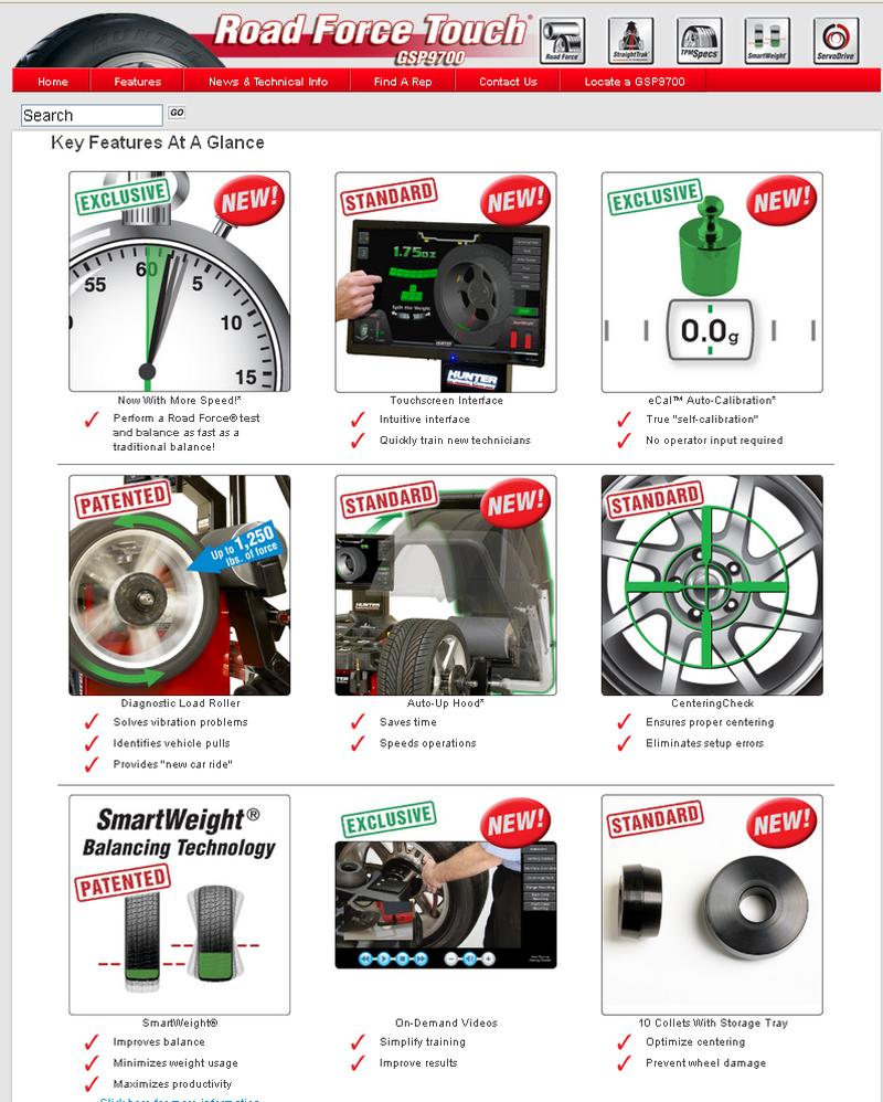

Splitting the weight between the outside and inside of the wheel helps maintain dynamic balance. My experience indicates that static balance is much more important than dynamic balance. I might expect dynamic balance to be a factor on very wide rims, but on my 5-inch-wide rims, it does not have a noticeable effect. Nonetheless, it is a good idea to try to maintain dynamic balance.

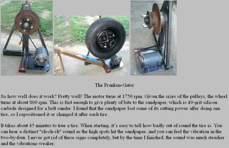

The guy brought up another problem with the tire-balance shops which I need to research for my vehicles:
Most tire balancing machines have the [wrong hub adapters]. They are designed to be used with cone-shaped fixtures that position the wheel by its center hole. My wheels have a center hole that is not designed to be used for this purpose, so an adapter with lug bolts is required to bolt the wheel to the balancing machine. Every tire shop worker has ignored this fact and attempted to balance my wheels using the center hole, proving that a balancing machine is only as good as its operator.

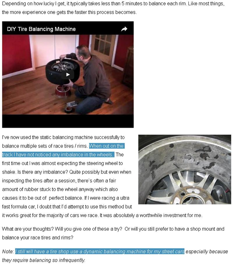

While every person has an opinion, what I'm searching for, just like you would, is a scientific study with valid repeatable peer-reviewed tests, and so far, I haven't found it.
I found this article where the guy "says" his static balance works fine on "his" race cars, but it's not a scientific study by any means, so I'm still looking for the answer in science.
If I were racing a ultra fast formula car, I doubt that I’d attempt to use this method but it works great for the majority of cars we race.
I'm still looking for a scientific study, where I found this reasonably detailed white paper from an engineer at Hunter which discusses algorithms:
In that paper, they mention that vehicle suspensions are much more sensitive to static imbalance than to dynamic imbalance.
All vehicles are inherently much more sensitive to the unbalance correction weight of static force (shake) then couple force (shimmy). Static residual forces are affected by small amounts of correction weight while couple residual forces require much larger amounts of correction weight in comparison, while the couple twisting force expressed in incremental correction weight units ends up having much less effect on the vehicle.

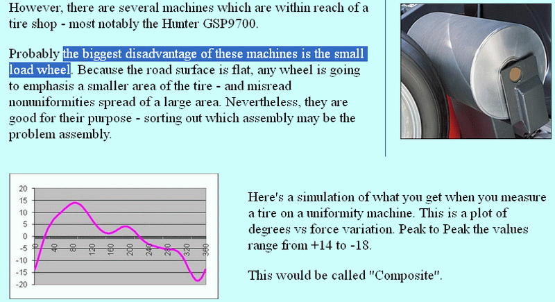

As I look for scientific (aka reliable) papers, I found this very interesting article which says that match mounting is NOT for balance purposes!
Some folks think [match mounting] is for balance purposes, but this is always done for reducing the Radial 1st Harmonic.
I hope it would be obvious from all this that force variation has nothing whatsoever to do with the weight distribution within a tire and therefore, there is no connection with balance. Put another way, you would be mistaken if you think matching the marks is reducing the balance weights needed.
Another interesting point made in that article was the fact that the driver is usually most sensitive to the left front wheel imbalance:
As a general rule, the most sensitive wheel position (to the driver, which is who is usually judging the vehicle) is the Left Front, and the least sensitive position is the one farthest away – the Right Rear.
The purpose of match mounting and the sensitivity of the driver to specific wheel imbalances aside, the article does clearly state that dynamic balancing is better than static balancing; but it still doesn't answer the basic logic question of whether dynamic balancing is needed if the driver feels no vibration after static balancing.
Note: I sent [email protected] a note asking him the question, and providing this URL as a reference, so, I'll let you know if/when I get a response.

However, I read a bunch of the Hunter PDFs and white papers, where Hunter seemed to be really (really really really really) trying to convince tire shops that they needed their fancy equipment.
For example, all these are on this one page by Hunter: (EDIT: See graphic below.)
  • Perform a Road Force® test and balance as fast as a traditional balance!
  • Saves time
  • Intuitive interface
  • Quickly train new technicians
  • True "self-calibration"
  • No operator input required
  • Speeds operations
  • Minimizes weight usage
  • Maximizes productivity
  • Simplify training
Read the PDF I posted prior for example. Read the references I already quoted. They all try to convince the tire shops that they can get more cars out the door with fewer callbacks with dumber techs using the fancy equipment. (It's the same argument for fancy tire-alignment racks.)

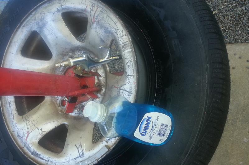

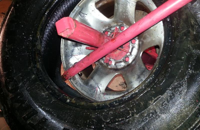

I've done now two 60-series passenger tires for a sedan, which had very light 16-inch alloy wheels, and both were a breeze.
But breaking the bead on these Optimos is not something you want to do in front of genteel company, as your vocabulary will not be polite during the process.
To get back to the mounting and balancing so that others can benefit who want to do their own mounting and balancing at home, I did another wheel last night and I continued to learn that the Harbor Freight equipment is stressed to its max by these Optimo tires, even with the block of wood shoring up the breaker arm, and a longer pipe for leverage:
231348d1482166953-advice-requested-those-you-who-have-mounted-tires-balanced-wheels-home-0_long_arm_on_bead_breaker.jpg

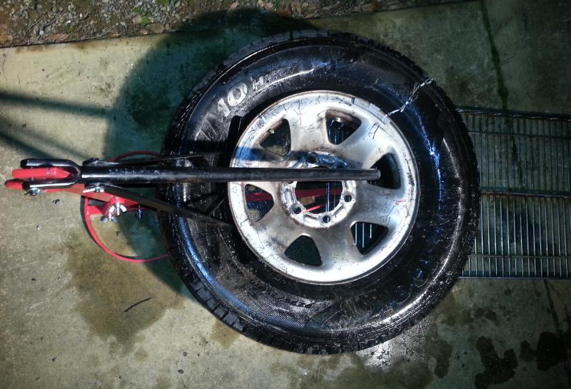

The wood fell out and the metal starting bending again, so I broke out the HF Pittsburgh Bead Breaker item# 92961
231349d1482167056-advice-requested-those-you-who-have-mounted-tires-balanced-wheels-home-1_break_out_the_bead_breaker.jpg

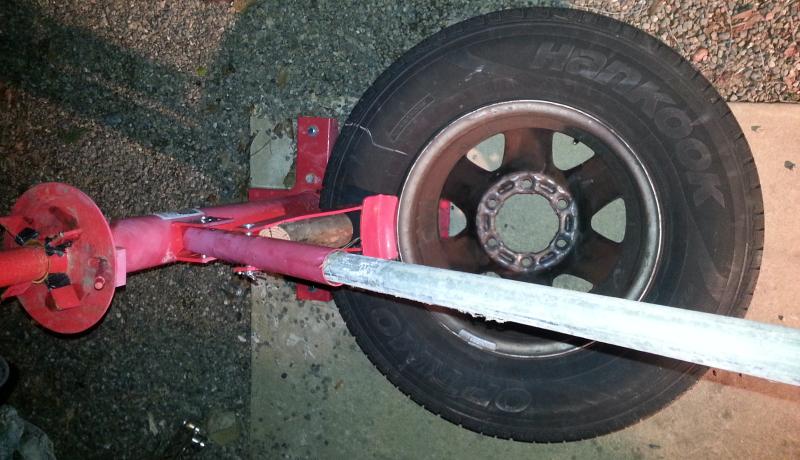

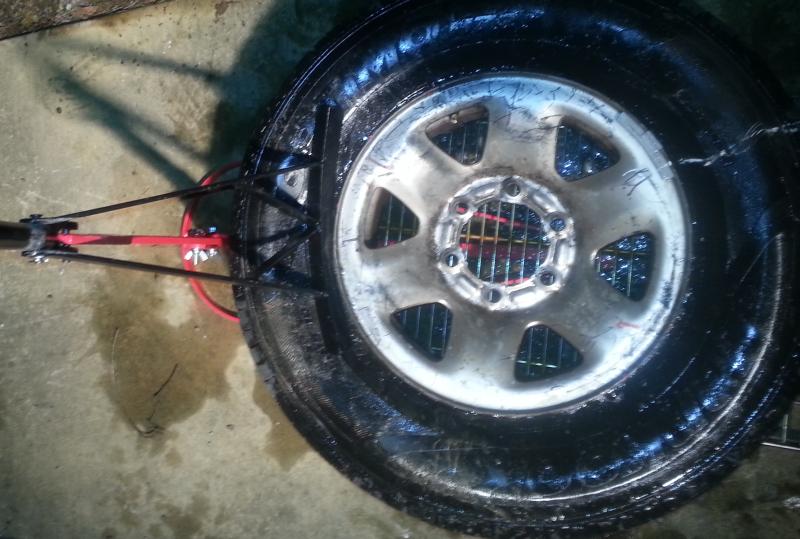

Here you see the old and new bead breakers for size comparison:
231350d1482167533-advice-requested-those-you-who-have-mounted-tires-balanced-wheels-home-2_compare_bead_sizes.jpg
Just in case it was possible, I tried both at once, but you need two people if it's gonna stand a chance of working.
231351d1482167650-advice-requested-those-you-who-have-mounted-tires-balanced-wheels-home-3_try_both_at_once.jpg
Even with the newer bead breaker, it's still very difficult to break these Optimo beads:
231352d1482167690-advice-requested-those-you-who-have-mounted-tires-balanced-wheels-home-4_it_is_very_hard.jpg
Finally, I was able to get the back bead broken (the first and the last beads are the hard ones, where the first is the hardest of all, by far):
231353d1482167768-advice-requested-those-you-who-have-mounted-tires-balanced-wheels-home-5_it_is_very_hard.jpg

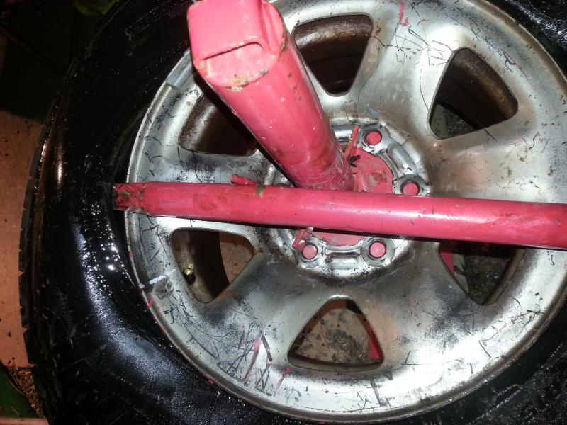

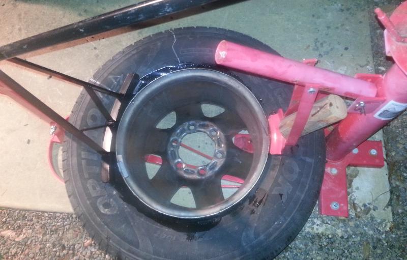

Flipping the 15-inch tire to the front side, a design flaw in the bead breaker showed up which was that the rim is a different diameter which doesn't touch the front of the bead breaker (under the tire) which causes the bead breaker to lift up, making it useless.
231354d1482167826-advice-requested-those-you-who-have-mounted-tires-balanced-wheels-home-6_the_front_lifts_up.jpg

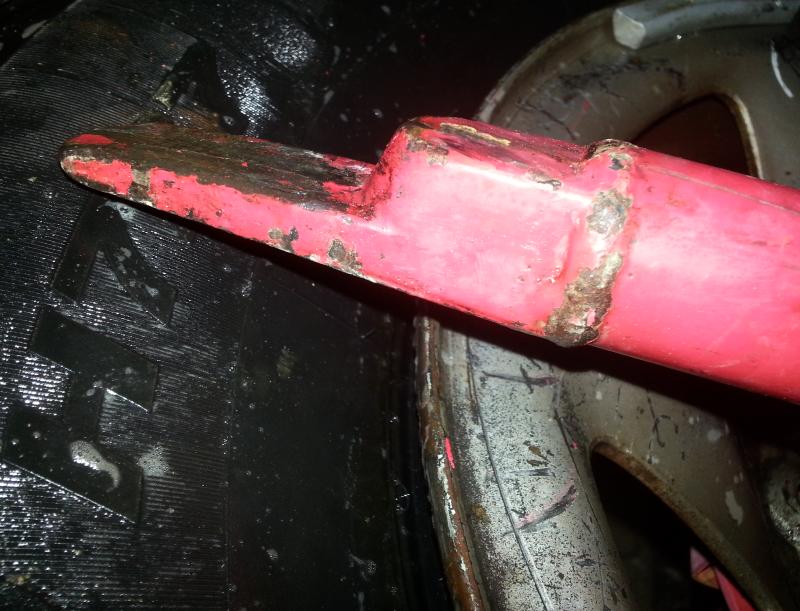

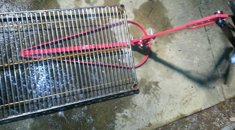

The HF bead breaker needs to be an inch or three longer, so I grabbed whatever was handy to extend the length of the tapered end:
231355d1482167896-advice-requested-those-you-who-have-mounted-tires-balanced-wheels-home-8_need_to_hold_the_front_down.jpg
It took me a couple of tries to realize that the extension needs to only be on the tapered end because you need the little welded-in chock that holds the wheel close to the vertical stem of the bead breaker.
231357d1482168139-advice-requested-those-you-who-have-mounted-tires-balanced-wheels-home-9_but_you_need_the_bump.jpg
So I moved the extension out to just cover the last few inches of the tip of the tool base:
231358d1482168166-advice-requested-those-you-who-have-mounted-tires-balanced-wheels-home-10_needs_only_on_the_end.jpg

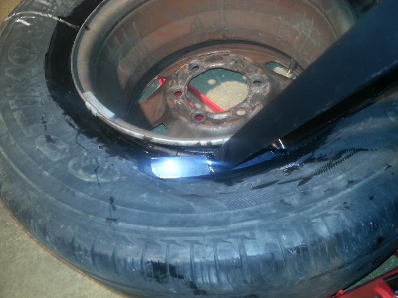

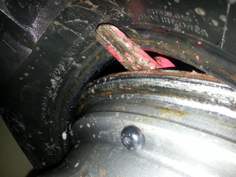

Once the top bead was broken (which is far easier than the bottom bead once you nail down the bead-breaking tool), I easily removed the top bead from the wheel on the tire changer tool.
231359d1482168223-advice-requested-those-you-who-have-mounted-tires-balanced-wheels-home-11_top_bead_is_easy.jpg
For reference, for someone doing this in the future, the tool goes with the step-side up, like this:
231360d1482168254-advice-requested-those-you-who-have-mounted-tires-balanced-wheels-home-12_put_the_step_side_up.jpg
The tool goes in the same orientation to remove the bottom bead from the rim, which is only very slightly more difficult than removing the top bead from the rim.
231361d1482168297-advice-requested-those-you-who-have-mounted-tires-balanced-wheels-home-13_same_with_the_bottom_bead.jpg
Here is a closeup of the bottom bead coming off and the positioning of the tool tip:
231362d1482168337-advice-requested-those-you-who-have-mounted-tires-balanced-wheels-home-14_bottom_bead_position.jpg

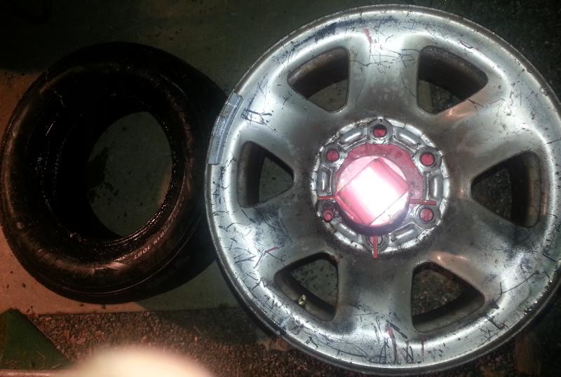

This removes the tire from the wheel:
231363d1482168378-advice-requested-those-you-who-have-mounted-tires-balanced-wheels-home-15_tire_off_wheel.jpg

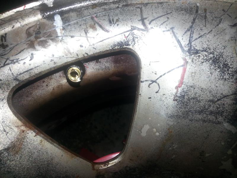

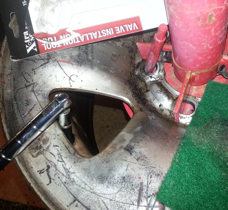

For the record, I destroyed the tire valve in the process, so, it's a good thing to do the tire valve last before you put the tires back on the rim.
231364d1482168454-advice-requested-those-you-who-have-mounted-tires-balanced-wheels-home-16_damaged_valve_threads.jpg
I didn't get to use the fancy valve-removal-and-replacement lever because the threads were so messed up, so I just cut off the valve, and I used the fancy lever tool to insert the valve, but, it really wasn't worth the trouble since it would have been easier to just pull the tube on with the end of one of my threaded compressor soccer-ball filling attachments. \
231365d1482168655-advice-requested-those-you-who-have-mounted-tires-balanced-wheels-home-17_replaced_valve_stem.jpg
Putting the bottom bead of the new tire on the rim is anticlimactic, in that you can almost press fit it on with your hands (I levered on only the last 1/4 or so with the red tire iron).
Putting the top bed on requires the other end of the tool, and it's the second hardest bead to deal with, but it's nothing compared to the effort breaking the first bead.
However, when you put the top bead on, that's when the base is stressed the most, and when you'll be most glad you bolted it down.
This tire was a little cranky when filling with air as I had a tougher time cajoling the bead into position to seal. I needed three hands, two to hold the tire against the rim and one to press the trigger on the fast fill (the Schrader valve was removed) for the air.

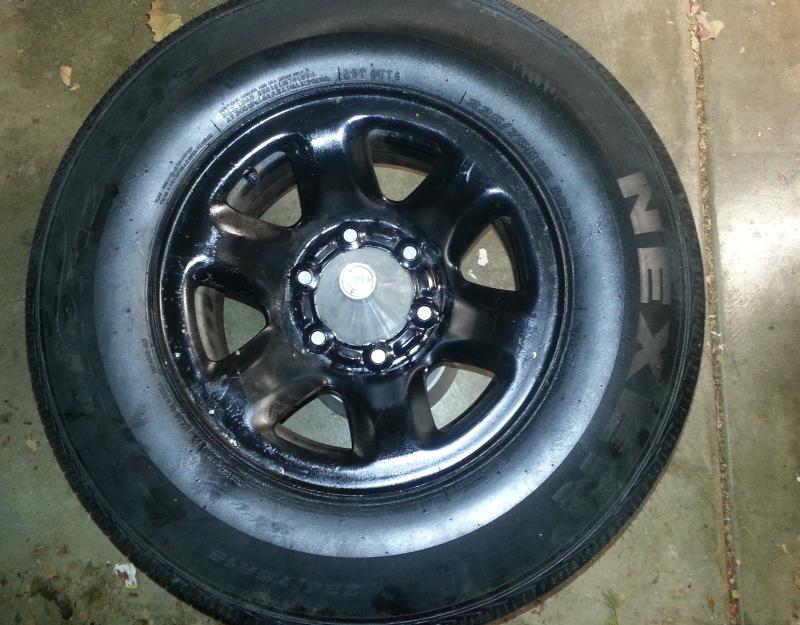

Because the rim was so scratched up, I decided, on a whim, to spray paint it black. Dunno how that will look (nor if the owner will even notice) but it's done already.
Here is that wheel above on the static balancer...
231408d1482187701-advice-requested-those-you-who-have-mounted-tires-balanced-wheels-home-002_balance_is_goog.jpg
for future reference, its a good idea to remove the weights prior to dismounting the tire. as the tool can catch on the weight and cause a problem. maybe even slide the weight around.
did that machine come with a plastic cover for use with alloy wheels?
also, start at the valve stem to avoid damaging it. meaning, put the tool in, and lift the bead up AT the stem. as you wont be replacing them every time a tire comes off the wheel.
This is very good advice.
I would have removed the weights but I was doing an experiment to see if the new wheel balanced the same (it didn't).
I removed the weights just by "chipping" them off with a chisel and hammer, but, I think investing in the weight removal tool is probably more useful than investing in that valve installer/removal tool.
f
I already did two alloy wheels (I'll snap a picture soon to show you as I have a flat that I want to repair that is on alloy wheels) and the tool doesn't mar them in the least (it just leaves red on the very edge of the rim which is nothing).
However, for my friend's alloy wheels, we fashioned a set of plastic covers, just as you suggested, out of a prestone coolant jug (we got the idea off the web). It works just fine so that's not a problem.
I should note that I painted that last steel wheel, because it was so scratched up, but all the scratches existed prior.
This is good advice. I am not sure when the valve stem got chewed up but it was probably in all the gyrations that occurred when I was breaking the bead. I doubt it happened when I was removing the beads, but I wasn't looking and it was pitch black outside since I was doing it at night with just a flood light that was 20 feet away as the coyotes howled at me.
