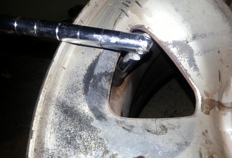

Nonetheless, I learned a lot and in the six tires I've done this week, I learned a few tricks, which is a good thing.

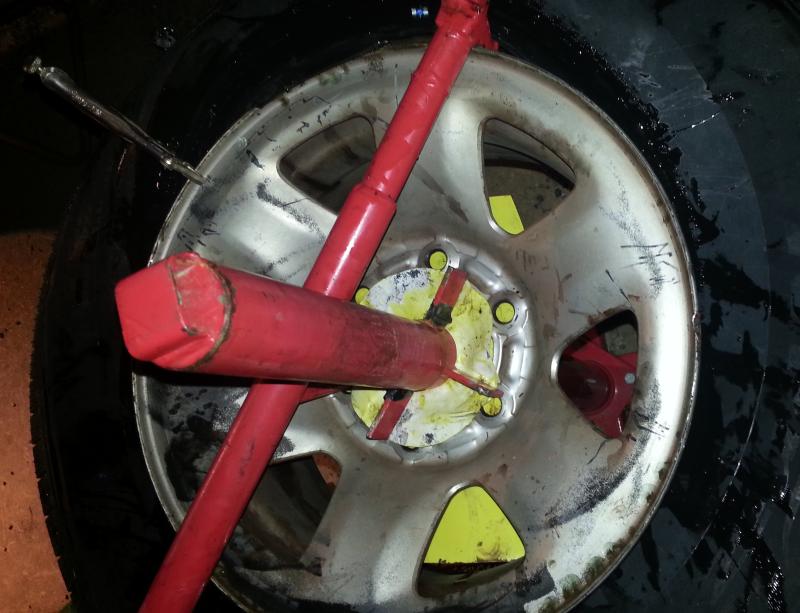

For example, hooking a tire iron inside the wheel rim when putting on that last very slippery bead works wonders to keep the very slippery tire from simply spinning on the wheel rim.

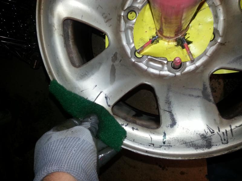

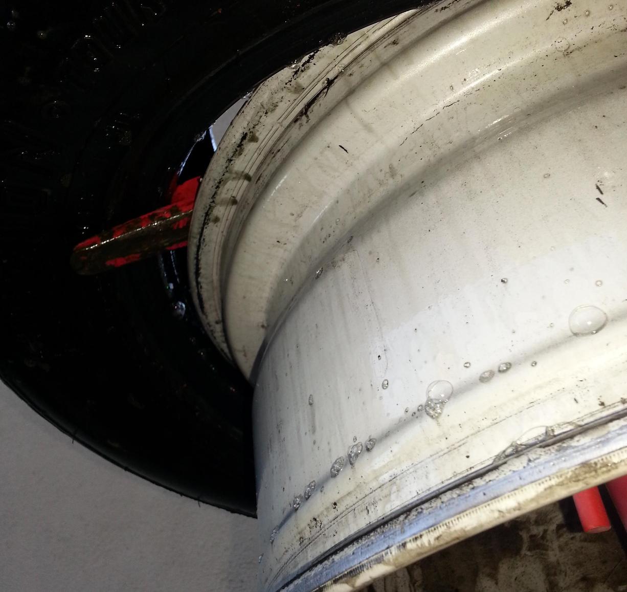

Anyway, I learned another hint today which others reading this can benefit from which is to clean the inside of the lip of the rim with scratchy stuff so as to get rid of caked on rubber. However be careful for sharp edges!

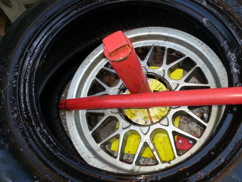

Anyway, I learned something else that everyone already knew, but I'll mention it so that someone reading this thread in the future benefits.

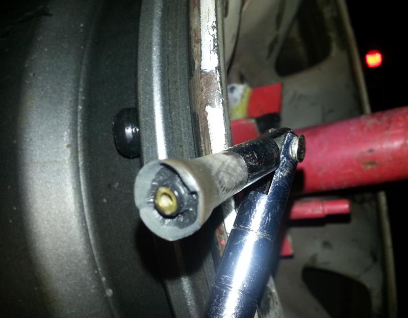

That lever-action valve-remove-installation tool?
I thought, for some reason, that it could push in a valve stem without destroying it; but I found out two things (which should have been obvious from the start), which are:
  1. The tool destroys the valve stem (drawing and quartering it), and,
  2. The tool is a pain to thread onto the valve (because it should spin on a spindle).

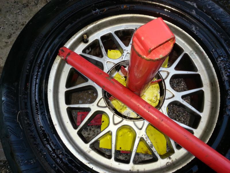

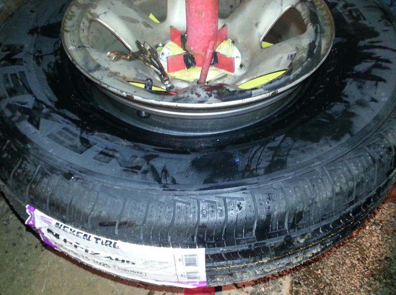

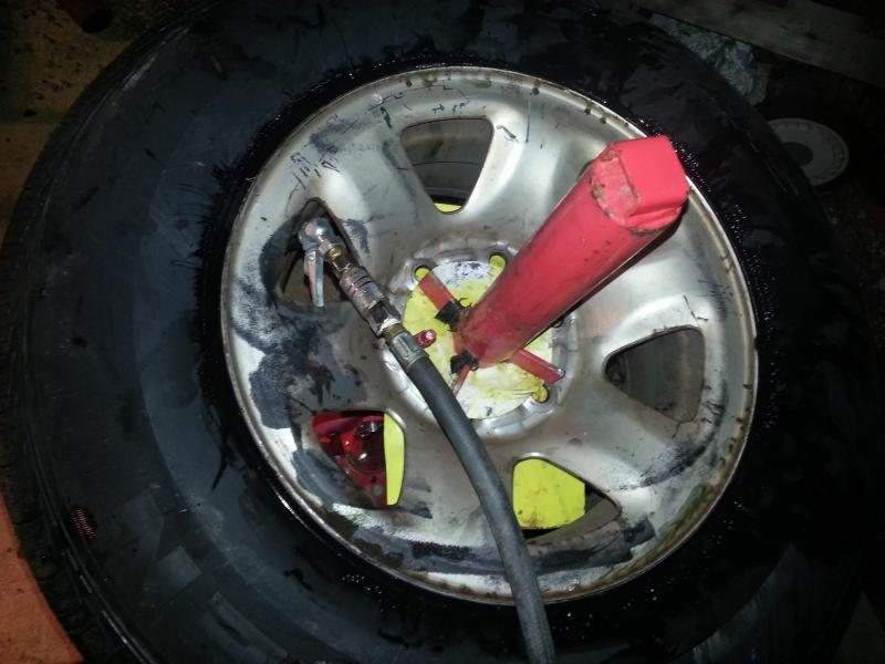

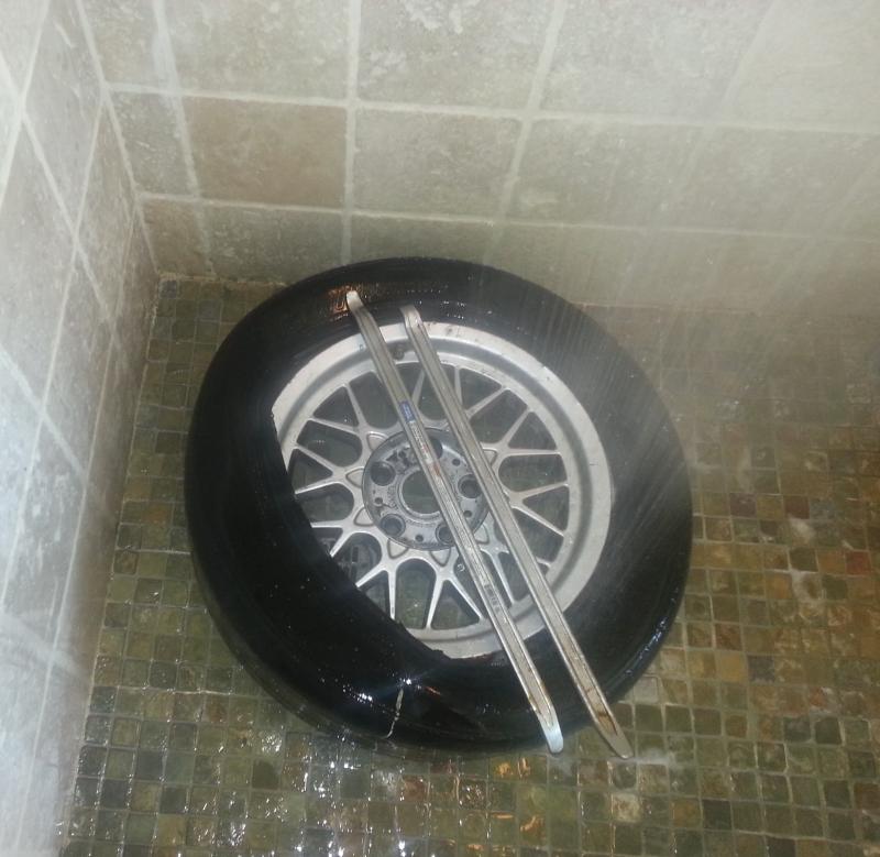

Anyway, I want to pass on an important trick for seating the bead of the new tire when filling it with air.
At first I was just cajoling the tire into seating, but then I realized a simple trick that worked most of the time:
  1. With the wheel facing upward on the tire-mounting machine,
  2. I manually seated the underside (bottom) bead as best I could with hand force, and,
  3. Then I pulled NOT on the entire tire!
  4. I pulled up with both hands just on the OUTSIDE TREAD of the tire!
  5. I had to bring the top bead over the open valve hole!
  6. Once I pulled up on just the tread area, I was consistently able to seal the tire
  7. Which then popped into place, with a resounding pop!
That trick is invaluable, because if you can't get a momentary seal, you'll never set the beads of the new tire.

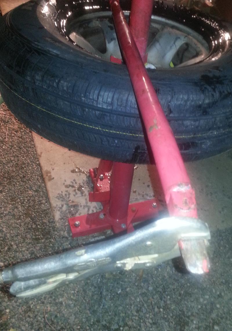

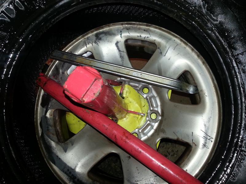

Another invaluable trick is that two different sizes of vise grips are useful when leveraging the last (top) bead of the new tire onto the rim.
Small vise grips are useful for the top beat to prevent the tire from spinning on the slippery rim.
Large vise grips are useful on the end of the handle to keep it from spinning (which causes the business end to slip off the tire bead, necessitating starting over).

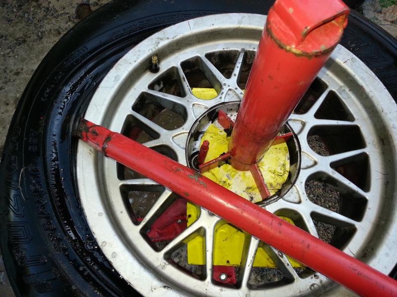

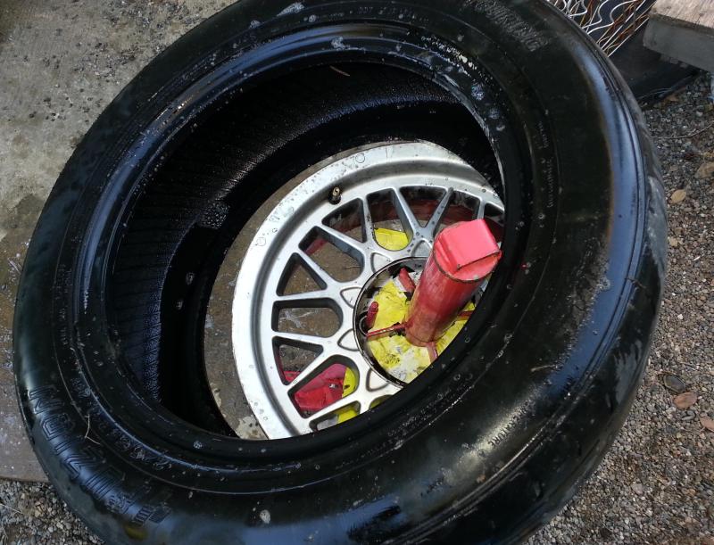

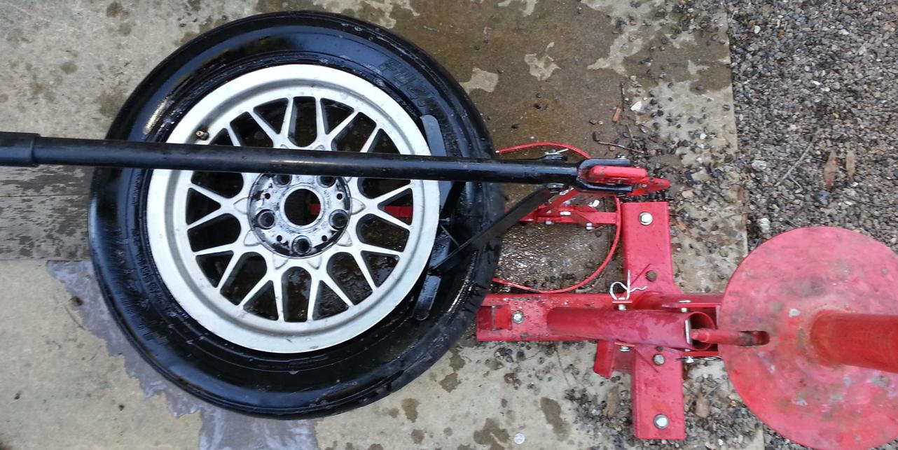

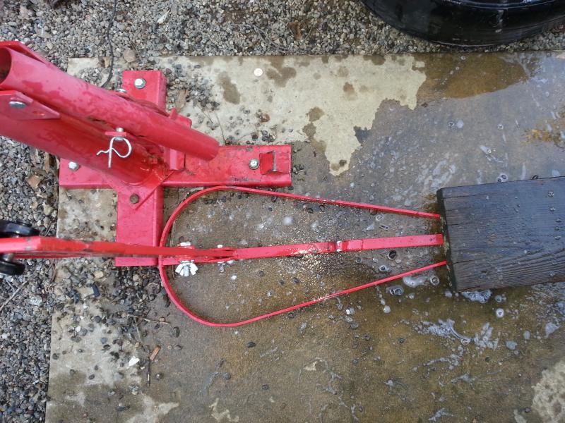

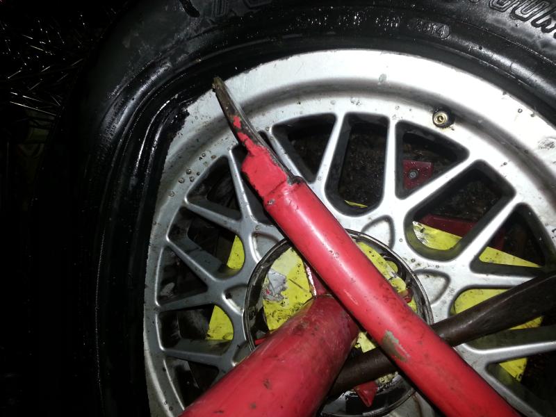

Two other tricks I learned which are invaluable for breaking the first (inside) bead of the old tire were
  1. A board worked better than the wire-rack shelf to hold down the bead-breaking machine, and,
  2. I had to move the bead breaker two or three inches at a time all around the circumference of the rim to finally break the bead!
Just those two hints make the breaking of the first (inside) bead more manageable!

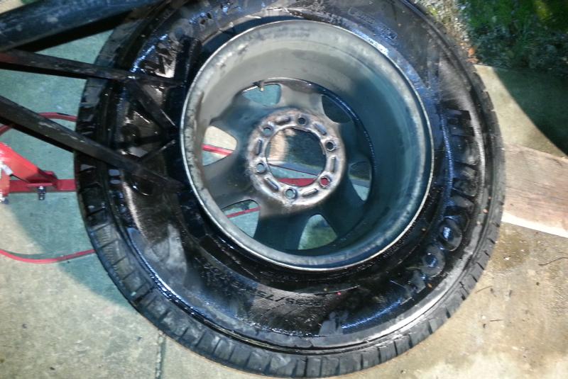

Overall, I would have to say the Harbor Freight tools stunk, for the most part, but, if you modify them slightly, they will do the job which is hard for an SUV and very easy for a passenger car tire (in my humble experience).
For the tire changing tool, the main modification you must do is you must add a vise grip to the end of the lever bar when levering the last (top) bead of the new tire onto the rim.
For the tire changing tool, you really should give up on the bead breaker, but if you use it, you must shore it up (as previously shown) and you should put bolts in place of the clevis pins (so as to reduce slop which causes it to skewer which bends the metal).
For the tire changing tool bead breaker, you really need a longer lever handle, and, you don't want to use the tire iron as designed, because it can bend and you really need the tire iron, whereas the lever handle could be any old pipe.
For the bead breaker tool, the worse problem is that it is too short so you need to either mount it (but it has no mounting holes) or you need to extend it (I extended it by putting a board on top of it, which worked for me but which is substandard to mounting it).

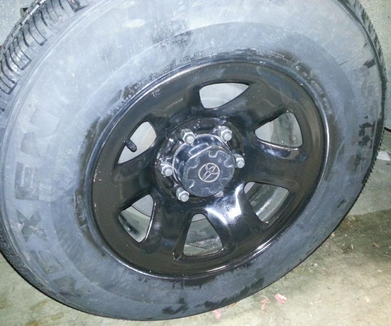

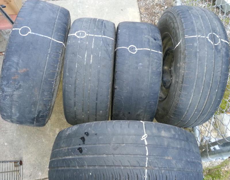

As for special "parts" and materials, you just need to measure the existing valve and buy 0.463" replacements of the same size, and dish detergent, water, and a valve stem removal tool of some sort for twisting out the Schrader valve cores.
For practice, I decided to mount and dismount and repair these five tires today, two of which are 55-series alloy wheel tires and the rest are 75-series SUV tires (all of which are holed within an inch of the shoulder):
231728d1482363894-advice-requested-those-you-who-have-mounted-tires-balanced-wheels-home-000_holes_in_tires.jpg

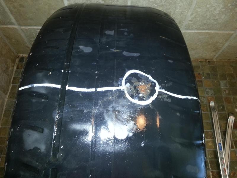

Ignoring the treadwear, what do you think of the safety and efficacy of my patch technique?
The first thing I did was set up the bead breaker with the wood on the sharp end and I butted the round end against the tire changing machine:
231729d1482364084-advice-requested-those-you-who-have-mounted-tires-balanced-wheels-home-00_bead_breaker_board.jpg
Then I easily broke the bottom bead on the 55-series alloy wheel tires:
231730d1482364103-advice-requested-those-you-who-have-mounted-tires-balanced-wheels-home-02_breaking_bottom_bead.jpg
Flipping the wheel, it was even easier to break the top bead of the lower-profile tire:

Once the beads were broken, I put the wheel outward side up on the tire changer to remove the top bead:
231735d1482364672-advice-requested-those-you-who-have-mounted-tires-balanced-wheels-home-04_removing_top_bead.jpg
The top bead came off with a simple 360 degree rotation of the tire iron:
231732d1482364287-advice-requested-those-you-who-have-mounted-tires-balanced-wheels-home-05_done_with_top_bead.jpg
The bottom bead requires the breaker bar to be inserted the same way:
231733d1482364404-advice-requested-those-you-who-have-mounted-tires-balanced-wheels-home-06_removing_bottom_bead.jpg
Then the bottom bead came off the rim almost as easily as did the top bead:
231734d1482364619-advice-requested-those-you-who-have-mounted-tires-balanced-wheels-home-07_removing_bottom_bead.jpg
Now I had the wheel off the alloy rim, I could look inside to inspect for internal damage:
231736d1482364933-advice-requested-those-you-who-have-mounted-tires-balanced-wheels-home-08_tire_off_rim.jpg
After patching the tire first with a plug, and then with a patch, I slid the bottom bead onto the rim without any problem whatsoever.
For one of the alloy-wheel 55-series tires, the top was only slightly hard, but for the second tire of the matched set, I still haven't been able to get the tire on the rim!
231737d1482365125-advice-requested-those-you-who-have-mounted-tires-balanced-wheels-home-bent_tire_iron.jpg
In fact, it took so much force for the second tire of that set, that it bent the tip of the tire iron!
231738d1482365171-advice-requested-those-you-who-have-mounted-tires-balanced-wheels-home-bent_tire_iron_tip.jpg
231731d1482364237-advice-requested-those-you-who-have-mounted-tires-balanced-wheels-home-03_breaking_top_bead.jpg

After leaving the recalcitrant tire and wheel assembly outside in the cold in the 3/4-mounted position for about a week, I finally gathered up the courage to tackle the job again, despite it having previously taken me a couple of hours to fail where I bent even the strongest of steel implements, and damaged both the rim and the bead of the experimental tire, I followed the words of advice to ensure that the top bead was in the drop center.
Taking the lead from the barefoot Filipino in the photo above, I took a shower with this recalcitrant tire & wheel assembly.
232271d1482785280-advice-requested-those-you-who-have-mounted-tires-balanced-wheels-home-01_bead_shower.jpg
I don't know if heating the entire assembly in the shower helped or not (I didn't even use detergent), but it just popped right into place when I stepped on the bead with my bare feet (being emboldened by that photo of the Filipino doing it) to ensure it was in the drop center for as much of the circumferential arc that I could get it.
232272d1482785284-advice-requested-those-you-who-have-mounted-tires-balanced-wheels-home-02_bead_shower.jpg
Much to my relief, the tire bead popped into place with just the use of the two 24-inch tire irons, where there was no need for much force and no need for vise grips or a helper, or anything.
232273d1482785289-advice-requested-those-you-who-have-mounted-tires-balanced-wheels-home-03_bead_shower.jpg
So, while most tires will go into place whether or not you lower the top bead into the drop center, some will NEVER go on the rim unless you do so.
Lesson learned!
Luckily this was just a test tire, as my entire goal was just practice in learning the process for:

  3. Removing and replacing the valve stem

NOTE: It's so easy to get the first bottom bead of the new tire on the bottom of the rim by hand. And, this method gets the second top bead on the top of the rim. Given how easy it is to mount a new tire on the wheel by hand, I wonder if the HF tire-mounting tool does anything useful that you can't do with just tire irons and bare feet in the shower.
The HF tire-mounting tool is useless for breaking the bead, so, you need a separate bead breaker anyway.
I guess the HF tire-mounting tool is best for removing the first and second bead on the old tire (which it does do handily).
