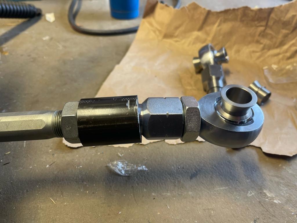

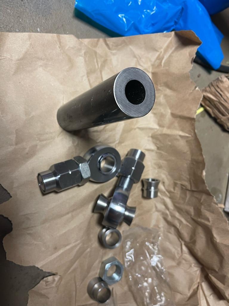

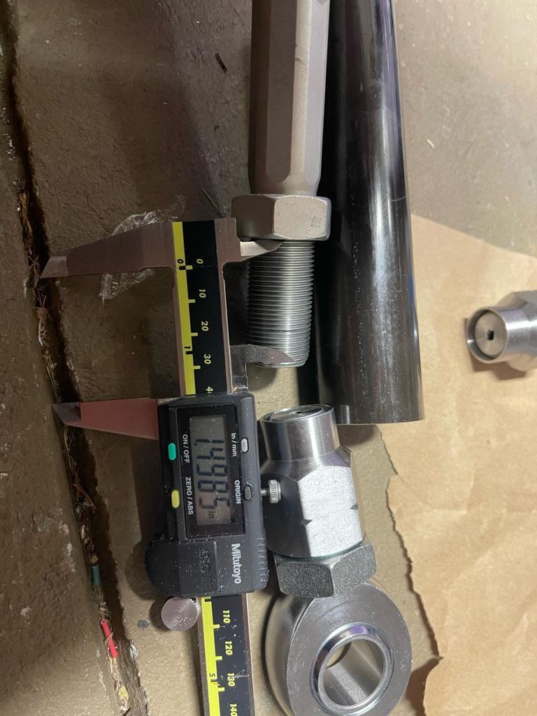

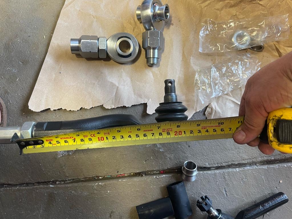

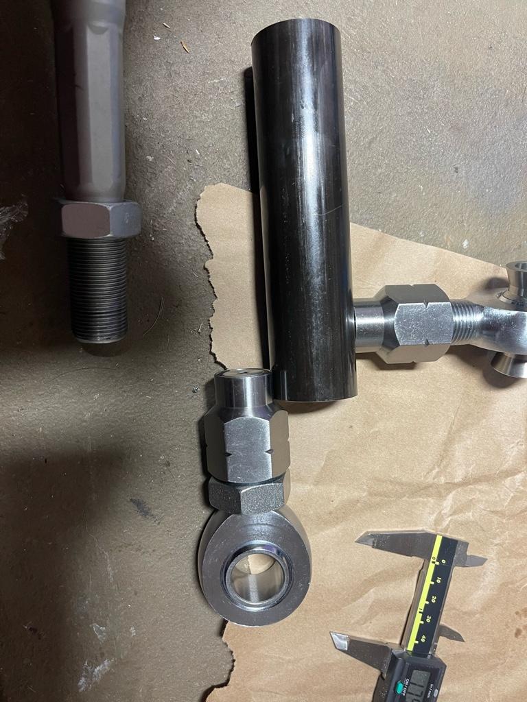

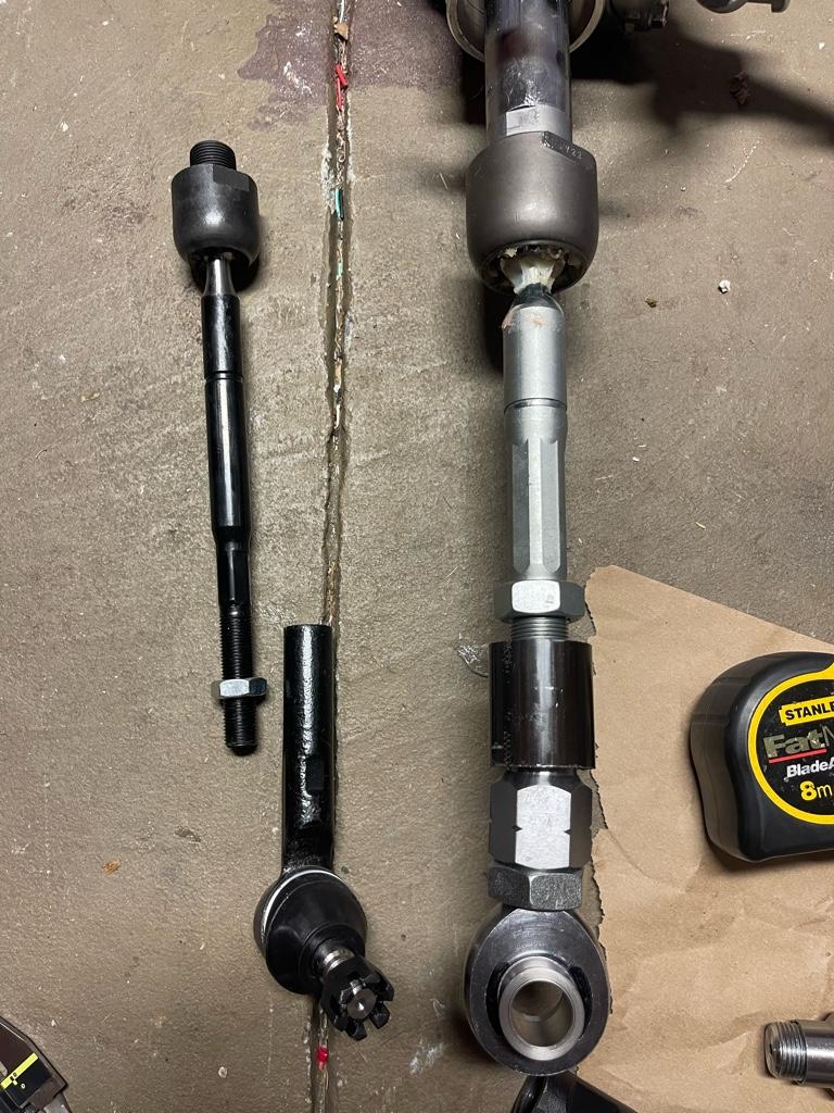

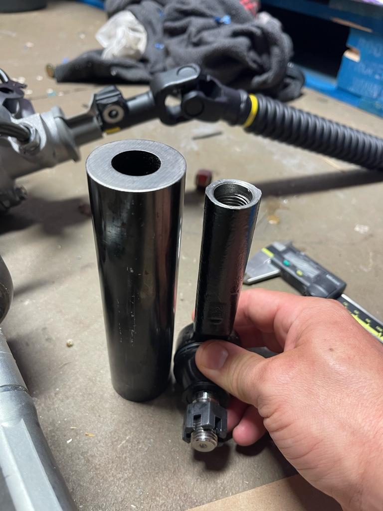

Both the Heims and DOM tubing delivered sooner than expected.. and holy beef batman.. If you thought the LC200 tierods were beefy.. wait until you see this come together..

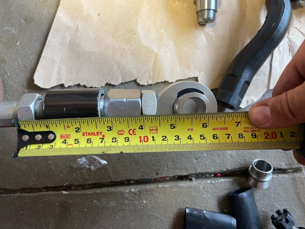

I really need to think about the size of this setup before I get to cutting, drilling and welding.. I feel like I will end up with quite a short piece of tube by the time I stack the heim, lock nut, weld-in bung, and the the tube, i'll probably have maybe a 2" piece that needs to be made up, but I need to make sure it is short enough fully screwed in to give me some toe-in adjustment. The heim joint has probably 1.5" of thread I can screw outward so toe-out adjustment isn't concerning, just need to make sure I can hit just below the minimum total width needed.
Edit: ran out and grabbed some rough measurements and i think I should be ok.. with the inner tierod threads bottomed out on the heim joint threads I have just a bit over 2 inches of space between the inner rod lock nut an the inside of the weld bung for the heim. This is what I'm going to cut the pipe to and drill out to 1" on the welded insert side and 20.5mm on the threaded side. The heims are reverse threaded so I'll be able to easily adjust the toe without having to take everything apart which is nice, originally I was thinking of just having to either undo the heim bolt or or spin the inner tierod for adjustment, but this should work out great.
The limiting factor in this setup will be the inner tie rod threads bottoming out on the heim so I don't see a reason not to go ahead and cut the tube and get everything prepped. I'll probably give myself a bit of wiggle room on the tube and cut it to 1.75" in case I have to end up cutting down the heim threads allowing the piece to screw on further down.. we'll see. This is some super thick stuff.. really wish I had a bandsaw to cut through this but the angle grinder will work just as well.. only messier and louder lol.

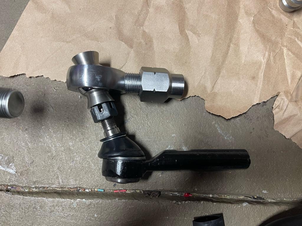

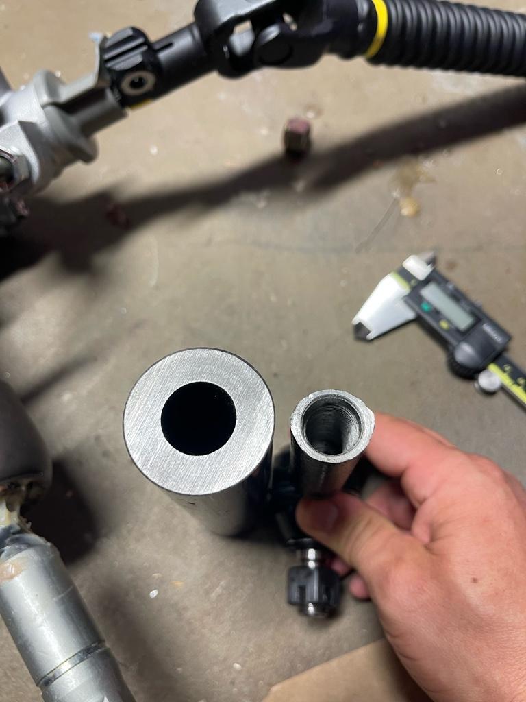

ps: fun fact.. I believe my factory tie rod could fit INSIDE of the DOM tubing.. that's the size difference in diameter we're talking here lol.
Yea.. I wasn’t wrong… the inner tie rod would certainly fit right in lol.
Also, my initial concern of not having enough angle on the heim was not valid. The angle meets, and maybe ever so slightly exceeds the factory tie rod

Pretty stout diameter, should be strong enough by a lot.
How is clearance on the coil over lock to lock?

Won’t know for quite some time lol. I don’t think it will be an issue.. or at least I hope it won’t be but worst case I guess I’ll take the grinder to it , certainly enough meat there to take it down if needed.

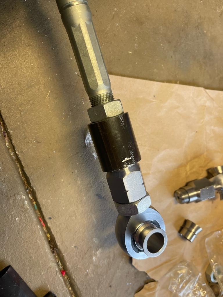

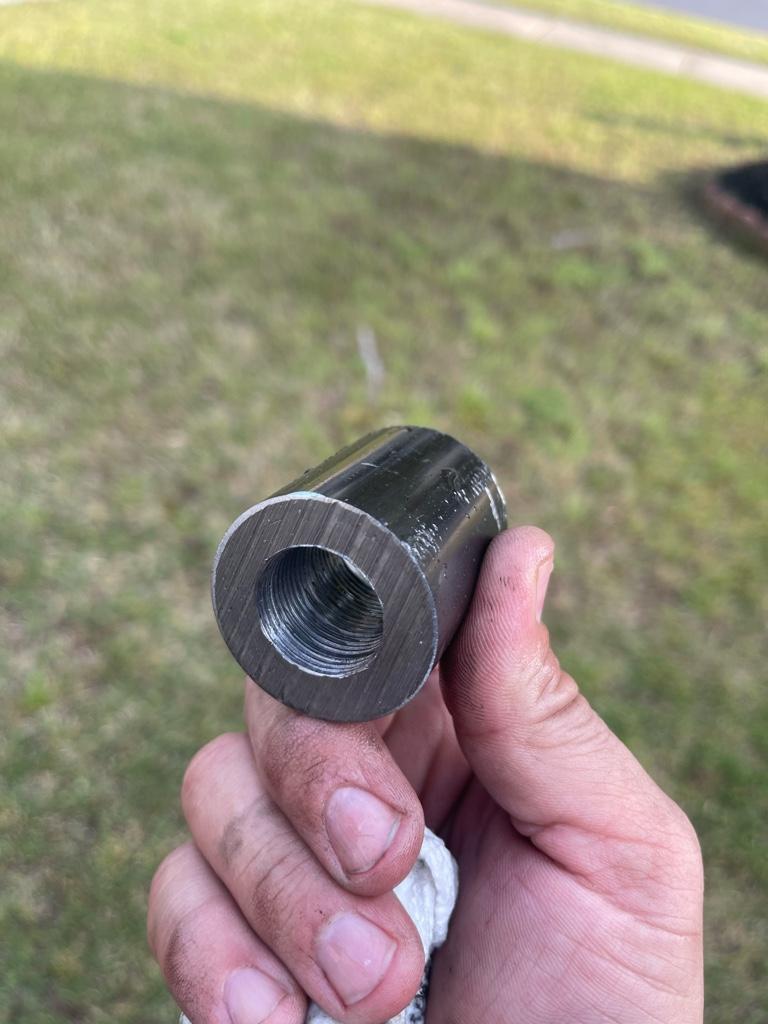

I decided not to wait to fab these up and cut down one adapter. Here is what it looks like so far. I’m measuring a 2.25” difference between the lc200 tie rod with it turned in to the max vs this one, so I THINk that should get me to a good spot with the overall width. Between the adapter and the heim itself I probably have another 2 inches I can come out at least if needed.

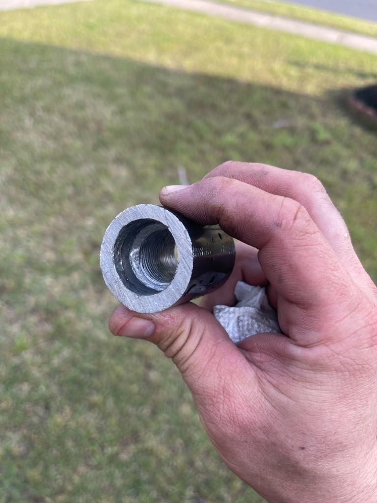

Hand drilling without a press isn’t as exact as I had hoped.. I’ll have to use a smaller bit than the 20.5mm that is called for the m22 threads.. while hand drilling I ended up wobbling a bit and the hole naturally is larger than 20.5mm bit. I don’t really think it’s an issue but the threads cut pretty easy and I don’t know if they are as deep as they should be. I have plenty of dom tubing left so I may recut this side and take a bit more time with the drilling.
The size difference to the stock rods is unbelievable lol

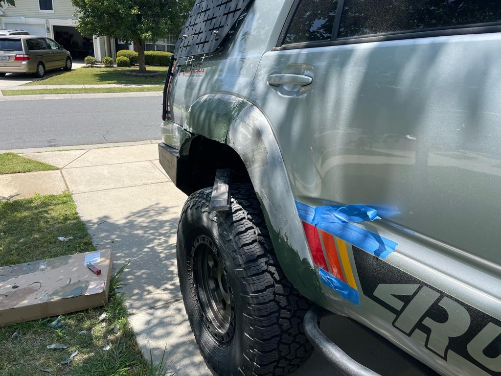

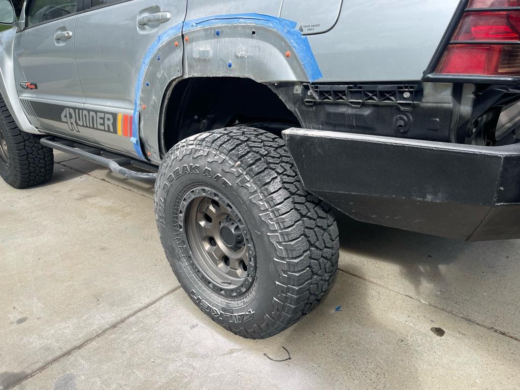

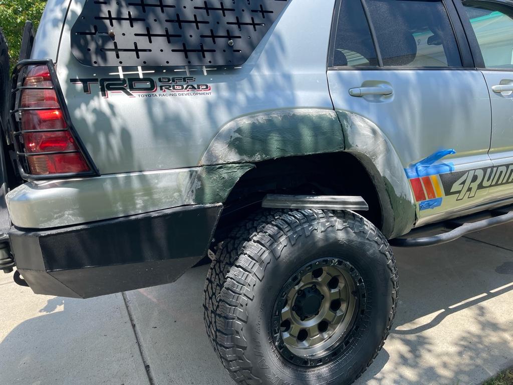

So you want to make custom wide body flares huh? Be prepared to live a messy, messy life for a few weeks [emoji38][emoji38]
Getting super close on the first side though.. and hoping that the next one goes even quicker now that I know what I’m doing more or less

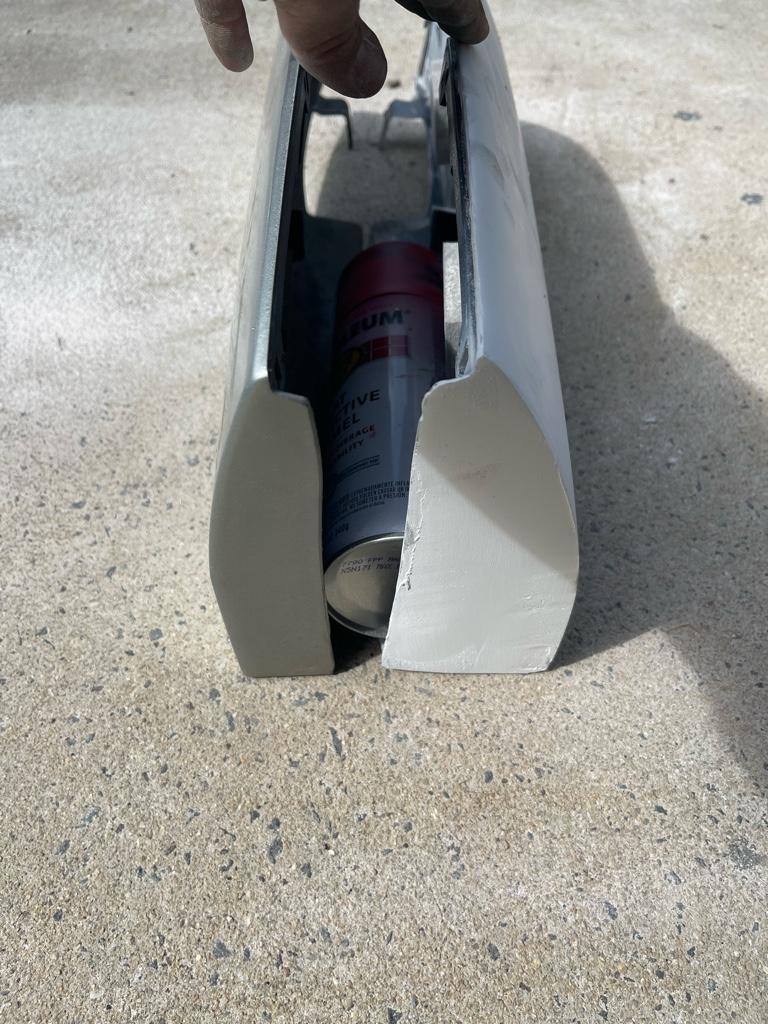

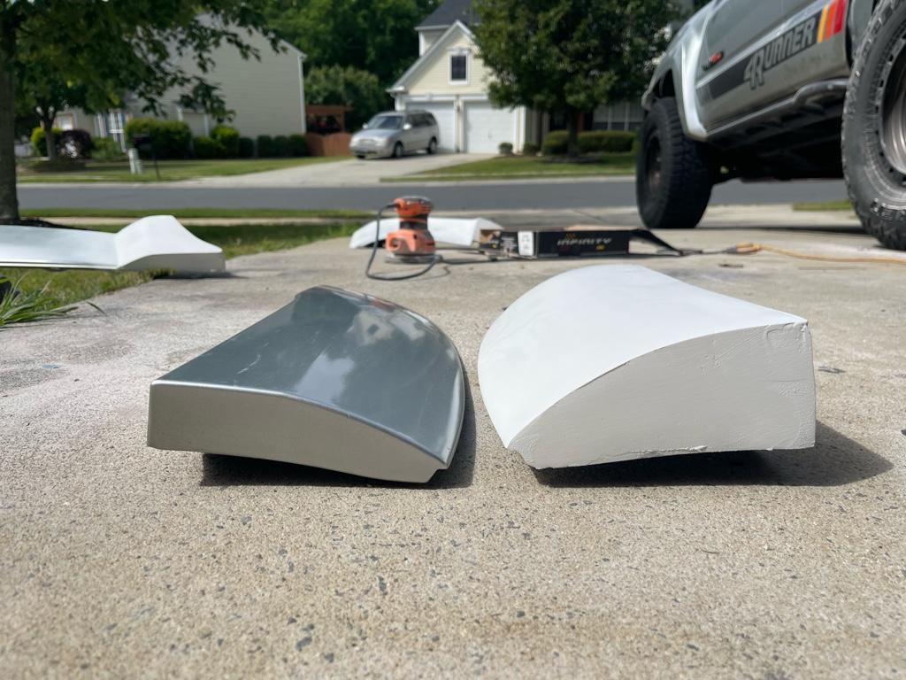

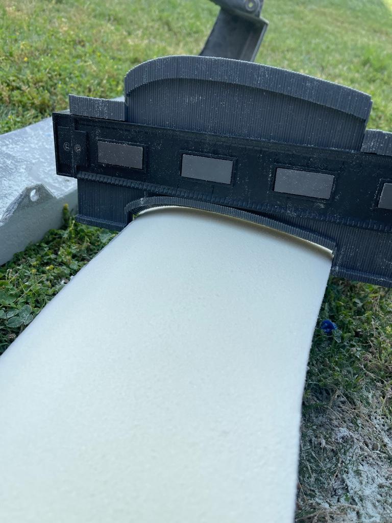

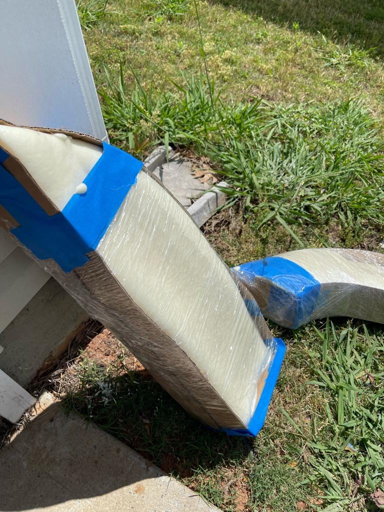

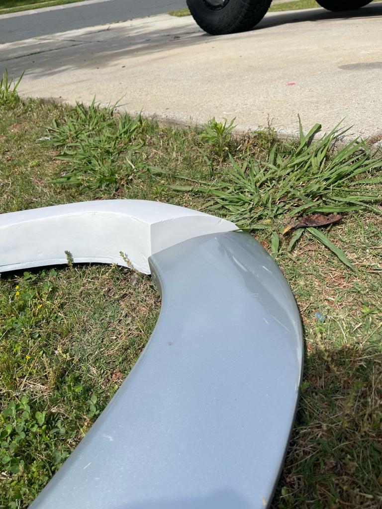

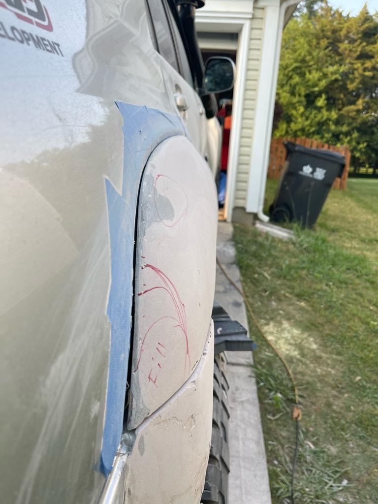

Second side is under way. Gained about 1.25” over stock. What do you guys think? Didn’t want to go overboard.

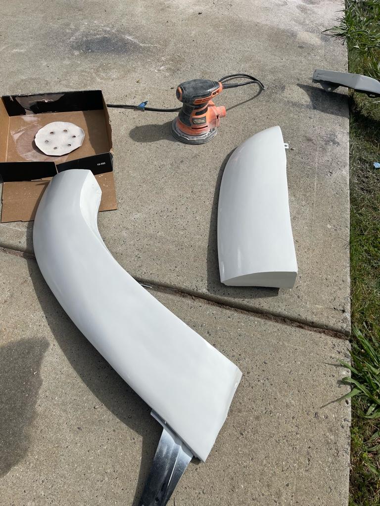

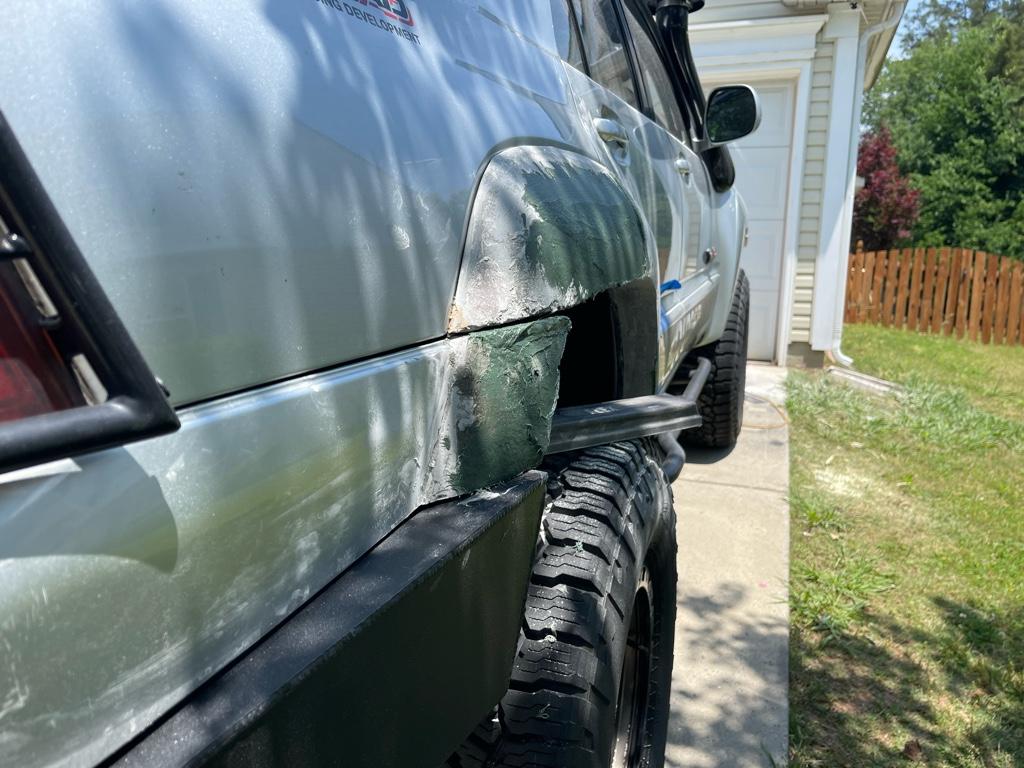

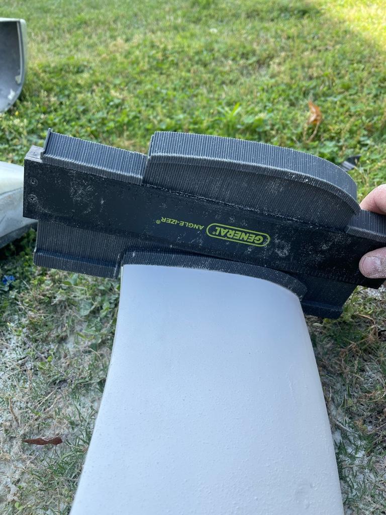

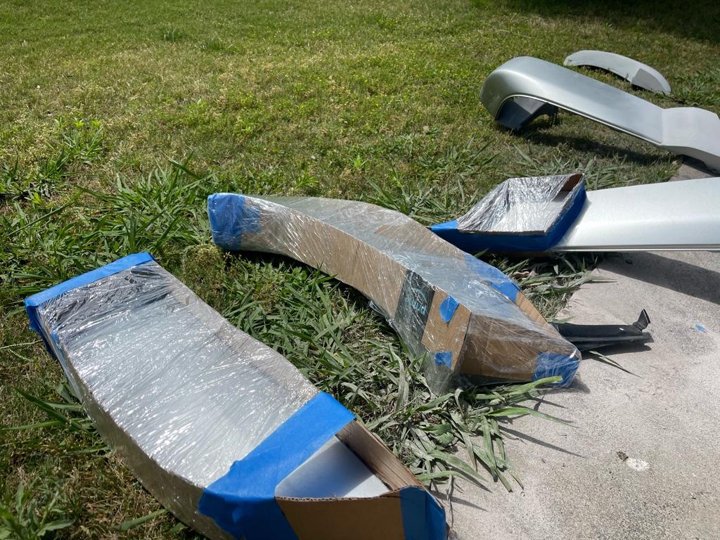

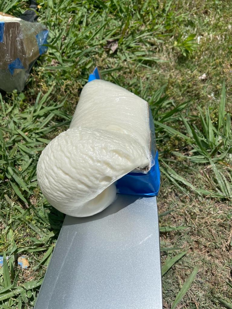

Side number two is coming along so much quicker than the first. The fully enclosed foam method did me wonders in being able to do just a single foam shaping pass. Using a contour tool to verify a few quick spots to get it close was helpful. I already have these covered in bondoglass for reinforcement, hopefully this sanding goes quicker, I’m ready to get these done , painted and on the car to see what it looks like.

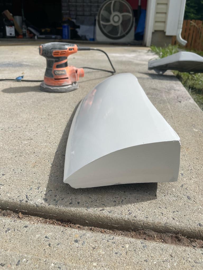

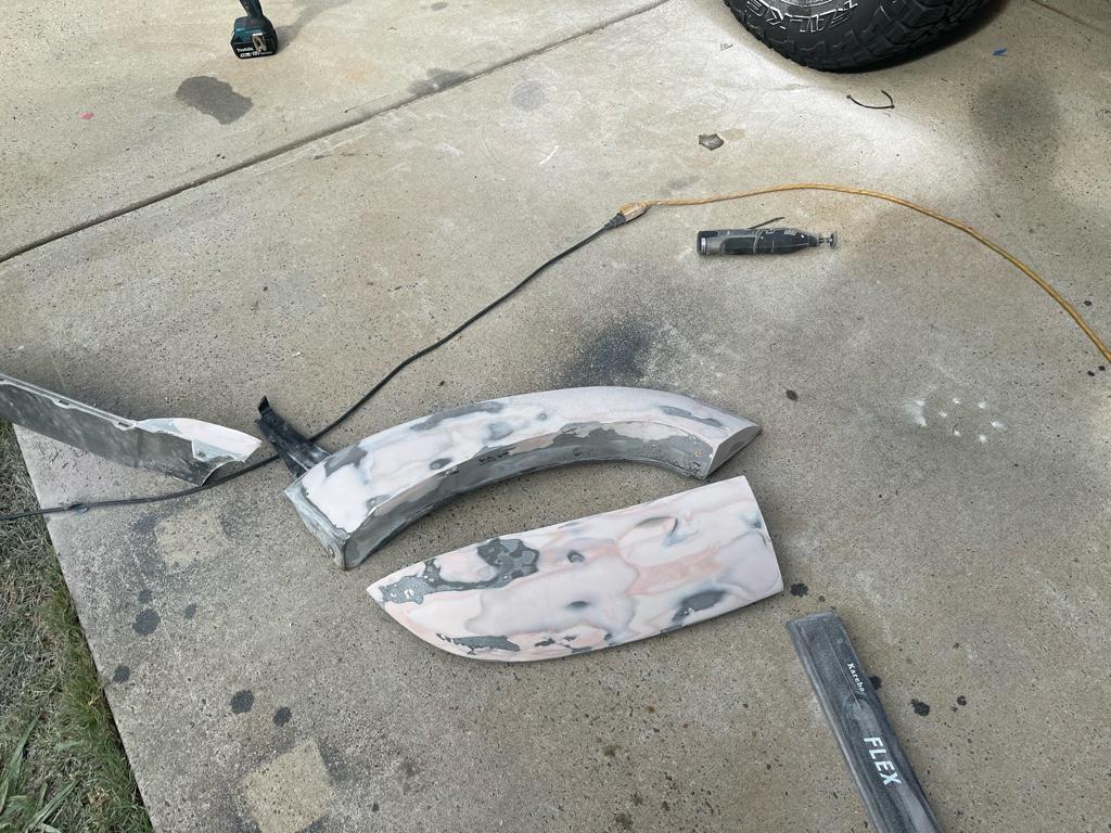

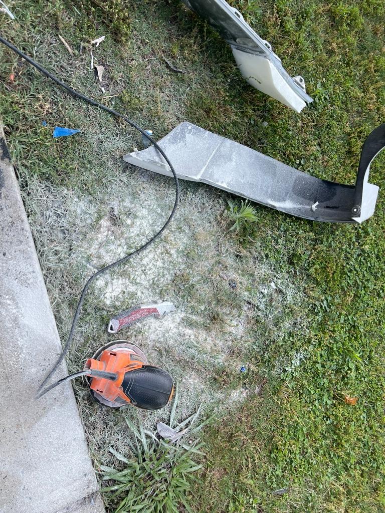

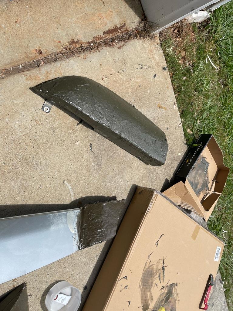

I won’t say it’s going SUPER fast, but the passenger side is going significantly faster for sure. The door piece is just about there. The center flare ended up being a bit low compared to the door flare so I’m having to build it out with some Bondo glass reinforced filler. The rear bumper portion I screwed up in every imaginable way lol. Way too thick at the top, not nearly enough at the bottom, and the curve is all out of wack… I’ll let you guess whether I used the contour tool in this or not [emoji23]
I figured I probably have another one , maybe two layers of Bondo glass and then start going over with regular filler. If all goes well maybe I’ll be done with shaping these by Thursday this week.. fingers crossed !
Next step will be to figure out how to reattach the the door flare the I cut away from the horizontal piece .. haven’t looked to see if there are clips behind there or not. Worst case I’ll just throw some expanding foam behind there to help adhere it to the door.

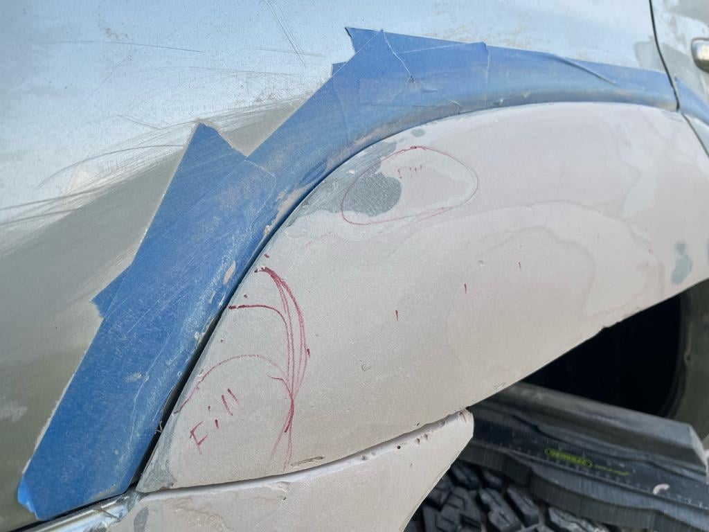

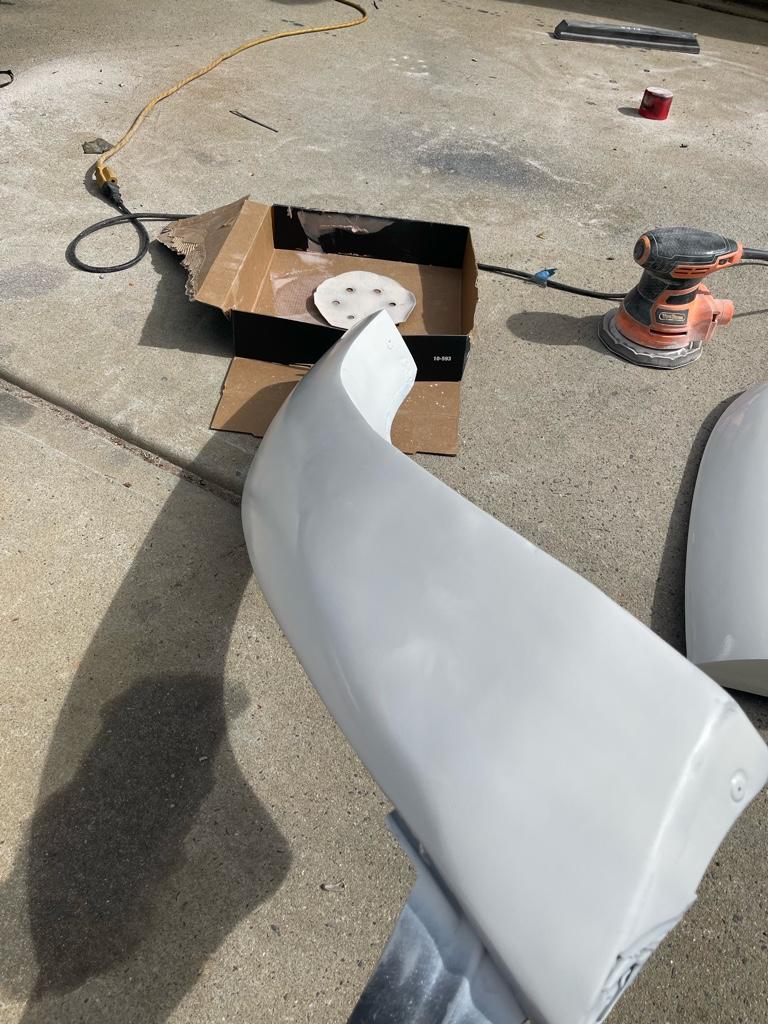

So… much…… sanding …… so so much … ask me again why I’m doing this ???
But I am making great progress. If I didn’t care about making these near identical from one side to the other I probably would be done by now.. but if figured if I’m going do it, I may as well do it right.
I can’t tell you guys how many times I have gone back and forth with the contour tool to verify every inch of the panels left to right. I think the middle flare only has two small low areas left to fill before it’s near identical. The other two should be significantly quicker. Hoping to make good progress tomorrow.
Mad respect for your dedication and attention to detail, it will be worth it. Pretty sure it's way more work than I would want to put in.
I kinda didn’t leave myself a way out since I’m modifying my existing panels .. lol.. it’s certainly more work than I ever planned on putting in .. even know I should know damn well exactly what it will take since it isn’t my first custom body project.. lol. But getting super close.
