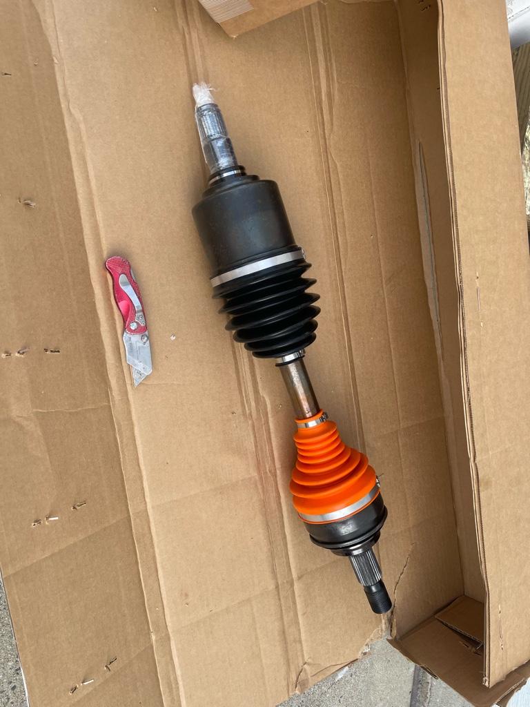

Sounds like that could have gone either way. Cutting the boots and sending out 2 to replace them must mean they are getting them pretty cheap.
Well.. I requested they send me my old ones before I knew they were cut and after they cut them lol. So initially they weren’t planning on sending me any additional ones back, used or new. But again, not complaining if it’s fixed now and will hold up.

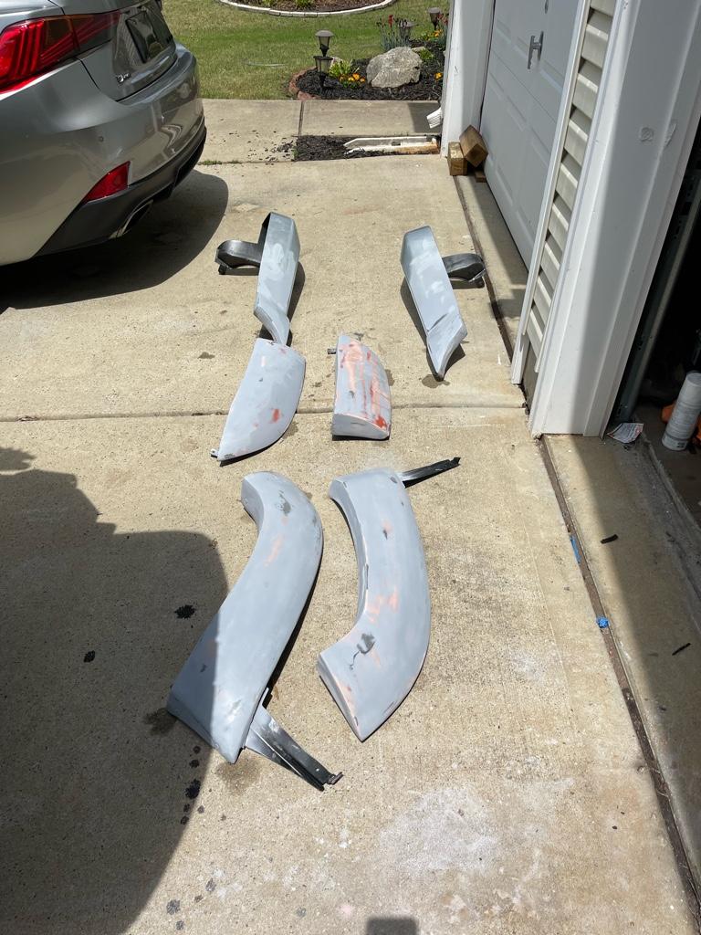

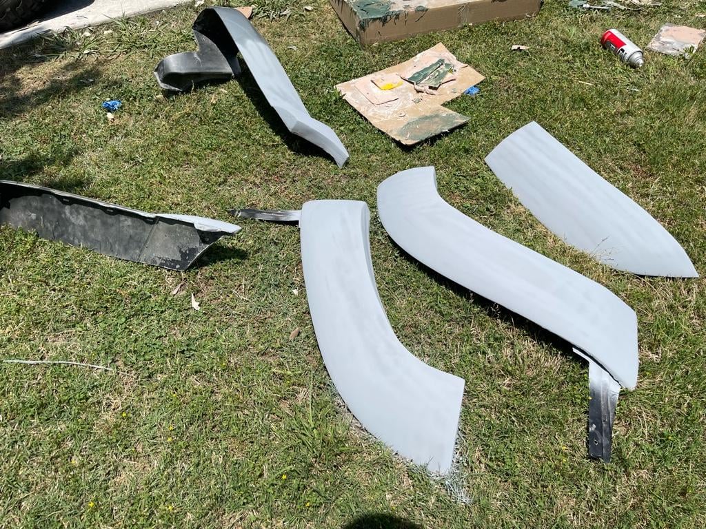

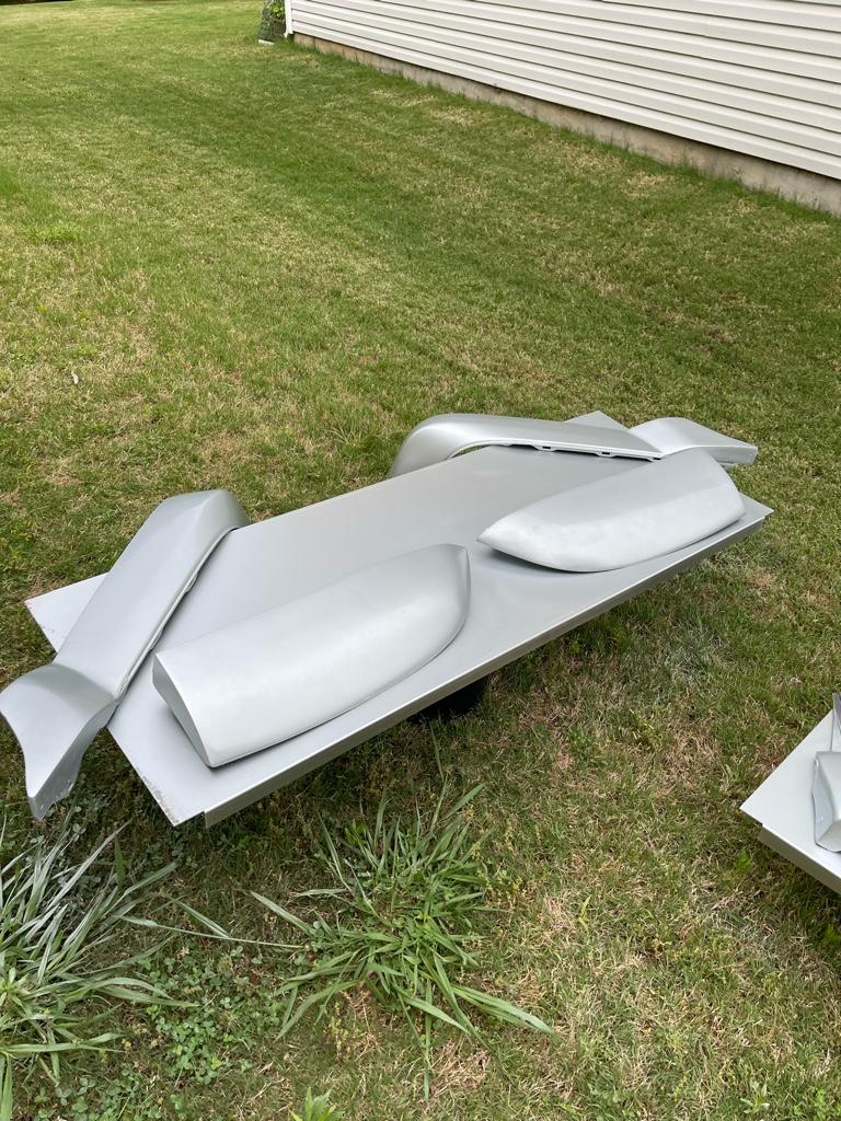

I spent a few hours of sanding , and then a few more … but man.. I think I see the light at the end of the tunnel !

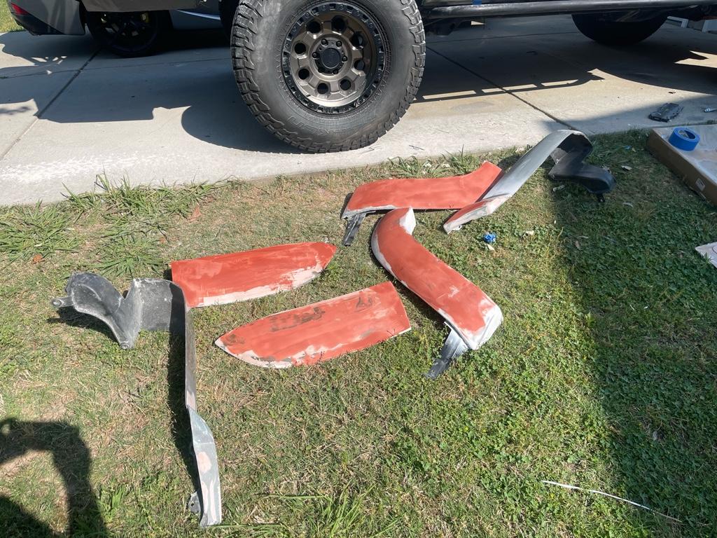

All 6 flare pieces are shaped and blocked. What you see here is a glazing putty coat the fill in some small pin holes. Once this dries and gets sanded I’ll hit it with some sandable primer and block that down… from there it’s just paint and clear and hope all my clips still work to attach properly and not fall off… I may be putting on some 3m tape just to be on the safe side since there is so much added weight now.

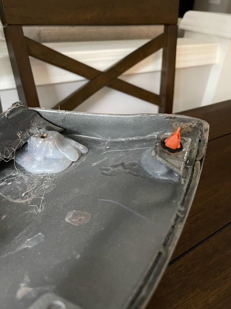

I'd make sure to beef up the clip tabs with some epoxy or something. My front fender flare is barely hanging on after bottom out the suspension on a whoop and the tire eating it and breaking a clip mount.
Yea that’s what I’m working on now actually .. one of my tabs is cracked and not holding so I already got it taken care of, now to figure out the best way to do the rest of them.. epoxy is nice and strong, just super messy to work with and it wants to flow out from under the tape .. we’ll see. I’ll definitely throw in some 3m tape under all these. That for sure will hold. I ripped off my paint taking off the last wing from filmy supra lol.

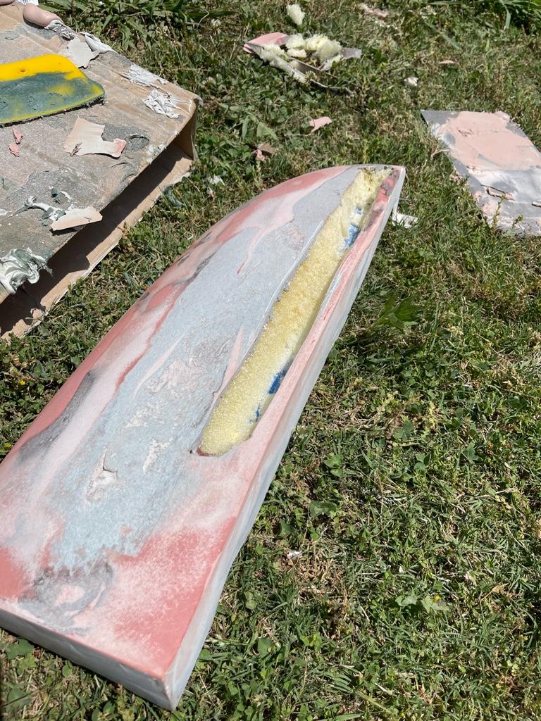

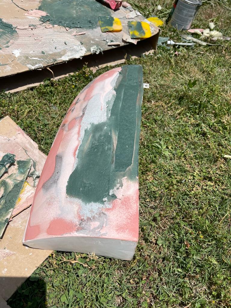

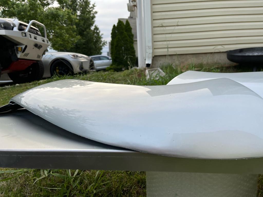

Andddd just when I said I was done …. Lol .. I found a damn giant soft spot in the first flare I did.
The first set of panels I did I didn’t enclose the cardboard for the foam expansion. This resulted in it being able to expand too much and too easy, leaving it porous.
That on top of the fact that I really went to toe sanding the bondo glass filler to get the shape I wanted really left almost nothing of the filler , causing this entire section to flex.
But I surpassingly made super quick work of it.. all in the mater of my lunch break. Cut out the soft spot, filled it with bondo glass twice, rough shaped it, and 3 coats of body filler along with a glaze coat. The heat today really helped dry it all out super fast. All of these are now primed and drying. Now all that is left to do is to wet sand and paint /clear… please remind me not to do anymore custom body projects and just go enjoy this damn thing already. Lol

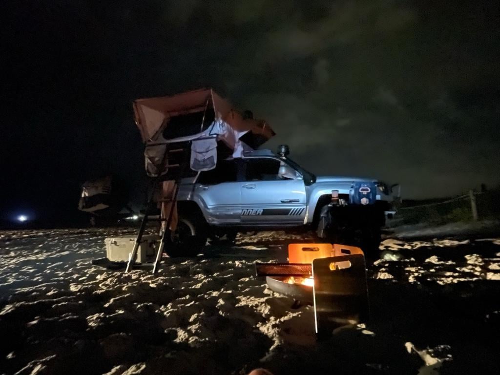

We planned a beach camping trip tomorrow into Monday at Carolina beach, so no more work on the car until we’re back. Everything is in full blown overland mode

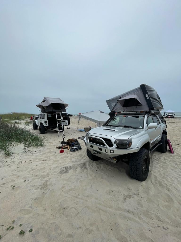

Beach camping with the wife and puppies was a success. The trip did not disappoint , and the rig did wonderful, couldn’t ask for more from it. Now to get some rest .. lol

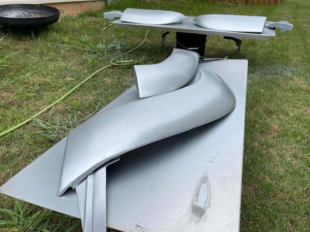

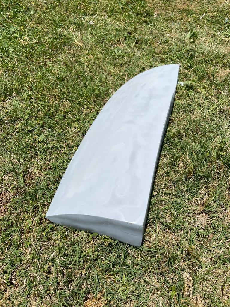

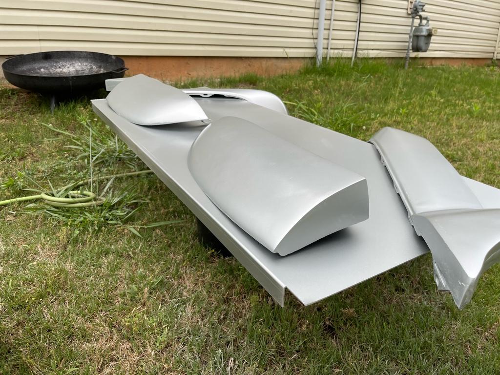

Proper or not.. I’m done prepping these panels. This took significantly longer than I anticipated.. ready to pick up some paint in the morning and spray these panels this week so I can slap them back on the car.
Far from perfect, but I think it’s close enough and hopefully they hold up and don’t crack off of the original panel.. time will tell lol. The hole “saving time by not wrapping in fiberglass “ route may very well come back to bite me in my ass .. but let’s see what happens. With my luck, I’ll put one of these sides into a tree my very next outing and destroy the things lol.

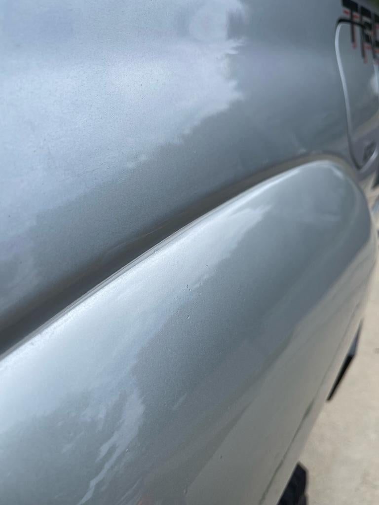

Well.. they’re certainly far from perfect… but at least the paint is on .. lol.
I figured there was no reason to continue perfecting the finish without knowing how these will even hold up long term with having foam inside for a backer.. and not to mention trail use and abuse.. it’s about 90% there finish wise, a bunch of small pinholes that I didn’t feel like filling and sanding again, and I did see a couple of spots that could have been blocked better ahead of time, but overall these should look pretty decent from 5-10ft out lol. Eventually with my color change plan these small imperfections won’t matter anyhow since we’ll have to sand the whole car down a bit so I think for now it will do.
And the clear is on. Super sleek and wet lol. Like I said, far from perfect , but she’ll be a good 5footer. Can’t wait for this to dry tomorrow so I can slap these on and see what it looks like.

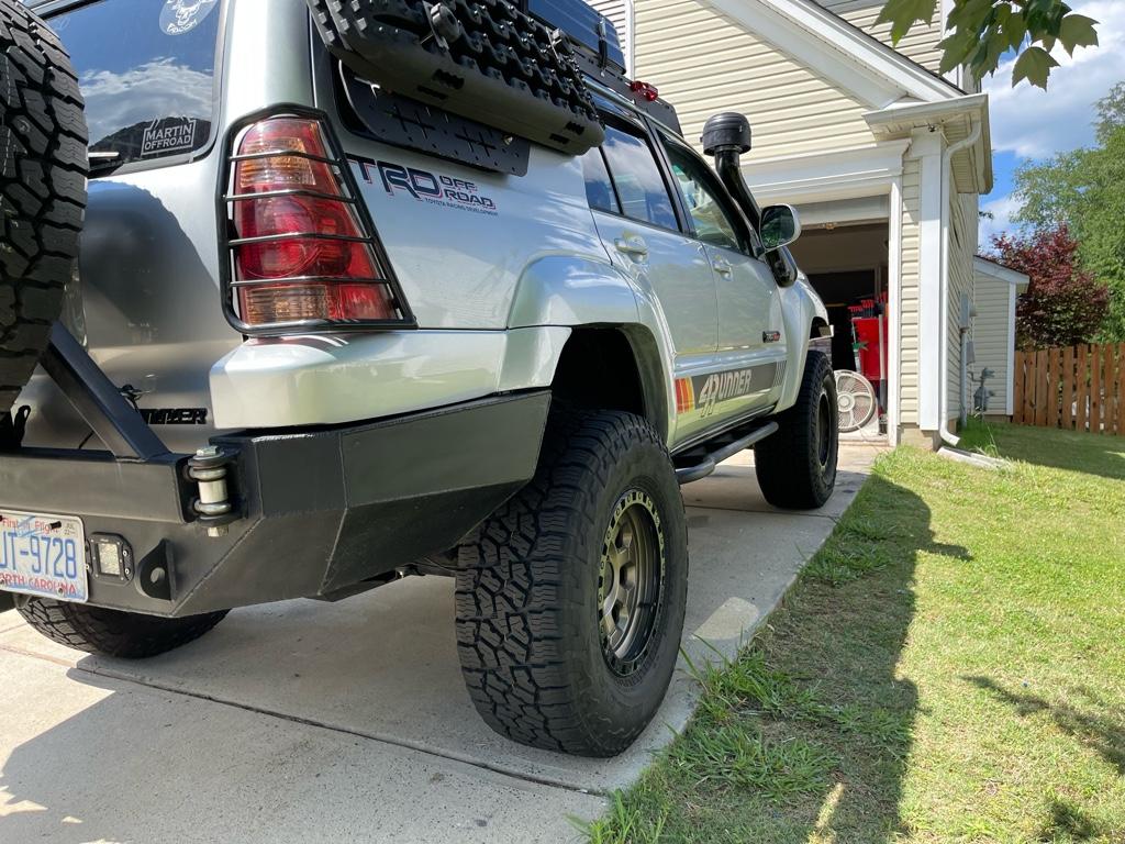

Project Big Booty Judy is just about wrapped up.. so much effort .. so much time .. I don’t know what to do with all the free time I’m about to get lol.

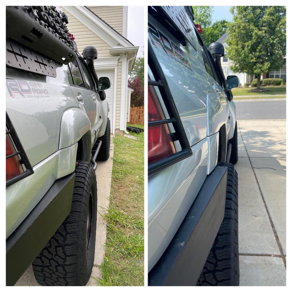

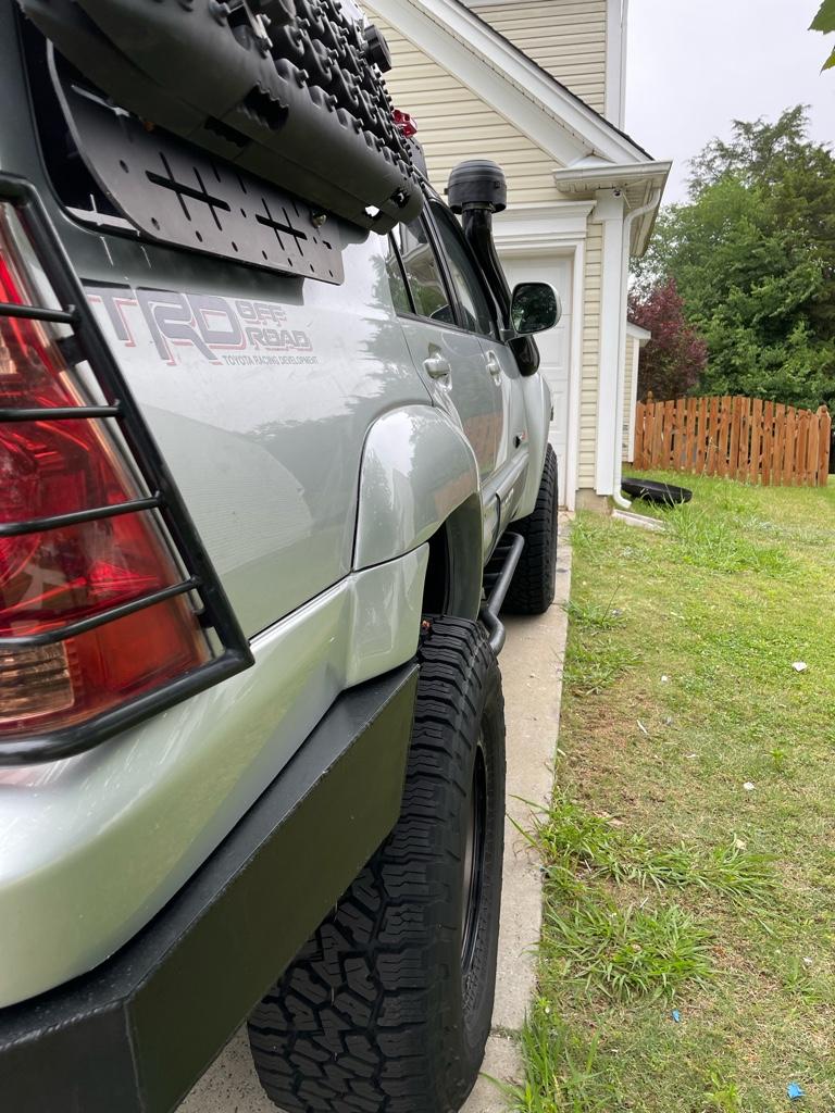

Ofocurse I ran out of body clips to fully install one side. And the passenger side door flare snapped THE most import clip at the top right that sucks the corner down.. yay.. so now I’m waiting for the epoxy to dry and hope like hell that it holds.. if this doesn’t work I’m not exactly sure what I’m going to do.. will have Jerry rig a way to set a nutsert and drill a whole from the inside to be able to use a screw instead of a clip maybe.. we’ll see. A bit disheartening but it’s the nature of custom projects I guess.

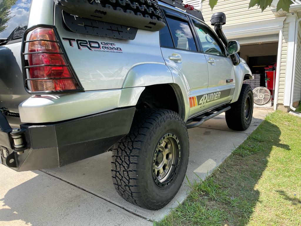

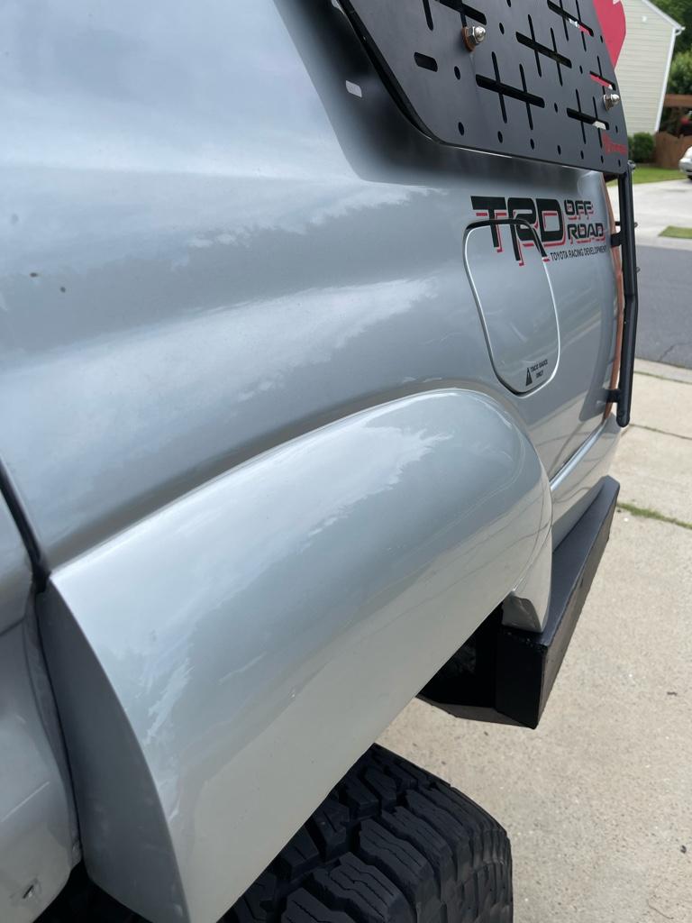

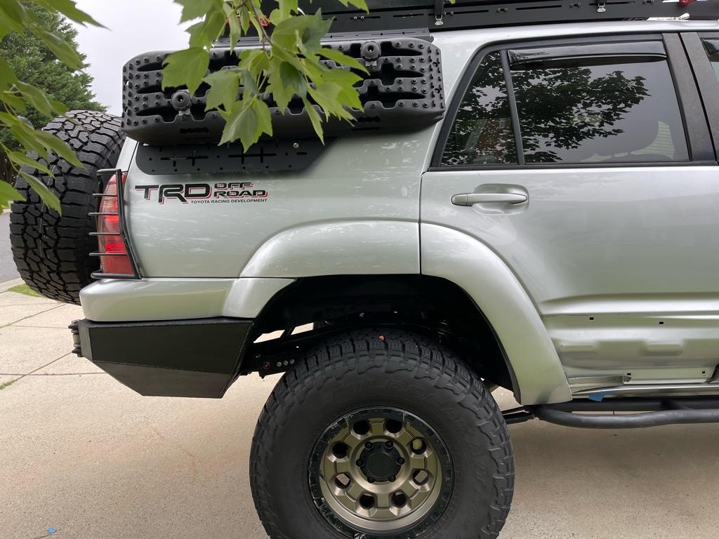

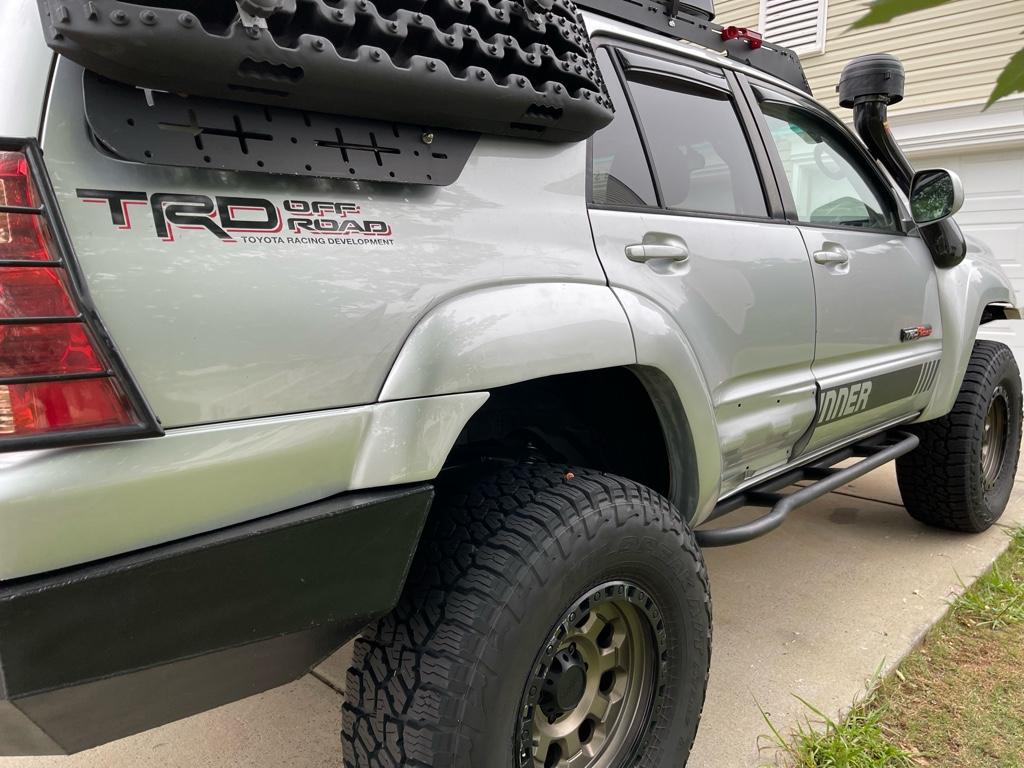

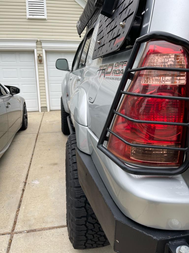

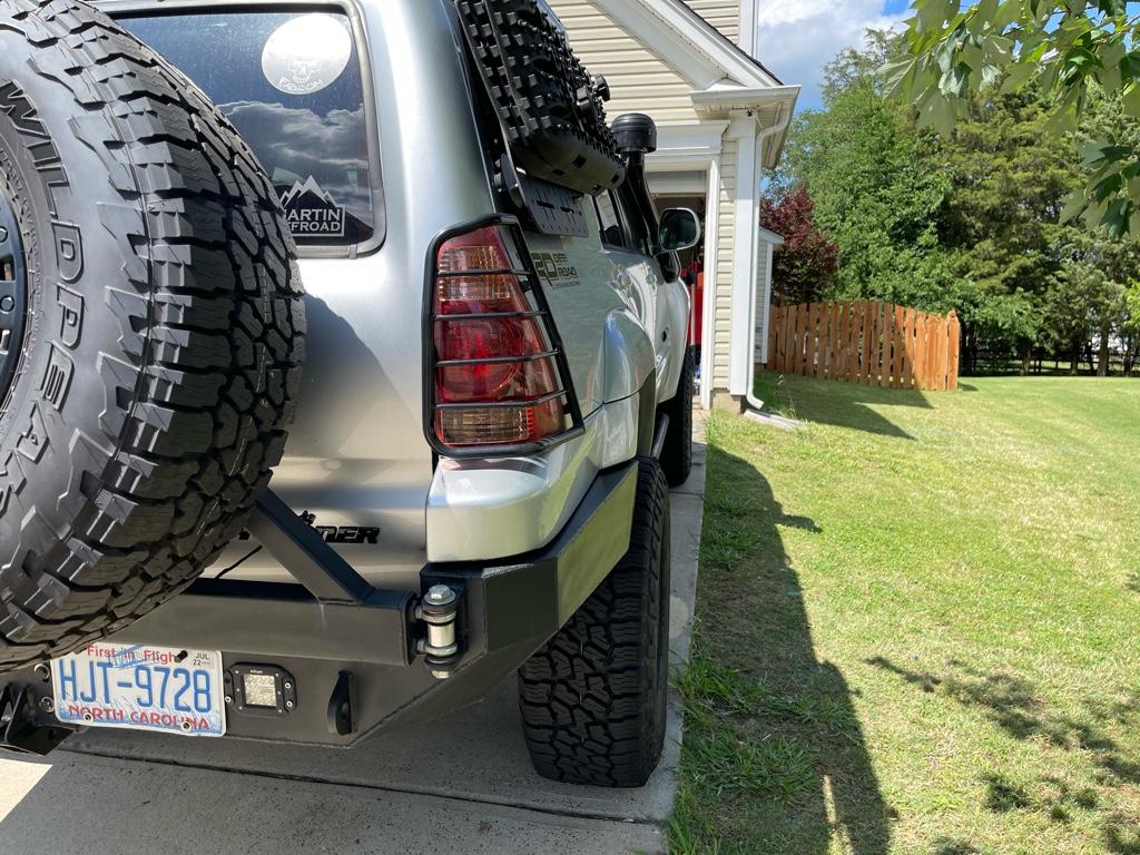

To me these look so factory that it’s actually kind of hard to tell it’s wider than stock unless you compare back to back to a stock rig. I like that and I hate it .. lol. A part of me wishes I went a bit more aggressive with styling, maybe a bit wider and with harder lines like the front fenders, but I know damn well what nightmare that would have turned into lol.
For once I have a decent before and after picture with decently matching angles lol

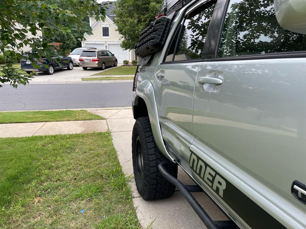

Got the body mount clips delivered and all the panels are on. I took it a step further and filled the larger than stock gaps with some grey silicone. Made it looks pretty good. Overall pretty happy with everything.
The drivers side door panel fitment and clips are not in the greatest of shape .. my nutsert I epoxied in failed and is only partially holding.. a bit worried about this corner peeling back a little .. but it can’t come fully off so we’ll see what happens… I may need to pull this off in the future and use a more serious epoxy to set either new clips, or nutserts or something to suck it down some because right now it stick out past the body flare just a bit.. oh well.I’ll rock and roll as is and see what happens.
