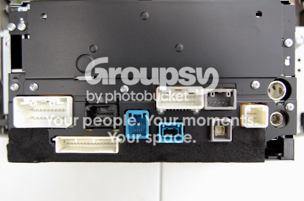

Question 1......
Back of Non Nav SR5 /TE 2010
BackofStereo.jpg~original
And the back of a JBL nav(2010) unit also...
Picture001-7.jpg~original

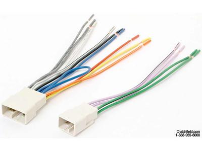

- Metra 70-1761 Radio Wiring Harness For Toyota 87-Up Power 4

If you need a hand installing any of that, let me know. I took apart my SR5 2x and the limited once as well. I would also suggest some posi tap connectors (see my pics above) and some double ended connectors from Home Depot or some electronics store - maybe Micro Center? The posi taps will keep you from needing to splice lines, and the radio harness will need to connect to the adapter harness with the wire connectors.
