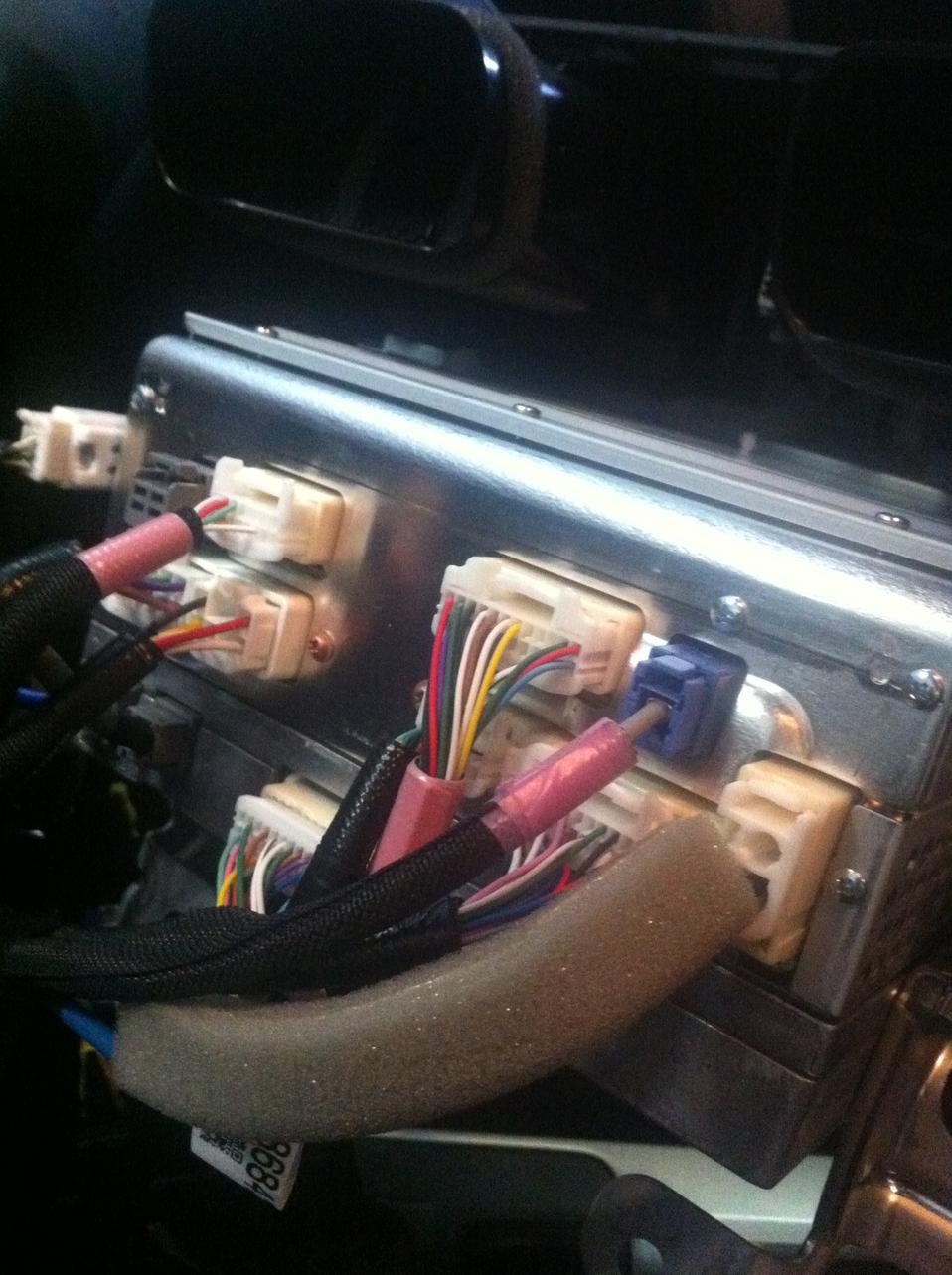

I think I will post it on eBay. Is it really that easy to remove the amp and wiring harness in tact? Lot of wires going into hidden places and lots of connectors. I know I can remove it if I cut off some connectors but don't want to make the thing too hard to reinstall.
Easy? I never said it would be easy......just that it was humanly possible. You would have to practically take the whole truck apart as the wires for the stereos are bundled with the whole truck wiring harness and branches out like a tree.
I guess if you cut all the connectors off and included them that it could be re-wired from the HU to the Amp.That's a lot of work and possible headaches as it's tied into a multi media interface ECU also.

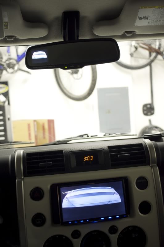

Has anyone figured out a way to play video on nav by splicing into the rear view camera wire?
Helloooo anyone?
can anyone tell us where to get the signal out of the rear view mirror so we can have the rear view camera to play in the after market Nav?
I'm willing to take pics get wires and do whatever, just tell me where to look :)
my 4runner is a 2011 trail and I have a kenwood ddx812
to make it look like that
You can do it by making an RCA cable. Tap into the video feed in the rear view mirror. You can run that down the A pillar and through the dash to the head unit. You can utilize the same reverse sensing wire that antman mentions in a few of his threads. He pointed me to a good one to use (see pics in my post earlier in this thread) when I was setting mine up.
Basic answer is yes, not a big deal.
