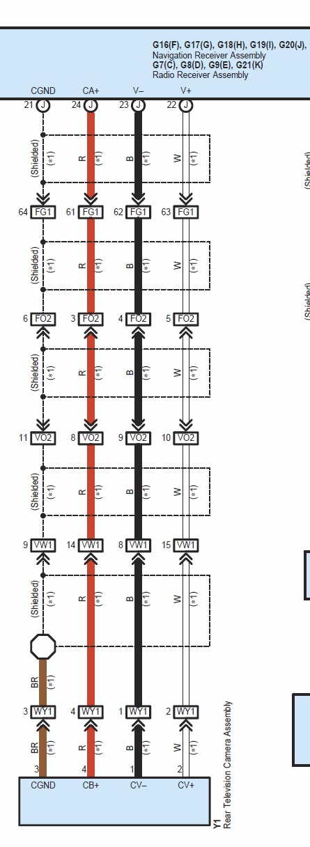

[MENTION=2054]Kingpin[/MENTION]s pictures are down, but I'm trying to do this. Anyone know which wire gives the factory backup camera signal so I can splice this into an RCA?
Well, I did...haha. I still have the factory camera installed in addition to the new camera and an extra input on my new screen so I figured I'll try and wire it up just for kicks (yes I know I know I'm running out of things to do on this truck). So all the old harnesses are dangling back behind my new stereo.
I have already done the mod listed above to trigger my camera with a switch. I'm just trying to find the wire the carries the actual video signal so I can splice it into an RCA plug. According to the wiring diagrams it should be white (if I am reading it correctly). I've done some probing but am coming up empty.
Ooooooh, fail on my part, I thought you meant the signal to turn on the backup cam, sorry! I was wondering why you were asking something so simple, lol.
This might not be as helpful for you since it's from my 2012 with entune, but I've noticed that the wire coloring generally tends to be similar from year to year (just pinned differently); so maybe it might be a "white w/ black stripe" wire that you're looking for?
EDIT: Scratch that, I think what you need to find is a pair that has a white and black...now that I think about it I recall there being a thicker wire that runs to the back of the headunit and then splits apart into two wires (right before terminating at the plug), which goes into the plug at two adjacent pins :noidea:

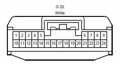

Okay sorry for confusing the shiet out of you, I just remembered the only reason I was able to see that the two wires came in pairs was because I unwrapped the entire factory harness :tape:
You probably won't be able to see it just by looking, lol.
So...to make it up to you, I think I found what you are looking for below.
Pin 22 :)

Awesome, thanks! I tried this again today and it's still not working. I'll bet my installer disconnected the factory backup camera when he installed the 360 system. I should be taking the rear garnish off soon so I'll double check the camera then.

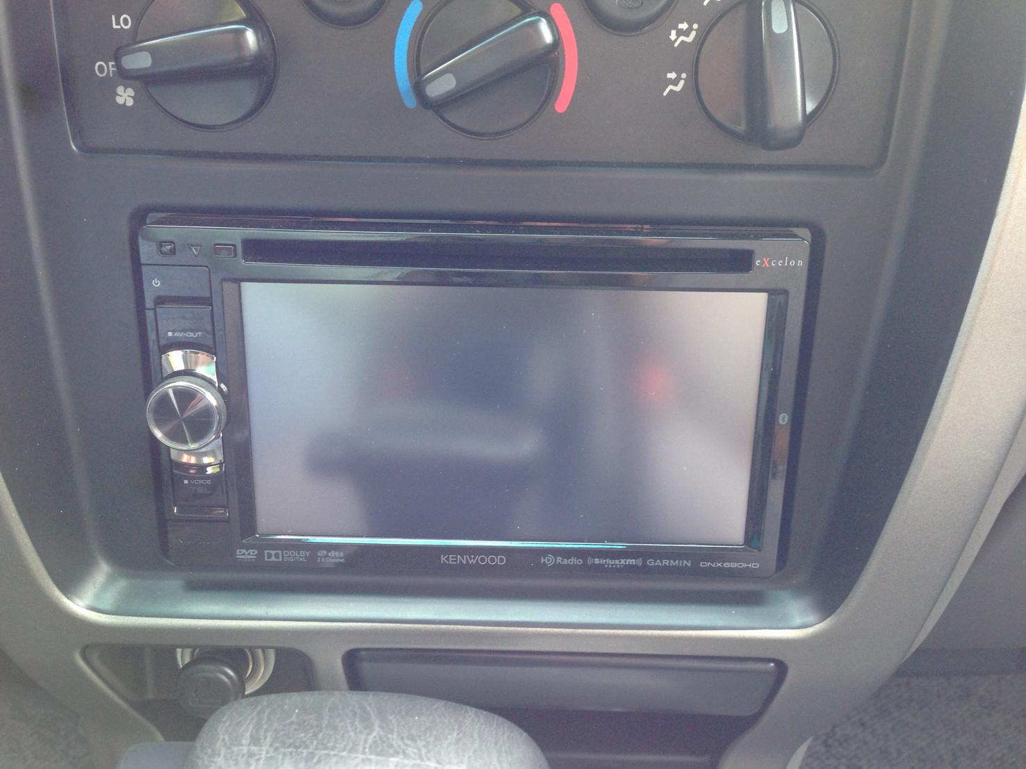

I have been a Kenwood fan for quite some time.
