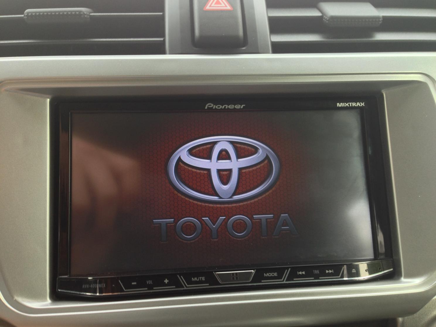

Here are a Toyota splash and background jpeg that I made in Photoshop for my AVIC-8000NEX, but they should work on any of the NEX units (and most likely others as well).
IMG_0530.jpg I used your splash screen, well done!
