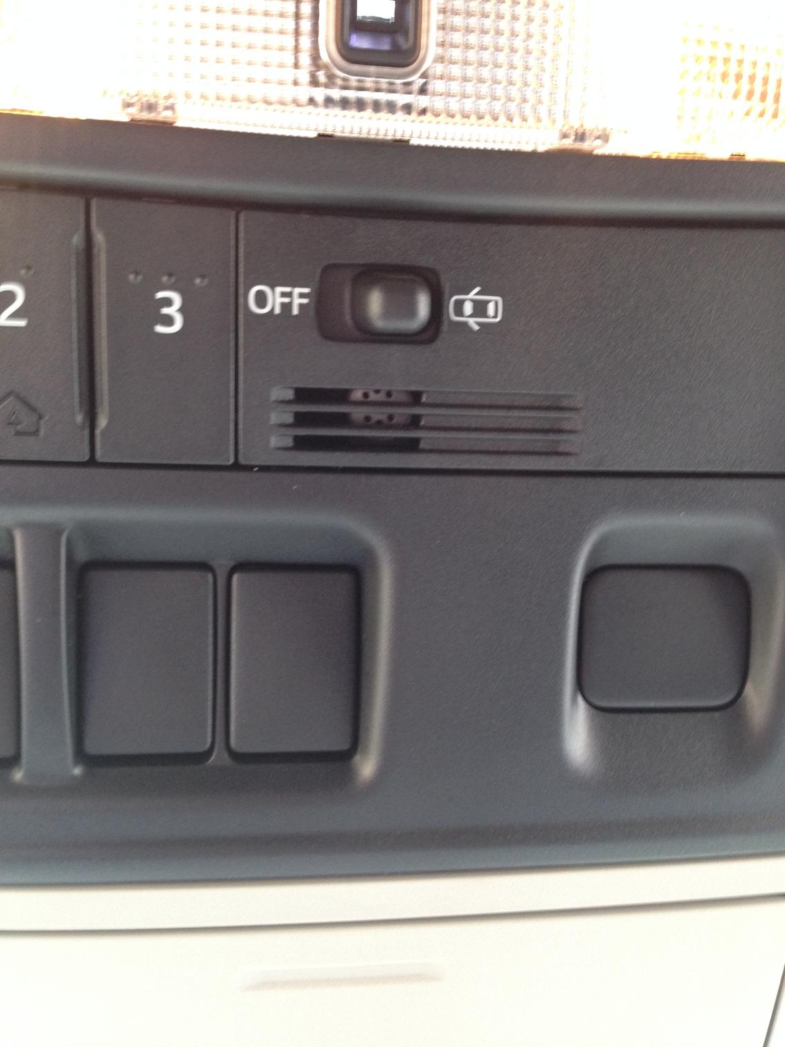

Microphone placement
I see where people on the forum have discussed where to put the aftermarket mic. I just put mine in the same spot as the factory mic. Remove the overhead console and the factory mic will easily move out of place. I used the factory mic to wedge the new mic in place.
Edit (5/24/14): I was having issues with Siri (as in, it never understood me) when driving on the interstate, so I put in some open cell foam around the mic, over the slots, etc. to deaden the road noise. Hope it works (probably won't).

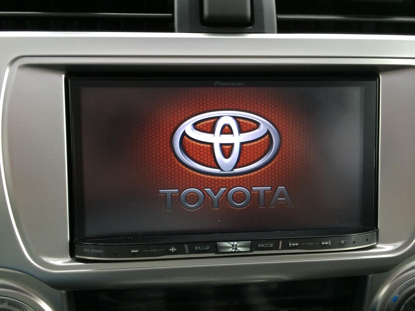

I just had an AVIC-8000NEX installed in my 2010 4Runner Limited on Friday... I LOVE it! It's fast, beautiful, and intuitive. The GPS is better than Garmin. The capacitive touch screen works well (WAY better than a resistive touch screen, but not as smooth as a modern smart phone or tablet). Plus, if you have an iPhone, you'll get to use Apple CarPlay starting early this summer with a firmware update! The unit supports iDataLink Maestro SW, and will support Maestro RR with a firmware update early this summer.
There is NOTHING I don't like about this unit!

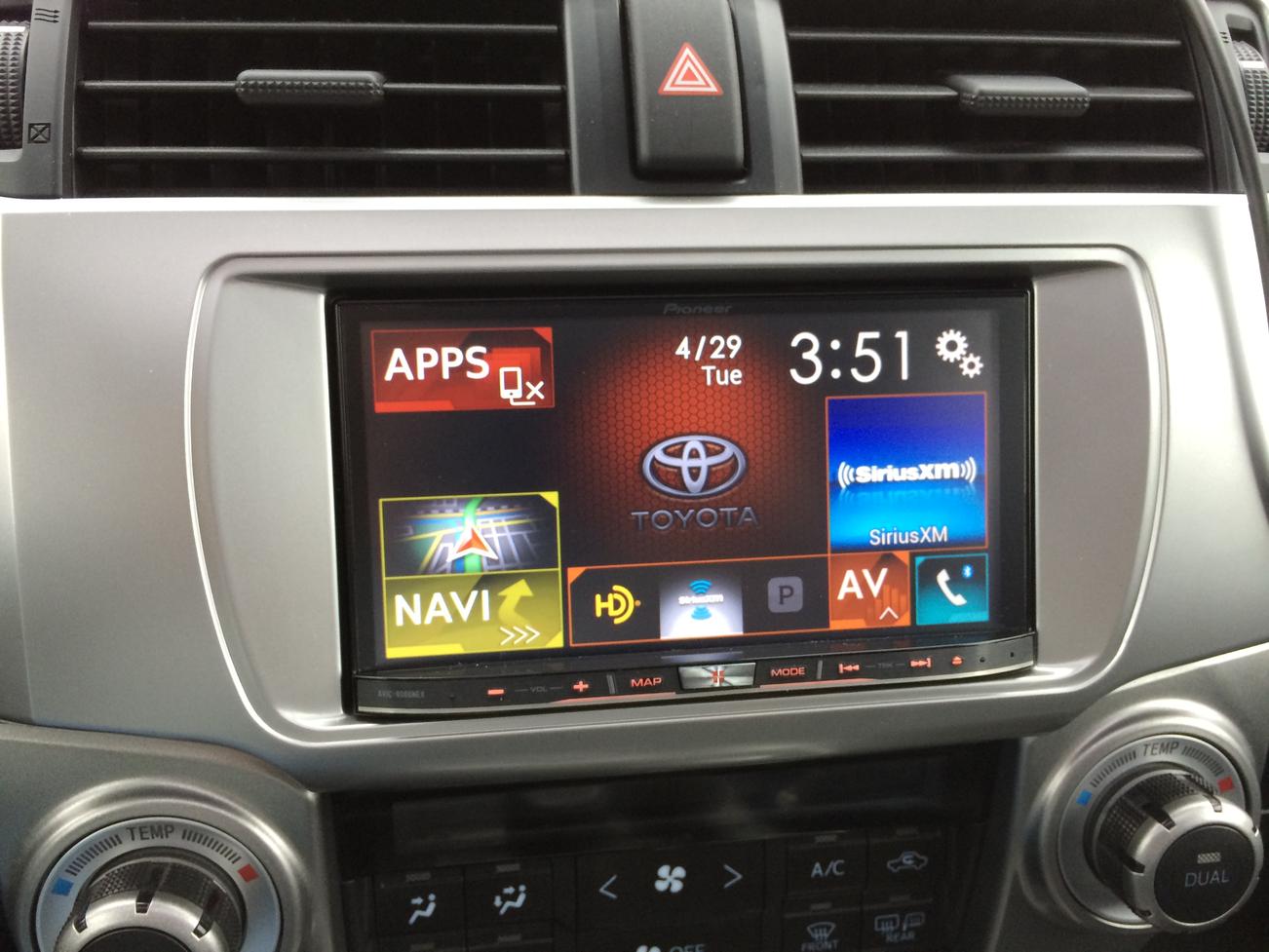

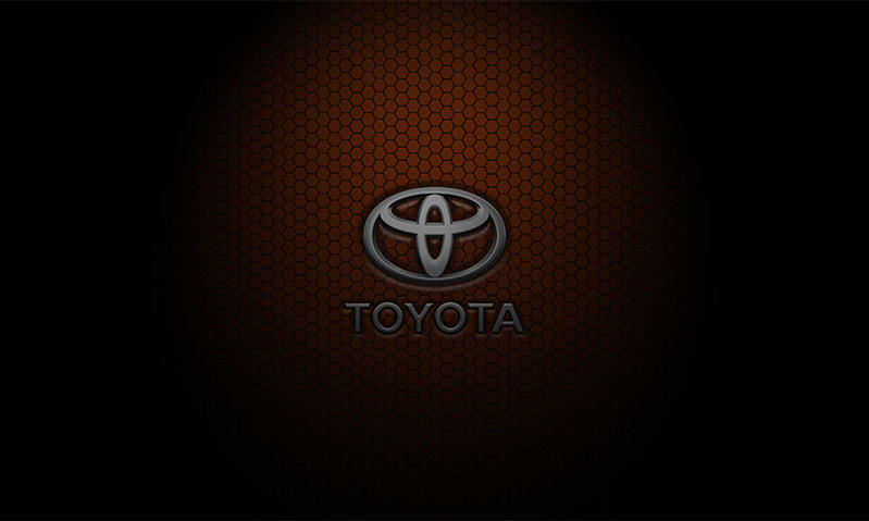

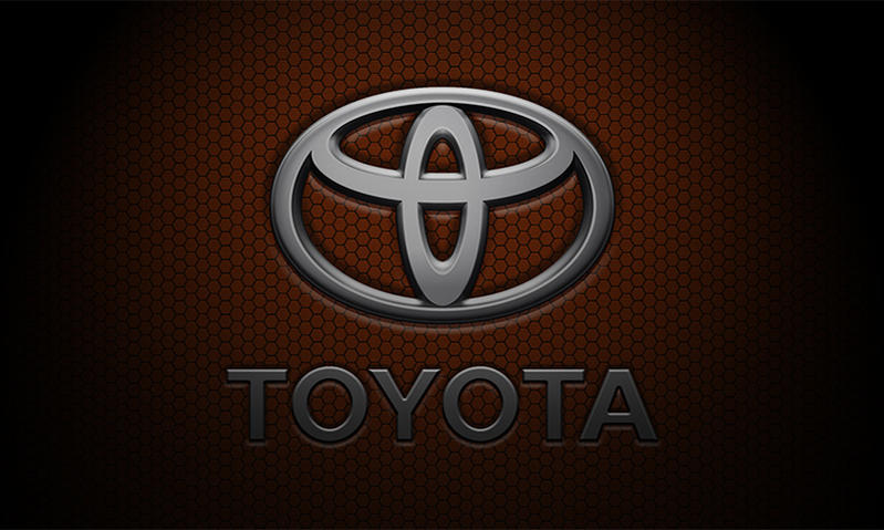

Here are a Toyota splash and background jpeg that I made in Photoshop for my AVIC-8000NEX, but they should work on any of the NEX units (and most likely others as well).
On the NEX homepage, the small Toyota logo on the background jpeg fits perfectly in the middle of the icons (see my previous post). The orange honeycomb background is the same color as the panel lights, so it ties everything together.
For the Source/App screens, I set the background to the Pioneer stock honeycomb pattern with the orange theme... the source screens have have so much info on them that there isn't a good place to put a logo.
(EDIT) NOTE: The forum picture manager reduced the file size of these pics... not sure how they will look on your head unit! I tried zipping them up, but the zip file was too big to post. You can find the full size jpegs here... http://avic411.com/index.php?/topic/36-custom-background-gallery/?p=277955
