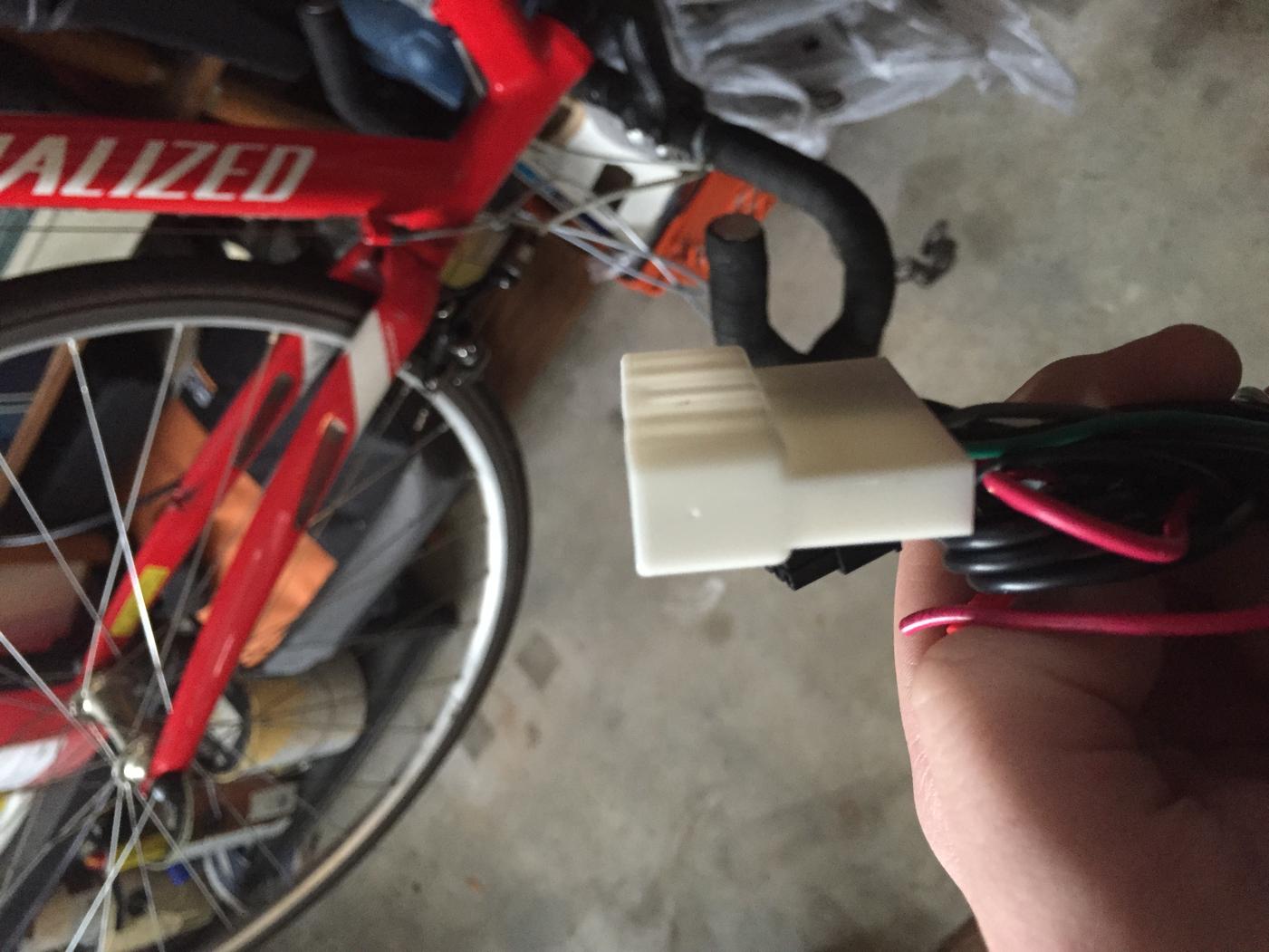

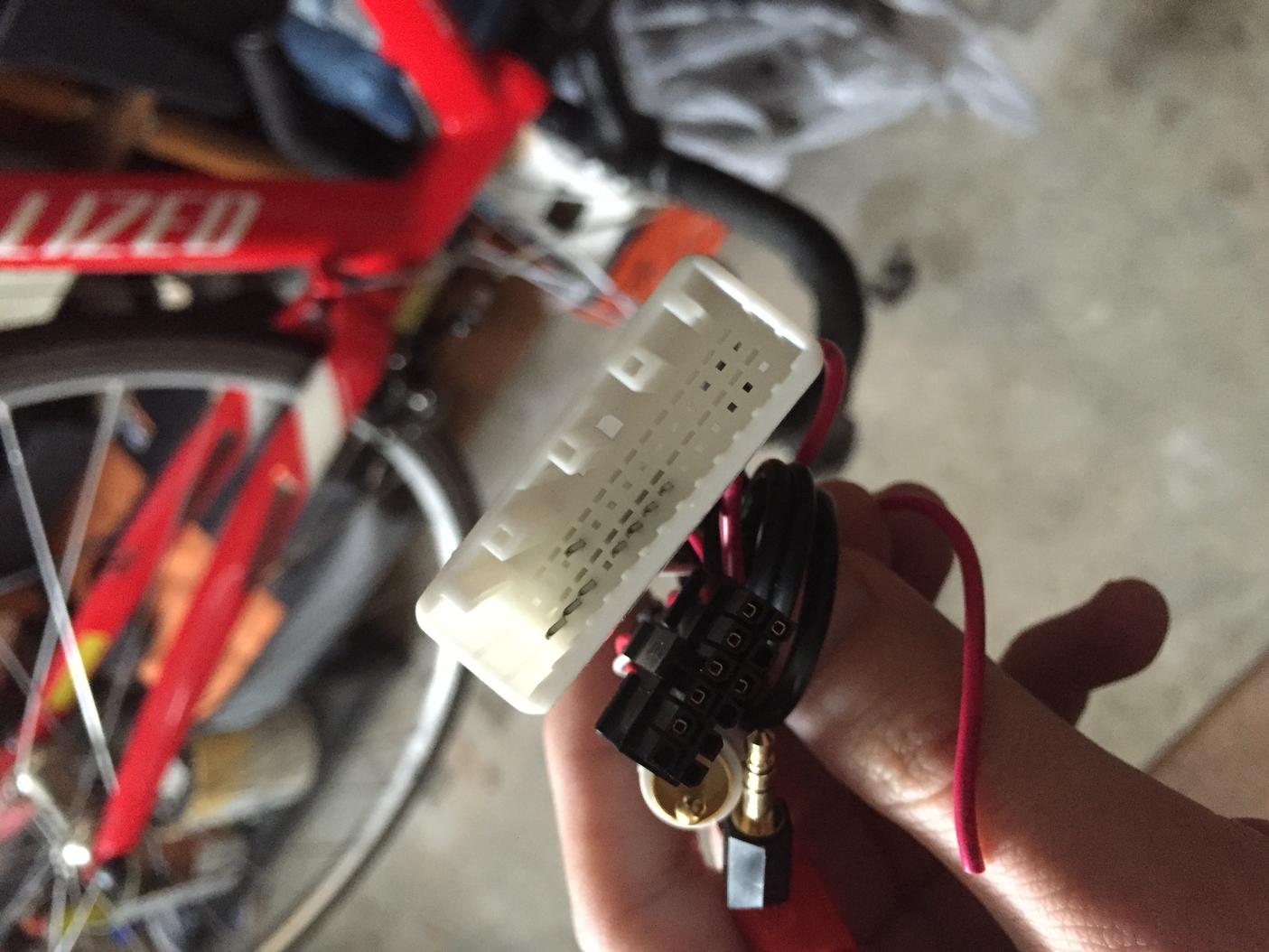

From what I get from researching, it seems like I would need the AX-TOY28SWC to plug in my existing 28 pin harness per photo below. I guess I would need to splice power and ground wires though?
This is what the TOY28SWC looks like, if that helps.

Can someone provide further confirmation on this for 2014 SR5 with stock navigation.
