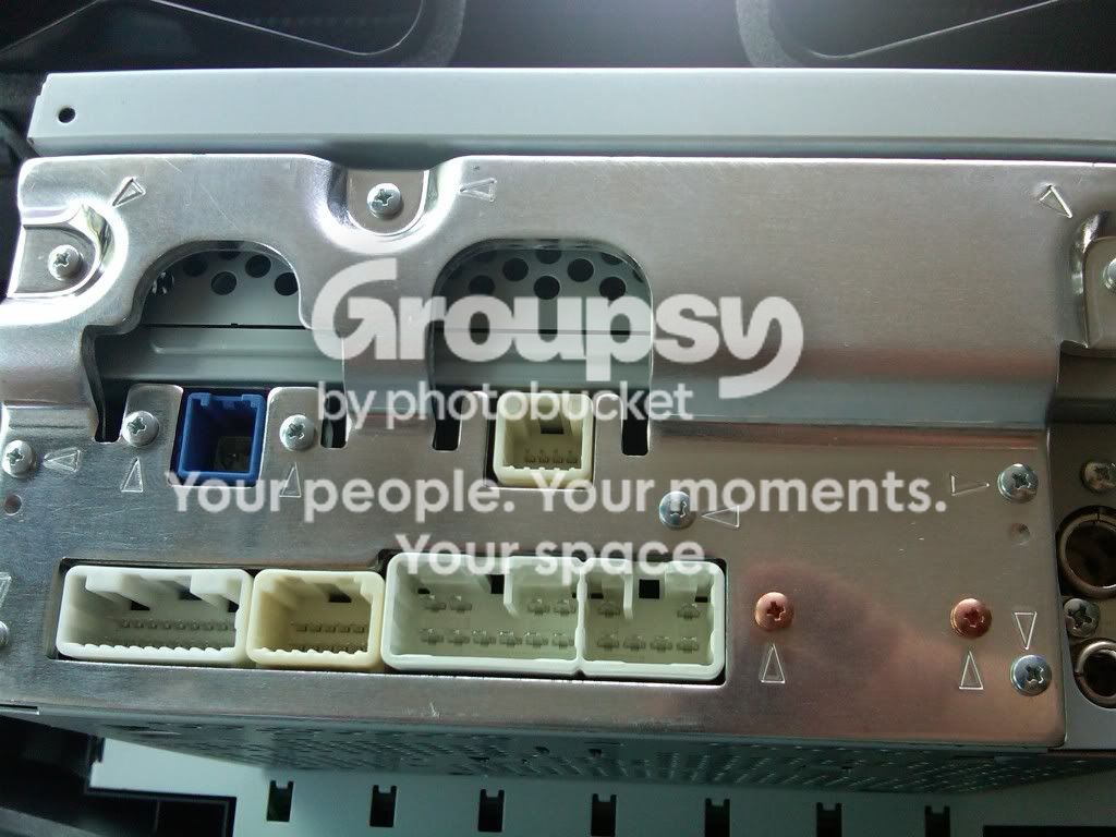

Back of Non Nav SR5 /TE 2010
BackofStereo.jpg~original
Has anyone been able to get the AX-TOYUSB-2 adapter to work with the non-JBL system? I am assuming it is the upper white plug in the pic. The harness that connects there is too wide for the adapter, and it's the smallest plug I can find back there.
I am asking about the AX-TOYUSB-2 not the AX-TOY28SWC which is the 28 pin adapter (which does fit). The AX-TOYUSB-2 is the USB adapter. Confusing names.

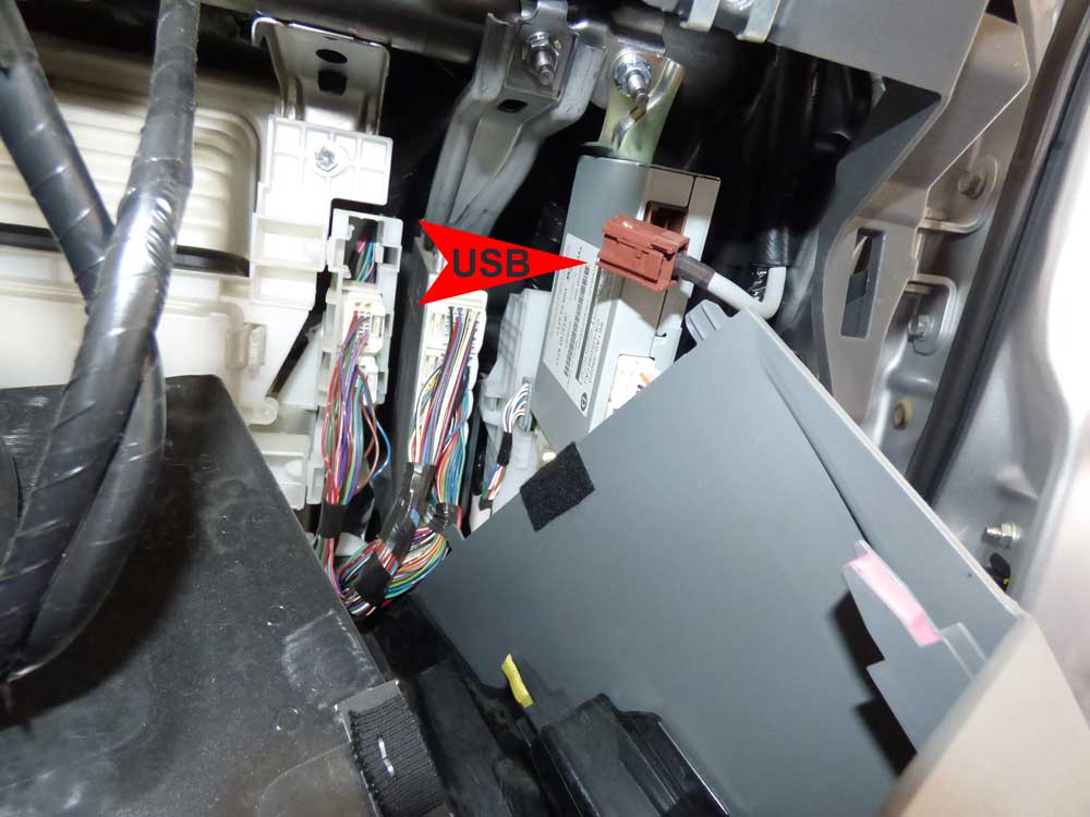

The plug for this adapter on the non JBL is behind the glove box. The stock plug connects to a silver box (labeled Panasonic) mounted vertically on the passenger kick panel behind the glove box (on mine anyway).
You'll need to disconnect the stock plug from this silver box, connect it to the adapter, and run the adapter to the stereo.

I will have to look for that box tonight. I don't remember seeing it in the kick panel but didn't look too far up.
You were right on the money with this one. Never would have thought to look there. Real pain to get to.

Yup, that's the one!
Yeah, it is a PITA to get to. I just zip tied the adapter cable to the loom that the stock USB wire ran in back to the stereo.

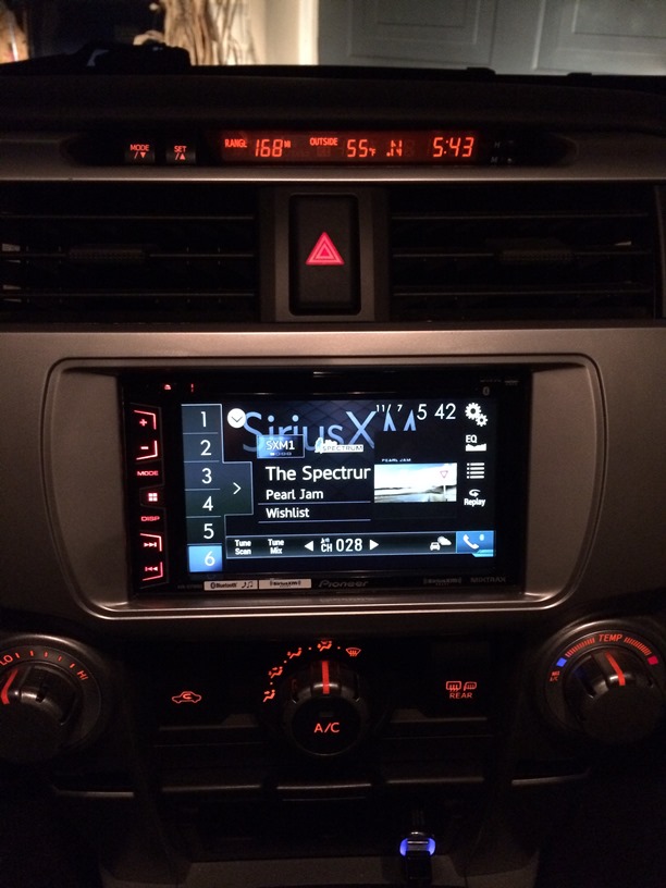

So todays lessons learned. There was one issue with the new head unit I couldn't figure out. The dimming didn't work. I tried auto, manual, day, night, nothing was triggered by the light switch. Pulled everything back out, tested the orange connection, 12v when the headlights are on, but not the parking lights, which is OK. Still can't get it to dim.
Then I turn the key to on, nothing... wait... it slowly dims. Put the key back to ACC, nothing.
So the key has to be on, and the dimming function is very gradual. I was looking for the instant dim the way every other stereo I ever owned functioned.
So for those with a Pioneer AVHX series (maybe others) now you know what to look for if your auto dimming doesn't seem to work.

Love the install, and the Pioneer AVH-X2700BS. Install was in family member's 2010, and was replacing the Kenwood DDX392 I installed 2 months ago (bluetooth quality was terrible on Kenwood). Very pleased with fit, and sound quality, even with stock speakers!
Thanks to Nororola for advice on the mic routing!
